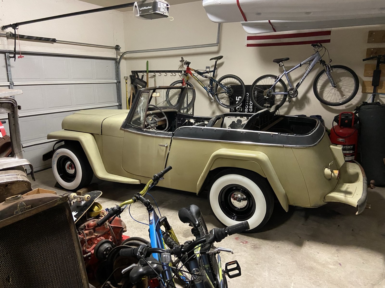

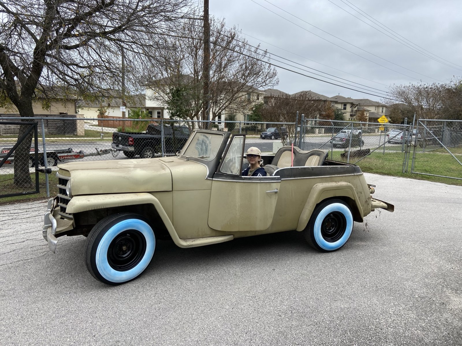

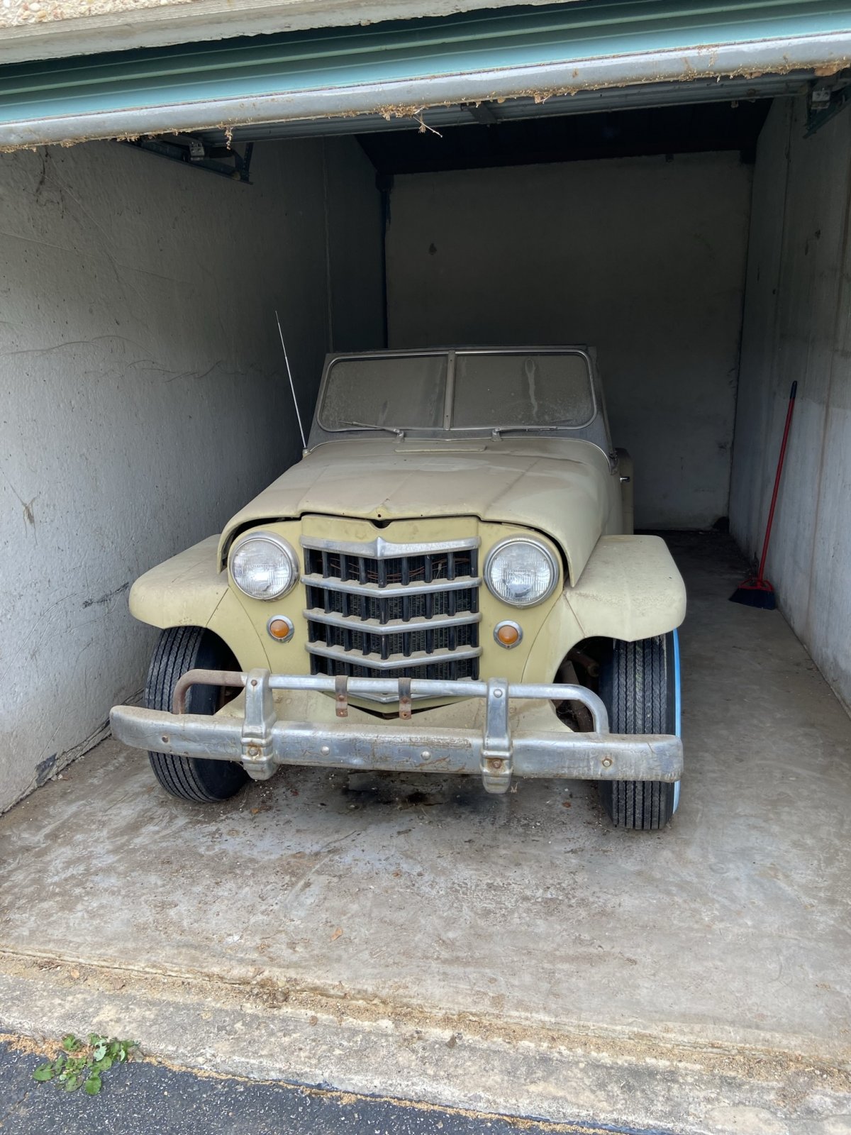

    Thanks. He is super excited and appreciates old stuff. Nice Jeepster! I am building one for my wife right now. Pulled from a storage in Austin where it sat for 20 plus years. Eli is sitting in it in the second picture.

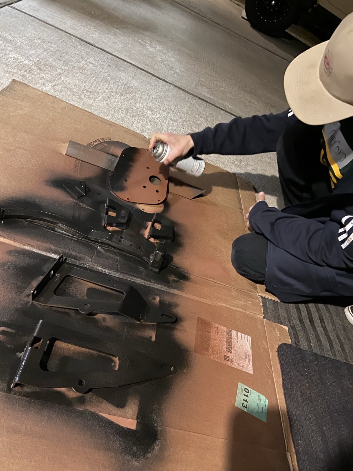

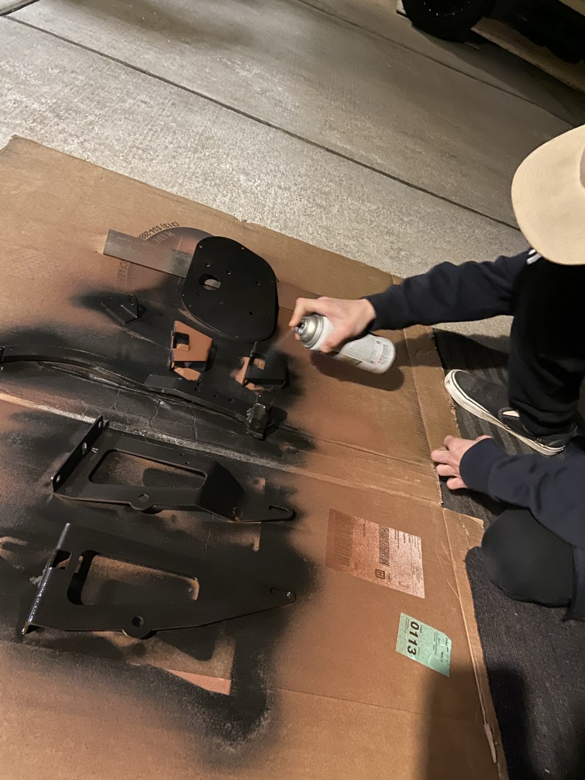

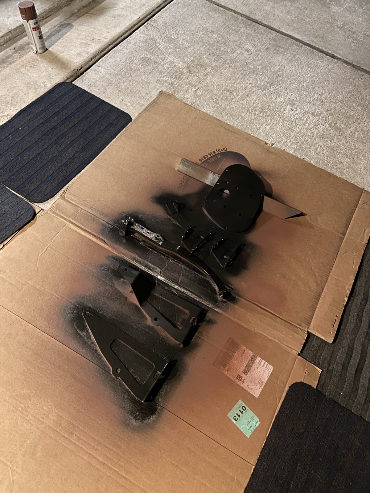

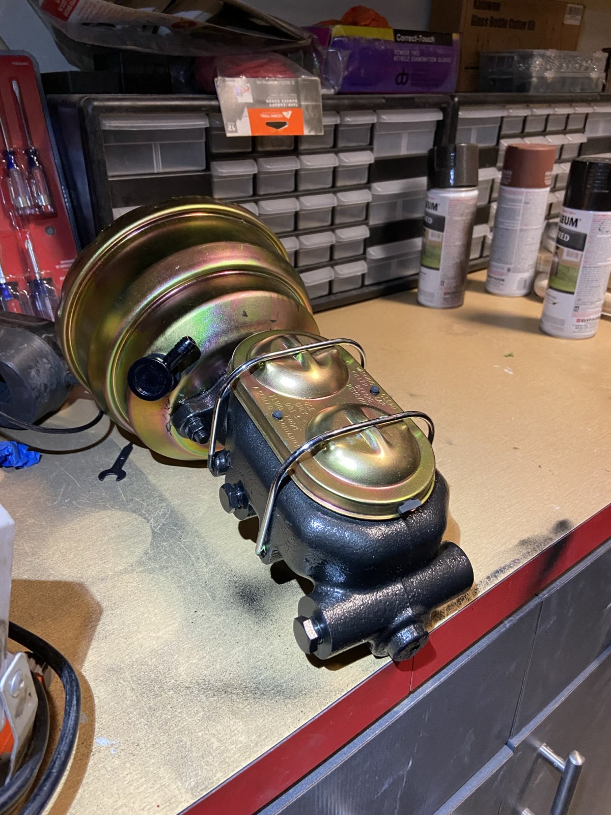

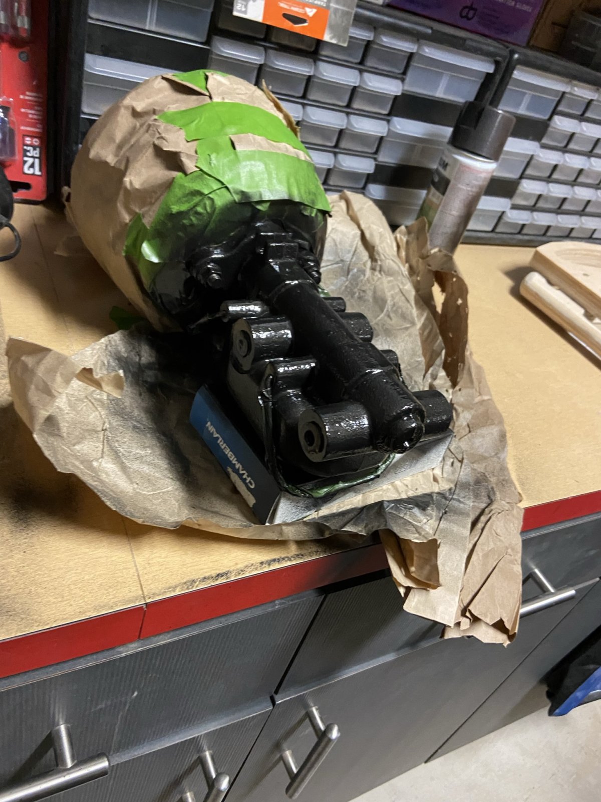

    Been working slowly on Eli's 1950. Life has been getting in the way a bit...in-laws in town visiting and a bunch of other stuff. Still plugging away though. Got the off topic front suspension set up. We purchased the power brake and pedal assembly from Walton Fab. Super nice parts and happy so far with everything we purchased from them. These parts are huge time savers for us on this build.
    Here's Eli painting the parts
    IMG_5495.JPEG IMG_5496.JPEG IMG_5497.JPEG IMG_5498.JPEG IMG_5499.JPEG IMG_5509.JPEG

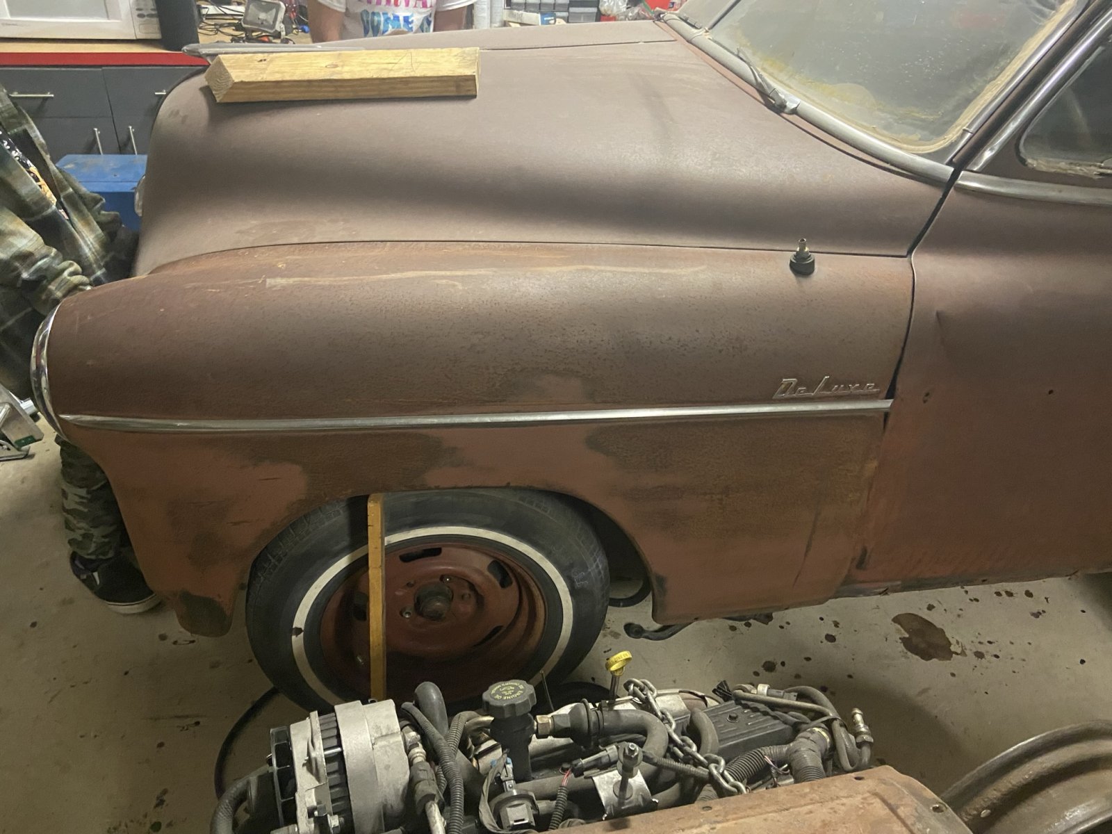

    We set a font fender on to make sure the wheel placement looked right. All of the measurements worked out and aligned from the original location.

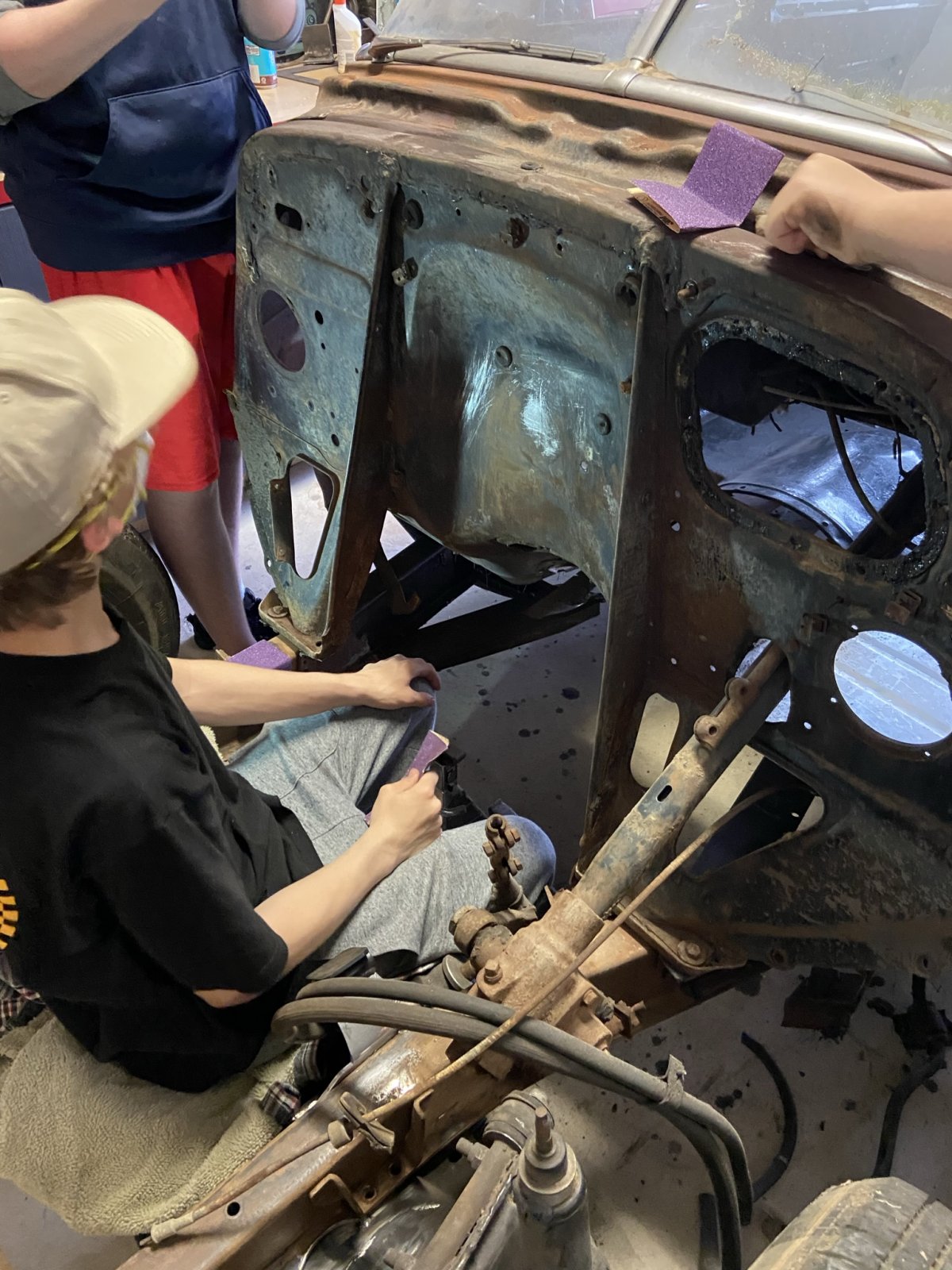

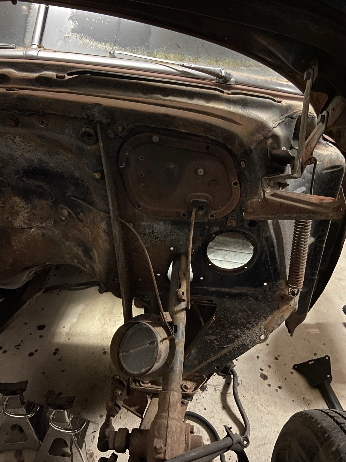

    @Thor1
    Eli and I used the tool you sent us. We pulled the hood and started cleaning the fire wall up. Thank you again for sending this. we will find someone to pass it onto when we wrap up with it.
    Eli had some buddies over last night that helped clean up the fire wall.

    im sure youve figured this out by now but just incase you havent its been my experience that the firewall body mounts may need to be shaved a little.
    also my experience was that posies springs with a 3" block ( 2 1.5" aluminum blocks welded together) would bang the axle on the frame pretty regularly. that was also running 6.70's which is a 29" tall tire if I remember correctly?
    before you have a driveshaft made for it see if a stock tri 5 will fit. I had a saginaw 3speed in mine and a stock 57 chevy drive shaft bolted right in.
    also I seem to recall having to notch my tunnel a little bit too.

    Matt, I am glad they worked for you! You guys are doing a great job on the car. I can't wait to see how it turns out.

    Thanks for the encouragement and sharing lessons learned. We have Posie's springs with 2" blocks now. Need to check the clearances to the frame. Hopefully we don't need to notch the frame but sounds like we need to.
    I heard if you run a mid 90's LT1 set of exhaust manifolds, you can avoid trimming the body mounts. We should have the motor mocked up in the next few weeks and will know for sure then.
