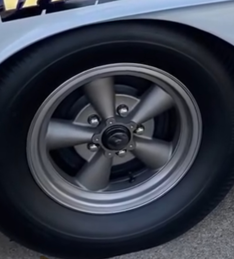

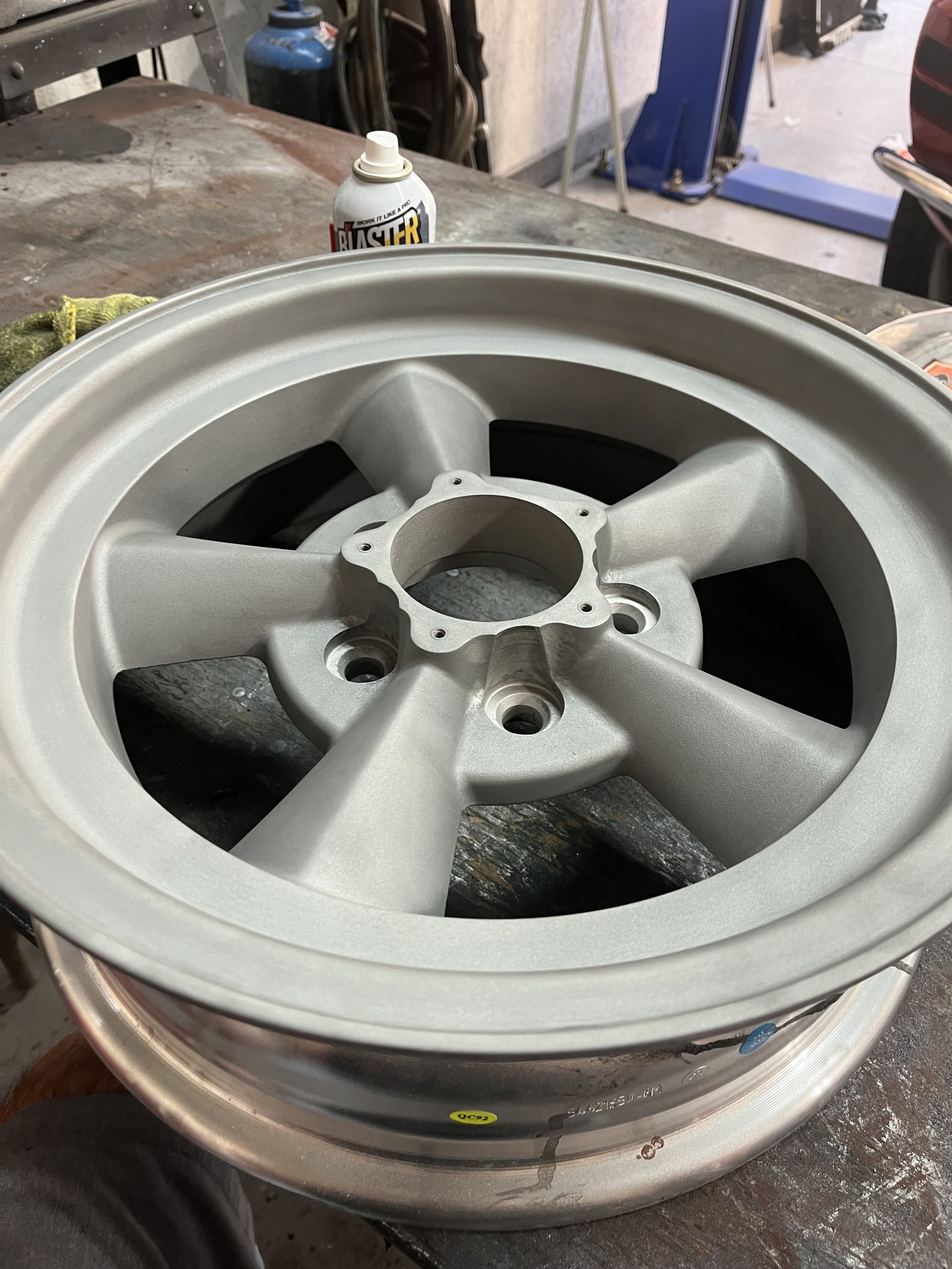

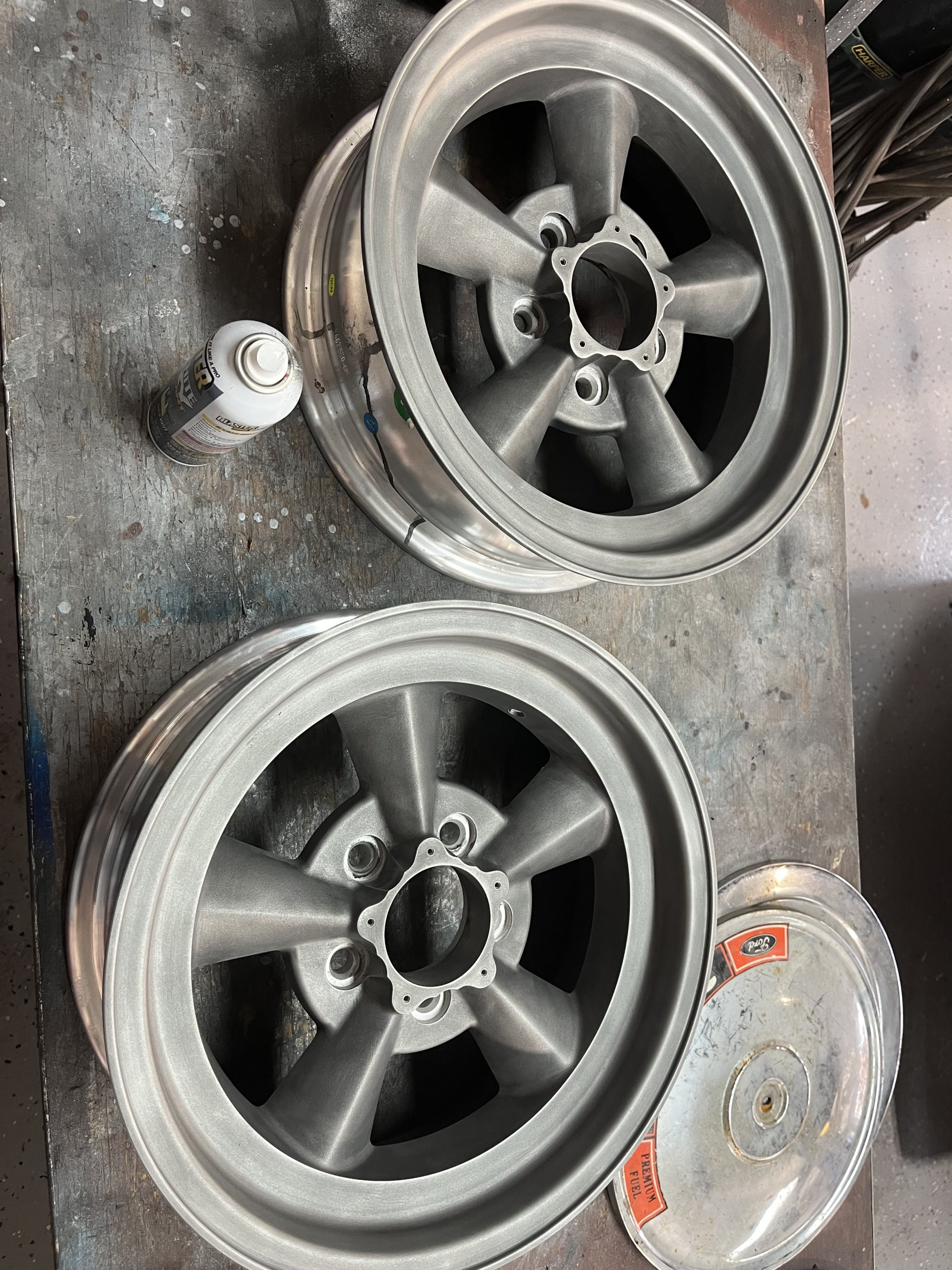

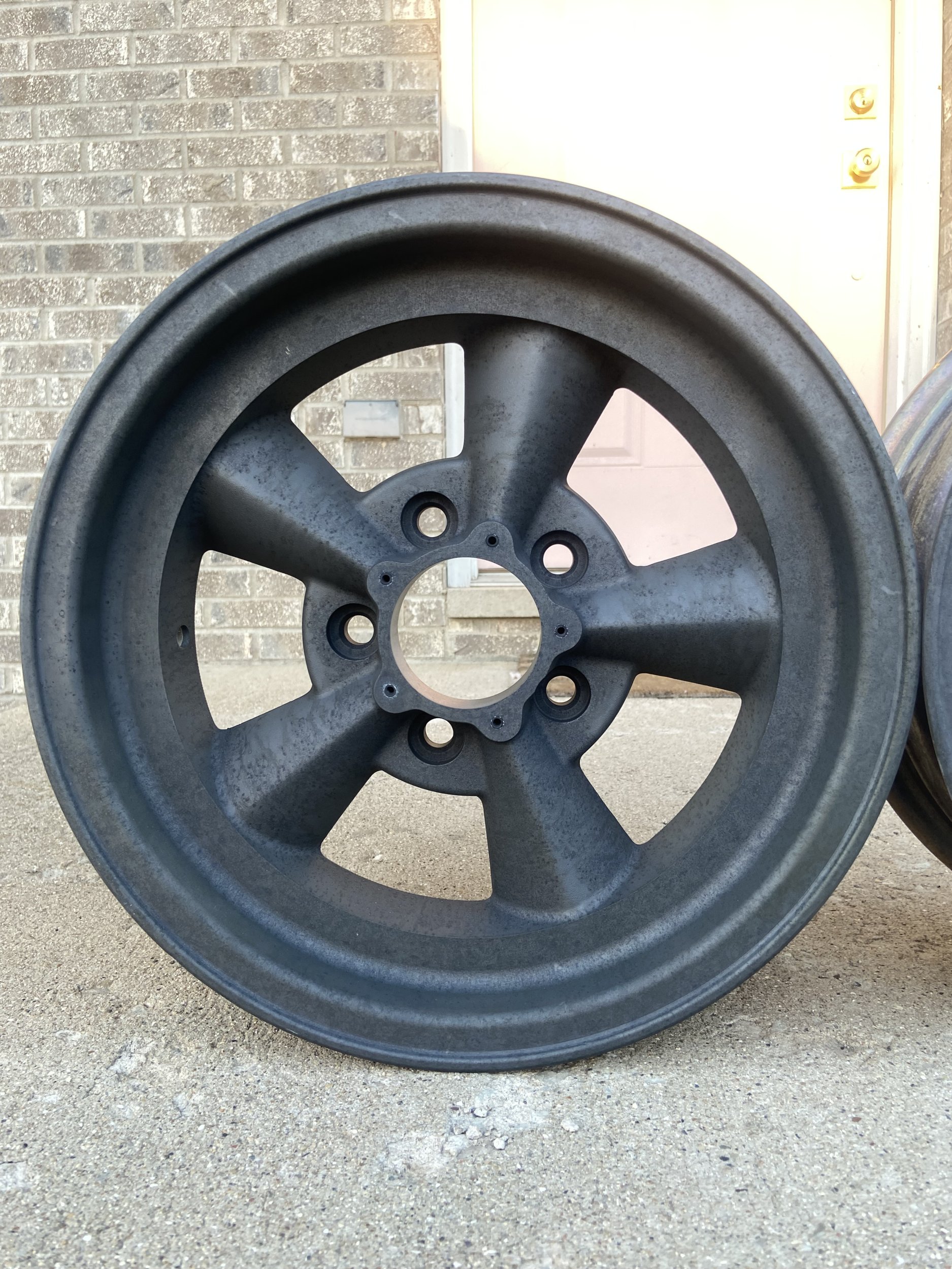

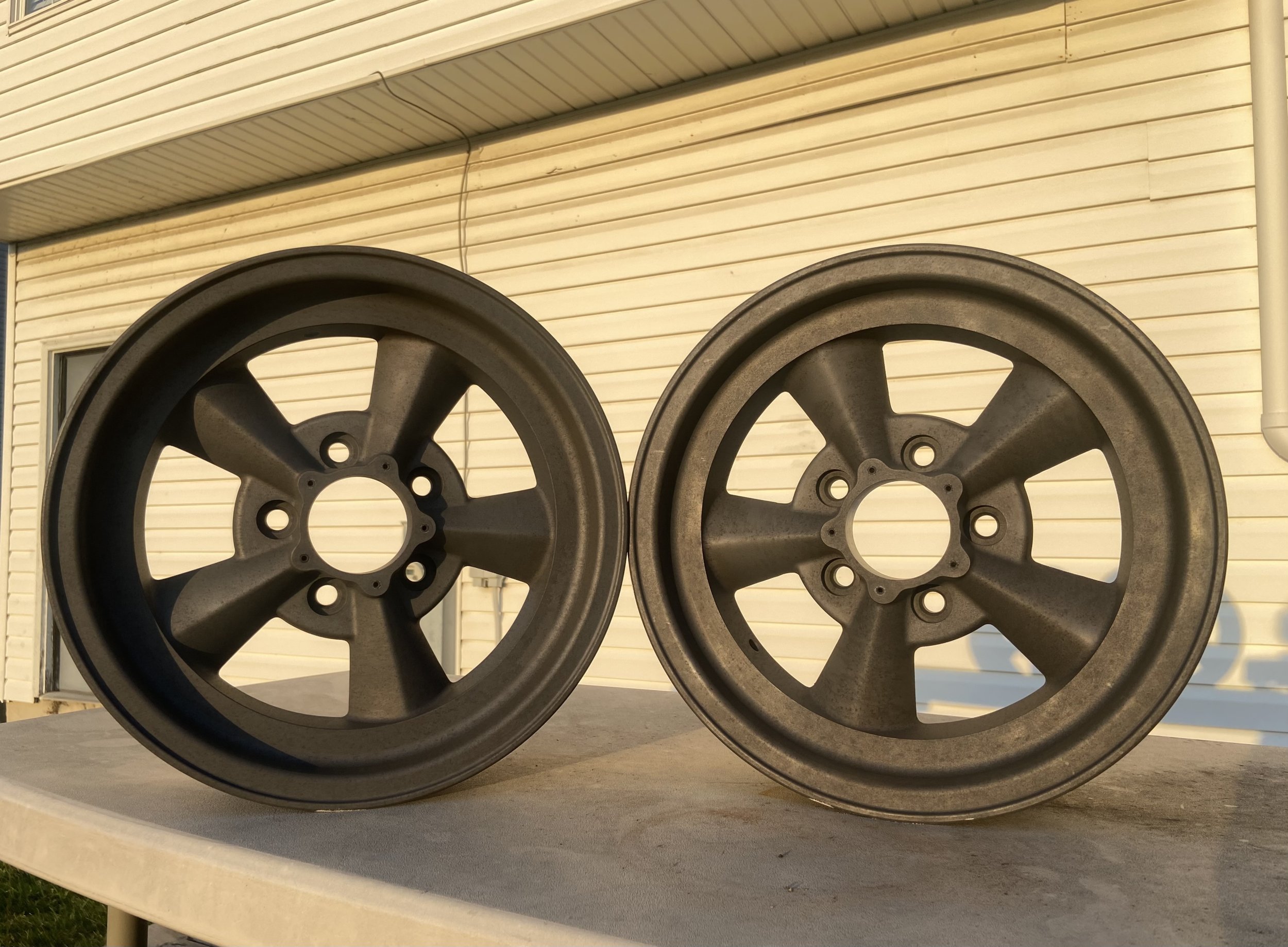

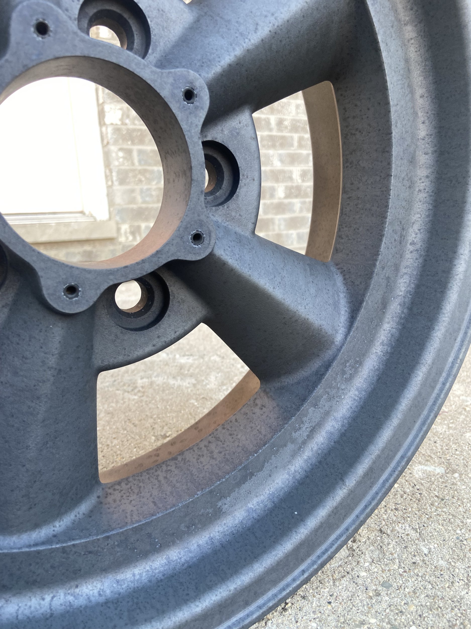

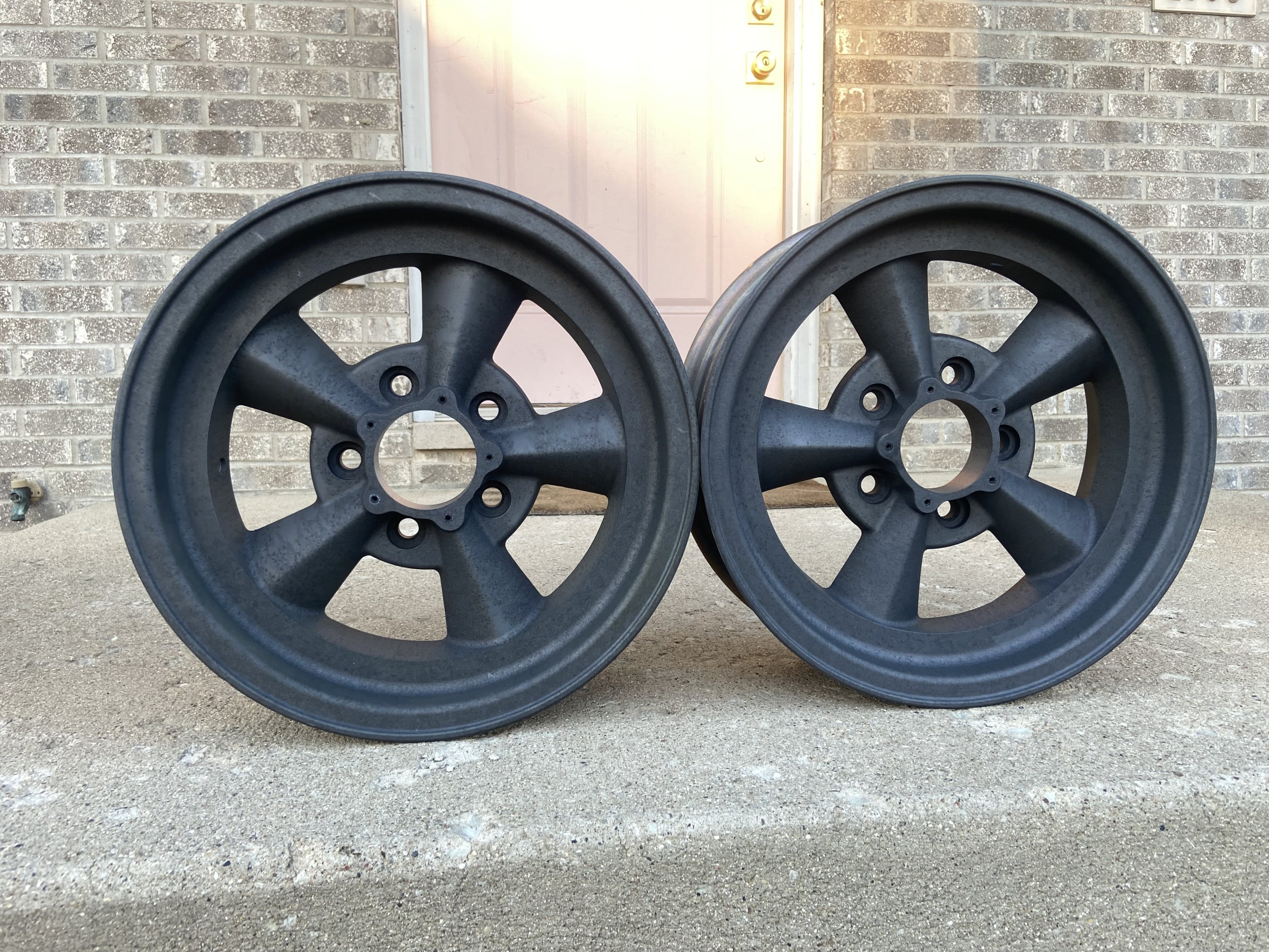

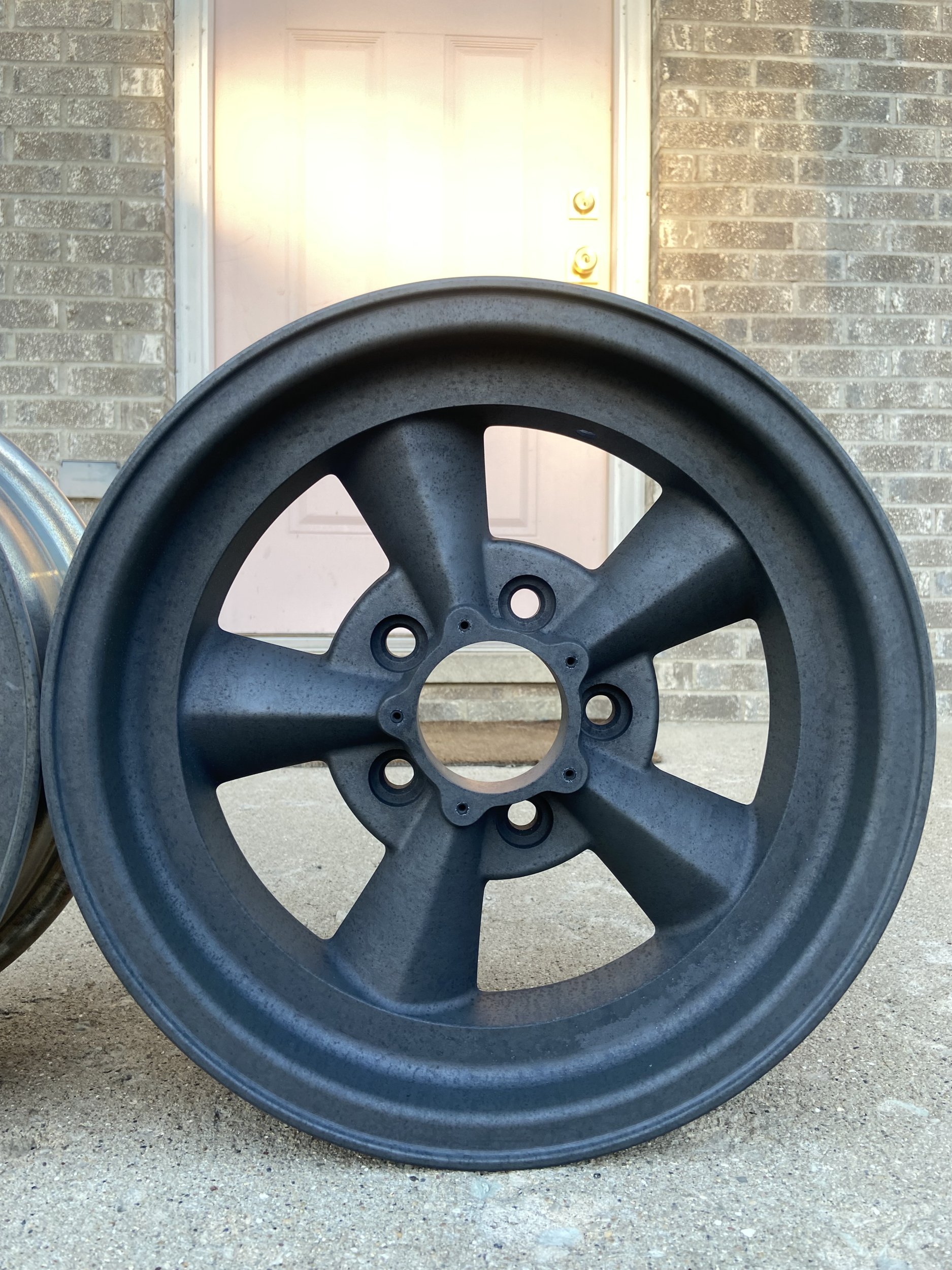

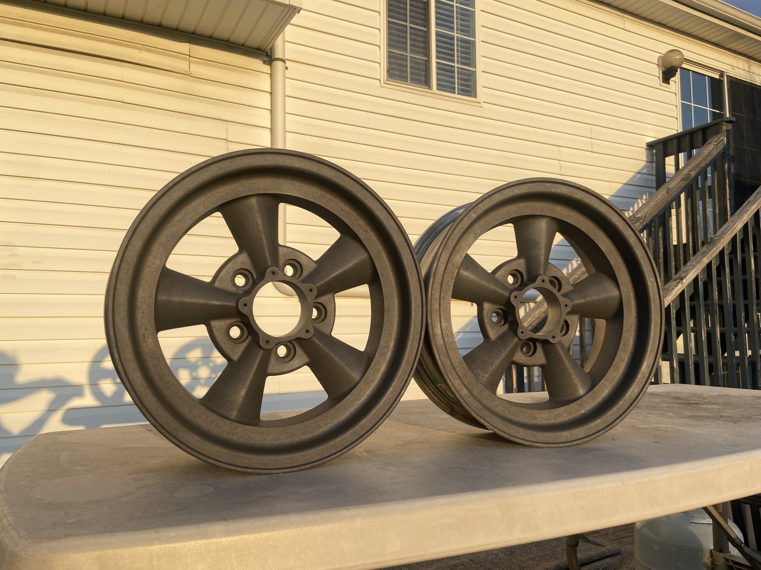

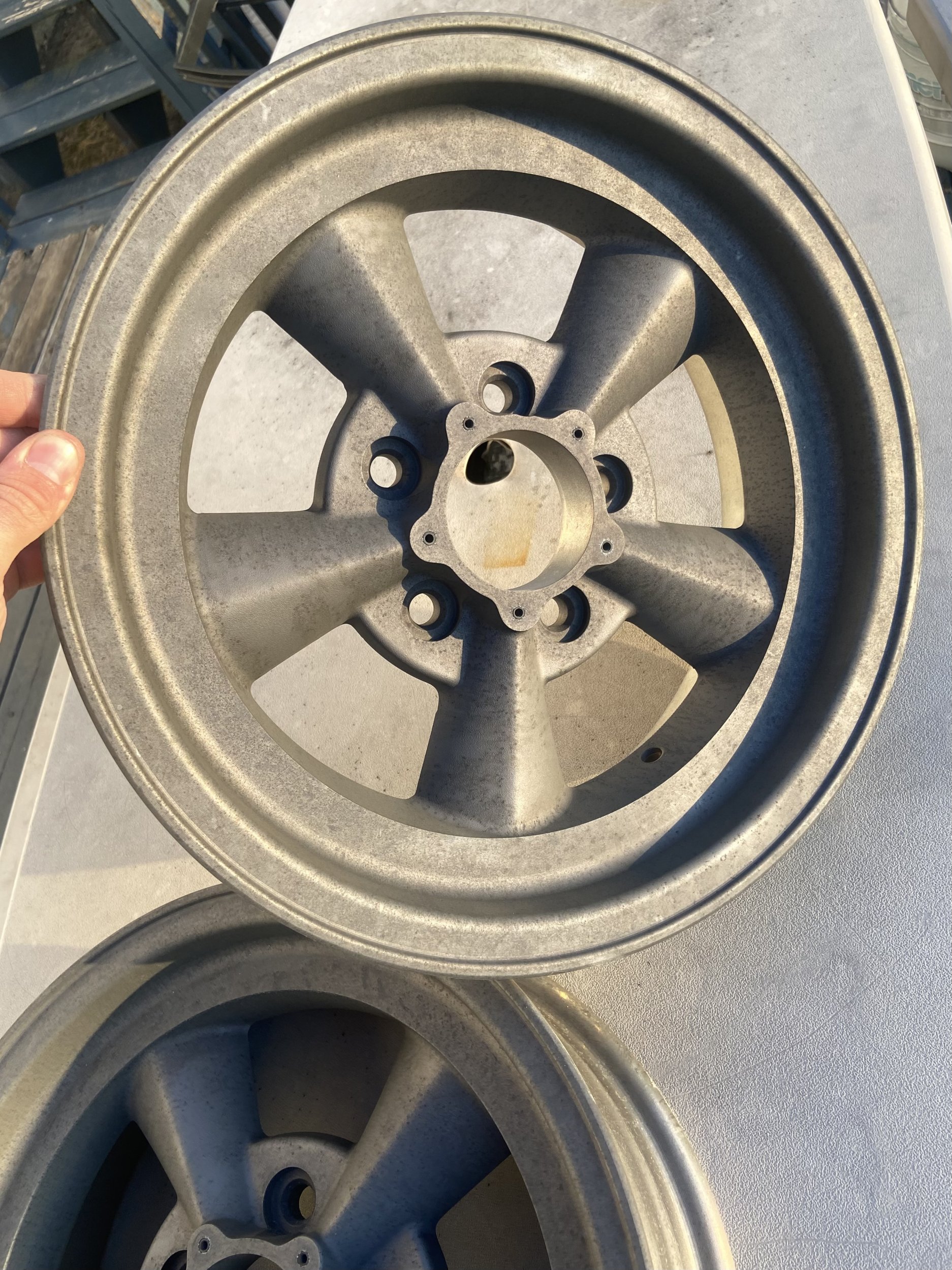

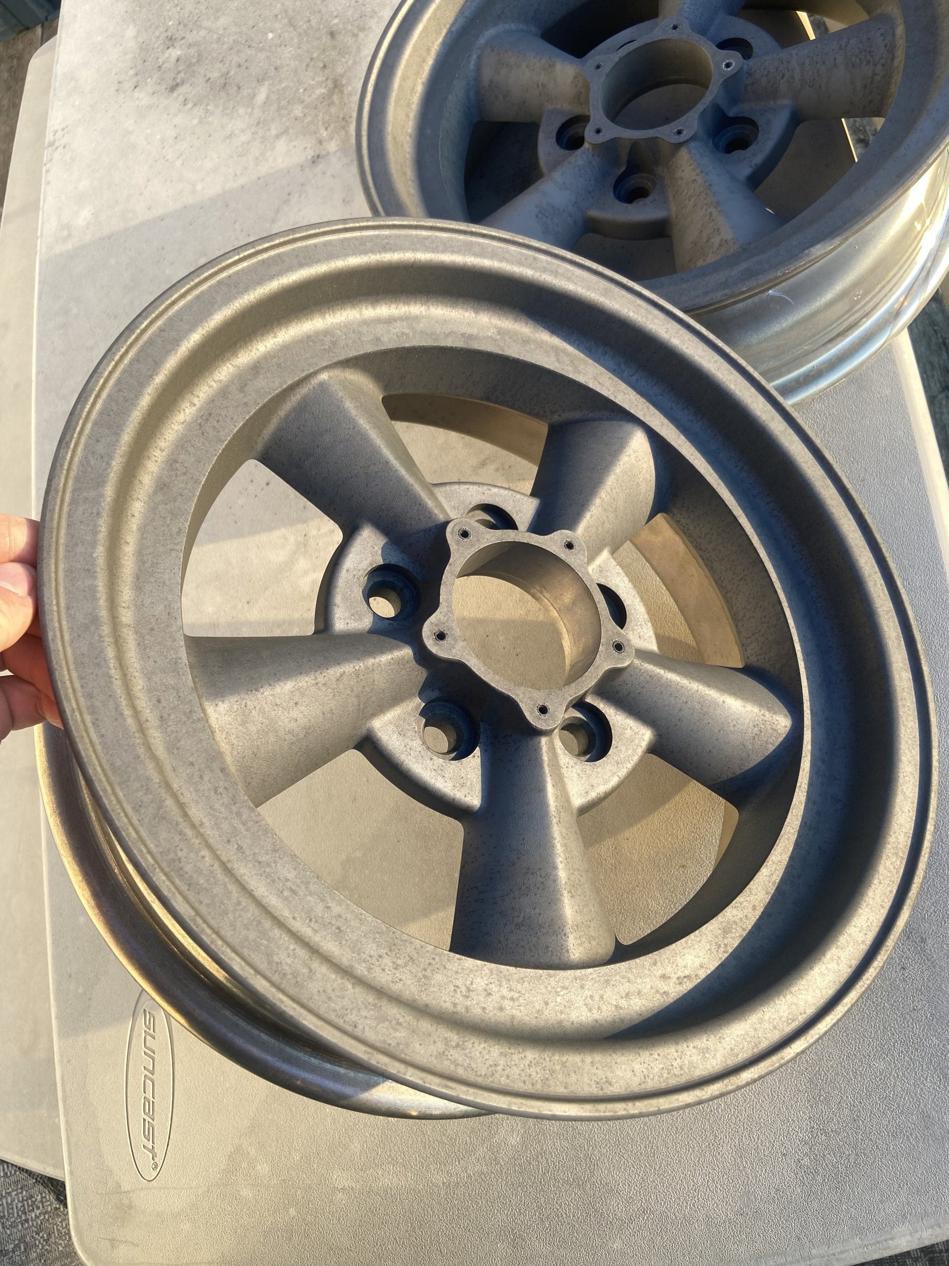

    The machining I removed is specific to the American racing wheels, it’s machined lines in the “polished” part of the wheel done by CNC or a lathe. I sanded this by hand with 80 and 120. And I used a co**** media, just to make it all uniform across the entire wheel. I blasted both front and back.

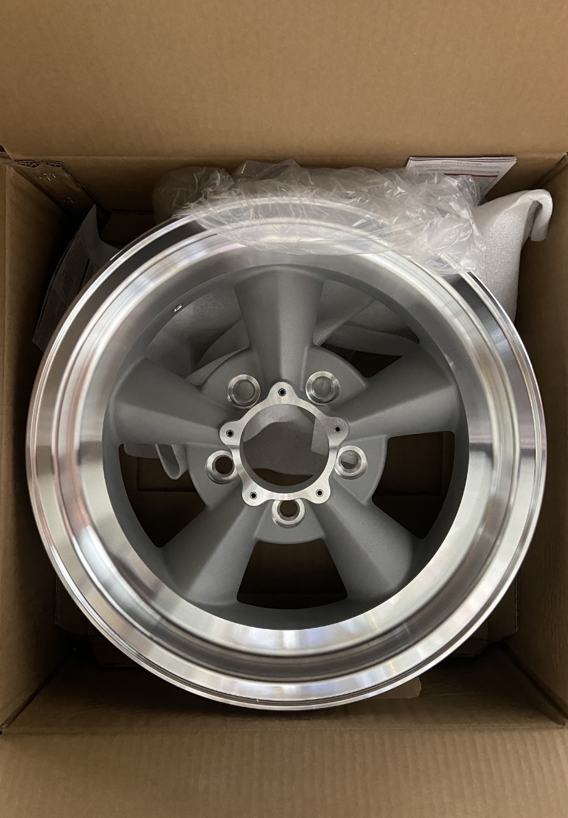

    Yes…I just got my wheels and saw that…ughhh…I’m gonna look at surface conditioning discs to see what I can get off with those…those lines ****! I’ve got gl*** in the cabinet now, not course, may take em to the local blaster..and I’m gonna blue em with the gun blueing

    This is a friends ET wheels..all he did was scotchbrite the lips, used a cotton ball to apply,
    And hit em with 000 steel wool..cars been driven in rain, snow, salt, and still look great..
    issue is the Americans are painted in the center,
    So that will have to come off and the machining marks are pretty deep..gonna be a lot of sanding to get that area smooth..I think I’ll sand the lip first and go from there

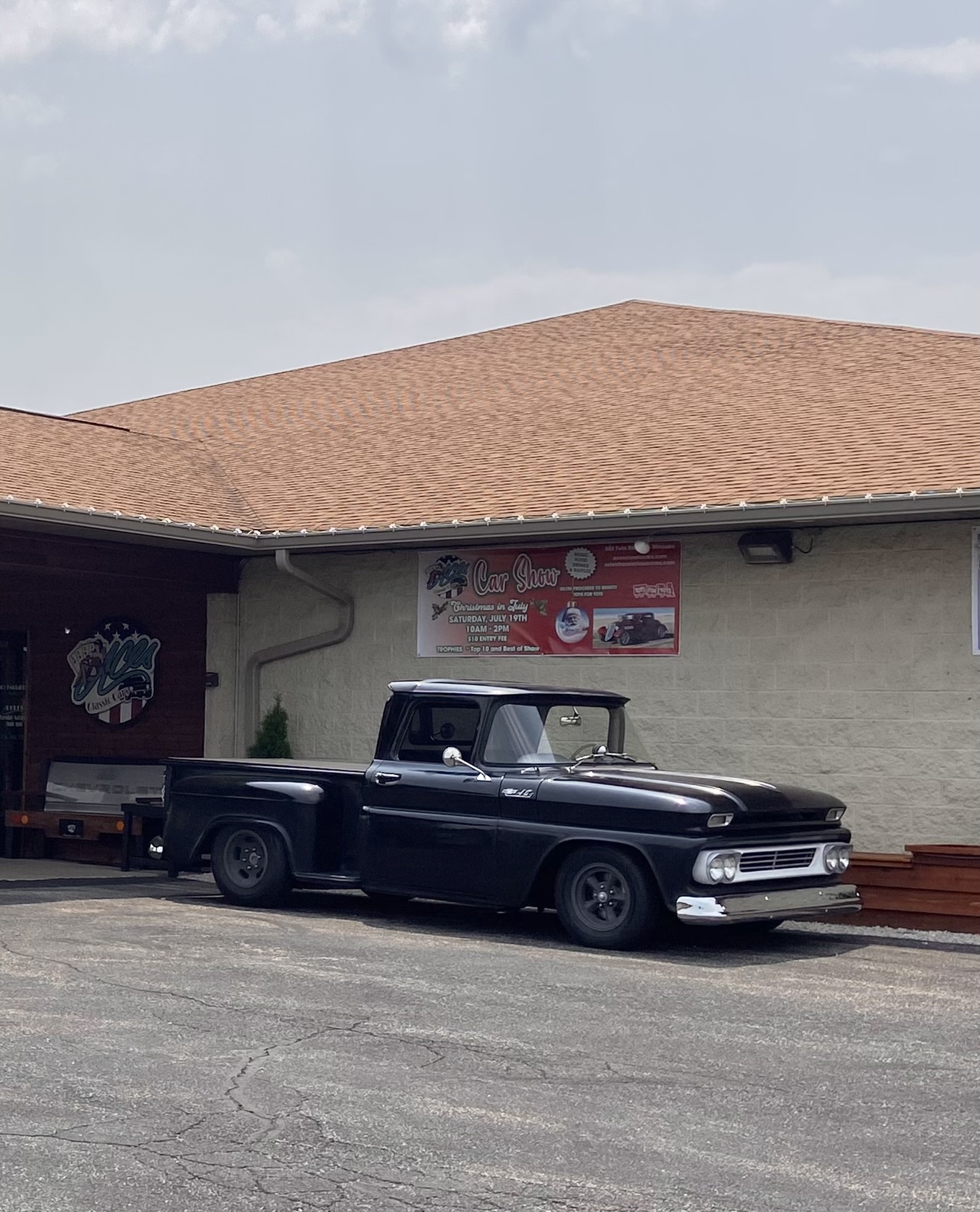

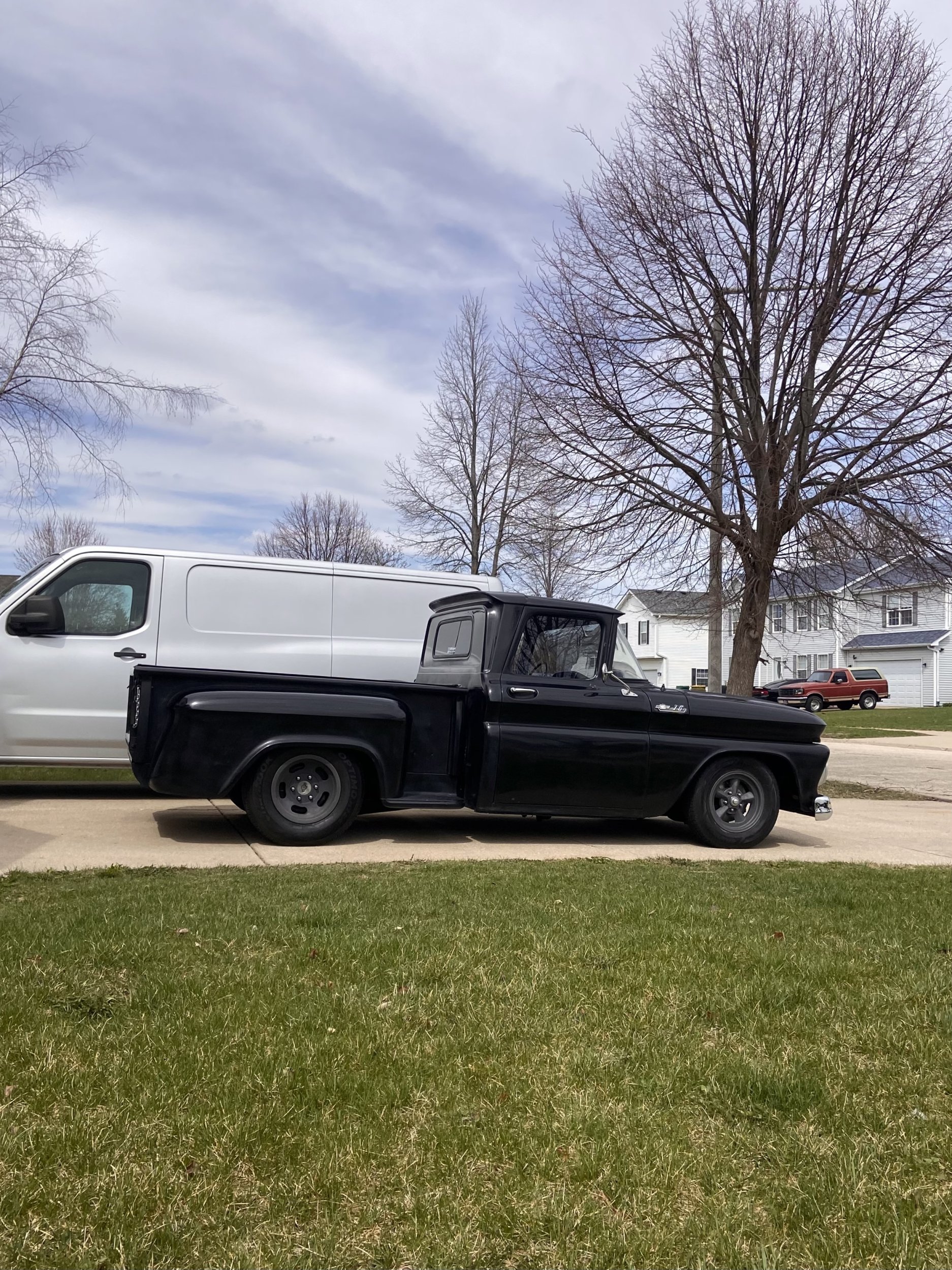

    looks like Eric Wallace’s Corvette!
    His car is one of my main sources of inspiration when it came to building this old truck.

    So when you say sanded by hand…what did you use for a back up pad? I don’t want to finger F the lips of the wheels up..my plan is to get em straight as possible, not gonna blast, gonna use a cast paint like the ET’s come with, and blue the smoothed out lip…

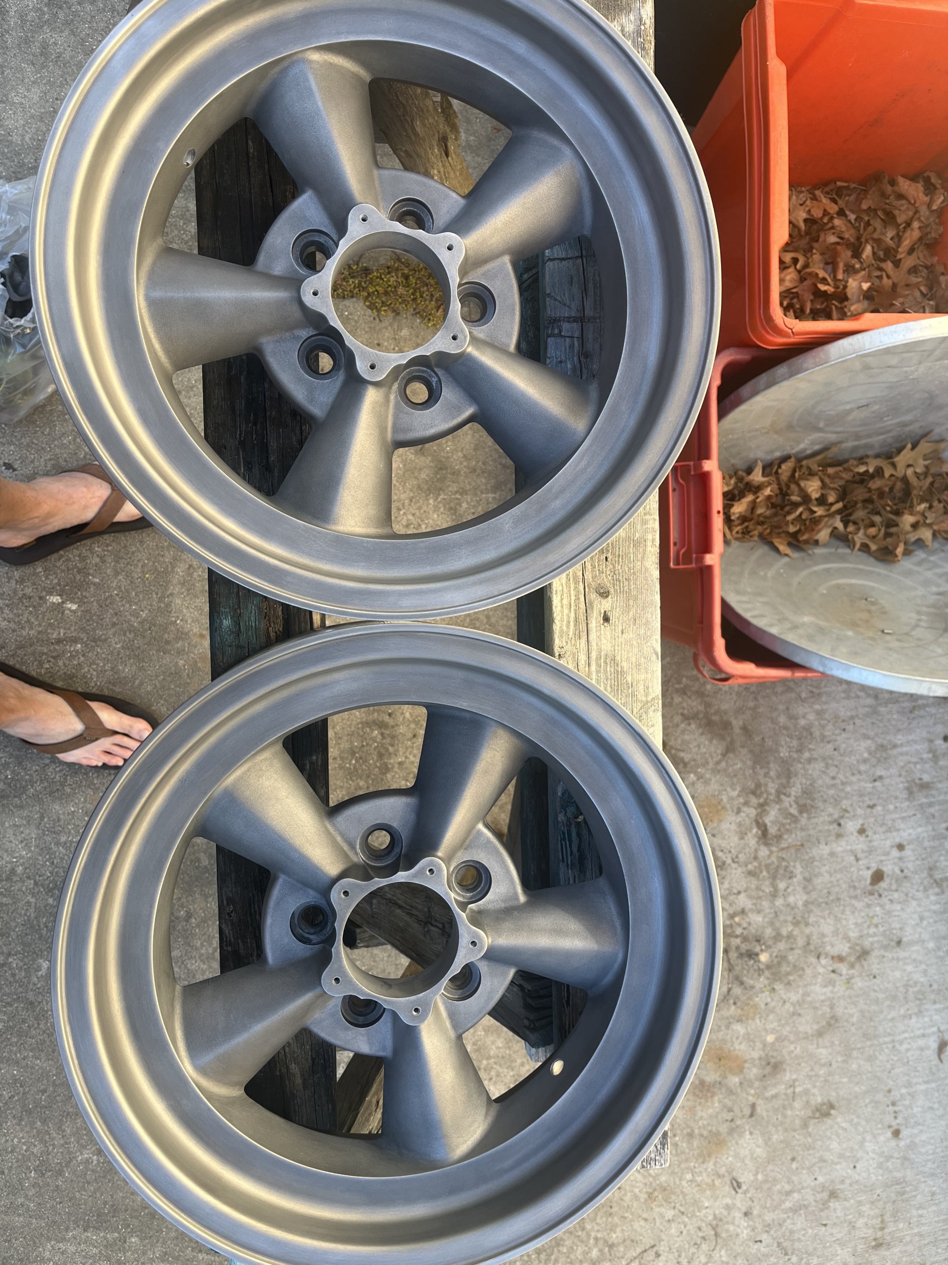

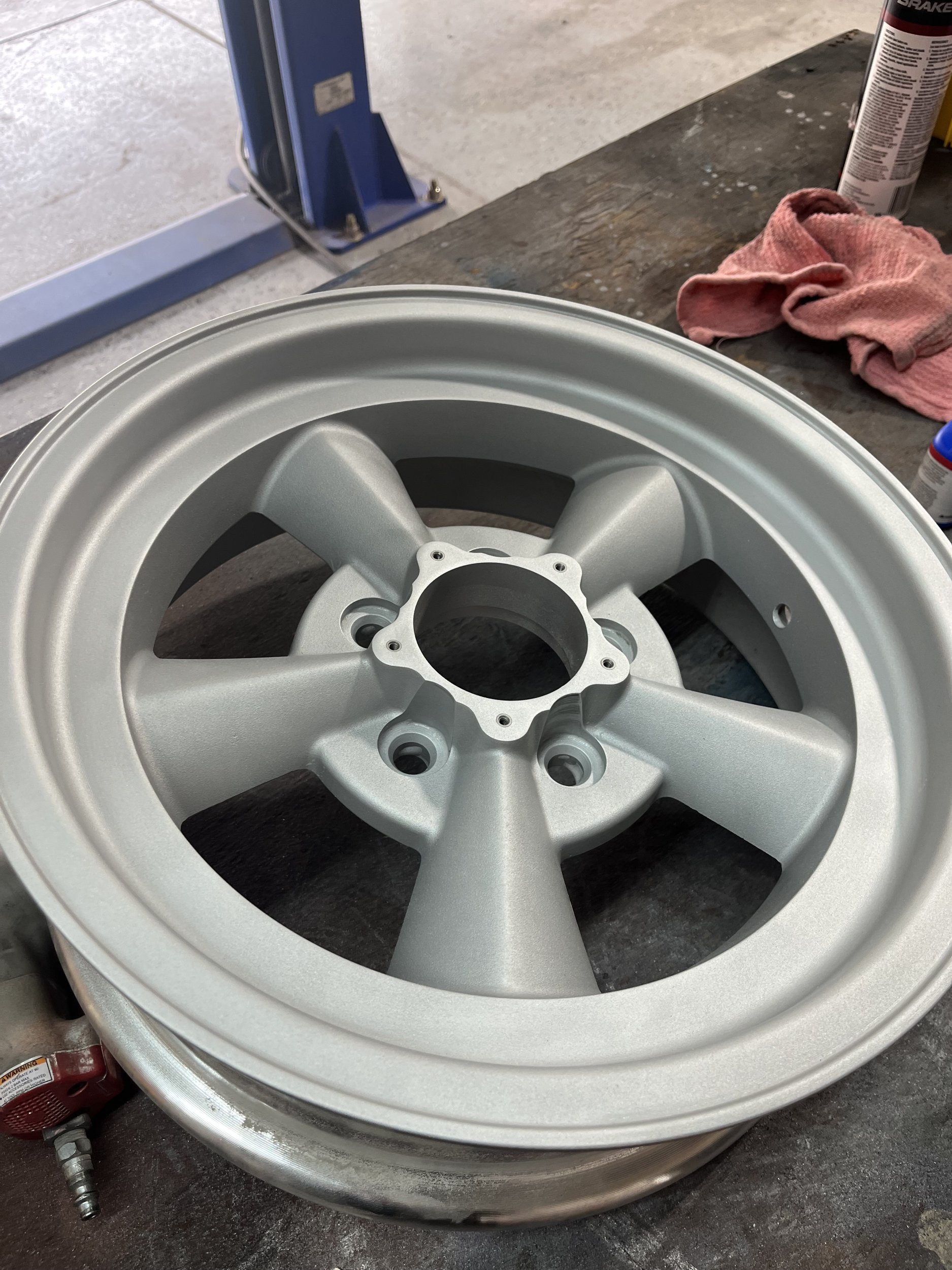

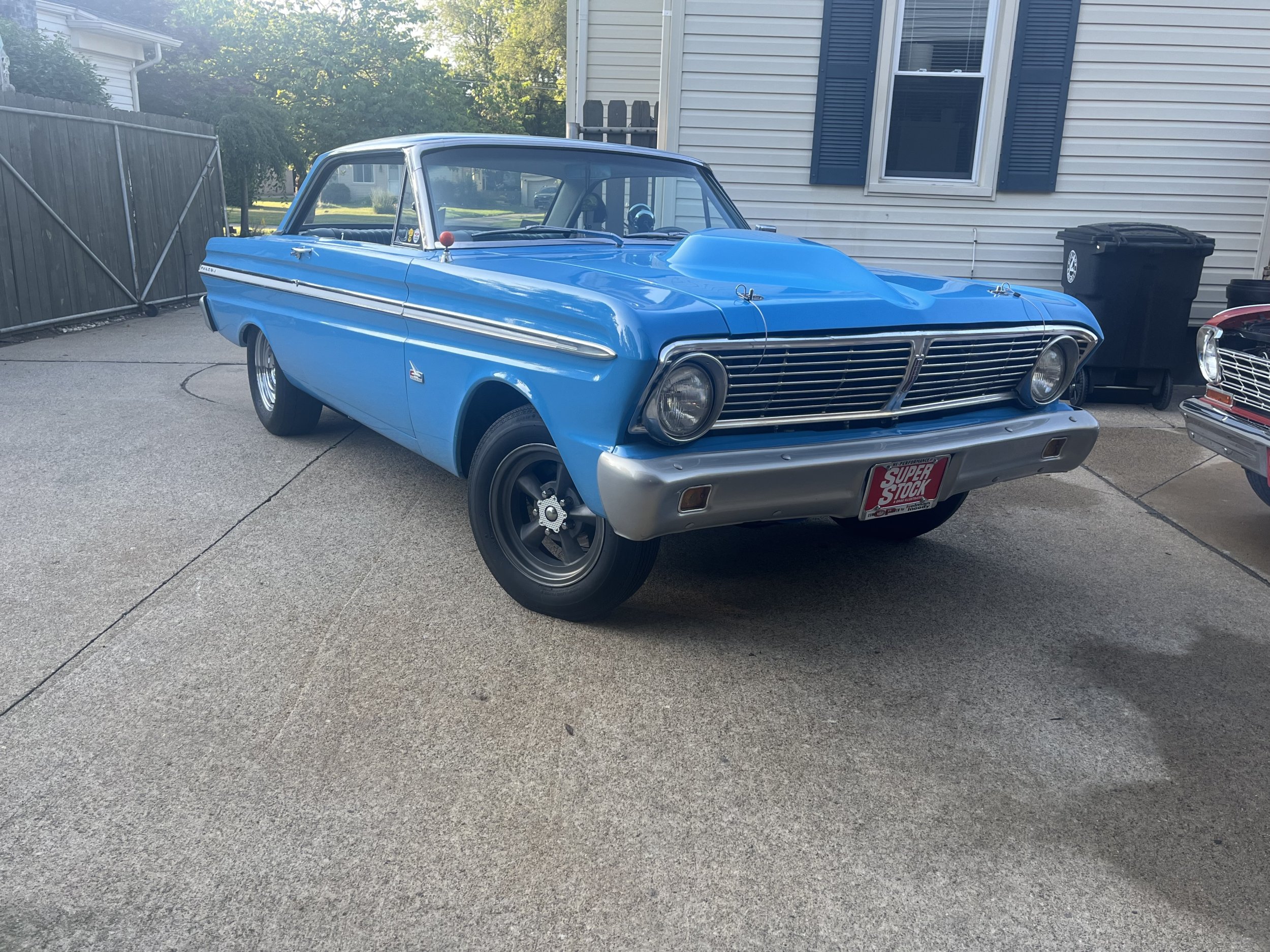

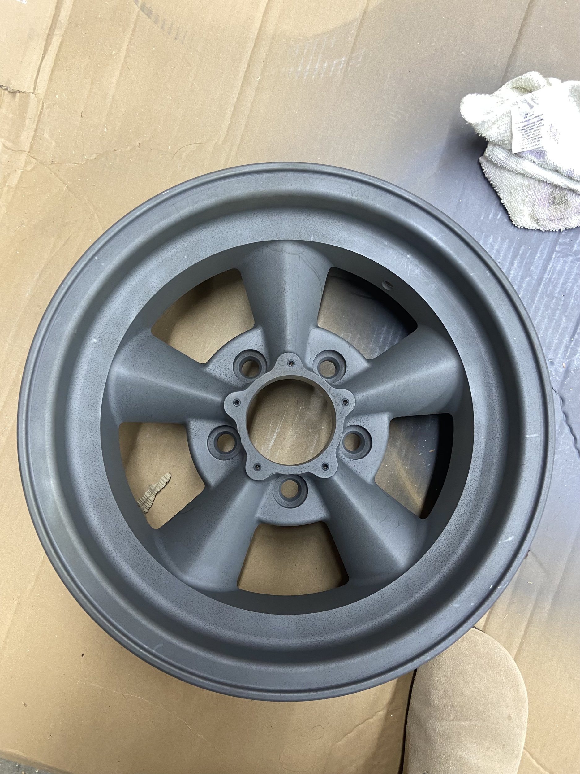

    Well wheel 1 has been sanded and blasted…I used 80 grade on a cut down interface pad by hand for 80 of it and a 3” DA where I could. I blasted the whole rim to make it look uniforms..I could only get the blueing liquid for steel locally…tried it anyway..not the best result…didn’t really darken it much…won’t post a pic for that reason...ordered the aluminum blueing liquid and it will be here Tuesday.
    I may re blast the wheel and try to start fresh with the Aluminum stuff..

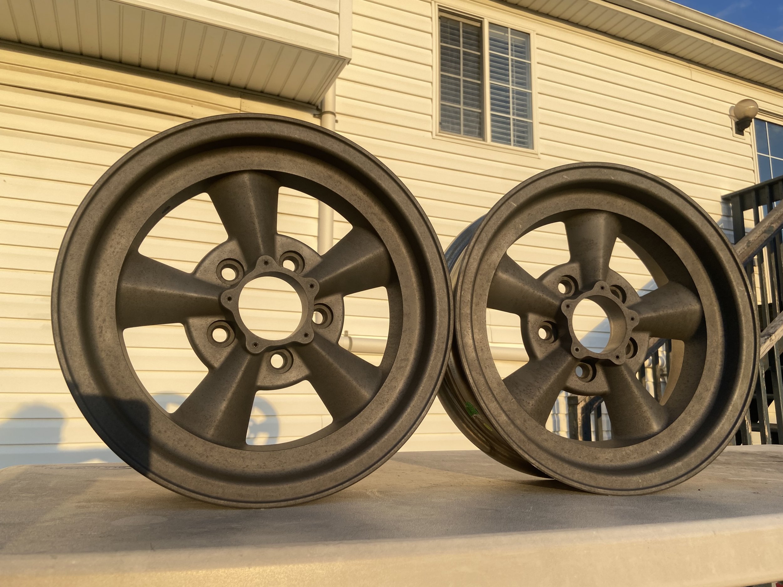

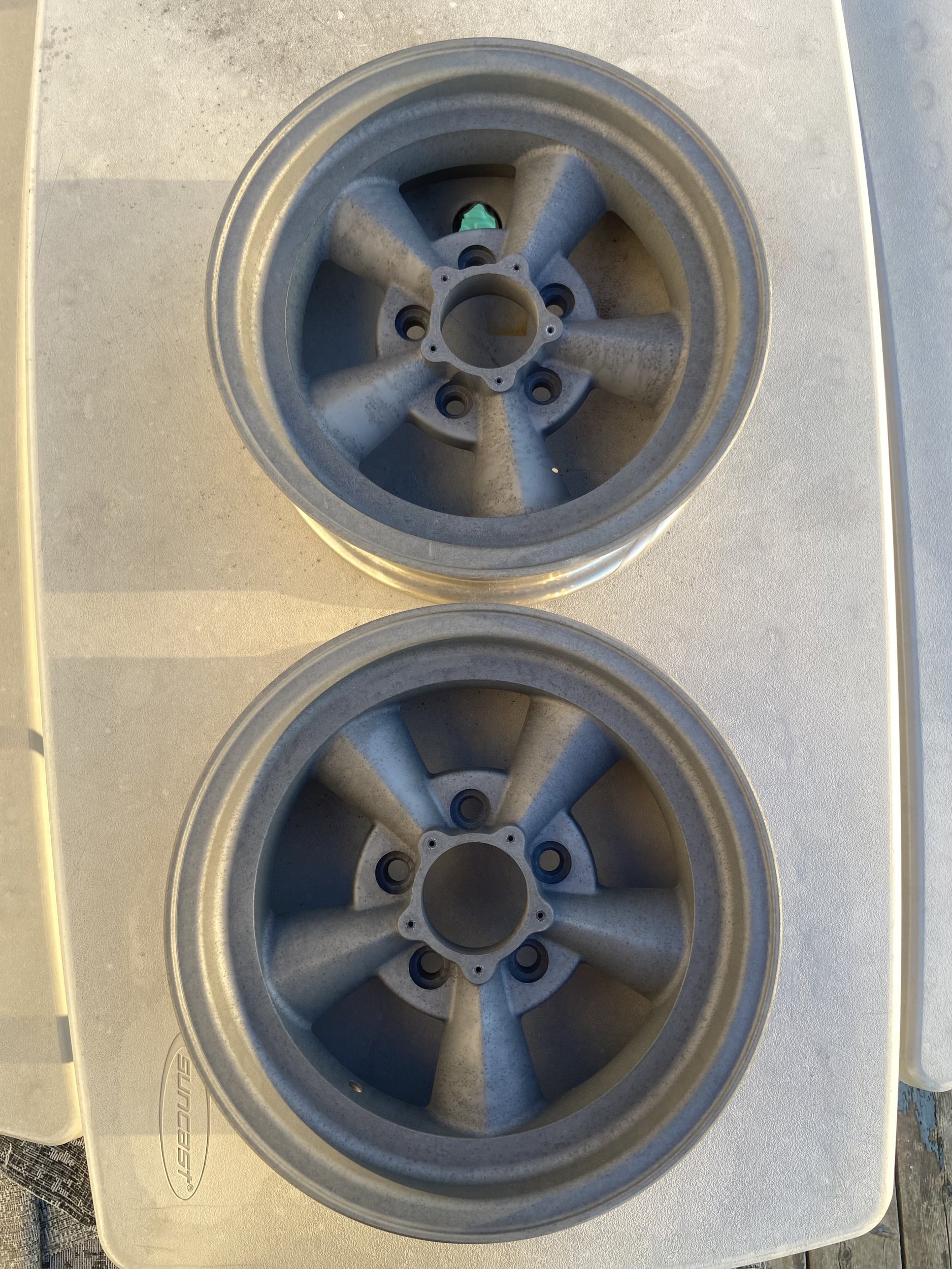

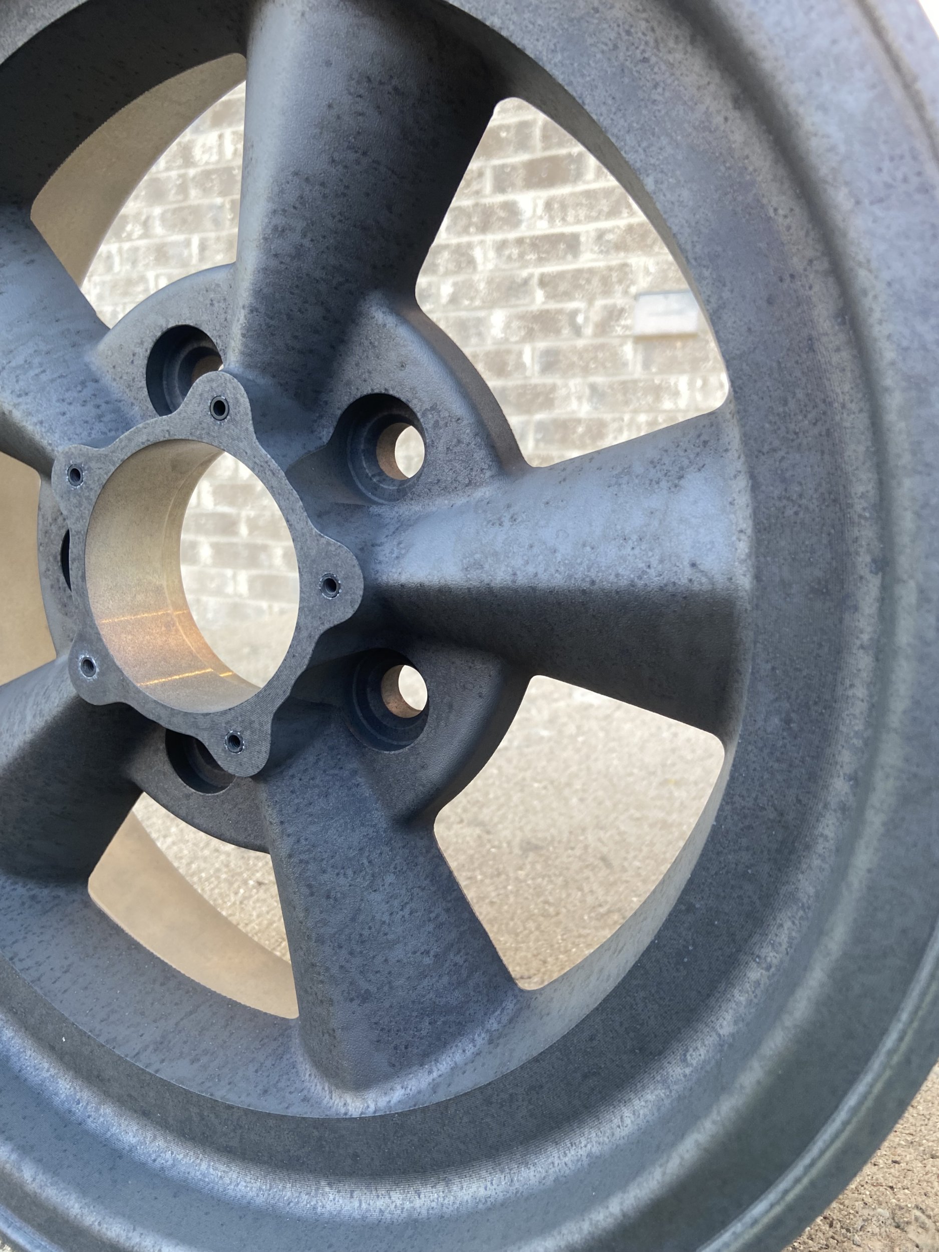

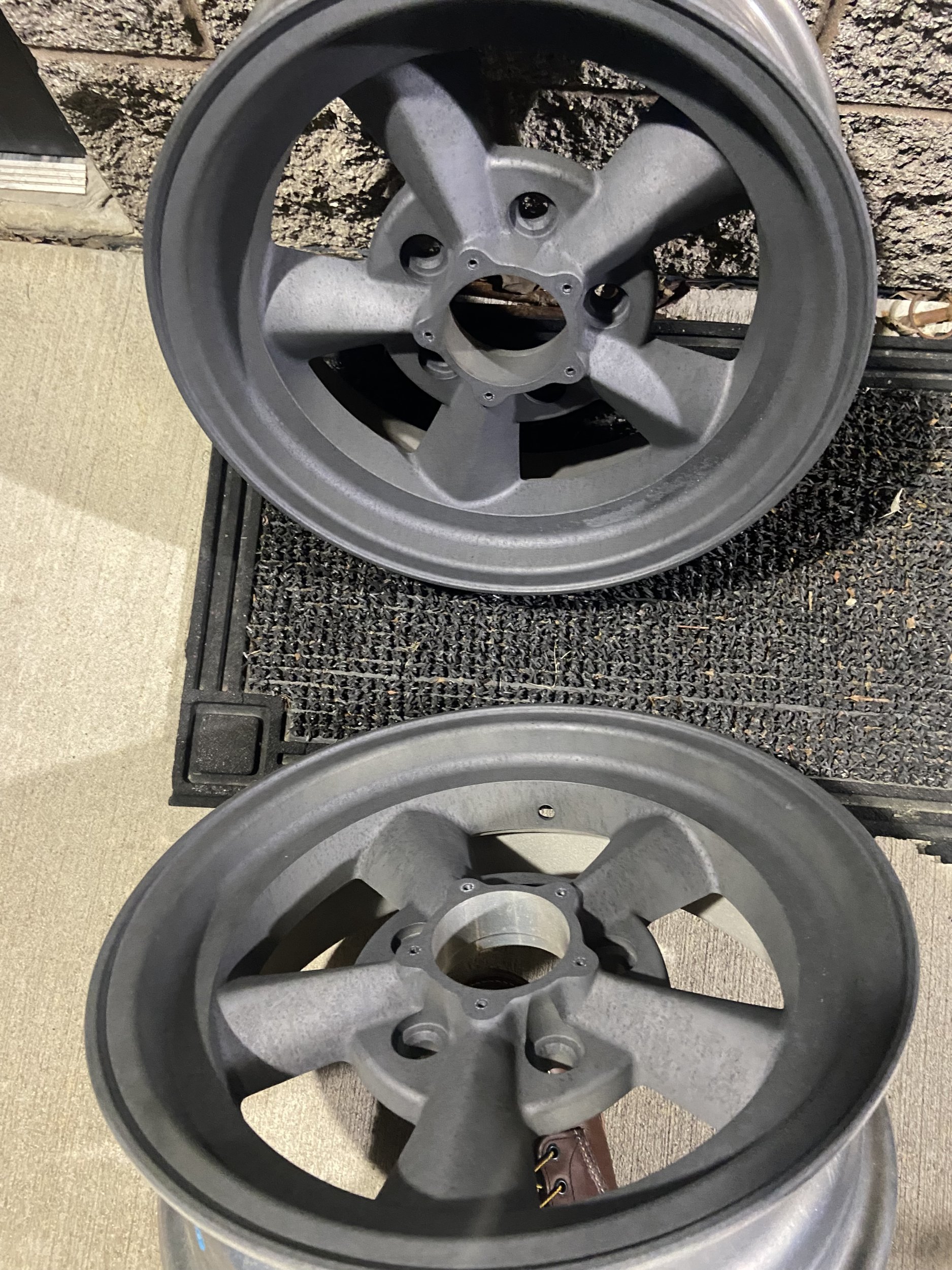

    I did the video method and I’m very happy with the results. Looks like “weathered” magnesium

    Not claiming to be an expert but the two pic’s here are what would be most permanent…as they etch into the aluminum, and aren’t just sitting on the surface. My son’s O.T. Valve covers (Vanish) turned out “mint”, nice and dark. Trust me.

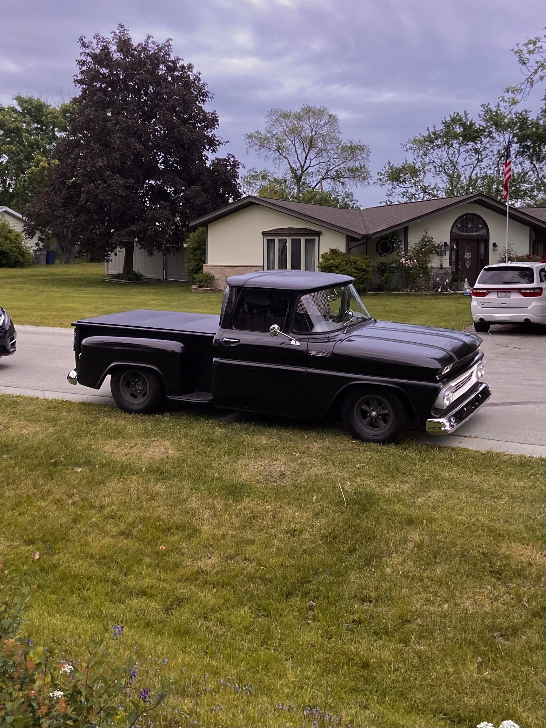

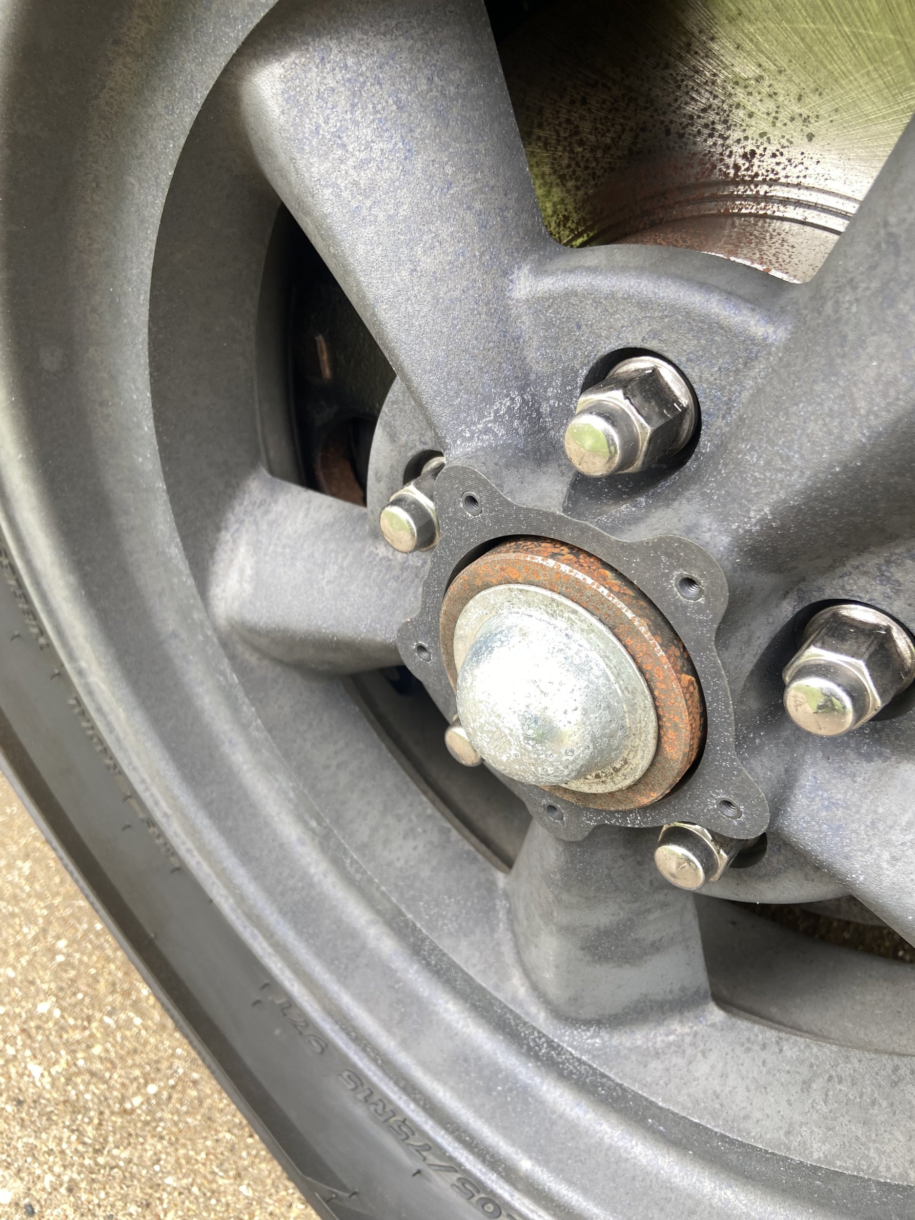

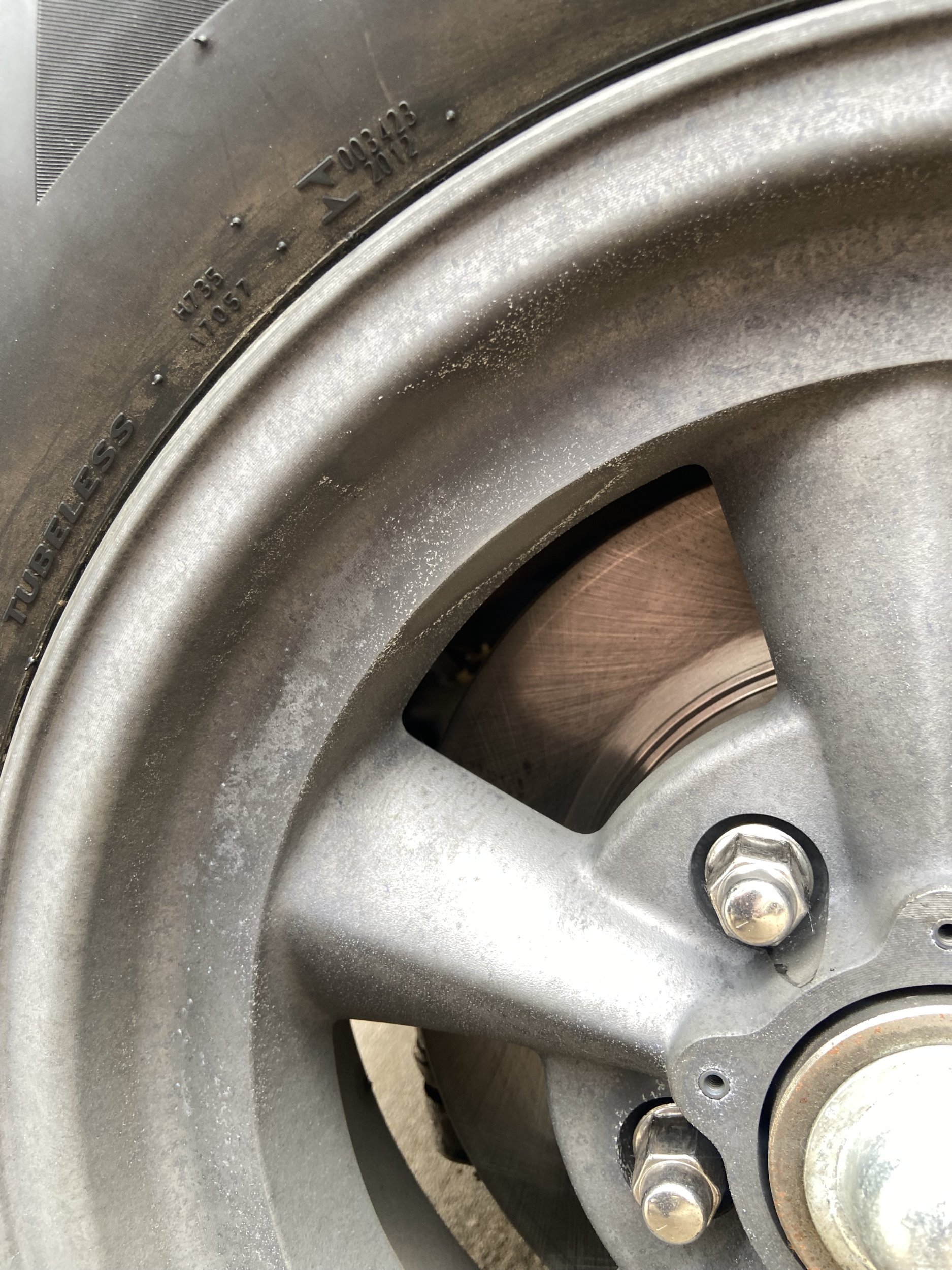

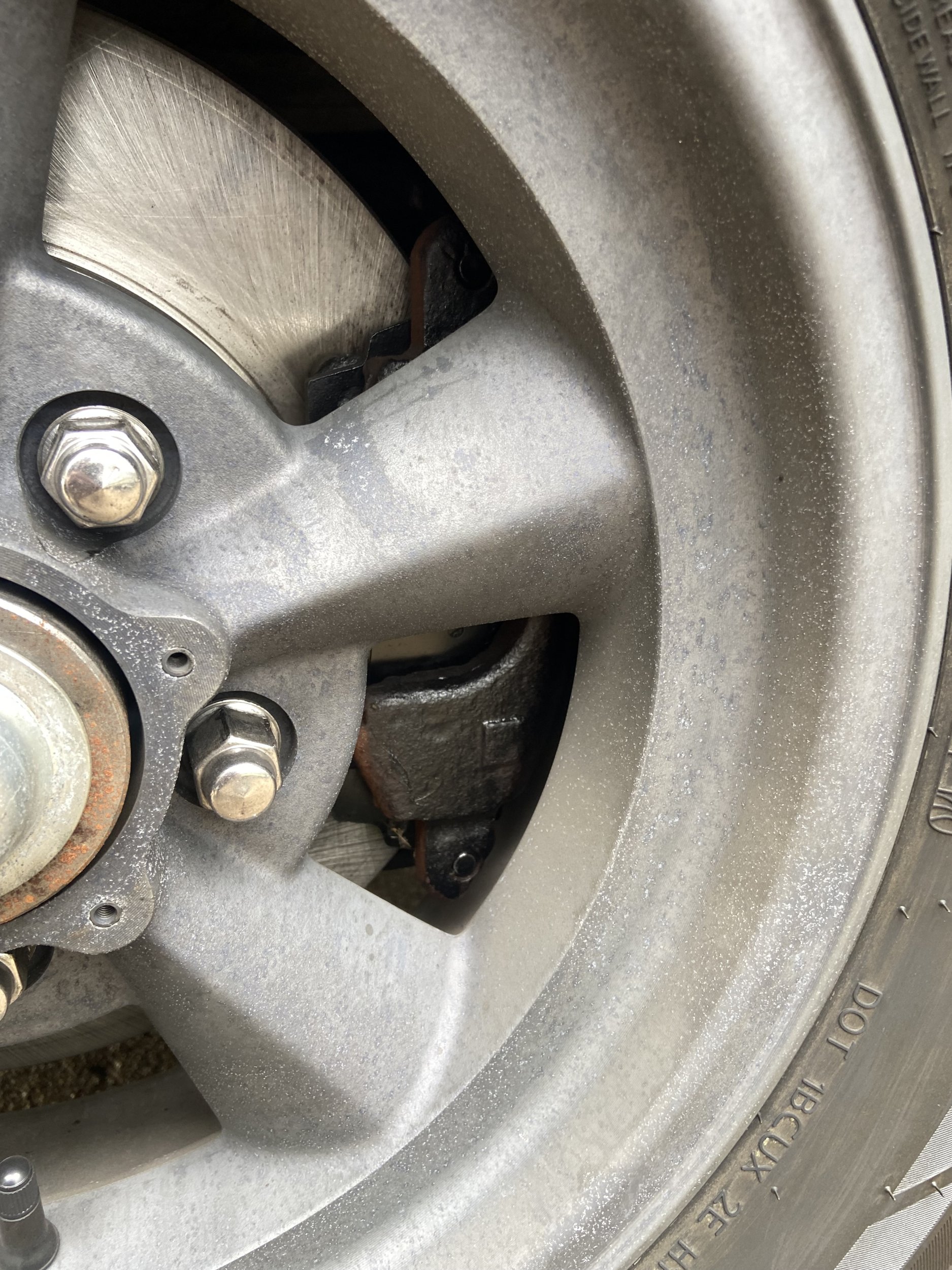

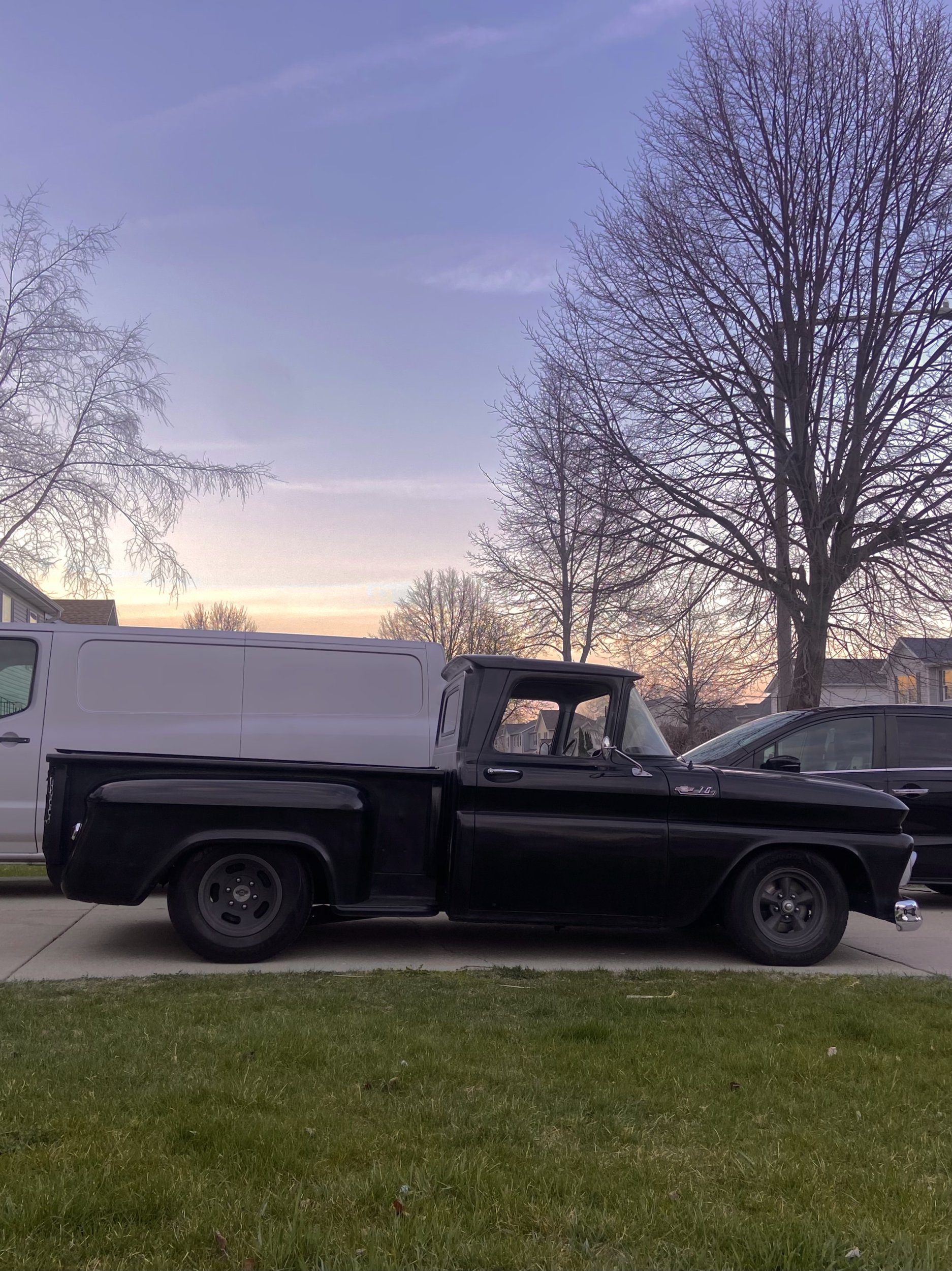

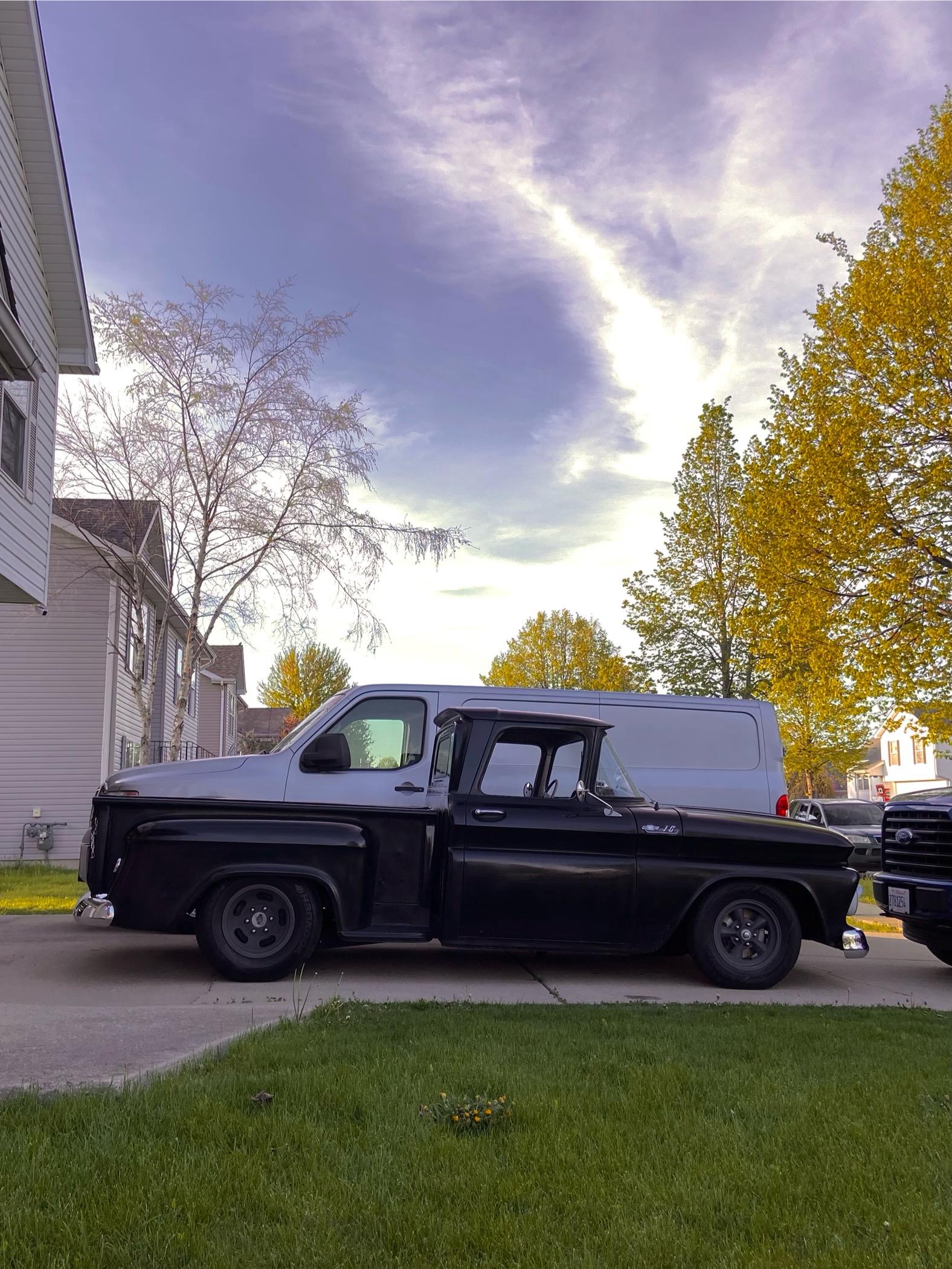

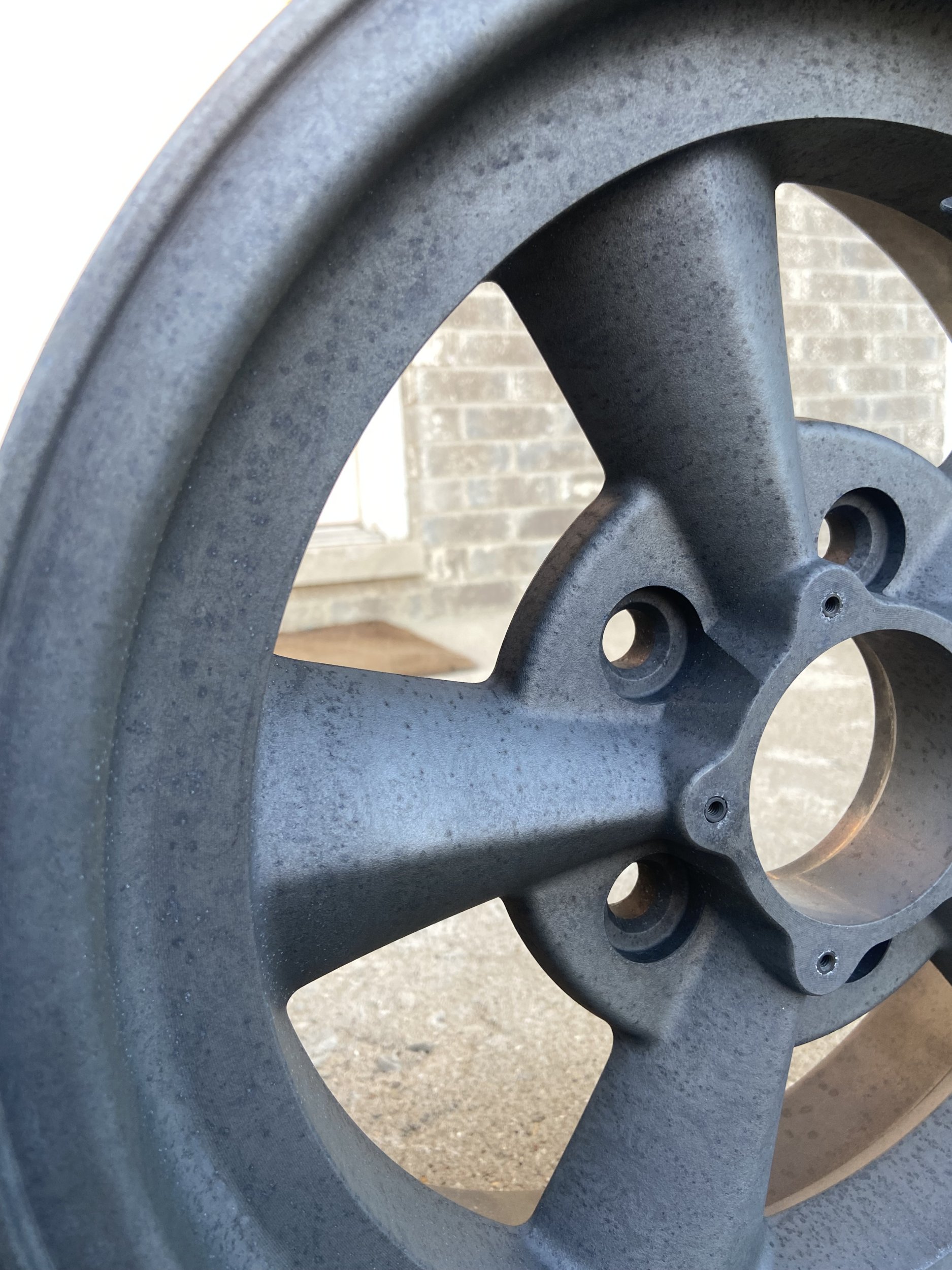

    Well 3 month update, they continue to get nice and crustier after driving a bunch in the pouring rain, hot sun, and even a spontaneous Illinois dust storm.
    Digging the new oxidation.

    I'm no expert, but that's looks real in your pics. Thanks for the follow up.

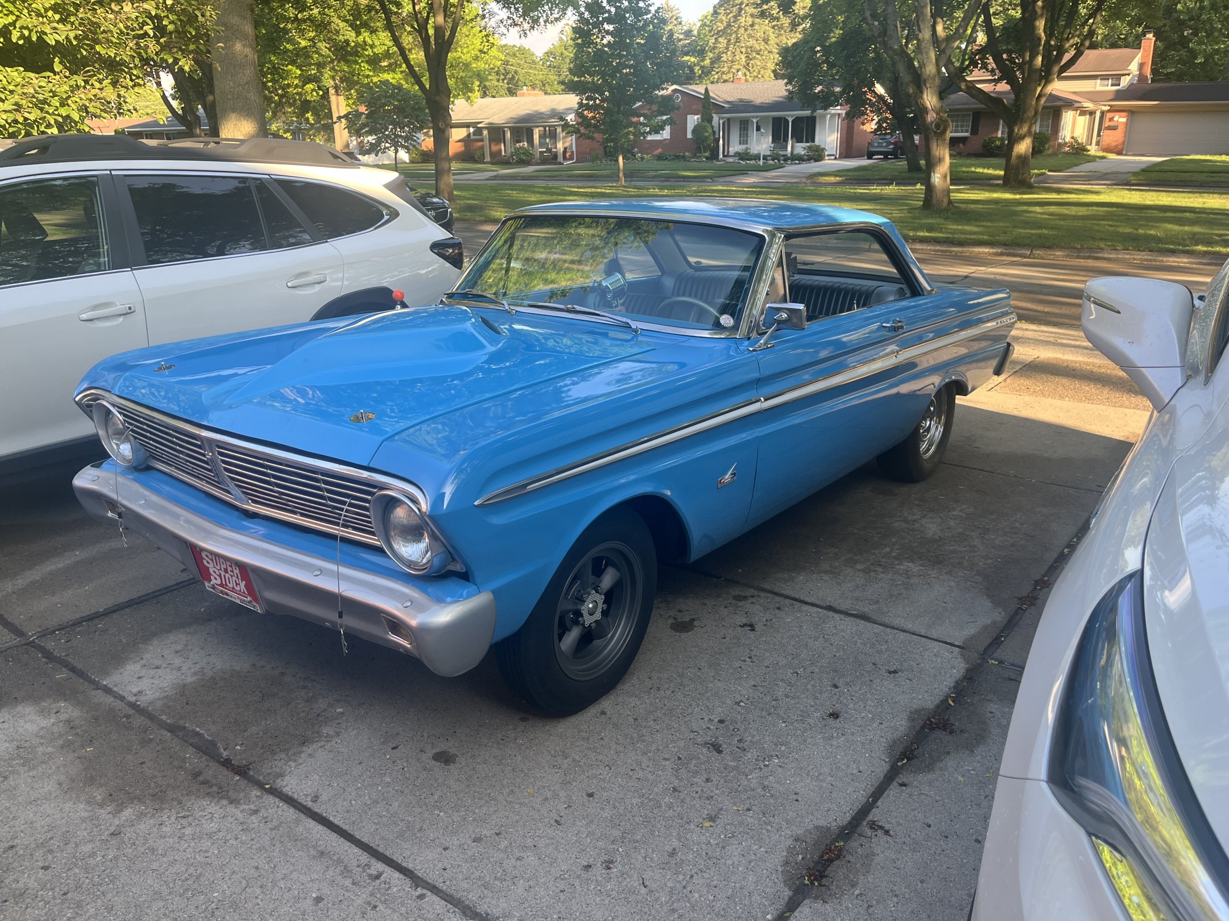

    IMG_2073.jpeg IMG_2081.jpeg IMG_2076.jpeg Mounted up the fronts tonight…
