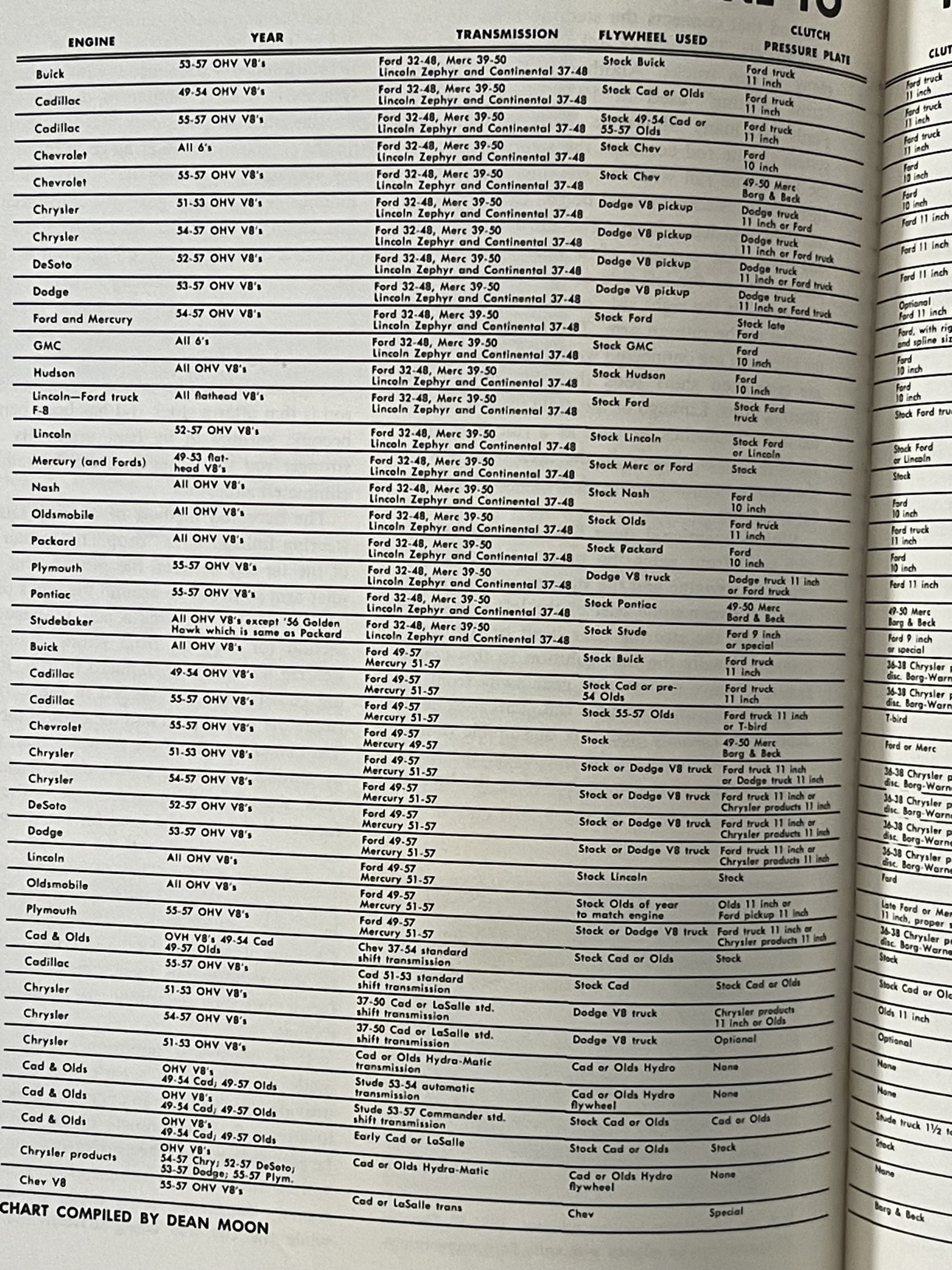

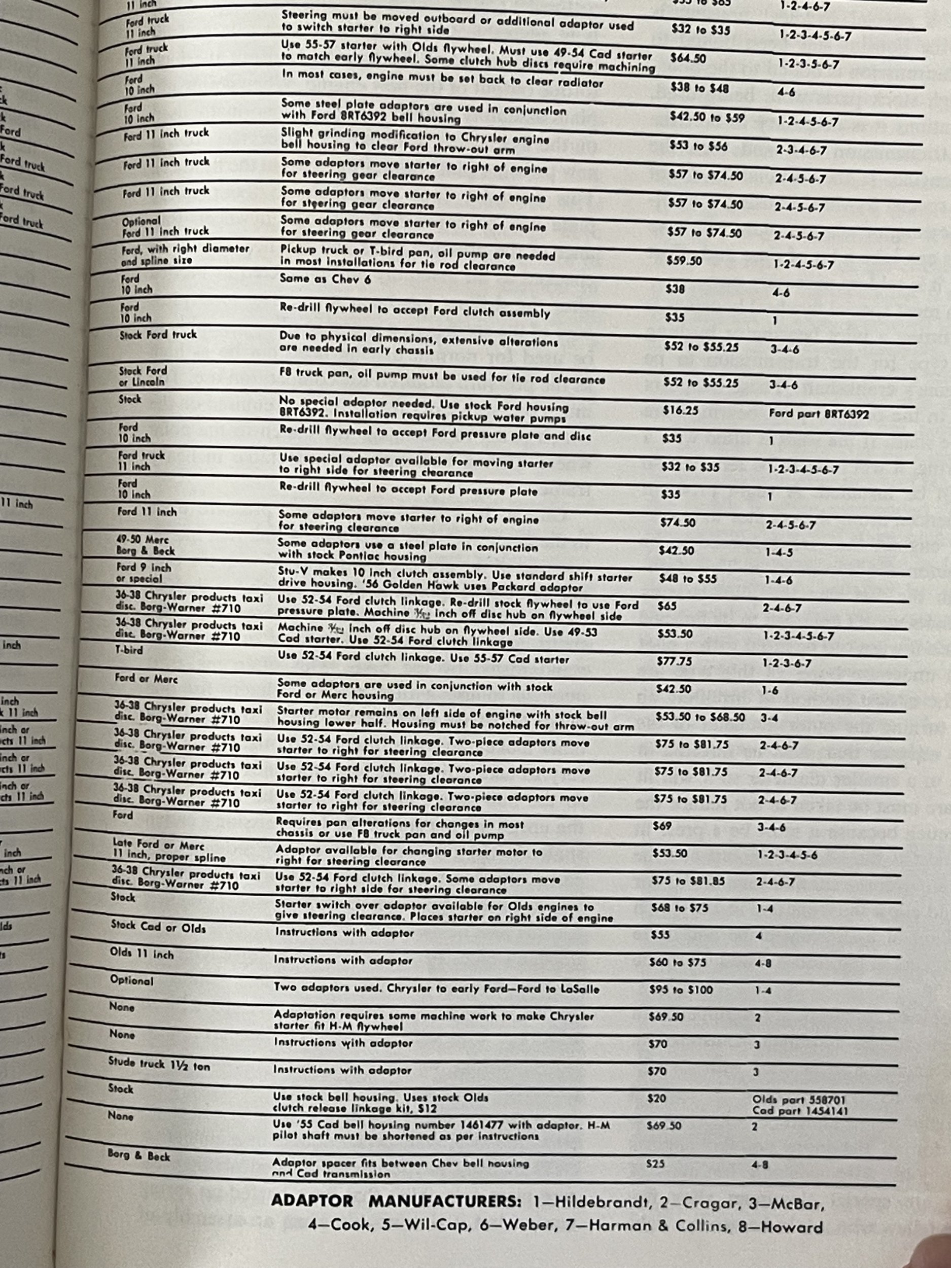

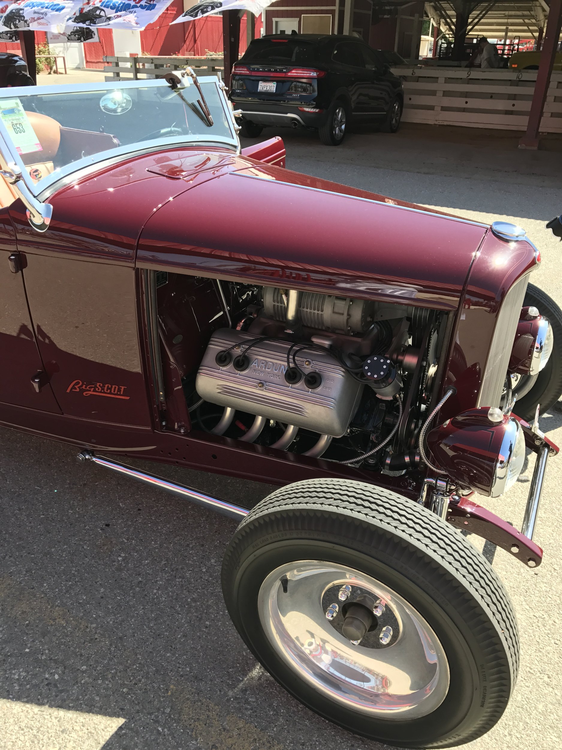

    Engine swaps, compilation of engine to transmission adapters
    From
    ‘The complete book of hot rodding’, c. 1959, Petersen. I got it as a Christmas present from my parents 1959, I believe. Still a good reference.

    In the late 60's and early 70's, my dad ran a shop out of our converted barn where we did cheap paint jobs, valve grinding and engine swaps. We did an amazing amount of work in that old shop. Dad bought a Hollander interchange manual (he called it the "Dutchman") and it was really useful in helping figure out what parts would interchange between various makes and models.

    Yep! My copy is well worn since I first bought it new in the 70's!
