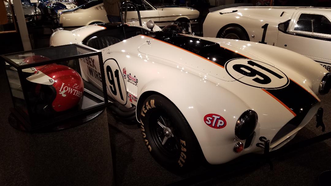

    I got bitten really hard in '67 when a gentleman named Ed Lowther let me sit in his 427 Cobra at the Glen 500 road race, with it running- the race required a pit stop and driver change, and he was practicing the switch with Dr. **** Thompson, "The Flying Dentist". Saw my standing there with my mouth hanging open and waved me over- I still have the race program. Also got to ride in a '64 Galaxie 500 with a 427-8V that same summer, ran out of road at 110- first experience with glorious "intake roar"

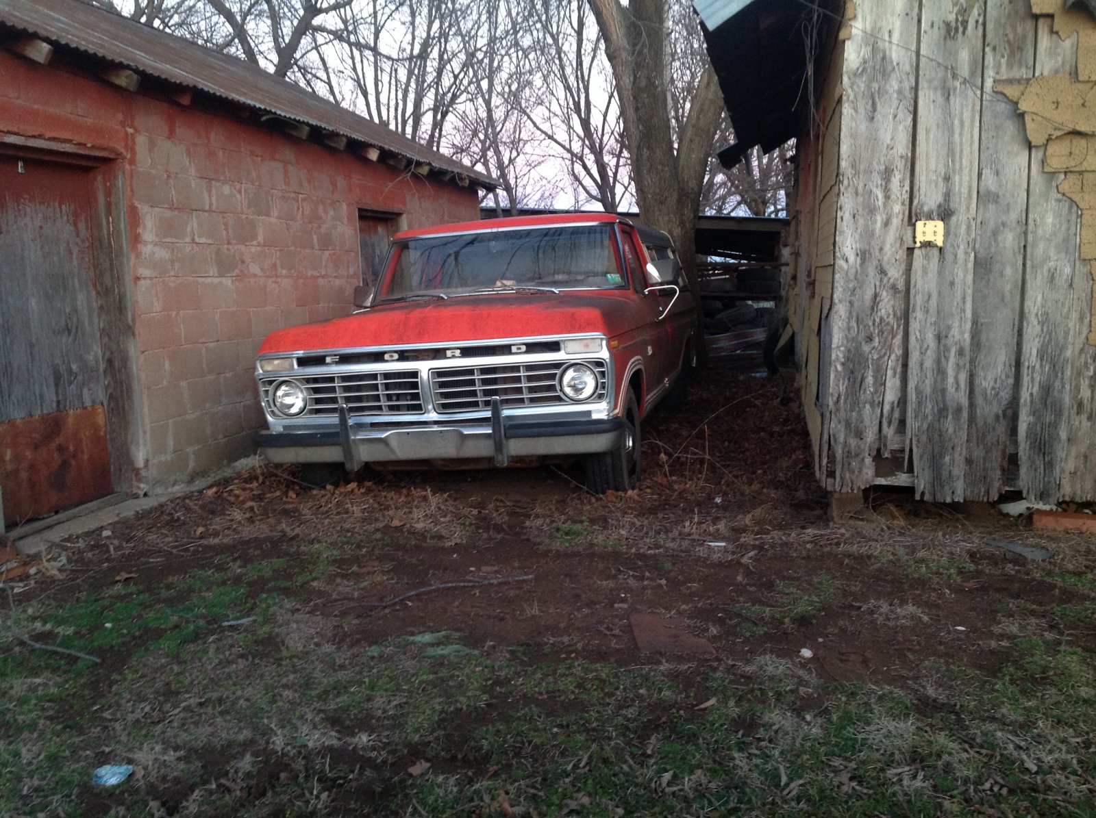

    Just a little clarification, not all heads have the exact same eight bolt pattern. The so called” GT” heads have a unique bolt pattern and regular FE headers and exhaust manifolds will not fit. That is one of the many things folks need to look out for while building an FE.
    I ran into this problem , back 25 years ago when I built a 416 for this truck!
