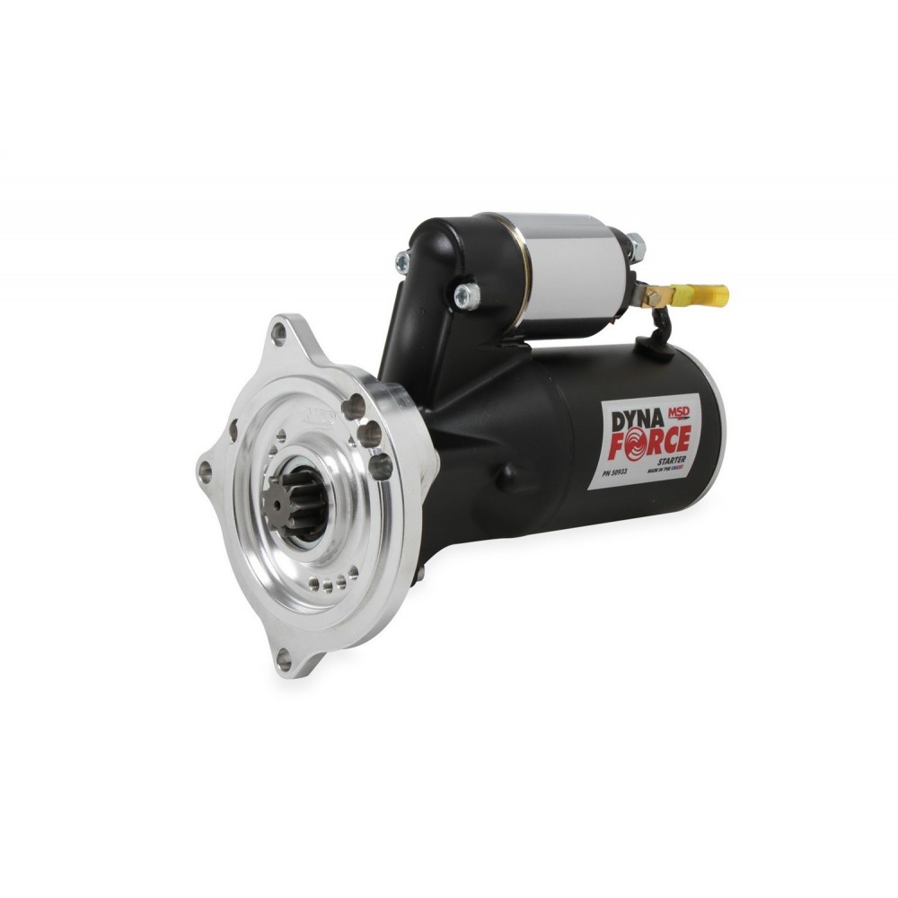

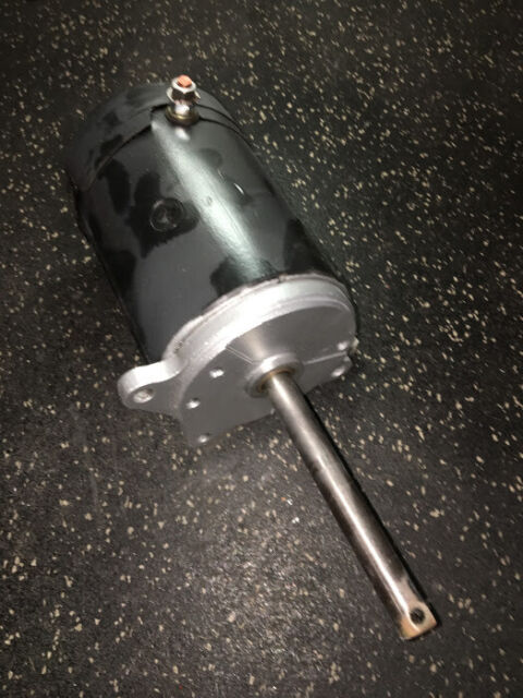

    The bell housings were changed in 64 I believe. I scored a new in the box MSD high torque starter only to find that it did not fit my 61 wagon. :(
    Early/late
