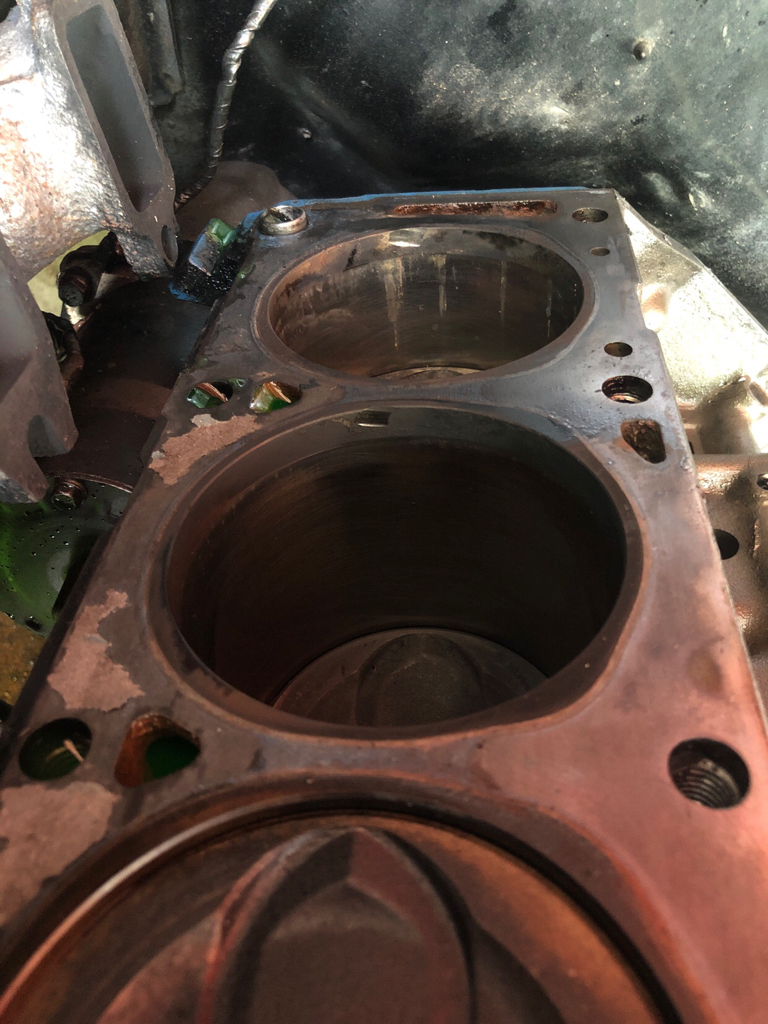

    So my my 390 in my galaxie started burning a little coolant on the right bank. Pulled the heads suspecting a bad gasket. During inspection I find these tool marked on the firewall side of cylinders 3/4 and 7/8. Anyone recognize what they might be from? Cylinder 4 was ****ing coolant su****iously close from that mark. They supposed to be there? I’ve never seen them on a block before. [​IMG][​IMG]

    from the valves rubbing the block?

  3. Has the block been sleeved. looks like a stake to hold a sleeve in position?

    Do the valves in those two have a shiney rub mark that would match the cyl? I've never seen any marks like that before. Maybe to large of valve?

    Ya, no valve issues, Valves are well within the bore. It’s a new one for me.

    My first thought was a sleeve installed aggressively.

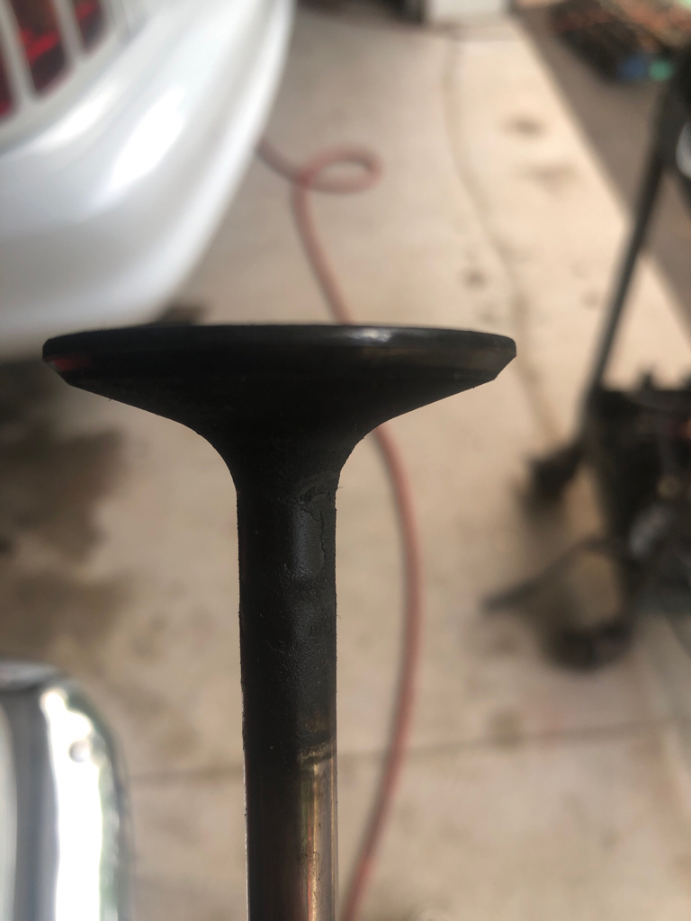

    Pulled the valve, and you can barely see it, but yes valve was rubbing. I guess CJ heads don’t clear a .030 over 390. Funny it was only the back 4 cylinders.

    Further investigation reveals the 428 Cj heads have had 1.75” exh valves installed, stock should be 1.65” hence the rubbing. Always measure twice!!! Lesson learned.

    Check your valve sizes. It looks to me looks to me that there oversize. Stock CJ valves I believe are 2.090 / 1.650. Some people used to put 427 valves in and port the heads. I have run 428 CJ heads on stock bore 390 without any problem.

    Yup, measured them, someone installed 1.75” exh valves.
