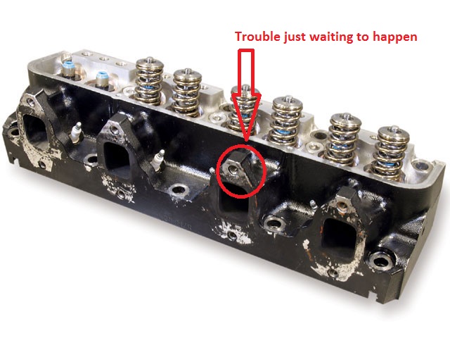

    The top bolts on the exhaust ports are not blind holes and thus the engine is a poor design...reallly???

  12. GregCon
    Joined: Jun 18, 2012
    Posts: 689
    GregCon
    from Houston
    Really. It's got nothing to do with being blind or not - it's an issue of the holes being threaded into a tab that sticks up into the air, supported by very little. Do they all break? No. But I'll bet their incidence of breakage is not even close to being matched by any other period V8 engine. It's easy to sit at your computer and say that's no big deal but when you have a car that you can't drive without shame, or get inspected, due to the constant exhaust leak then it's a real problem.

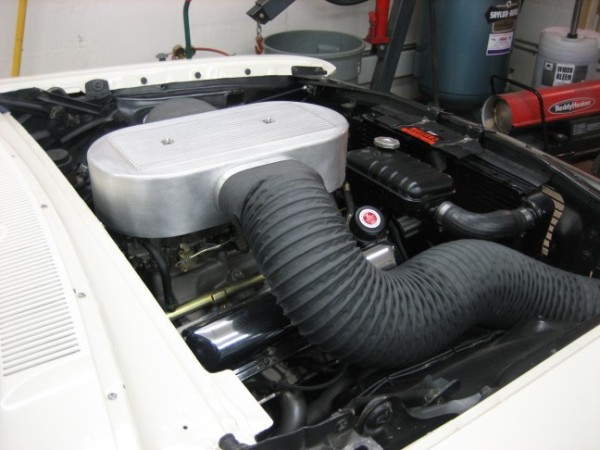

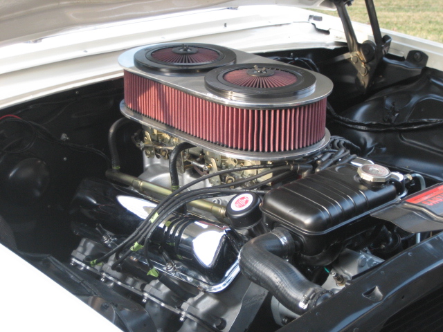

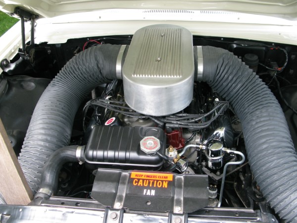

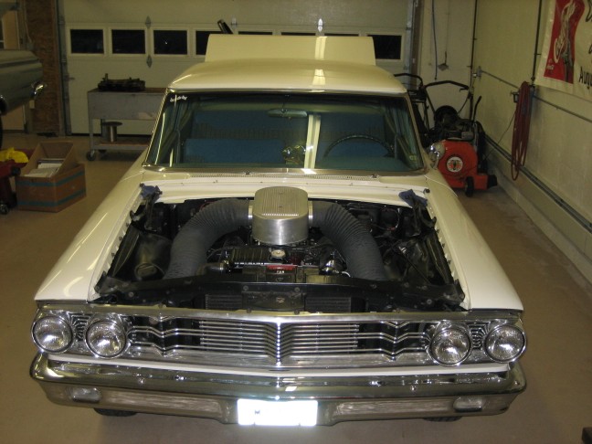

  13. hyperfe
    Joined: Jan 30, 2009
    Posts: 72
    hyperfe
    Here is my sideoiler with a filter setup and a homebuilt air bonnet. Also 1964 cop car 390/330 going in the Falcon
  14. Troublemaker427
    Joined: Jun 27, 2006
    Posts: 2,014
    Troublemaker427
    Awesome cars Hyper!!
    Check out the link to the event I'm helping with....
    http://www.fairlanet.com/FE/
    We'd love to see you there...
    There will be tons of overweight FE's there....:rolleyes:

  19. hyperfe
    Posts: 72
    hyperfe
    Yep, 4/27/13 already marked on the calendar, going to Carlisle Spring meet and then over to your show. Is this a great country or what! Jim M

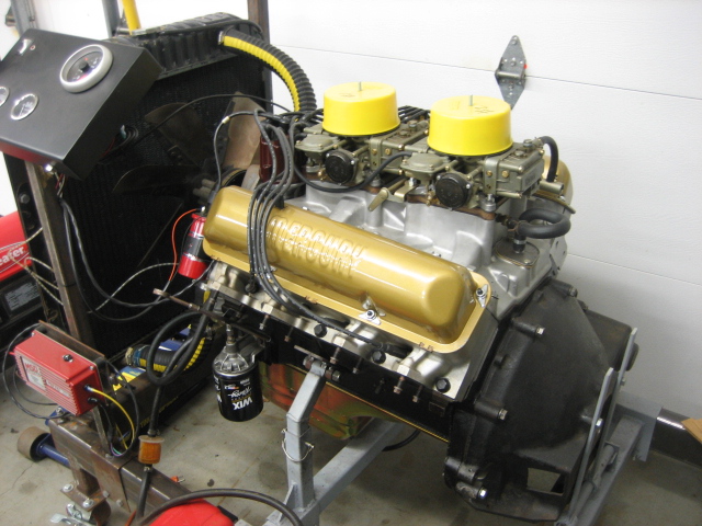

  20. hyperfe
    Posts: 72
    hyperfe
    The word's out, this swap as simple as they get.

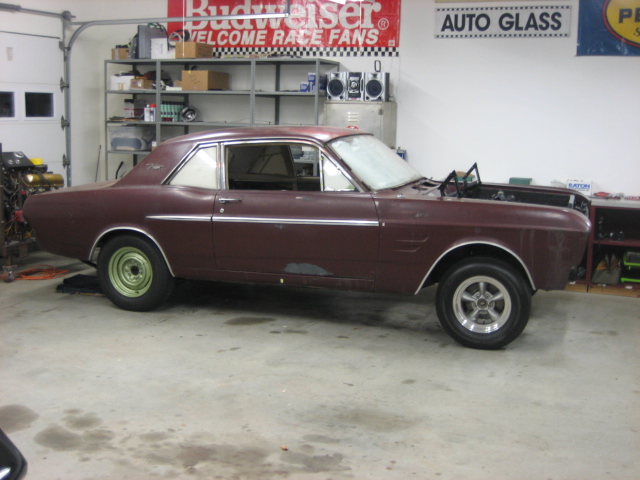

  22. hyperfe
    Posts: 72
    hyperfe
    Hope to have the Falcon ready for that meet, I might get lucky and have the 428/482 bullet Blair Patrick is finishing up for me in there for some shakedown runs. We'll see what happens. Jim
