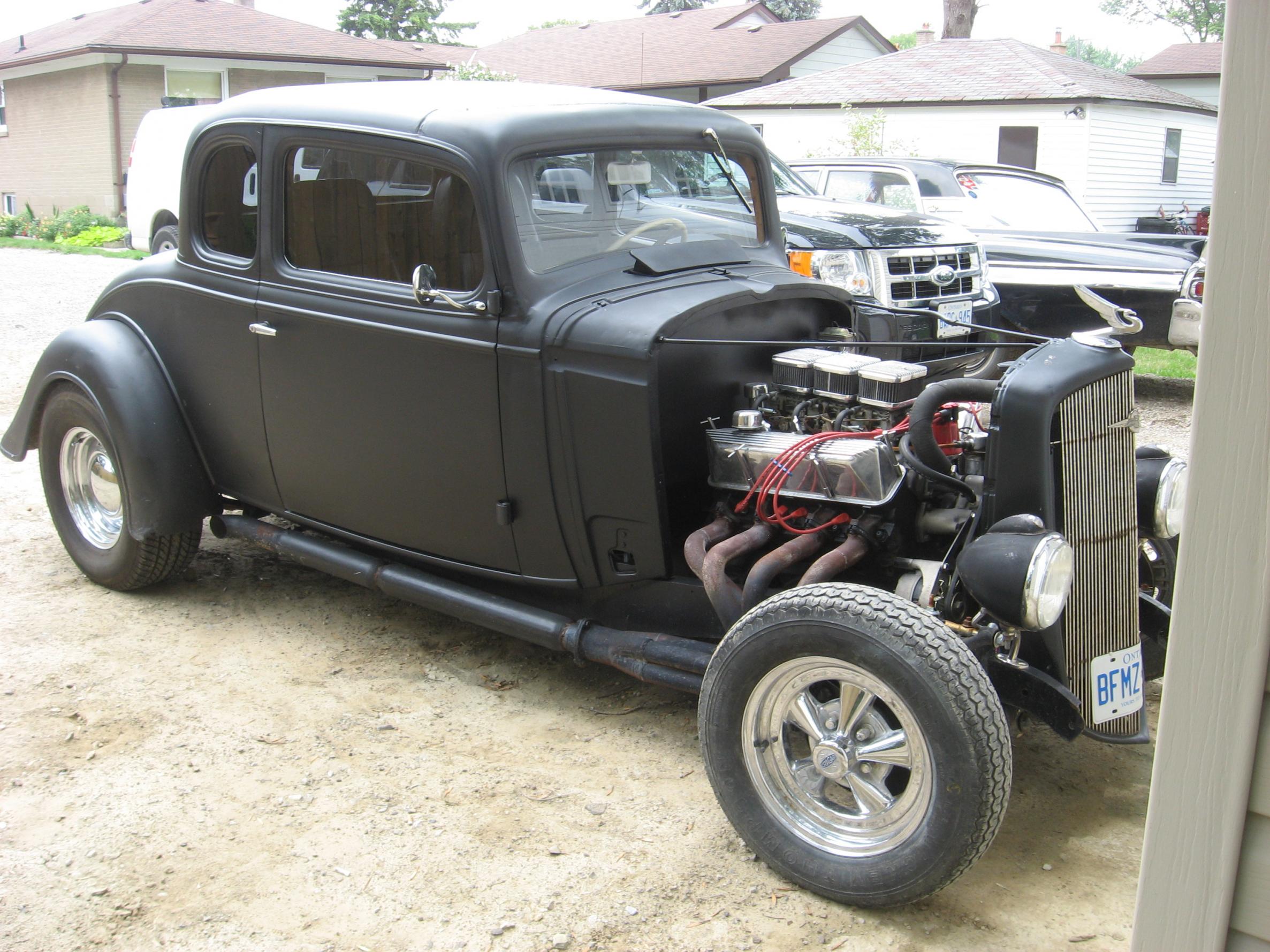

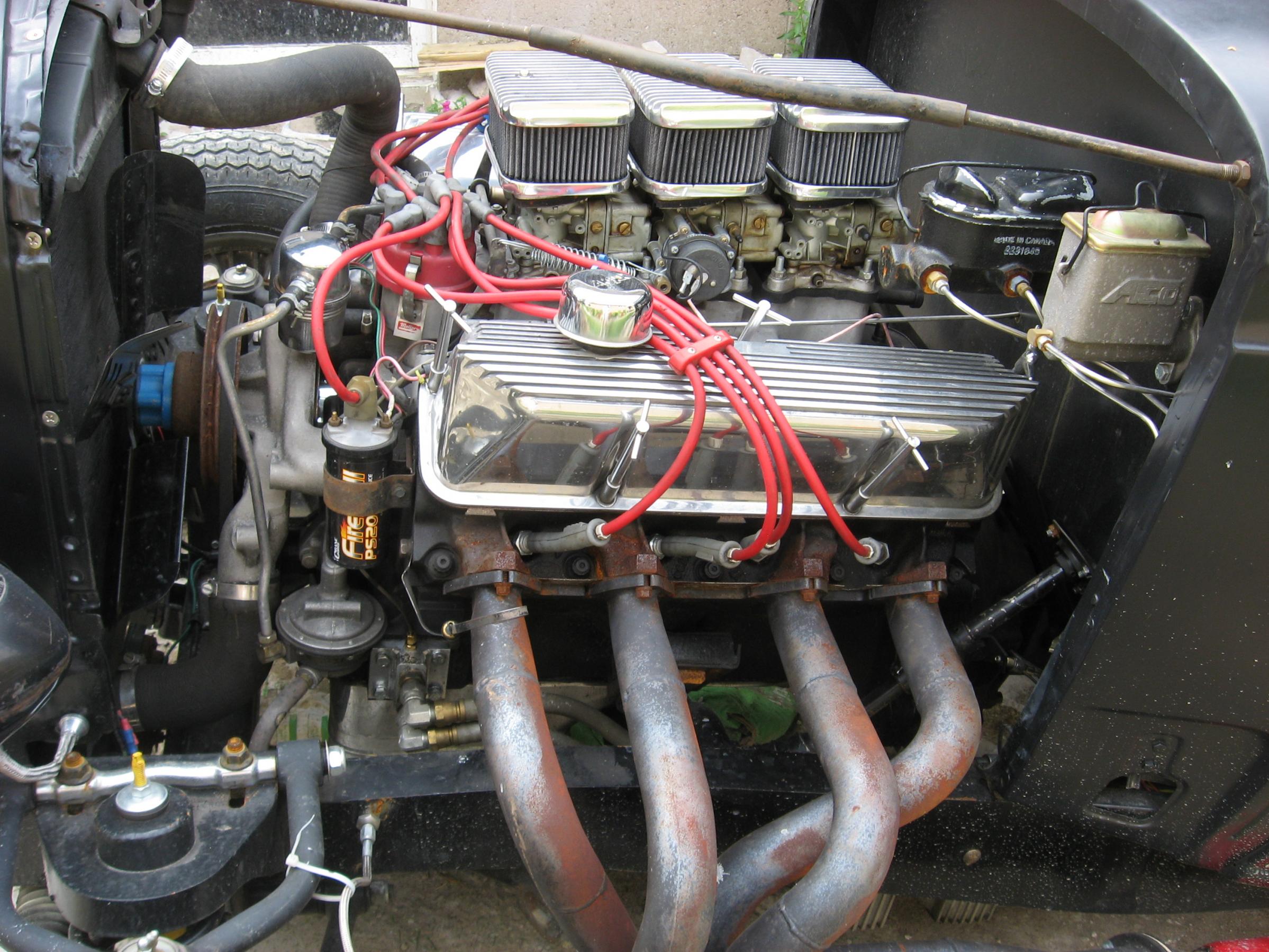

  14. Here is my 34 chev 5 window with a 61 390 hp and toploader 4 speed
    It is a full solid lifter roller motor tons of work done internally 10,000.00 to build 5 years ago
