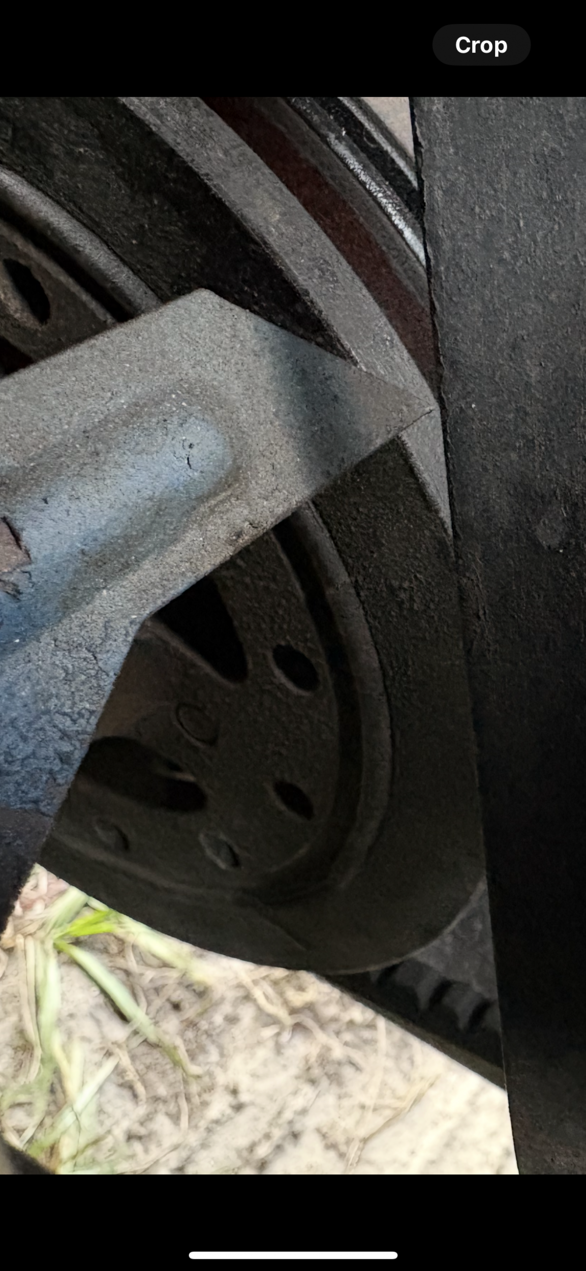

    On my 63 country squire there is a very rhythmic vibration from about 1000 rpm's through 1500 or so then it comes back in the 2000 rpm range but smoothes out after that as I'd expect from some sort or lower end imbalance. This is a stock 352 with stock cruise o matic. I've ruled out ignition and compression/ valve train issues as I've had both valve covers off recently and did a compression/ leak down test. It idles very smooth too with no noticeable "chuffing" from the single exhaust. Im sort of moving in the direction of the crank pulley but I don't think I'm dealing with a spun balancer but maybe just worn out rubber? The only visual indication I see of this is a piece of rubber sort of sticking out where it's vulcanized to the pulley. This is my first FE so I'm still learning but certainly not my first old car. Just wanting to see how much that pulley has to do with engine balance/ harmonics. Doesn't seem to be much meat on it.

    Not sure if anyone can tell but there's a small flap towards the bottom sticking out. I'm ***uming it's also 62 years old. haha IMG_1204.png

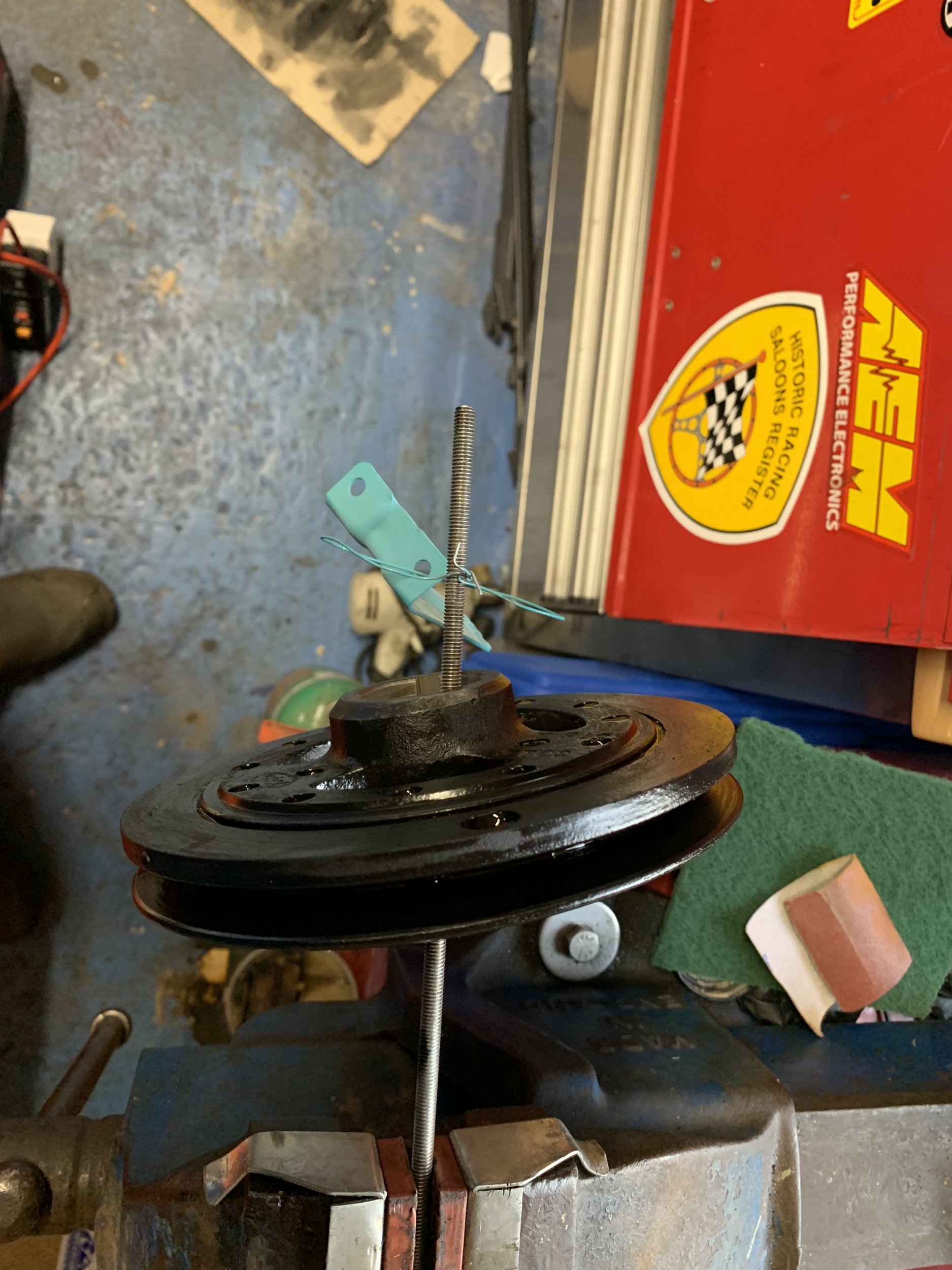

    I’ve got a 1962 and the rubber doesn’t bulge like that could just be a difference in the way they’ve been made IMG_6513.jpeg IMG_6581.jpeg

    Send it to the Damper doctor in central California for rebuild and balance…There’s also the Damper Dude in the same general area….

    Interesting, I'll get a closer look at mine tomorrow.

  12. No bushing. The convertor indexes directly into the crank. And I've seen much rattier dampers than yours run with no issues. As long as it spins true it should be OK.
