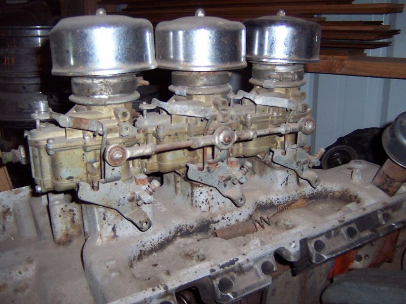

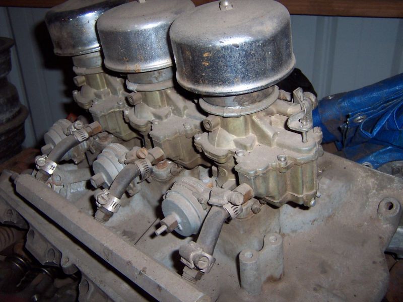

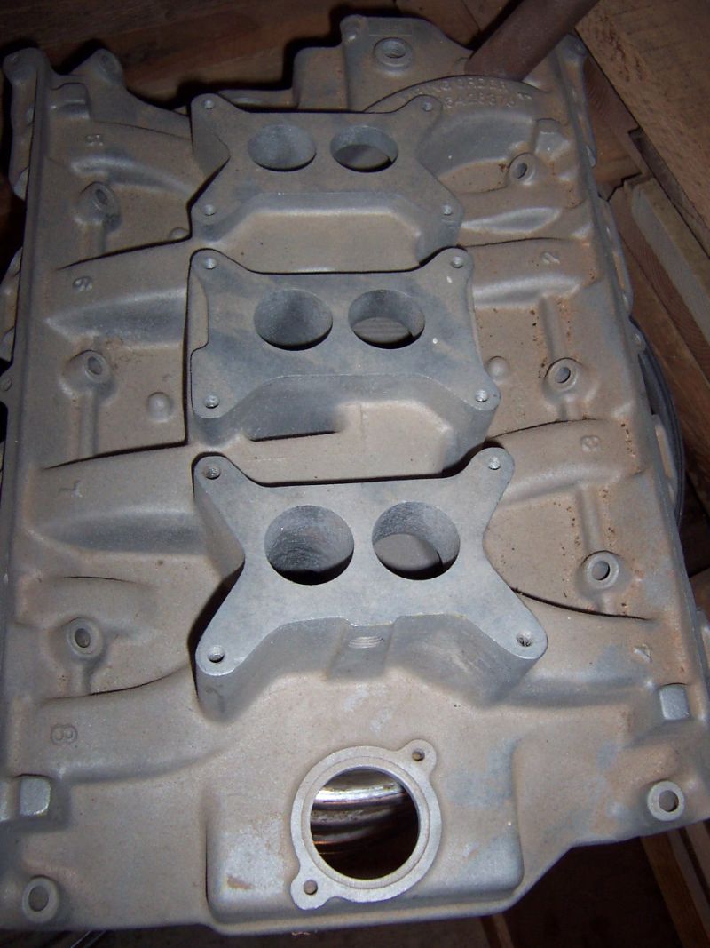

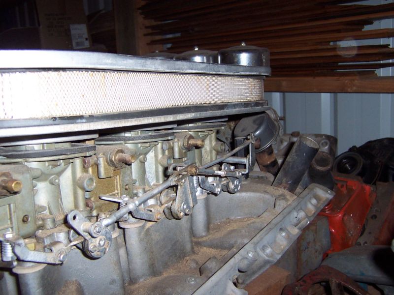

  11. Figure i'd chime in: attached are pictures of the 3 FE tri's i've got 2 are Ford's and the other is an Edelbrock F380 with the 4 bolt carb base setup (mine has 3 Stromberg WW's)
    The 2 Ford manifolds have no provision for a Trans kickdown so out of luck there. The complete setup I have has the carbs progressive linkage on the passengers side and the footpedal rod on the drivers side probably running from a firewall mount. The bare manifold also has no provision for drivers side mounts.
    The Edelbrock F380 does have2 mounting pads behind the back carb but the 3 positive carbs have no drivers side activation provision. Seems to me the 2 pads were for accelerator mounts and possibly an auto kickdown. Hope this explanation and Pic's help
