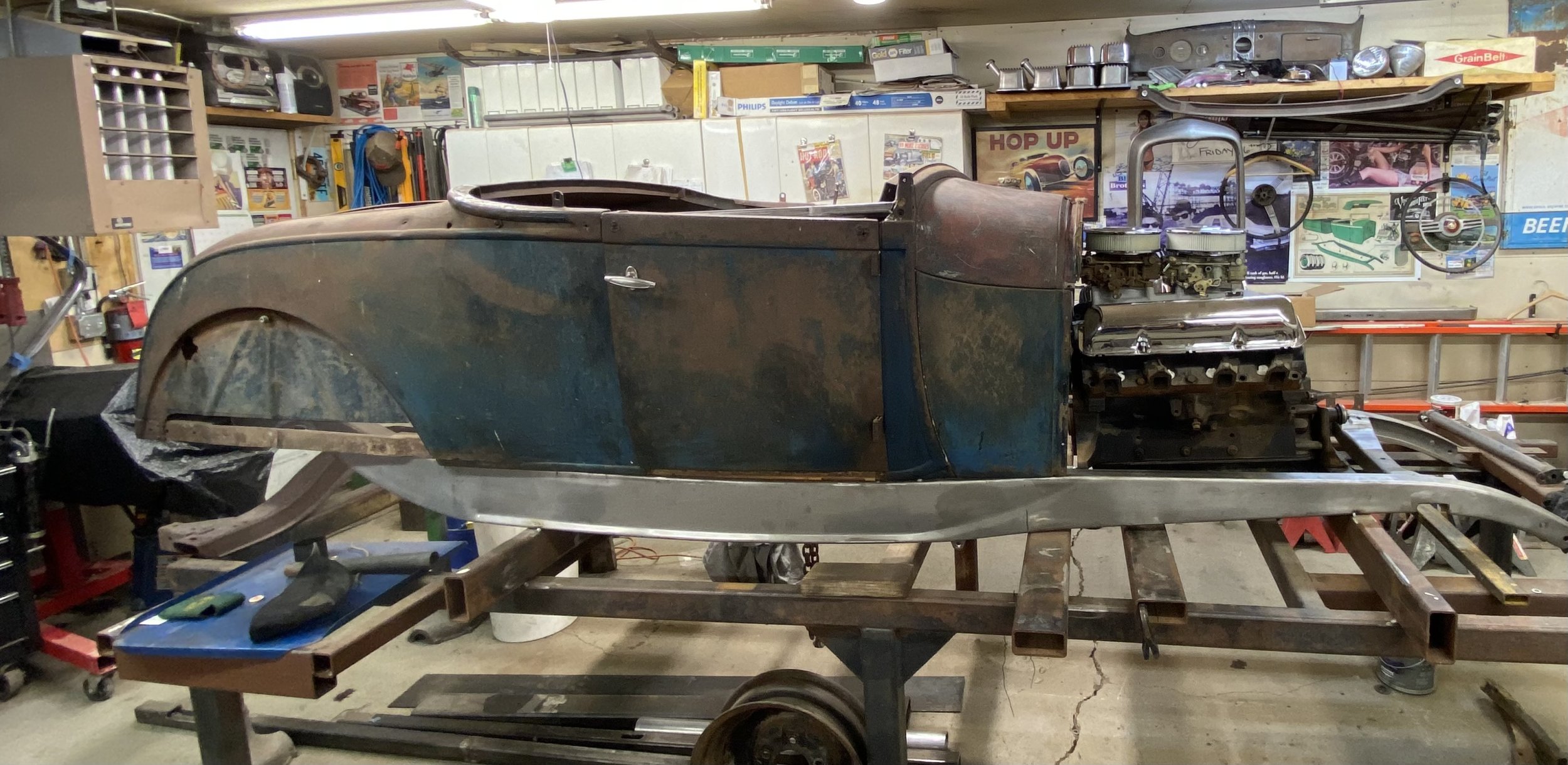

  14. Well, that's you. It's not the way he wants to do it. Kinda like when I did a Blown 392 with a 3" belt drive in my 40 Coupe. Total stock firewall and stock mounted Rad. I was told it couldn't be done, Wrong!
    And, it runs a manual fan mounted off the Crankshaft like they were designed to be. This photo was taken in the mock-up stage just to make sure I could do it.
