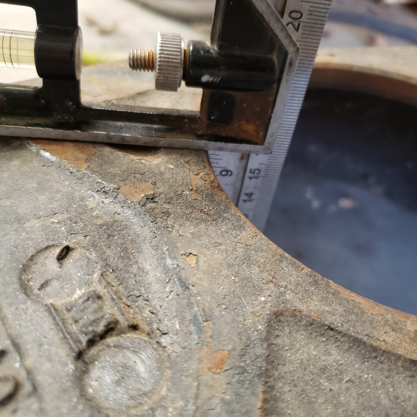

    OK, flange to flange, the C5TA-7505-B pickup bell is 6.8", and the car "hump" bell is 6.45", so sayeth Mi***oyo

    Looks like 6 3/4” was right. Ruler and a flashlight. ;)

    "So what I'm after is actual accurate measurements of bellhousing depth" Hence measuring to the shop floor with calipers, 6.8" ;)

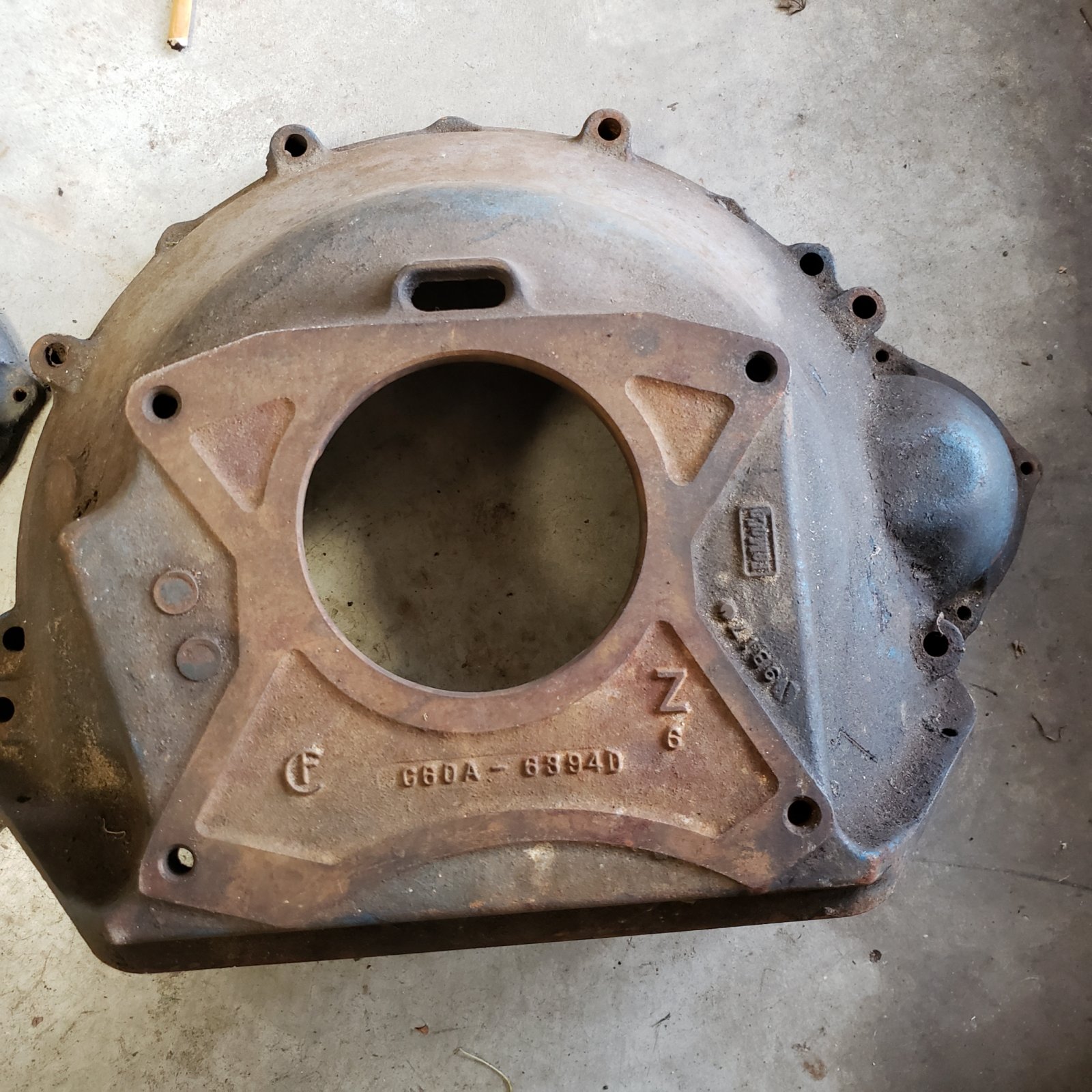

  24. The c5 bell is 390 fe car ,6 1/2 inches deep
    The c6 Z bell is also 6 1/2 inches deep ,but will accept an 11 inch clutch .

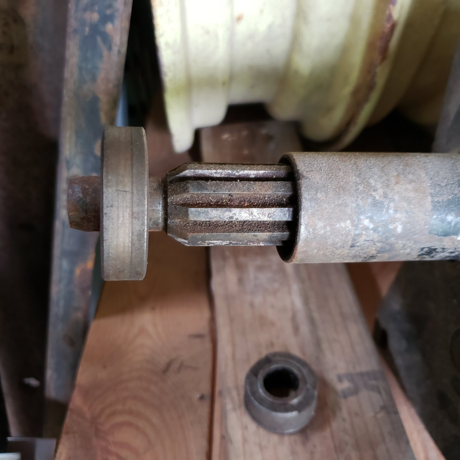

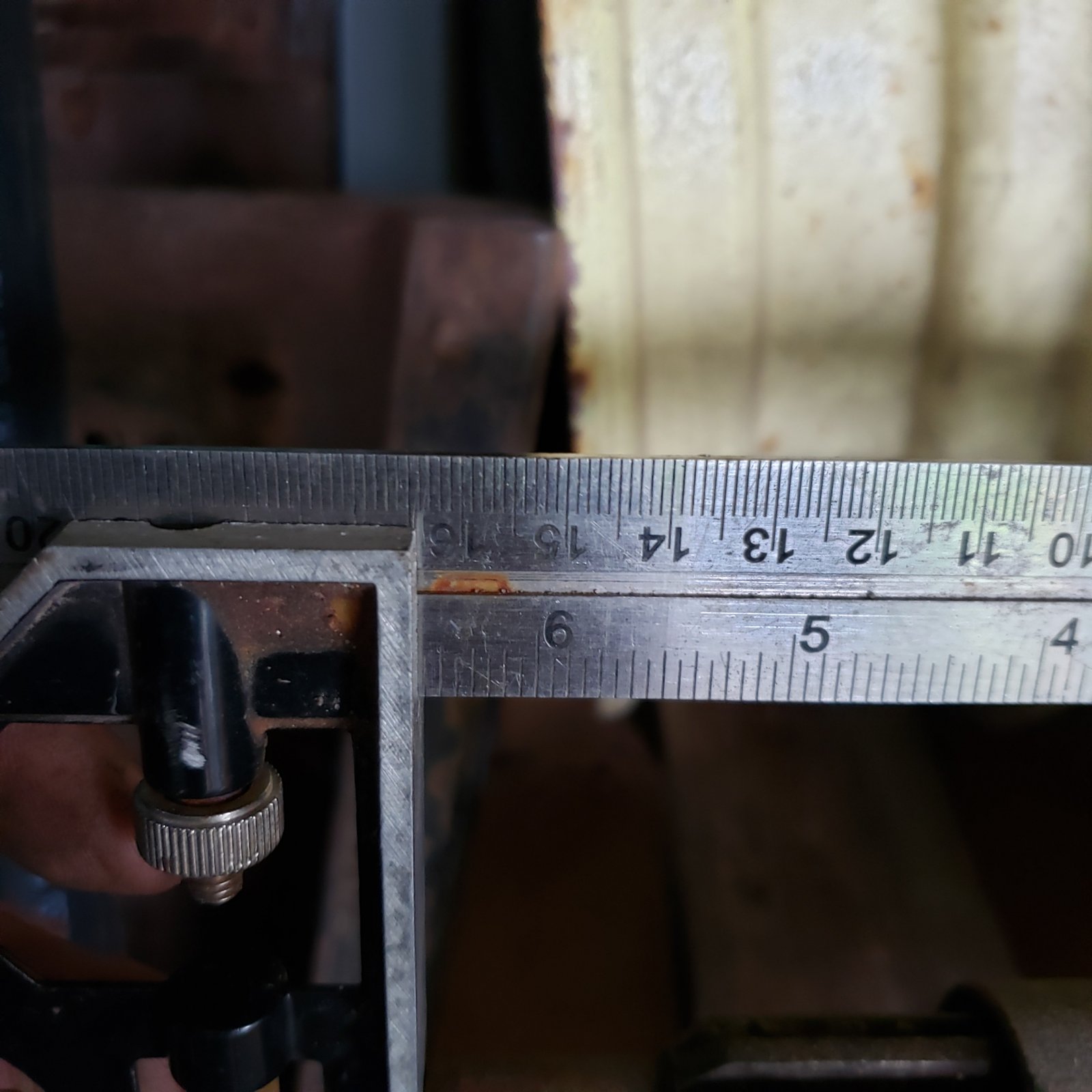

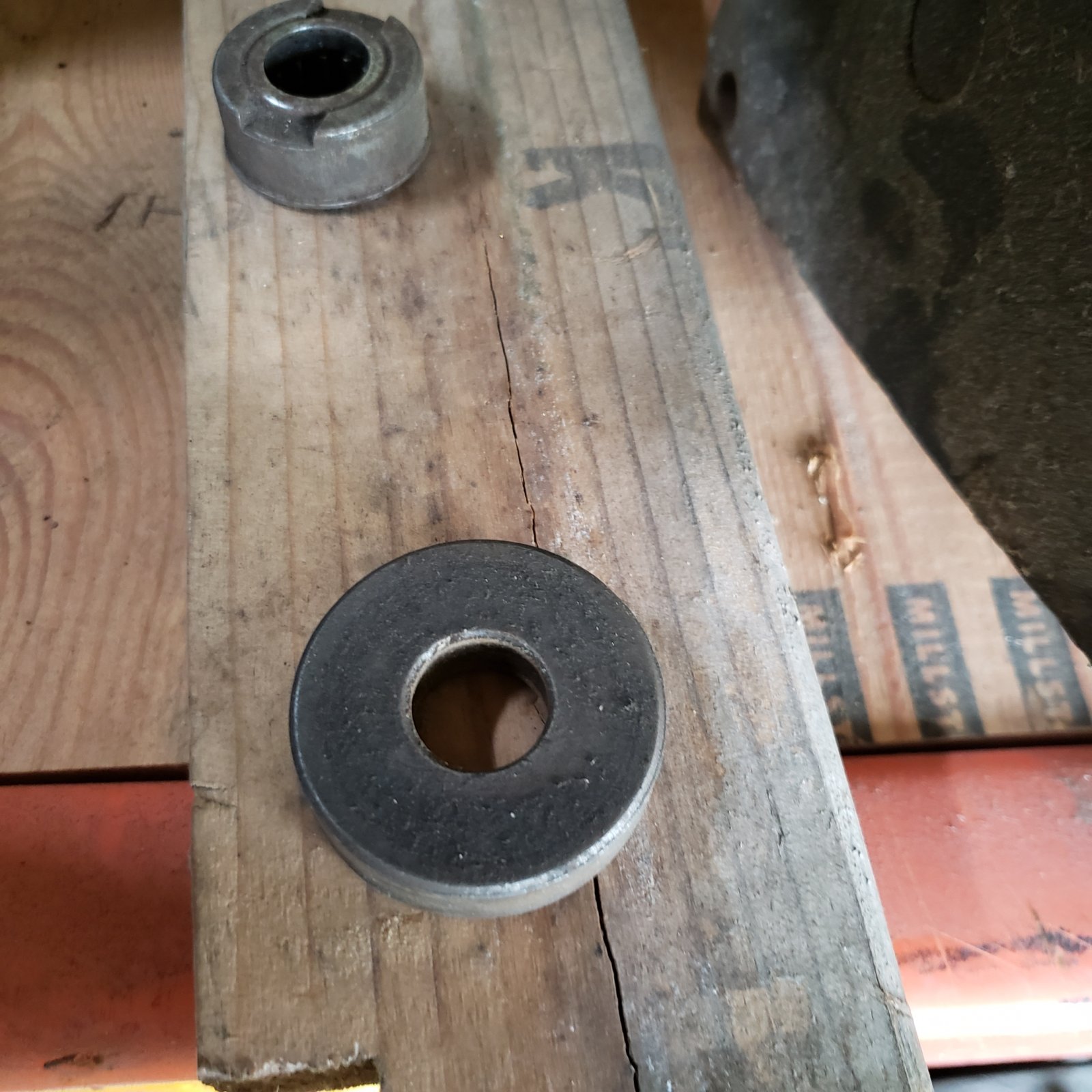

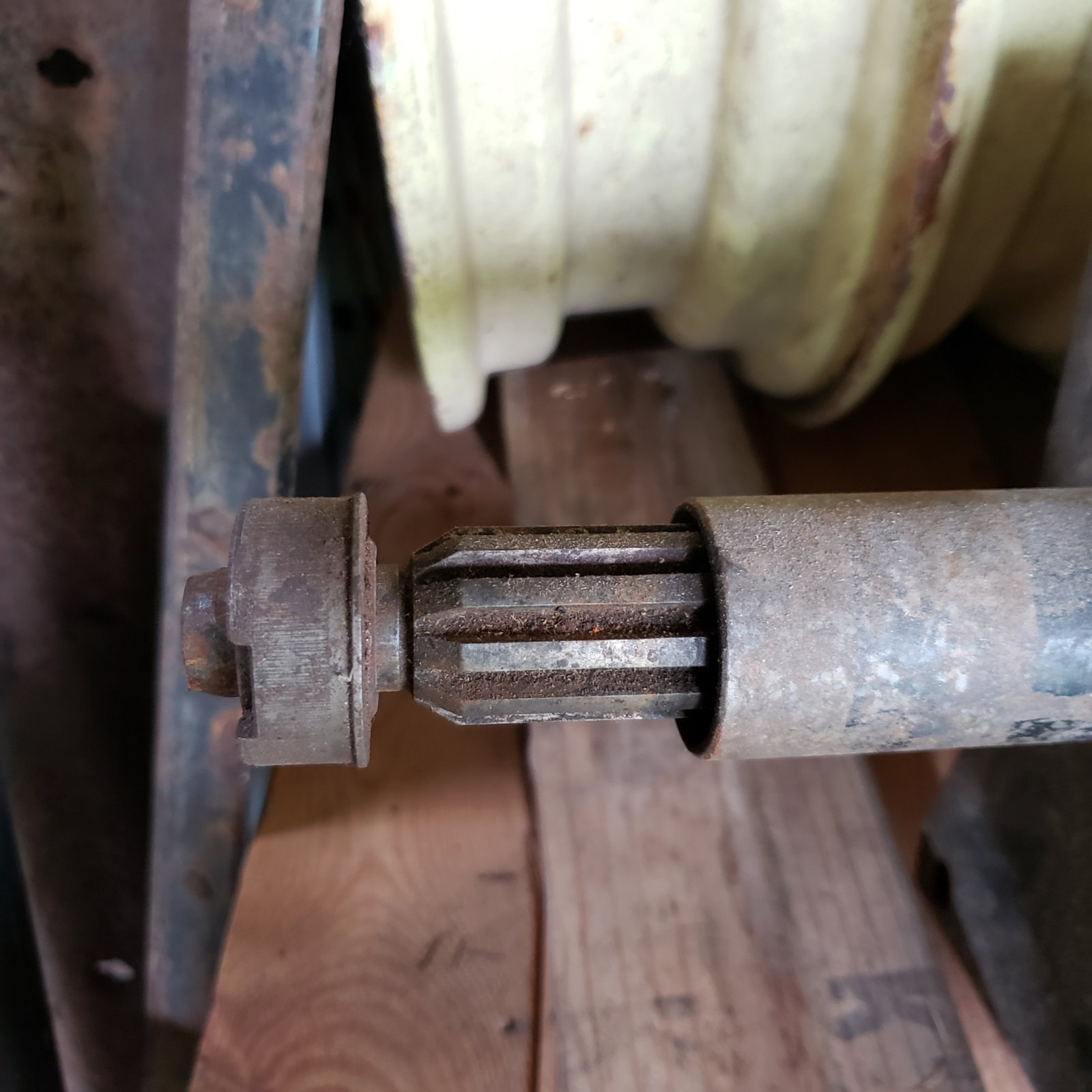

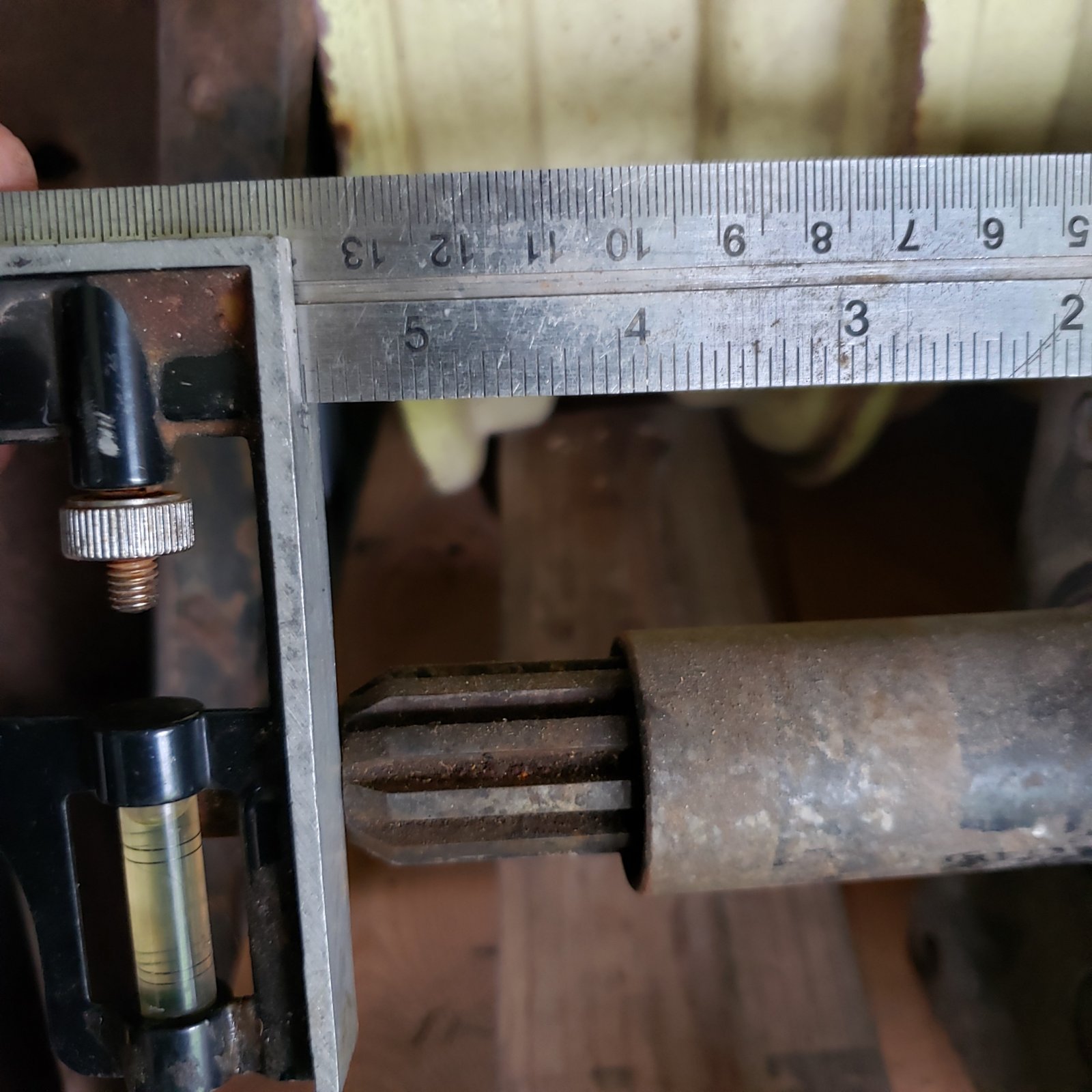

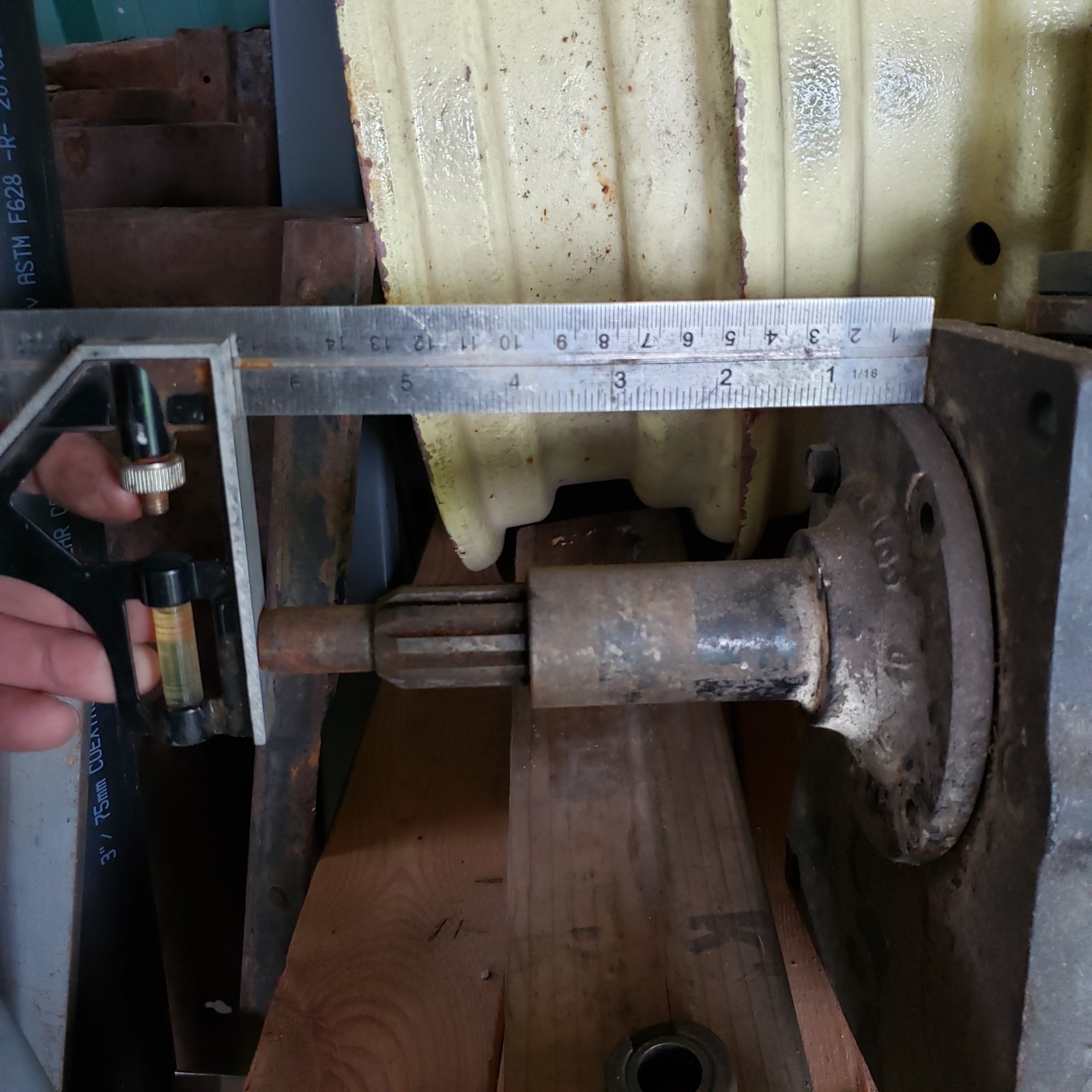

  27. A spare car SB toploader that I have measures 6-1/2" from the case front to the end of the shaft. Throwout sleeve is 2-7/8", splines 1-1/2" and pilot 1-1/4"

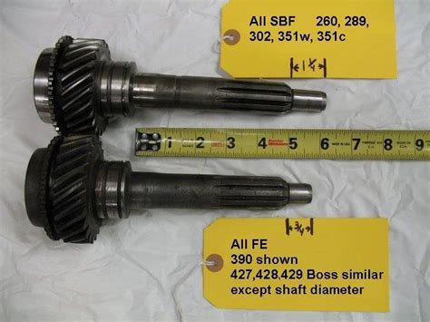

    There are two (2) top Loader 10 spline input shaft types, 1 3/8" and 1 1/16" (Standard). The larger dimater shaft is intended primarily for BBF applications.

  29. Great! Now if the truck trans measures the same, the mystery is solved!
