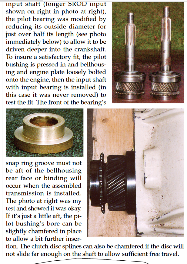

    With a bit of fiddling you may well be able to accommodate the longer input shaft with the regular depth bellhousing.
    I used a long input shaft with the stock, short bellhousing by machining the pilot bushing so that it would seat deeper in the crankshaft, and this combined with the long length of the clutch splines allowed the setup to work.
    Here's an image and some explanation from an article I wrote for the "Fairlaner" magazine some years ago:
    [To accomodate the SROD’s longer]
    Note that the longer (SROD) input shaft has longer splines, which are long enough so that the clutch can still have sufficient room to move.
    I've put many satisfactory miles and a few years on this setup.
    Deuces and loudbang like this.
