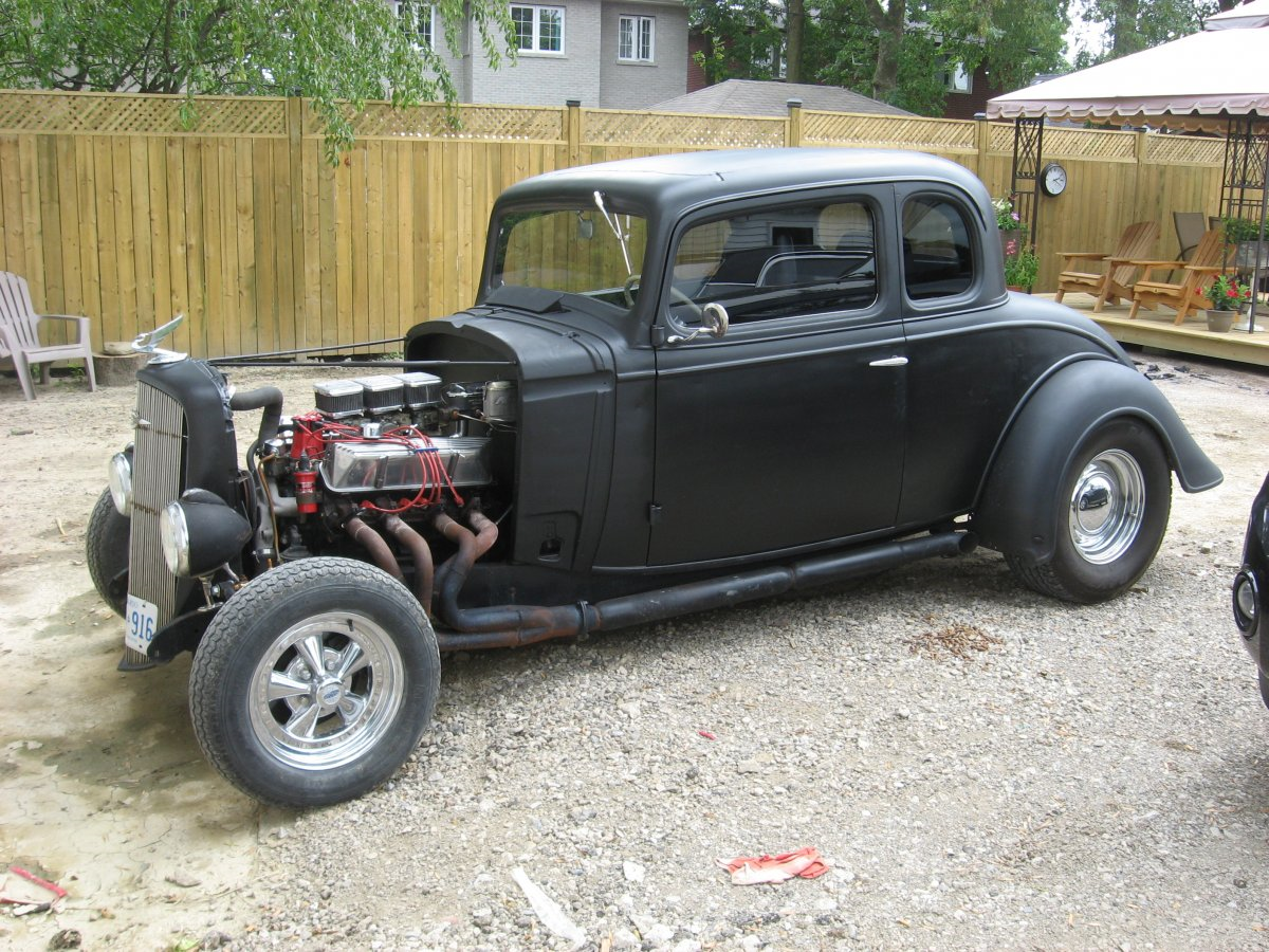

  10. Not a 34 ford , but fit good in my 34 chev ,actually the chev was on a 34 ford frame .

    Looks cool. A Ford in a Chevy! Well maybe, is it registered as a Chevy or a Ford? A '34 Ford has VIN/SN on frame.
  12. An FE in a '34 Ford coupe is as good as it gets.
  13. aftermarket 34 ford frame ,body has Chevrolet tags and ownership

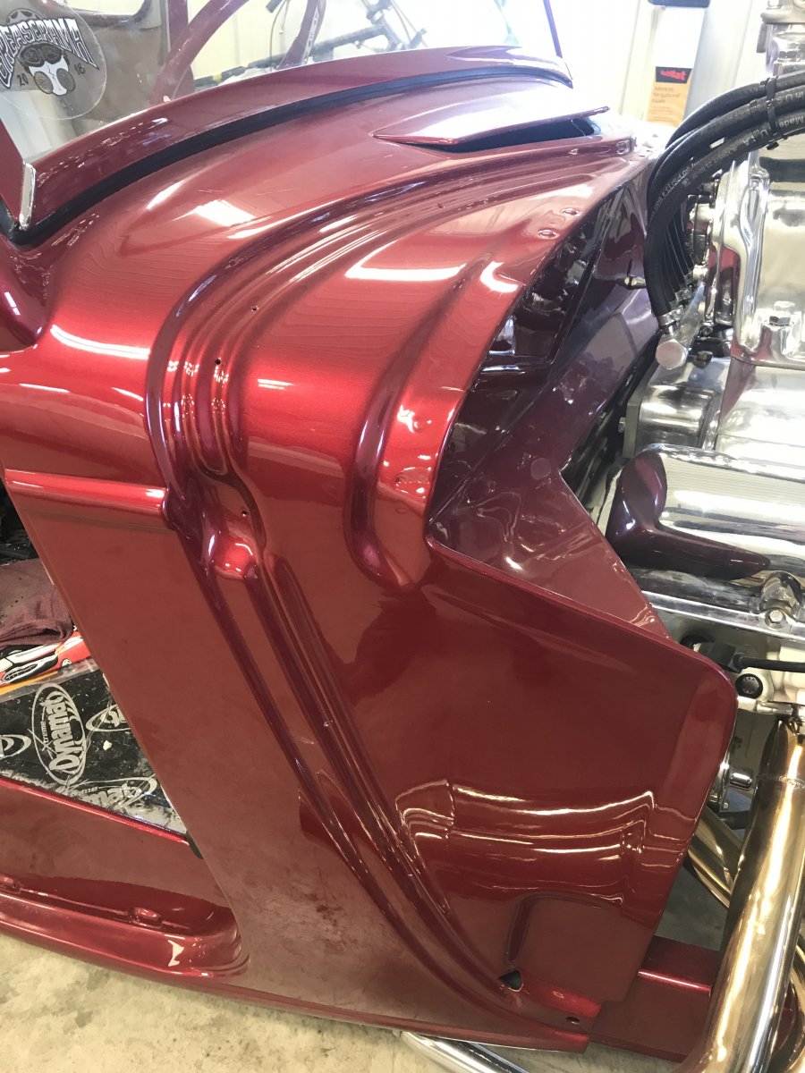

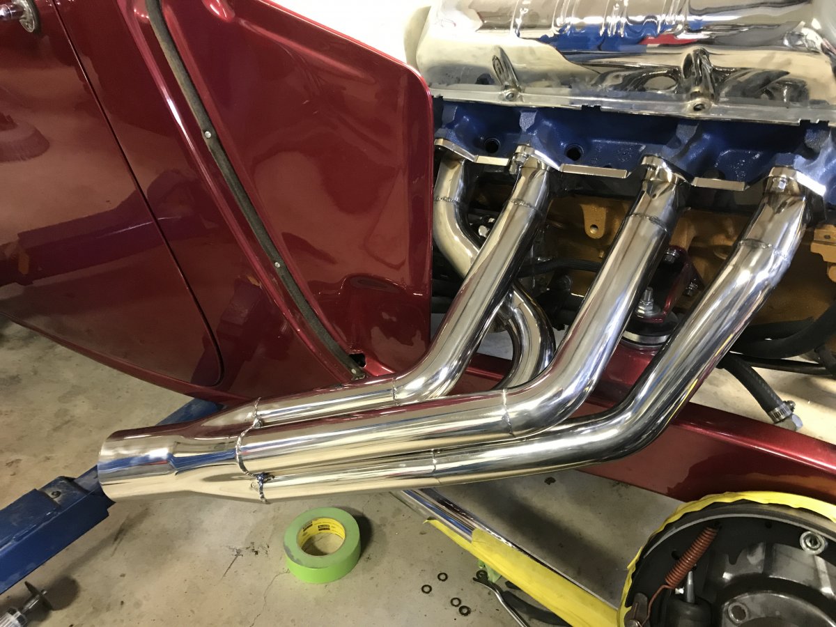

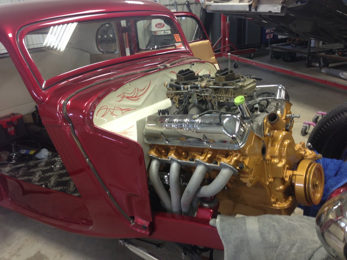

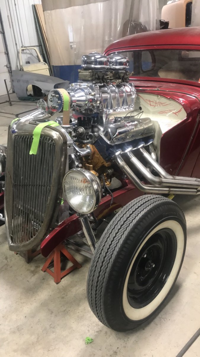

    8A55A077-FE49-4C2B-94A8-22FCBA4E30A1.jpeg 651526F0-ECA3-42E0-931E-70A3653043B4.jpeg 892326B8-BDA0-4855-A6C7-D70386D7B846.jpeg 34850803-9068-4DD4-9FC5-1188477B7D53.jpeg
    they actually fit pretty good. The first picture is when I had the 427 in it with full hood. Stock length. It drove just fine! That ******** about to heavy to big. Comes from the everyone do the same thing guys!
    I won’t say who! If you need more detailed pics just look for The Burrows Coupe.
    I had mine sitting high in the saddle. Which is not even necessary. I would just run the big pan that is flatter on bottom. Good luck!
