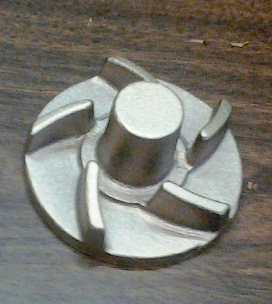

  9. Unfortunately the side drive deal was a bust, but I left with some other goodies! Now time to find some parts to get this water pump pumping! IMG_7109.jpeg IMG_7102.jpeg IMG_7105.jpeg IMG_7124.jpeg

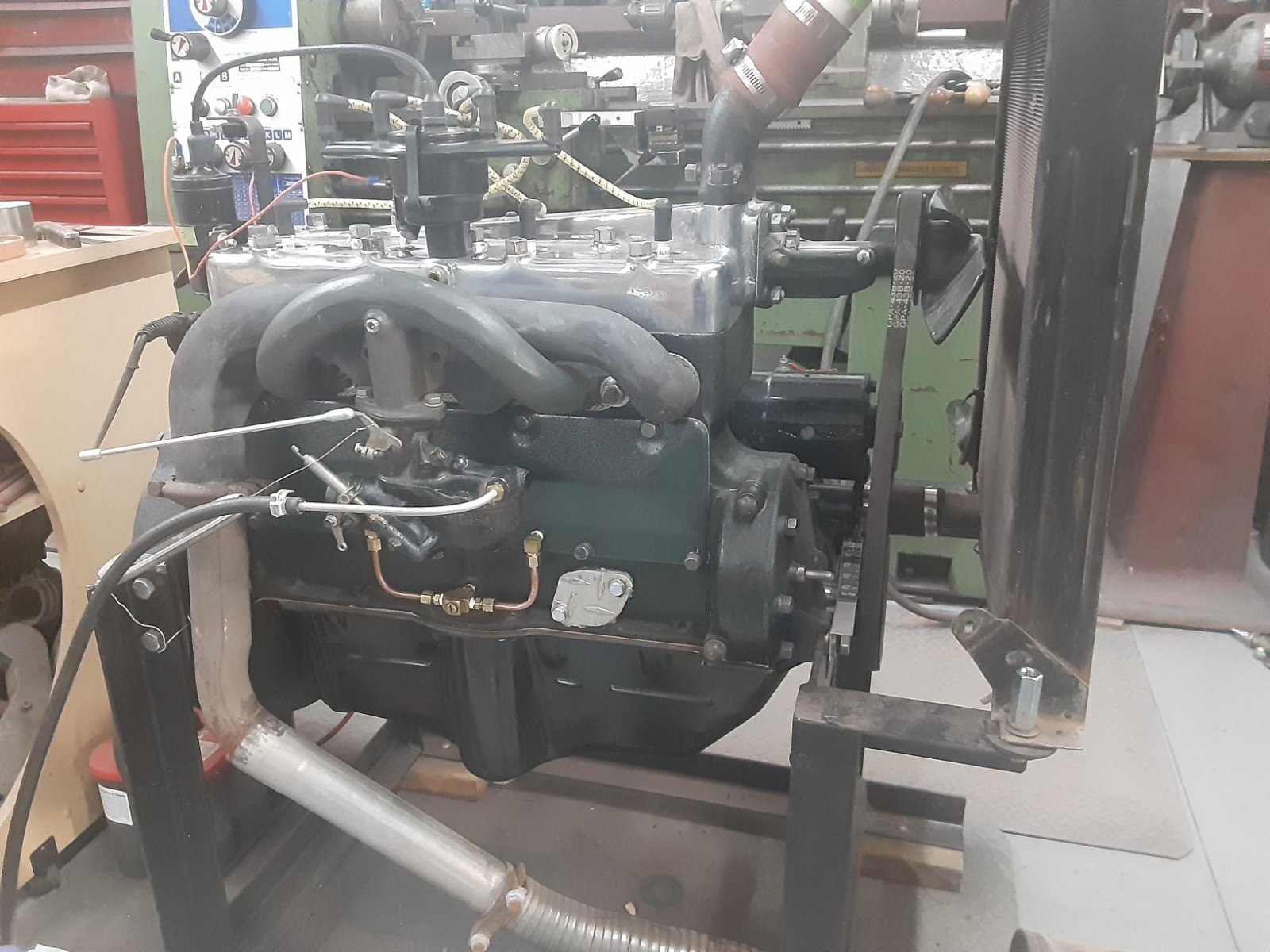

    Lite it off tomorrow.
    B engine, lightweight pistons, inserted rods, Winfield grind cam, non counterbalanced crank, 22# flywheel, 83cc Donovan head. Then into a Roadster if all is good on the run stand and it will get some more goodies. IMG_20230208_163136.jpg

    I didn't know that Donovan made flathead, when were these made?
  14. I would expect the heads made in the ‘70s when the Mod D was made
    I’ll post pics later as I get parts out

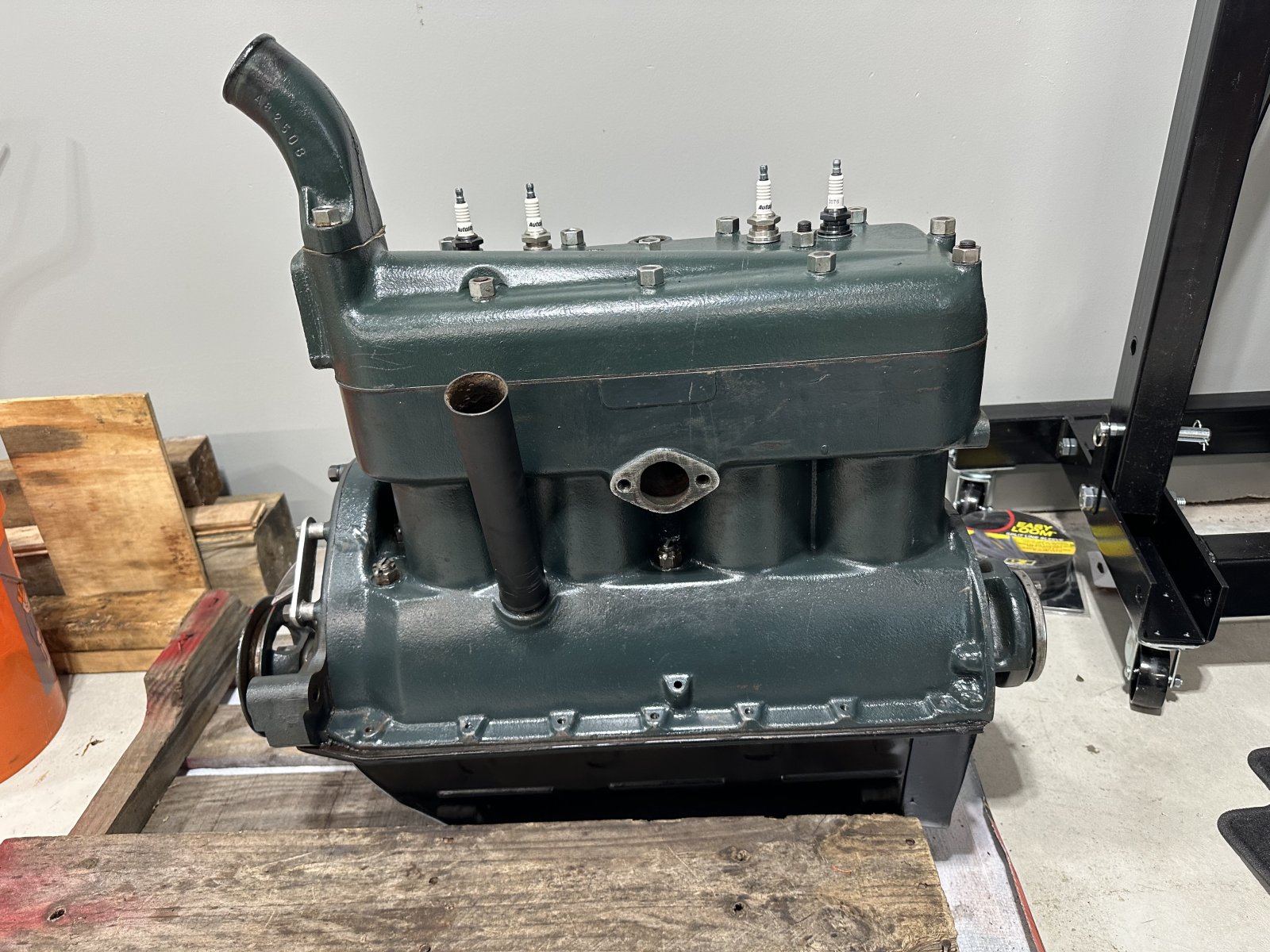

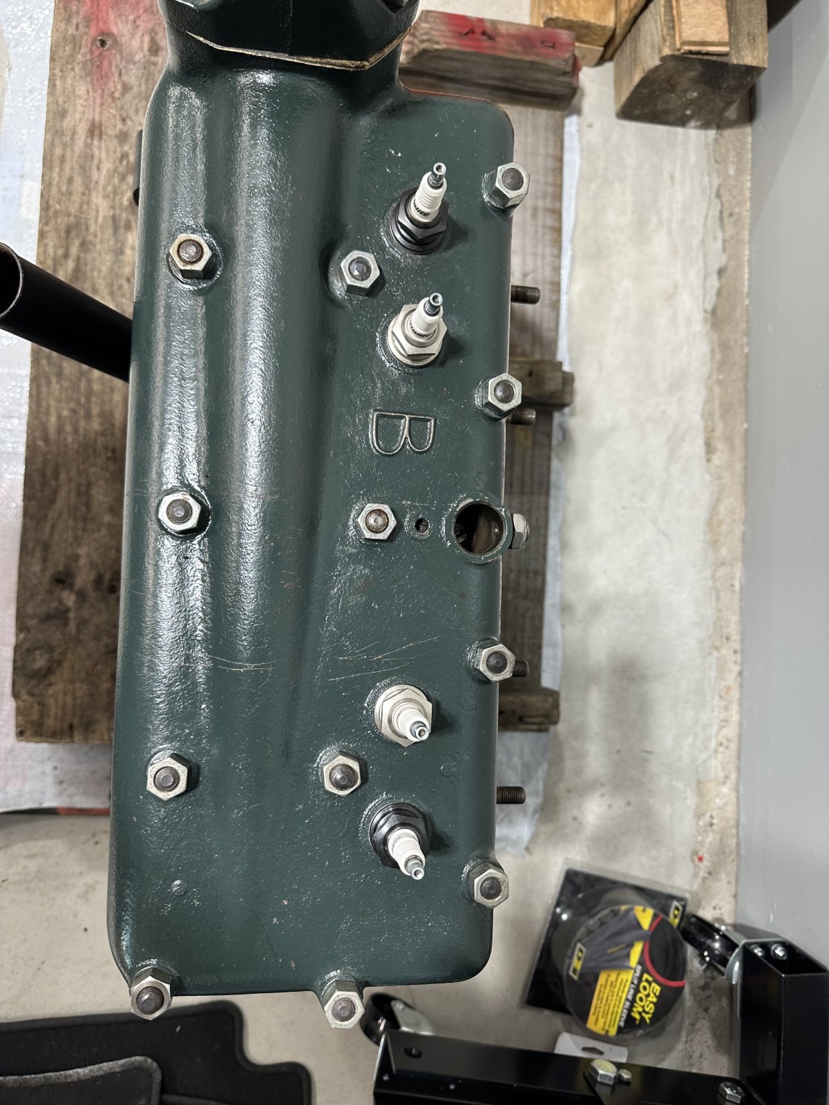

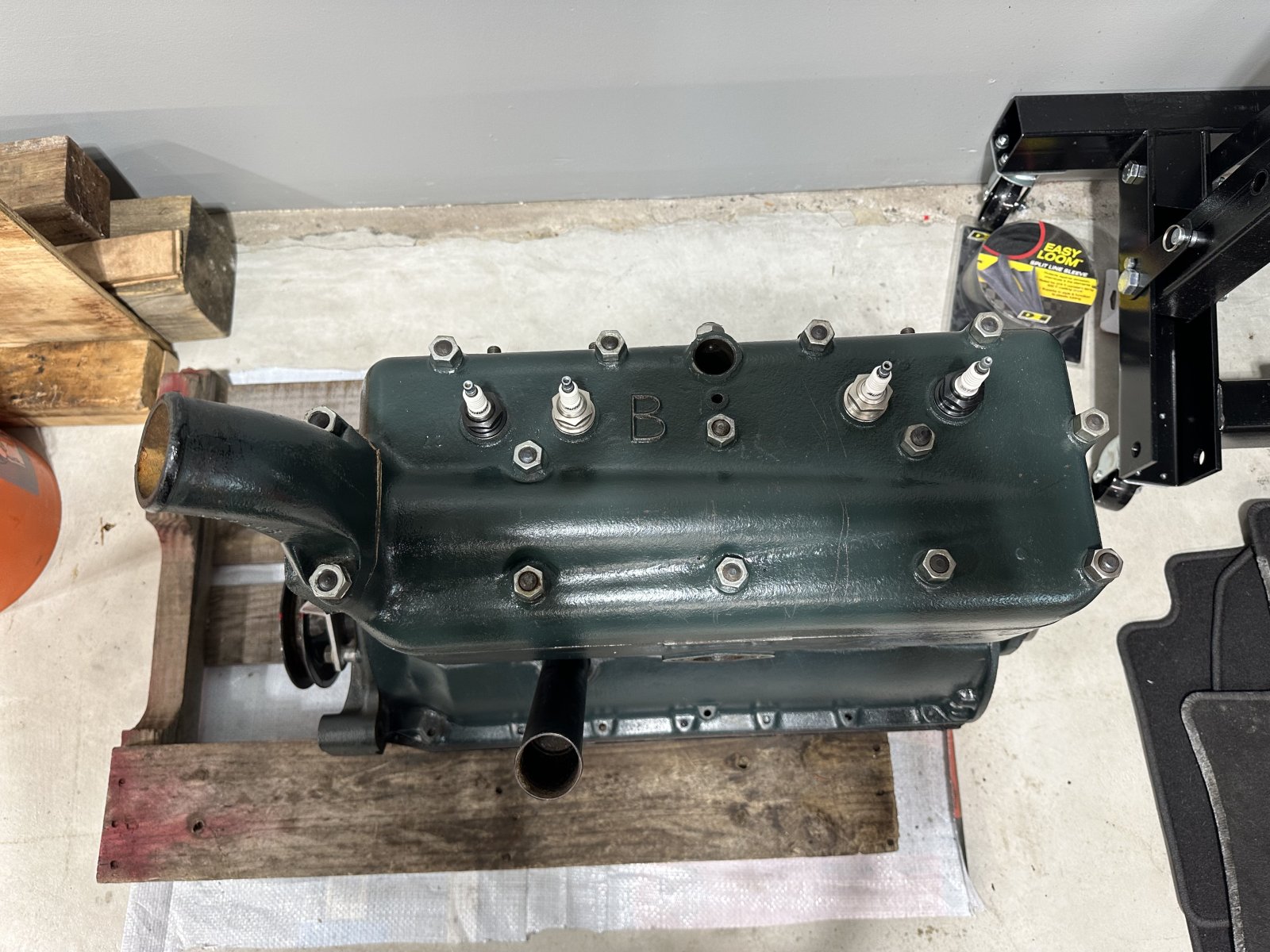

    Spent a little time with Dan Price the other day. I bought a running Model B engine w/ what I was told was a Brumfield head. I also picked up a lightened flywheel while I was there.
    I learned quite a bit from Dan and got to see his overwhelming collection of Banger parts and equipment. Overall great day.
    The engine will replace the one in my truck. I’ll be able to tear the existing engine down and use the one I bought from Dan.
    34A724C5-C060-4834-BA38-33182720F6D4.jpeg D5070CC9-13A0-4F9A-9B85-2991B51B4388.jpeg 8F4D0C1A-A9F7-486B-B2E5-AA25C31404CC.jpeg

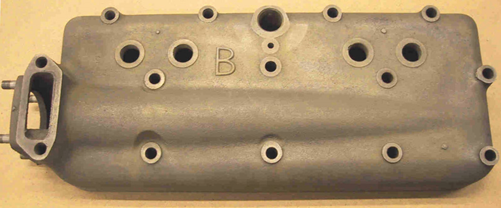

    Head on the motor in the pictures looks like a police head as shown below upload_2023-2-11_20-15-10.png
    Oil pan looks like model B, so maybe a model B with a police head?
    I understand the brumfield head had the letter B F cast on the top as shown below

    Thanks for clarifying the head. I ***ume Dan misspoke describing the engine.
    It is a Model B engine. It’s for my Model B 75A56EF3-FAF1-4B01-9C44-ACA61DA0056D.jpeg

  28. From what I heard, that engine has some cam in it!! Did it come with the Roto-Faze distributor?

    No Roto-Faze, no intake, no carb…The plan is to have a good solid runner.
    The engine in my truck has a nasty vibration and oily spark plugs. My guess is it has a flywheel/clutch/pressure plate related problem and a ring problem at the least. I’ll take it apart and see what I got. In the meantime I have a replacement.

    Donovan head engine lit right off...has 110# compression at 7000' elevation. Going to get it in a car soon
