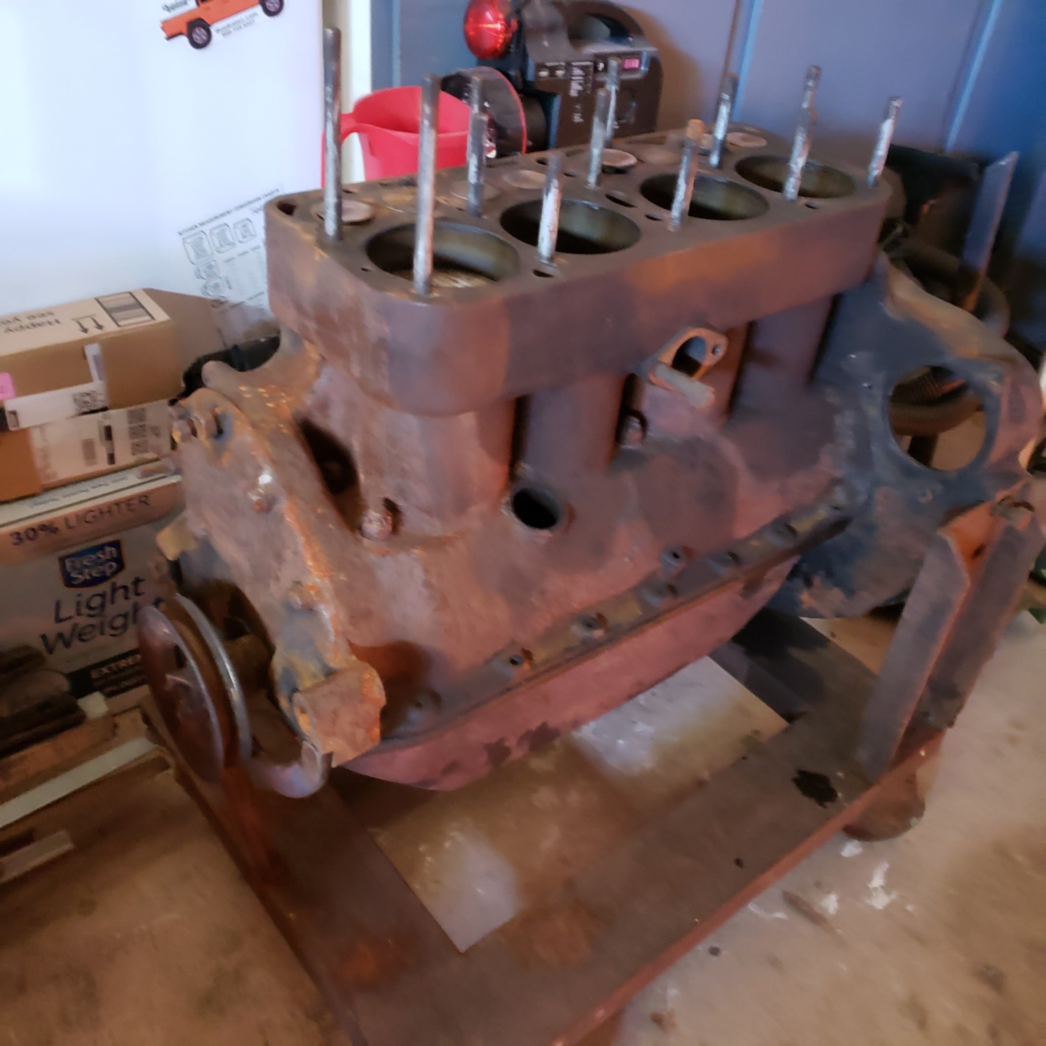

Technical ***Febrrruary 2023 Banger Stay Warm***
Discussion in 'Traditional Hot Rods' started by Jiminy, Feb 1, 2023.
  1. ccain
    Joined: Jun 13, 2009
    Posts: 1,231
    ccain
    Hot damn. My first "Banger Thread" check in. :cool:
    Here's my $100 short block score.
    Old Dawg, BeaverMatt, Jet96 and 5 others like this.

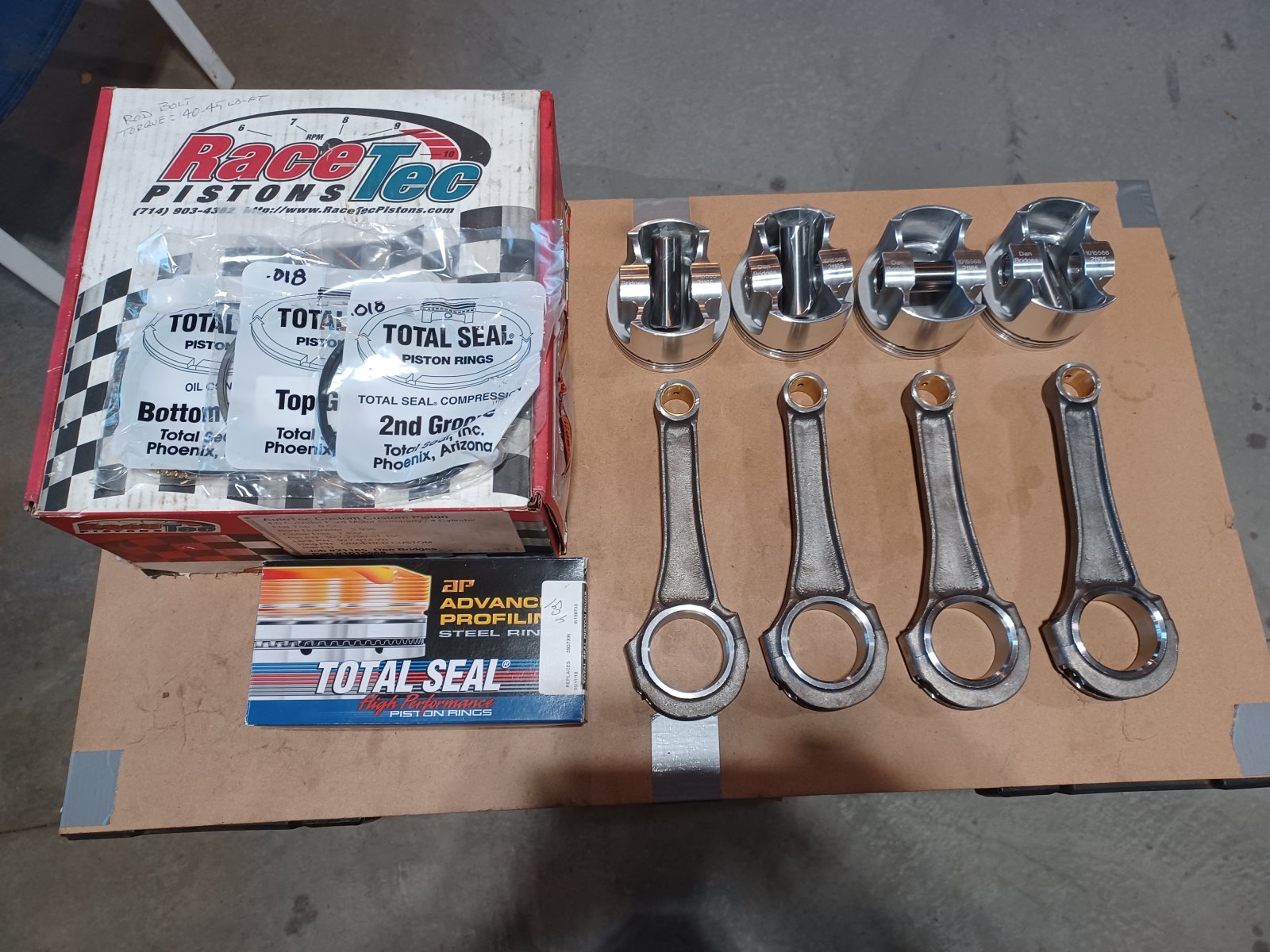

    Progress. Rotating****embly done

  4. Very nice Dan,
    Isn't it nice to work on new parts?
    J

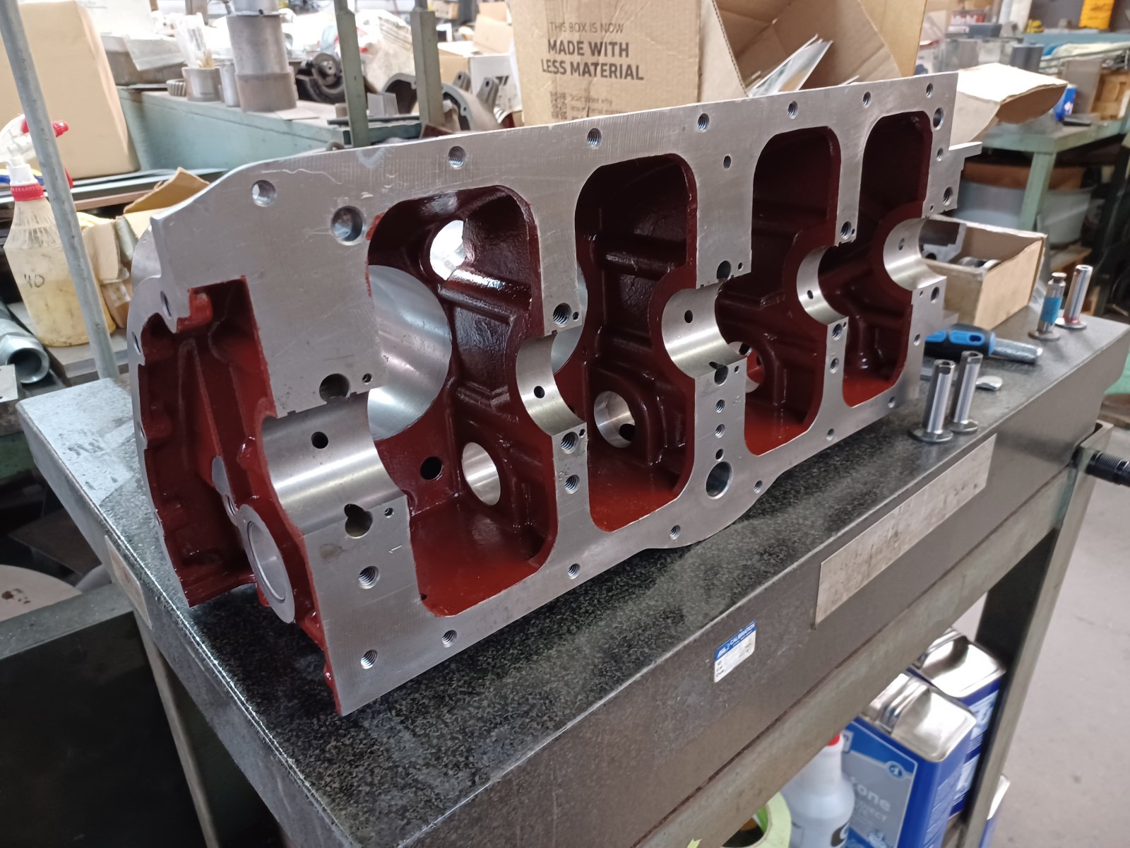

  6. 4BangerDean
    Joined: Aug 10, 2013
    Posts: 268
    4BangerDean
    I figured it was the new Burtz block. Interested about what I think is Glyptal paint under the side cover area. I think it’d be a good idea or was it done because of the application. The valves look interesting to me also.

  7. Yes, the painting of the inside surfaces does help with oil return to the pan, is a good idea.
    Those are not valves, those inserts are to help guide pushrods for an overhead conversion.
    Priorities, brakes are a good thing, it all comes together eventually.

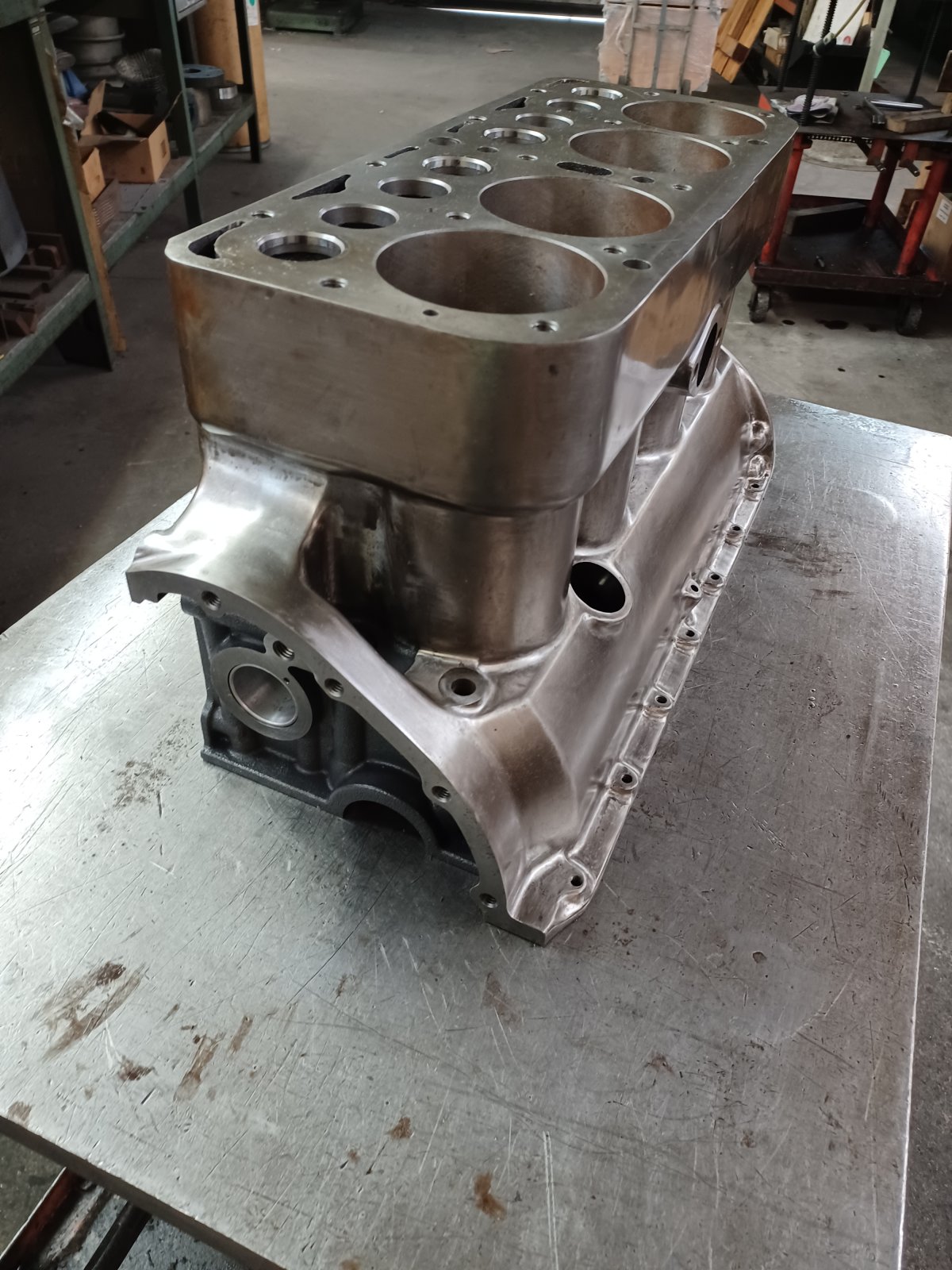

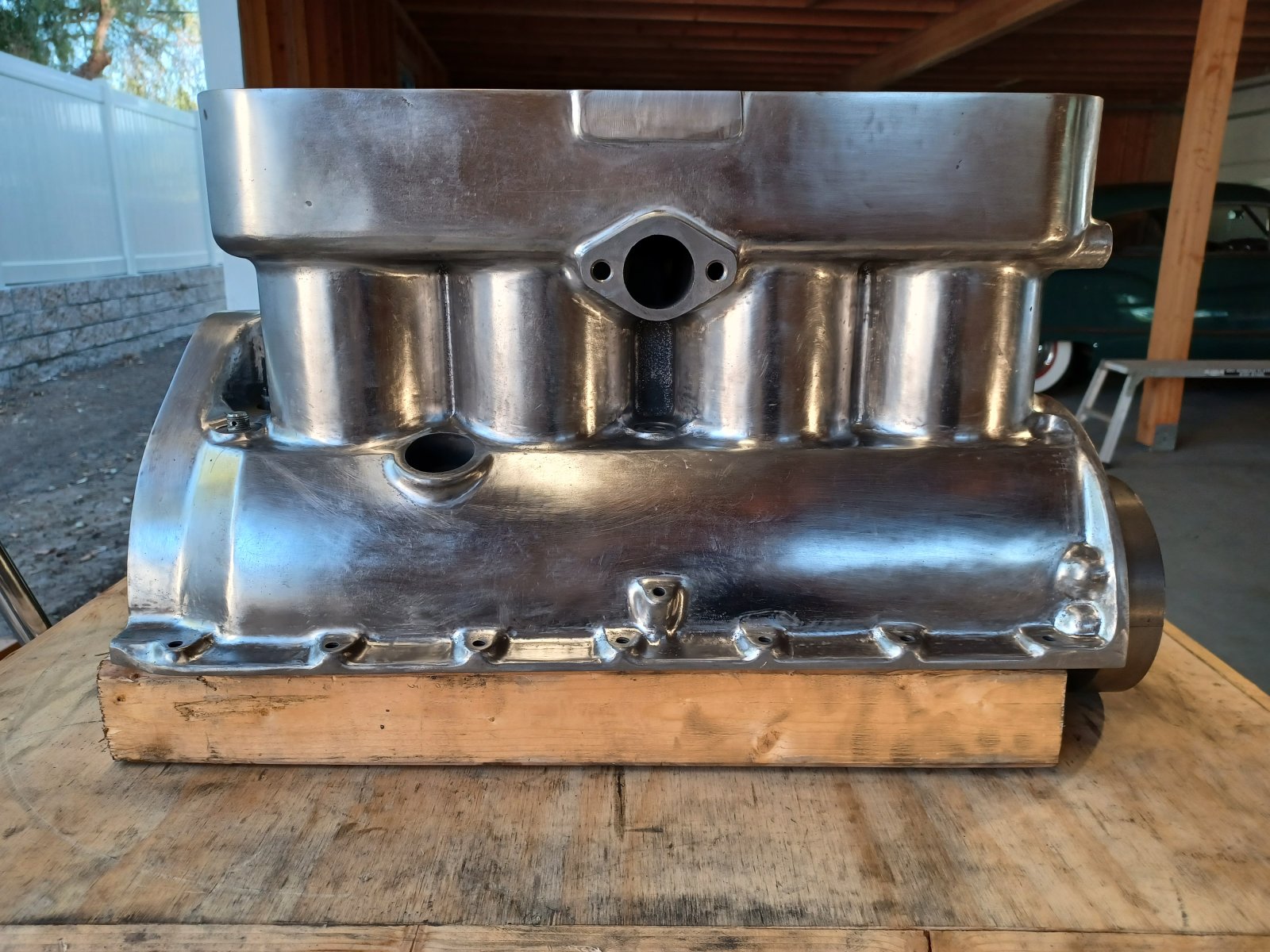

  10. Crazydaddyo
    Joined: Apr 6, 2008
    Posts: 3,370
    Crazydaddyo
    No build thread. It's a Burtz block that I polished the outside of the casting, bored it .060" over, Racetec pistons set up for 9.5:1 compression ratio, Rutherford OHV head, Brierly M-36 cam, Chrysler lifters, John Nielson oil pump.
    The build progress has been chronicled on the Banger meet threads since Feb of last year. Here is a link to the posts I've made about it: https://www.jalopyjournal.com/forum/search/404119932/
    Some pictures I may not have already posted:
    GuyW, Jet96, Old Dawg and 6 others like this.

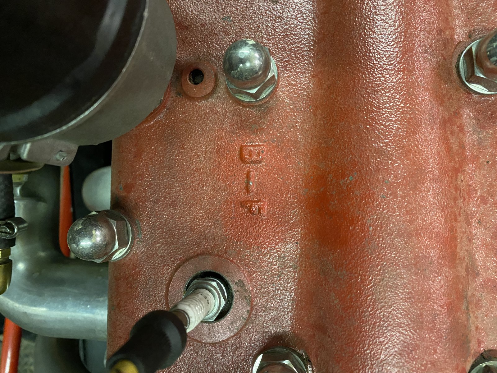

  11. 4BangerDean
    Posts: 268
    4BangerDean
    822984E6-2B8B-4D12-BB87-571901FED411.jpeg More on the Head….
    Dan Price says it’s a Brumfield and not a Police head. Dan says the cast Bs are different.
    With my initial research I had thought the Bs were different as well but the pictures and my eyes may not make them what they appear to be. I also could not find a picture of a Brumfield with a B on it either. That’s is why I initially inquired.
    I don’t mind if it’s a Police head or Brumfield I just would like to learn what I can. Also there’s a small 27 cast near the #4 spark plug.
    What do you think?
    322AE236-FA9B-483C-A80C-359A8F77C09D.jpeg A1065884-8162-45C8-9692-3116B470633B.png

  13. denis4x4
    Joined: Apr 23, 2005
    Posts: 4,384
    denis4x4
    from Colorado
    This is the marks on a Brumfield head. Note the spark plug size
    BiscayneBrain likes this.
  14. 4BangerDean
    Posts: 268
    4BangerDean
    Mine definitely does not look like yours. Looking closer at the head on my engine and the bare head, the Bs cast into the heads are different and are placed differently.
    9A213459-1937-4886-82D4-FF83C92C0A86.jpeg FCEEDB8B-B916-4DA2-98DF-B7A889E33530.png
  15. Probably the only way to be sure is to pull the head and measure chamber volume
    I do agree the plugs are wrong size for a Brumfield but the chamber is what matters not the casting
    J
