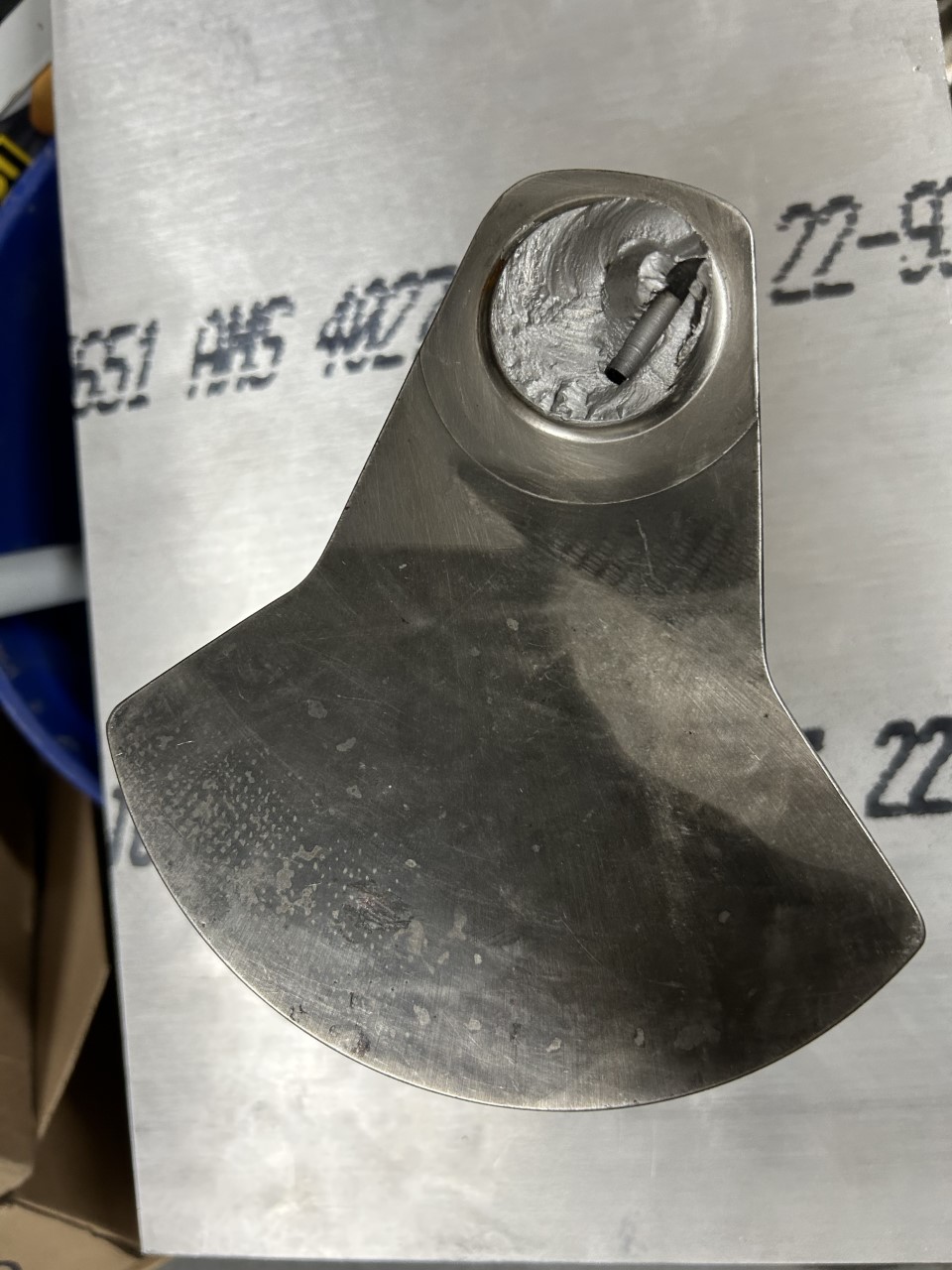

    Pic here is an "A" journal, drilled and busted. Somewhere I did the calculations about the oil hole taking about 10% of the cross section of the journal. That is a ton of strength out of a marginal journal.

    John- might not be the reduction in area of the journal, but a stress riser in the fillet on the side of the rod journal. The oil hole comes pretty close to the corner of the journal. Just food for thought.

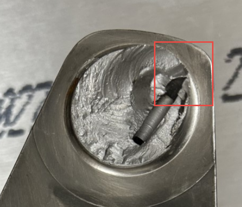

  27. Dan,
    I would agree with you, the pic makes it look like the drilled hole gets too close to the journal radius.
    However, this is not the case, see the pic below, it is not near the intersection (radius area)
    My point initially is that IF the hole is not in the journal to cause a stress riser, the length of the journal can withstand (deform and absorb) the flex/movement stresses.
    Chances are that if the hole was drilled more to the center of the journal, it could have survived.(?)
    Thank You for the input here, as always your opinion is welcome and appreciated.
    Best regards, John

    joemac05
    Thanks, much better picture angle.
