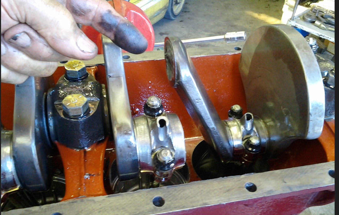

    They break undrilled as well.........
    ottoman and Crazydaddyo like this.
  5. Ugh, yes they do break.
    Maybe a fillet radius issue? looks like an early beaver tail crank, no?
    J
  6. wheeltramp brian
    Joined: Jun 11, 2010
    Posts: 3,343
    wheeltramp brian
    Just curious how and why are these cranks breaking so much? Is it the vibrations these engines put out or just parts that can't handle it?

    Thank you John just about what I thought I have had the flywheel work loose but could not see it exploding as some have said. I agree it is good to beef up the back flang by welding and a proper radius particually on the G28 as found in a Cl*** industrial engine

    Yes
  9. As Dan says,yes.
    Start thinking about the power levels attained now a days.
    The stk motor made 40 HP, a street flathead is about 80-90 HP
    A mild overhead is 120 HP and they go up from there.
    Add a little fuel or heavens for bid some Nitro and you have a grenade.

    Yep got it, but I figured the aftermarket **** cranks to be better quality and perhaps hold up better?

    The Achilles heal of the Skat crank is that the rod journals are A size (smaller) rather then B size.
