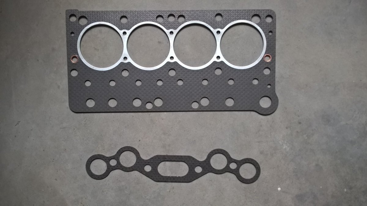

    Some time ago I told you we were working on our "mini banger" a 1937 Fiat topolino. Speed equipment is hard to find. We were lucky and got a Siata OHV conversion. We just got our head gaskets made. Now on to the Billet crankshaft and connecting rods
    These are laser cut of steel reinforced diesel material This head it about 11 inches long!
  14. WOW!!!! Sounds so awesome!
    Please keep the pictures coming!
    Joe

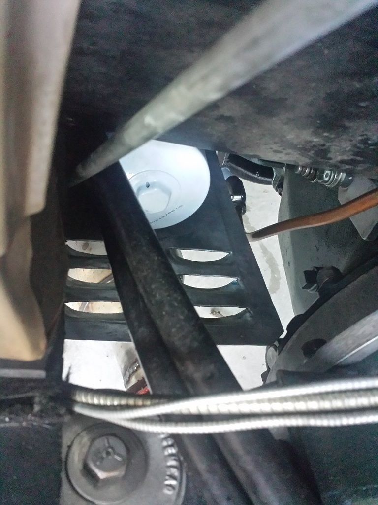

  17. I've been doing freeway speeds in my Banger with my Damper now for hundreds of miles. It doesn't vibrate like an old car anymore!!!
    One of the best mods EVER!!!!!
    There is two before being vulcanized and balanced.
    The other is installed.
    Didn't you get one VF4?
    [​IMG] [​IMG]

  19. Hi, a few have been made for H.A.M.B. members
    Although they are direct bolt on, you still need to make a different front engine mount just like you would if you was to do machine work and have a sleeve made for the use of a sbc damper. (It just didn't seem like a good/safe idea):eek:
    So we made these from hardened billet steel. It was a big time consuming project to whittle these little babies out, then take them to a Damper making pro to Vulcanize and balance/SFI certify them. End result. (NOT CHEAP!)
    Who knows, Maybe after a few hard races and thousands of miles on the freeway 70+ miles an hour W/O overdrive! we may just go ahead and buy the very expensive 20 foot long solid round stock of steel?
    That's a lot of Dampers!:D
    Joe

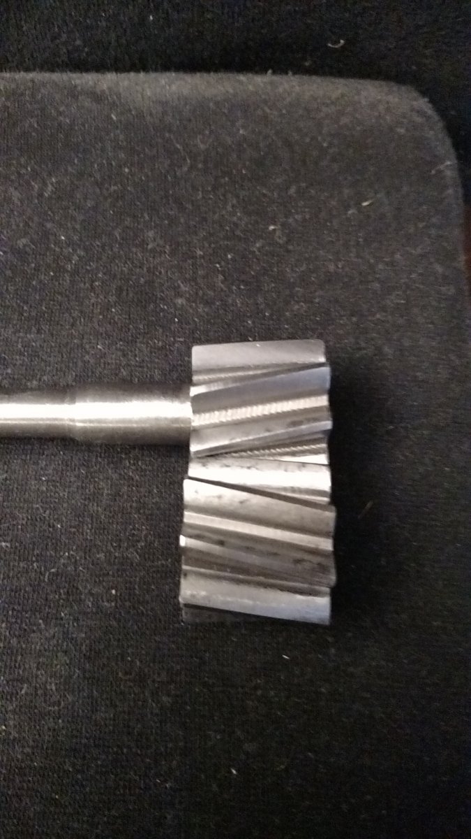

    So I have a buddy, Rick, that lets his hound dog mouth over run his **** dog *** a lot. He is active with the local Model A Ford Club. These guys are finding all they do is upset the motoring public in a stock Model A. They are starting to 'hop up' their cars. The problem with these guys is that they go on the cheap and don't have much mechanical skills for the most part. My buddy volunteered to work on one of the club members car that was loosing oil pressure on corners. Rick and I have been modifying the A oil pumps with the inlet to the gears in the bottom plate. This means closing the stock inlet opening in the housing. I've been making a copper piece and silver brazing the opening shut. Rick wanted me to do that for this club members car and I agreed. He thought that the housing around the screen was probably leaking and drawing in air and I suspect he is correct. The modification of moving the inlet to the bottom plate eliminates the problem of ****ing air in that manner. He brought me the pump and this is what it has for gears IMG_20160206_130526264.jpg
    It will build lots of oil pressure. 85 psi cold which is way too much but 25 psi at idle hot easy.....
    All the pumps I've ever seen have straight cut gears. They are 1/8" larger in diameter than the stock gears and the housing has been modified to accept them.
    Anyone got any ideas or seen a pump modified like this?
    Larry

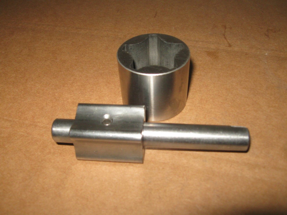

  22. We built one using a new set of USA made 1964 327 sbc oil pump gears. Works really good!
    You must have a regulator though!
    The first picture on the bench before running the stainless safety wire through all screws. I even ran a safety wire on the screw holding the pump to the block. I can't just depend on the spring to hold her up!:D
    The base is 7075 billet aluminum and the shaft housing is made with 1045 billet steel and bronze bushings. No more breaking pumps! (SUPER STRONG!) It has over 1,000 dollar shop hours in it!(parts and material not included!):eek: Worth every bit!o_O p.s. the pickup screen is towards the rear and the stock pan still fits it! Just (a little t******* needed on the baffle)
    Sorry,I didn't take any pictures of the gears but (THEY ARE HUGE!)
    Joe
    [​IMG] [​IMG]

    Good looking oil pump. Yes it needs a pressure relief for sure. Have been using a **** remote mount filter that has integral pressure relief but they changed it up and the new ones need a spring change. I have been looking for a relief that can be placed on the pump shaft.
    Sure would like to know what the pump gears are out of....
    Larry
  24. ****?????? I wouldn't use them for anything!!!!!! For theirs to work, it would need a separate return line to the pan!!!!!
    They said they would cover the broke crank, told me to send it back. It cost me hours and over a hundred bucks to get it back to them! Weeks later I was told to go f-ck myself!:mad:
    Mine is my own design mounted where the mechanical pump would go so it can be adjusted without dropping the pan.
    My oil filter housing is a Transdapt with 1/2" lines. The K & N race filter has an oil pressure byp*** that will still put out too much pressure if we don't run pressure regulators though a full oil filtration system like we usually run in our A's and B's
    The filter also has an anti back flow so if you mount the filter higher, the **** won't run back into the engine when not running!
    Joe

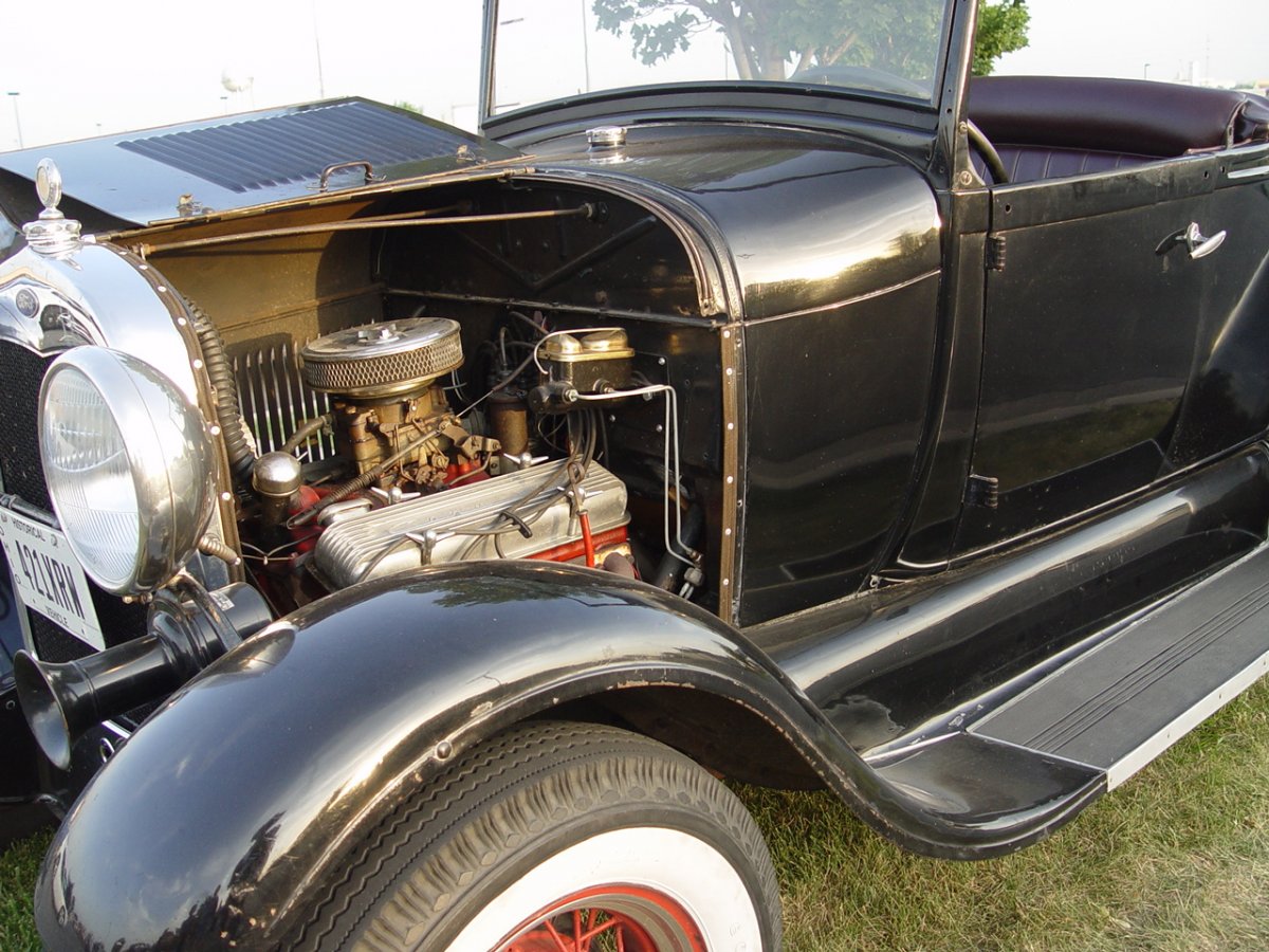

    I meant to reply that this is Dan Price. I met him in Lincoln, Nebraska at Speedy Bills reunion in 2013.
    Under the hood
    This is why he beat us everywhere....
    Great guy and very interesting to talk to.
  26. WTF! is that a SBC under the hood????
