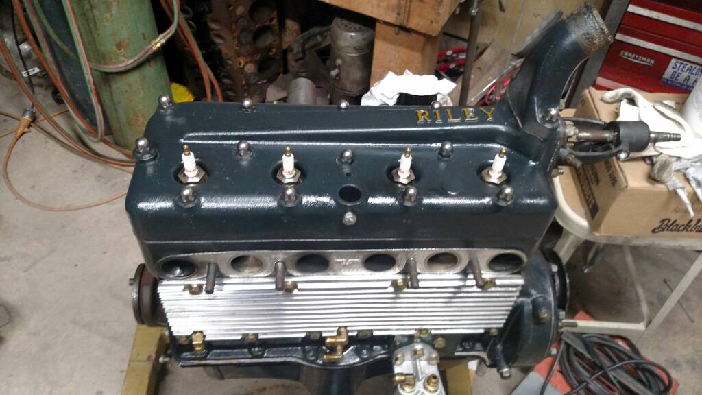

    Now for the mud to go away and get it in a car.
    where did you find that head ? also , the valve cover looks more like an overhead . info please

    The head is one of a few that Riley cast he is best known for his OHV stuff. I know they are rare and have heard of two others. I scored it in a find in California a few years ago. It was actually in a pile destined for s**** and I just happened to get there in time . I'll try to post a photo of the combustion chamber when I get to a different data base.
    The cover was in the same score and is old school. It isn't like anything else I've seen.
    This stuff is still out there. It came with a 4 into 1 header, lake style, maybe that is for this engine too.

    I have a reds 4-1 & like it fine .
    pix would be cool . id like to see how they did the cover ..........
