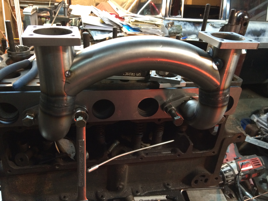

    Played with the Winfield intake today. Ran out of time but it's close

    Very nice! Now if I had a pair of fresh winfields I'd be calling you up! Beautiful looking manifold!
    If I may ask, what size and wall thickness tubing do you use on your manifolds? They look great, and I hear they perform as good as they look.
    Thanks, Johnny

    Thanks.....
    I wish I had two Winfield's my self.
    I use 16 gage tubing.
    I just found a guy that is doing 11 gage U bends I want to try and see how his quality of the bends are.
