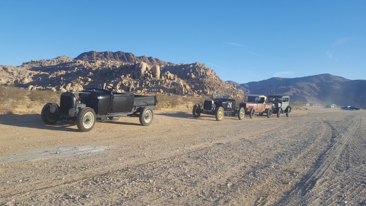

    Took a little run with my friends today 20180204_075424.jpg 20180204_094307.jpg 20180204_094325.jpg 20180204_075332.jpg 20180204_092527.jpg

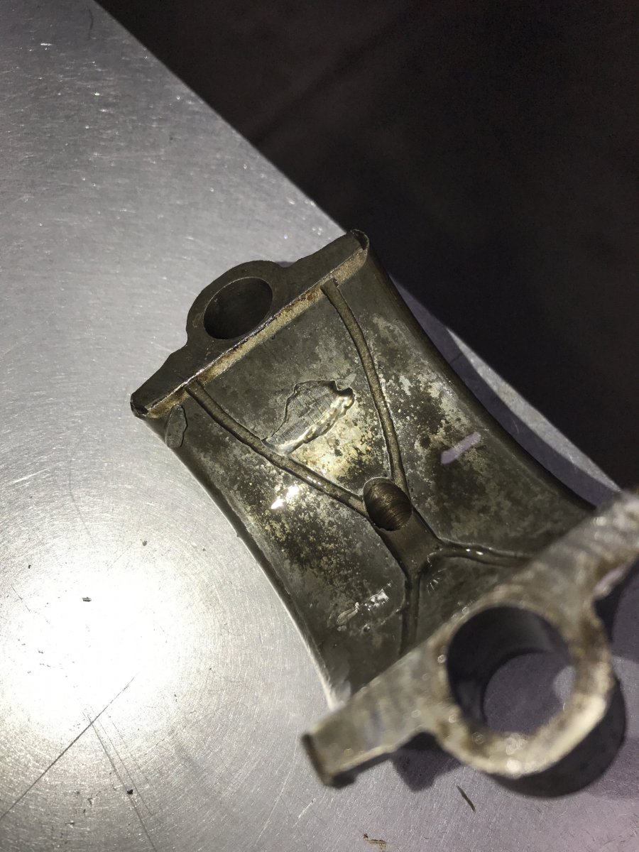

    Been running around in the deuce as much as the weather would allow over the last couple of weeks, it's developing a knock on N.o 1 cylinder so Im going to drop the pan and have a look at the Babbits (I'm hoping it just needs the shims adjusting) anything else I should check while I have the pan off?

    Thanks for the advice all, got the sump pulled before I saw your suggestions however think I’ve found the problem .......

  9. OUCH! Time to pull it and do it proper!

    Ouch indeed , thankfully the crank looks good . Currently deciding what to do, was hoping to get to run it as it is for a little while longer before jumping into the motor .
    Interesting to find I have a c head diamond block but not a counterbalanced crank . I assumed that you couldn’t have the block without the crank?

    No, number one cylinder . The mains look fine as do the rest of the rods (although they are only just in tolerance with no shims )

    Not front Main , number one rod bearing that’s gone .

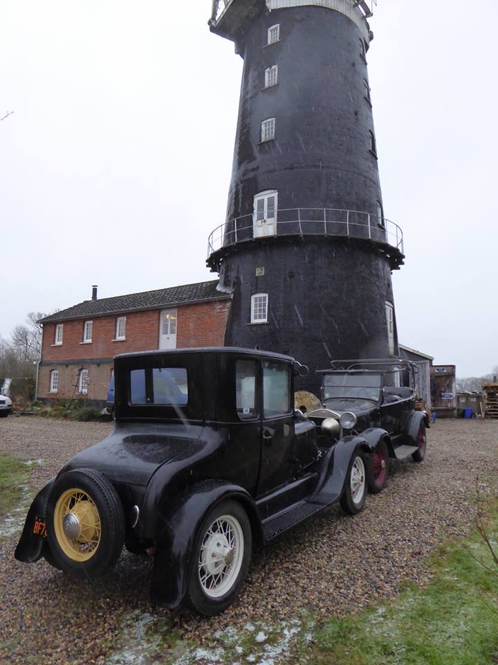

    Oh - and every post is better with a picture - new engine is for the Coupe... 27654643_10156114100692329_5331517526317084372_n.jpg

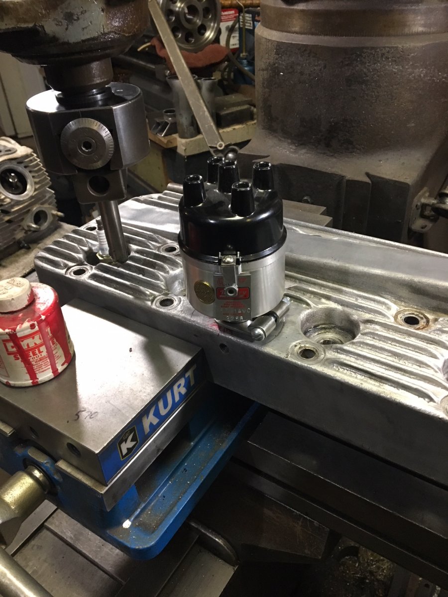

    Finally fixed the holes in the weiand head and cleaned up the hole to run the Mallory distributor.Need to find a single carb manifold and carb.Whats everbodys opinion on best single carb manifold and carb to run on a mild hoped up banger?

    Bluto
    CRANK ''LOOKS GOOD''/ DID YOU MEASURE IT?
    IF YOU STUFF IT BACK TOGETHER AND RUN IT YOU HAVE AN HONEST CHANCE OF IT REALLY "LASTING A LITTLE LONGER'' .....
    JUST ENOUGH TO DISTROY EVERYTHING!! I HAVE NEVER SEEN ANY OF THESE GET BETTER ON THEIR OWN. THEY DON'T HEAL THEMSELVES!!! NOTHING YOU POUR INTO THE OIL WILL FIX THIS ANY MORE THAN HITTING THE MOTOR WITH A LARGE HAMMER....
    IF THE CRANK IS GOOD SPEND THE MONEY FOR A NEW ROD AND HEAD GASKET.... THEN WHEN IT COMES OUT THE BLOCK YOU'LL AGREE WITH THE OLD GUYS HERE.

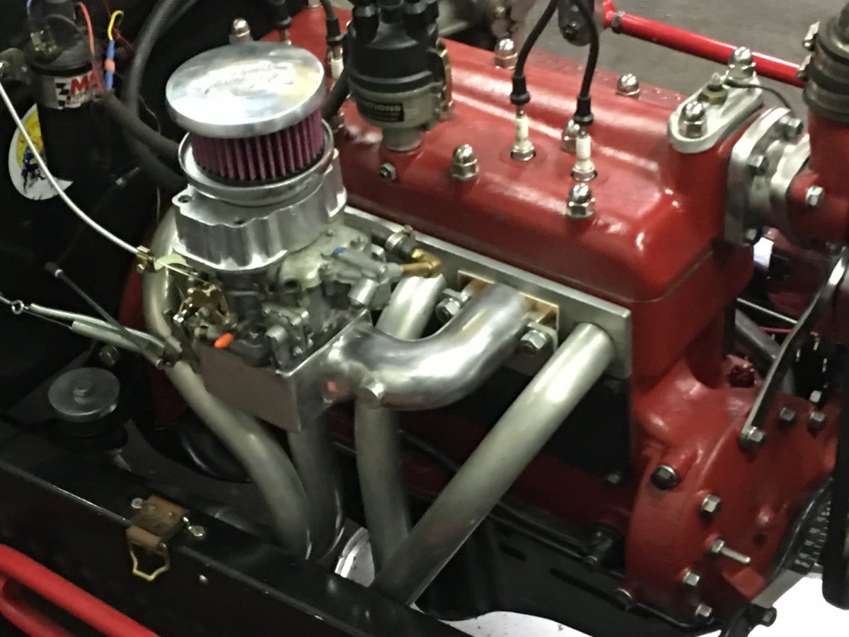

    Switched from Strombergs to Weber 32/36 carbs and intakes and never looked back 38E99B37-83E5-4E31-9583-3FAC990E398C.jpeg
    Old Dawg, Dannerr and burl like this.
