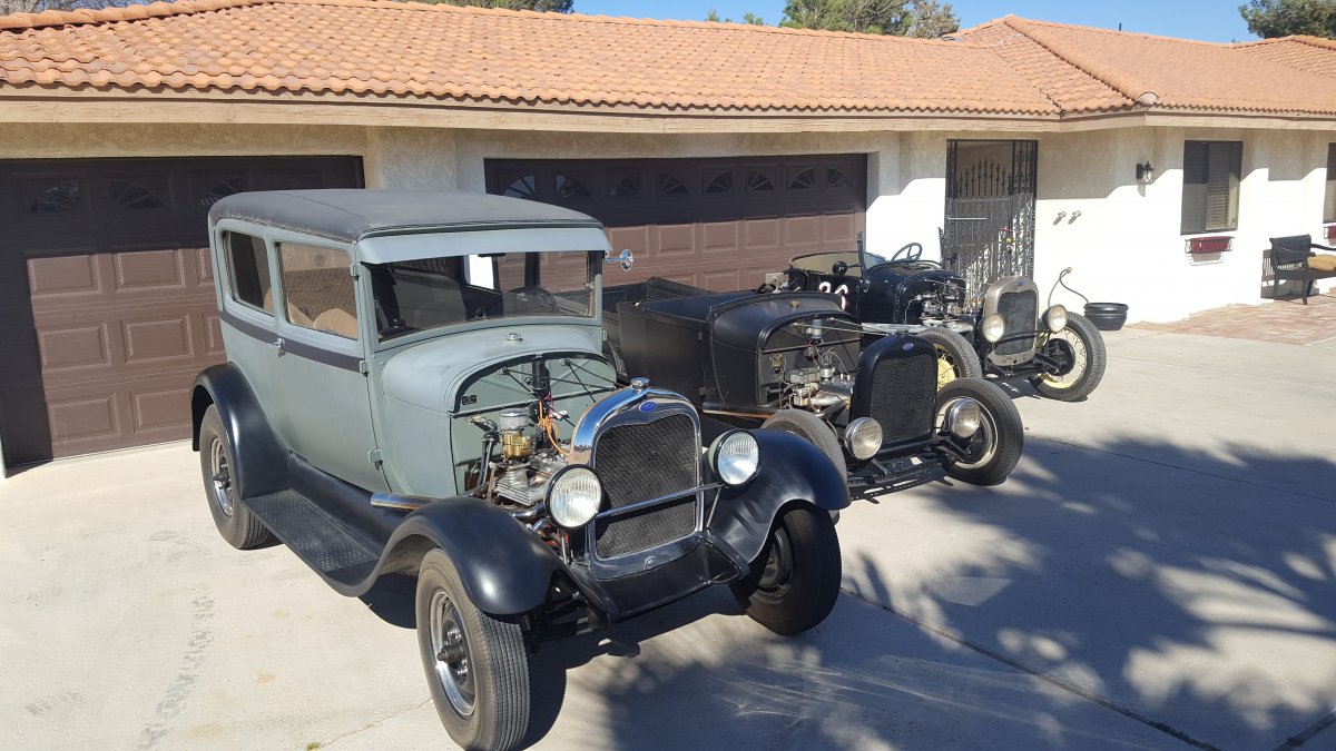

  18. ROCKER77
    Joined: Jun 30, 2008
    Posts: 515
    ROCKER77
    A little gathering for lunch today, I gotta,keep an eye on Jake as he really likes my original gas cap lol 20180218_141211.jpg 20180218_141129.jpg
    barrnone50, Dannerr, burl and 4 others like this.
