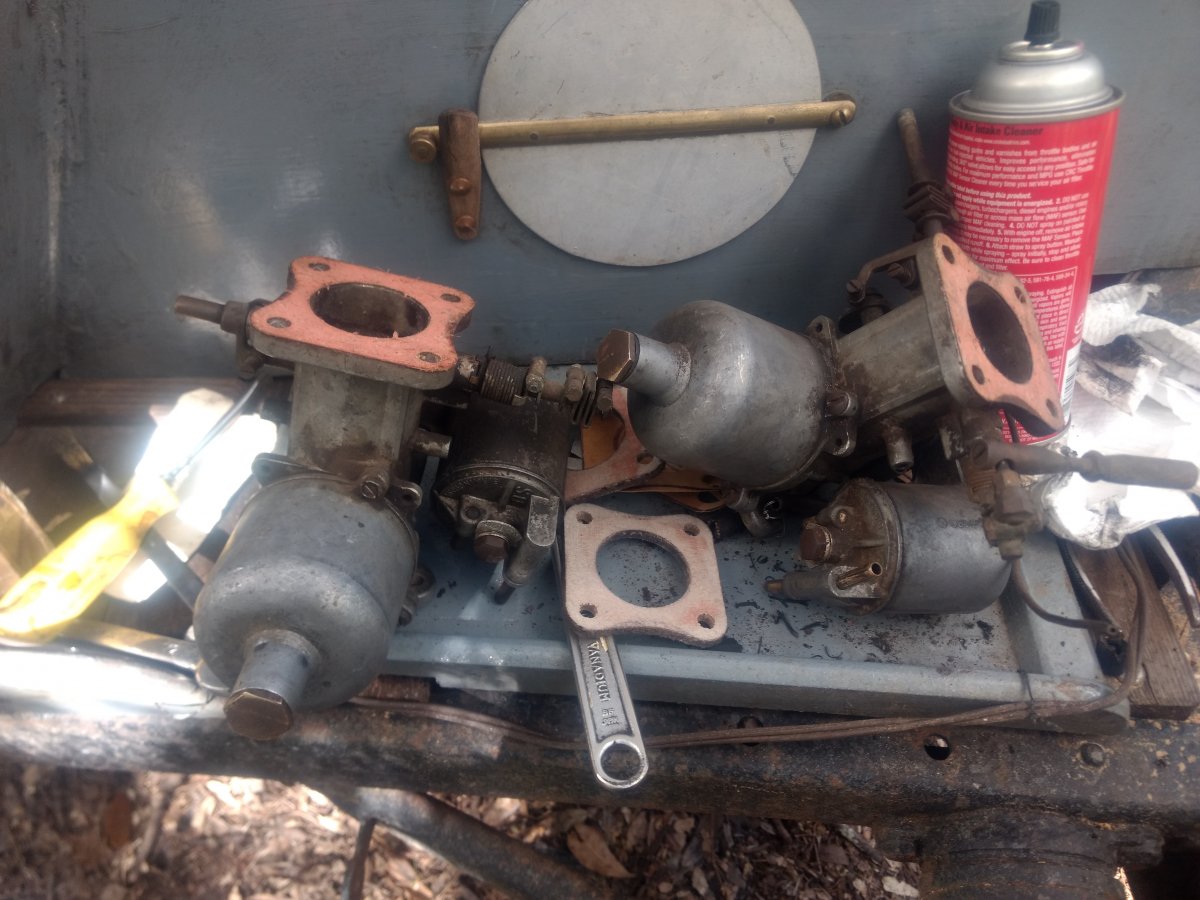

    Checking in. Aquired a pair of 1 3/4" H6 SU carburetors from lake_harley (thank you) on the cl***ifieds here. Been busy throwing together a jack-legged manifold.

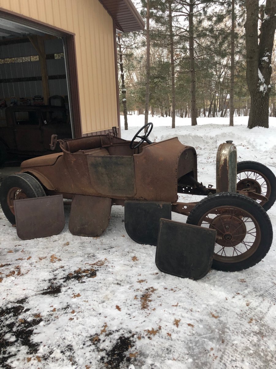

    Sport coupe body,Today I drilled out a bunch of waffle rivets took the front rumble floor pan and toe box out to make a flat floor,have some seat tracks from forklift chairs might make it a slider..Sport coupe is nice for leg room,take this floor section out and remove the parcel tray and you can really have the leg room..going to mock it up with the parcel deck in and see. The jeep seat looks better than the caravan chair..

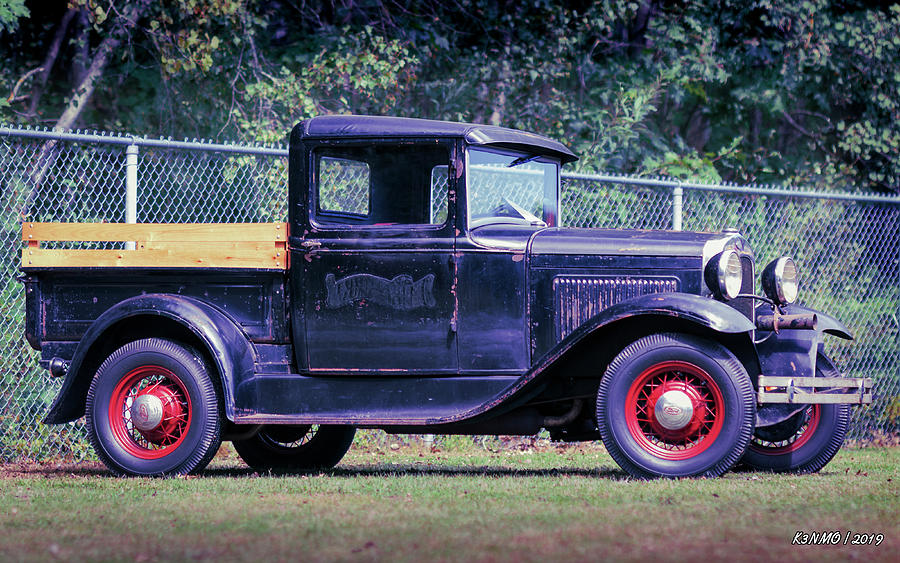

    Haven't posted in awhile but I been workin on my 30 banger here is the befor and after pic, what you guys think? Still want to do some work to the engine but just external stuff

  18. Ay-Uh, sumthin special bout them ‘30 Closed Cabs! Bang On! Keep us posted.

    So far what I did was got the stock axles dropped reverse main springs front and rear with a few springs removed in the rear and a mild z frame in the rear, I bought a manifold and carb from a fellow on the Hamb, would like to find a head and distributor if anybody has one ,, and going to do a t5 with a closed driveshaft conversation

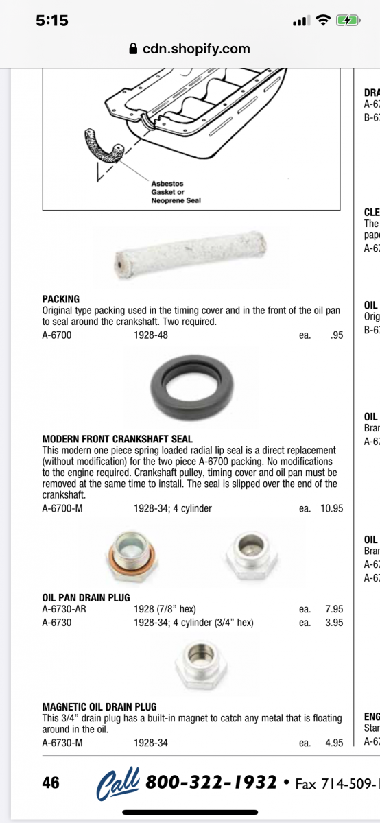

    Trying again.....looking for non stock ways to seal up oil pan and crank on a mild banger. stock with a better top end

    I just picked up a modern front crank seal from CW Moss.

    High quality modern silicone based sealants work well.I use threebond,but permatex ultra grey works good too,a thin film on all gaskets and a good seam along the corners of the pan where it fit the crank seal.Fit and trim your pan gasket prior to ***embly..The goal is to have just a trace of sealant squeeze out on all gaskets.When using the modern seal shown above bed it in a thin bead of sealant.also use sealant sparingly on the threads of bolts that screw blindly into the crankcase/valve gallery.
    The key to using sealant is be sparing with it but through..overuse is dangerous,a ball the size of a pea can clog a main bearing feed tube..done correctly you can have a leak free model a (within reason :) )

    front and rear seals were my main concern. I know there are modern seals and stuff out there but no experience. the rear ones require a pan modification right? Oh and this is a B block.
