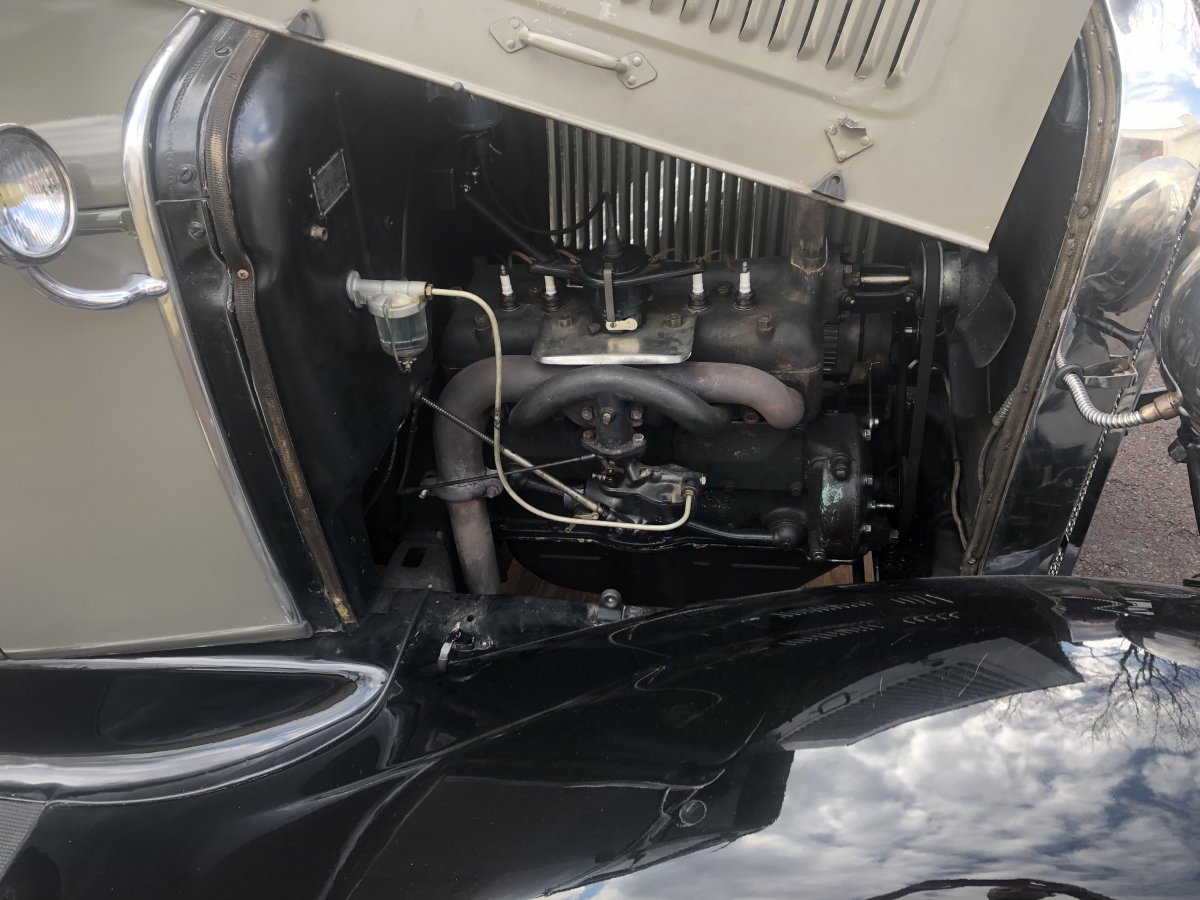

    Basically stock.
    Been resisting the urge to modify it.
    I already have a coupe that’s in pieces.
    I know better.
    Hadn’t run in years but new gas oil and rebuilt distributor has it running nicely.
    Couldn’t resist the mild weather had to take it out for a ride.
    It’s been a couple years since I drove one with a stock engine.
    Head/carb/ignition really make a huge difference. Maybe in the fall. 46367F1C-71CE-486C-A2AE-08258274EC0C.jpeg 76FA6F29-5490-4694-81C6-F919745B01F6.jpeg

    Oh how sweet it is......thanks 4 the ride!
