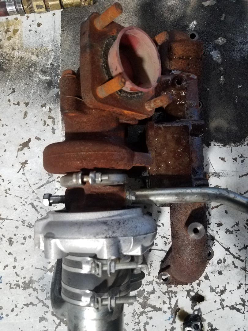

  3. Talked to the guy on facebook. Apparently the engine has a stock head, .100 over, with stainless valves, adjustable lifters, inserts, and a balanced rotating ***embly but still using the splash system.
    What's interesting is he has an electric pump for oil pressure to the turbo.
    I'm curious to see how the merc tea-pot carb works with it.

    Looks like a really big turbo for the little A engine.

    Why would it not have an oil seal in the compressor?
  7. A lot of turbos did not have an oil seal in the compressor housing because they were not designed for a **** thru system. By putting a carb on the inlet, you basically put the compressor housing at intake vacuum. Without the seal, it pulls the oil from the bearings.

    I have a T04D off a Kubota diesel..
    Small turbine,fed a 3000cc diesel (about 185 cuin). My plan is to set it up draw through. A blow through works well with EFI,not so good with a carburetor.Not only does a turbo raise compression, it also raises volumetric effciency through added turbulence. You don't need much boost to affect performance.Un controlled large turbine turbos will cost you in the end,a quality manually controlled waste gate is critical large or small turbine.

    Without a seal, what would keep pressurized oil from leaking into the compressor. Diesels do not make vacuum, but also do not make boost to hold oil in the bearing chamber unless the engine is under load. Cruising at low speed on flat ground or coasting they make no boost.
    I'm not saying you didn't find a turbo without seals, but it makes no sense to build one that way.
  10. Typically the oil in the bearing can go to the drain without having the compressor under boost condition. The issue is when you are pulling 15-20 in/hg vacuum, then you will pull the oil from the drain and bearing. Most of the diesel turbos do not have the seal unless there was a inducer vane system, Mercedes for example.
    Ak Miller used to rebuild the center sections for me and added the seals when in **** thru systems. I just did the bearings last year in the turbo on my Dodge, it had the slinger, no seal.

    Draw through will work, the compressor bearing is sealed. Problem is after some operation the fuel air mixture will eat the seal. All piston engines create vacuum. Boost in a diesel, as well as a car is controlled by a waste gate, the hot side is allowed to diverted straight to exhaust 'feathering' the turbine. Draw through with a carburetor is basically easier, the carburetor still sees atmospheric pressure at the horn, as it does with a naturally aspirated system.
    A manual waste gate can limit total boost, an automatic gate that works on a vacuum signal moderates boost for drivability. Controlling boost is critical for limiting compression, with a stock head and 3 lbs of boost you go from 4.2 to over 7 to 1.Heres my little TO4D,for scale that exhaust manifold is slightly smaller than an A manifold..itty bitty turbine..

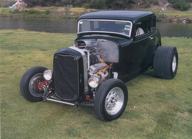

  13. 32@AG.jpeg 32@AG.jpeg Put a Supercharger or Turbo Charger on an Old Iron engine like a T, Model A & B..? Do a whole bunch of study and thought. If not you better wear a "Flack Jacket, LOL! Years (decades) ago I wrecked a lot of stuff before I went to an uncle with experience in pushing fuel in engines in higher pressure! I finally got it somewhat right. The supercharger on this engine is a highly modified Detroit Diesel (including it's own lubrication system). It's mounted on a 4 bolt "Jimmy" truck Small Block; But I still treat it with respect! Having said that I'm glad there are guys "Pushing the Envelope"!

  17. I ran that "Pelican' at ****onwillow one time! A "Gold chained and silk slacks' dude w/"Arm Candy" came by my Pit Space. Said: "Look Honey, that's a Hot Rod! He'll go fast on the straights; but can't "Corner"!" I went around him on the outside (he in his Cobra Replica) on Turn 2 (a 180 degree, uphill); and ****ed his goggles off down the straight with the "Deuce's" thunderous acceleration. Had great fun all weekend; beating the Corvettes, Shelby clones and Cobra replicas! I've always had "Pipe Dreams" about dueling with my friend Bill Pollack (he in Tom Carstens' Cad-Allard) thru the forests of Pebble Beach! But alas: I was too young and broke in the '50's! Bill (he died at 95) when seeing the "deuce" allowed that it'd be a "good race"!

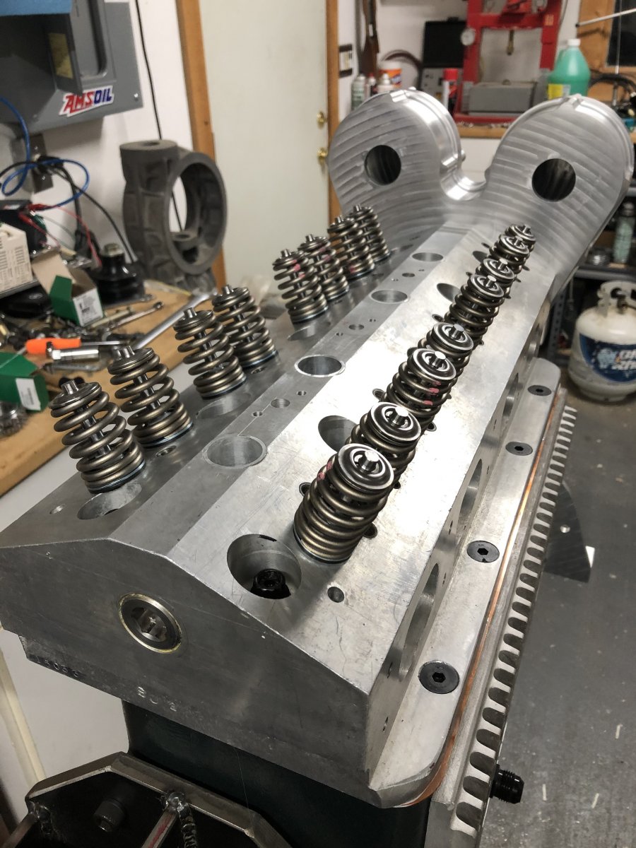

  18. John! Who's head is that? The "Cast In" drive towers confuse me!
  19. John,
    The cam tower is not cast in, just looks like it. I'll show more later after air test verification.
    The head is a CREE, developed from the late Bruce Johnson Bee-Jay of Burbank Calif.
    The basic design holds a few Bonneville records as of late but more refined than this particular one.
    John

    Hi John can we see a picture of the ***bustion chamber side of the head and a view of the intake and exhaust port sides " Please"

  21. No, I am not taking it back off unless I killed a sealing ring.
    It is like any other 4 valve head, you can only do so much with it.
    J

    I get it ..........Was hoping you might have some around from before you installed.....Thanks
  25. Steve,
    Yeah, sorry, it is sealed up, I might have pics in other bo**.
    It is very close to a McDowell style but with 4 holes. The pistons worked out to be McDowell domes and about 11to 1. I am not sure how many are still around, I found one about 3 years ago and it was in pretty bad shape. From what I understand, not many were finished and run, I think there is still a casting set in the Glendale area.
