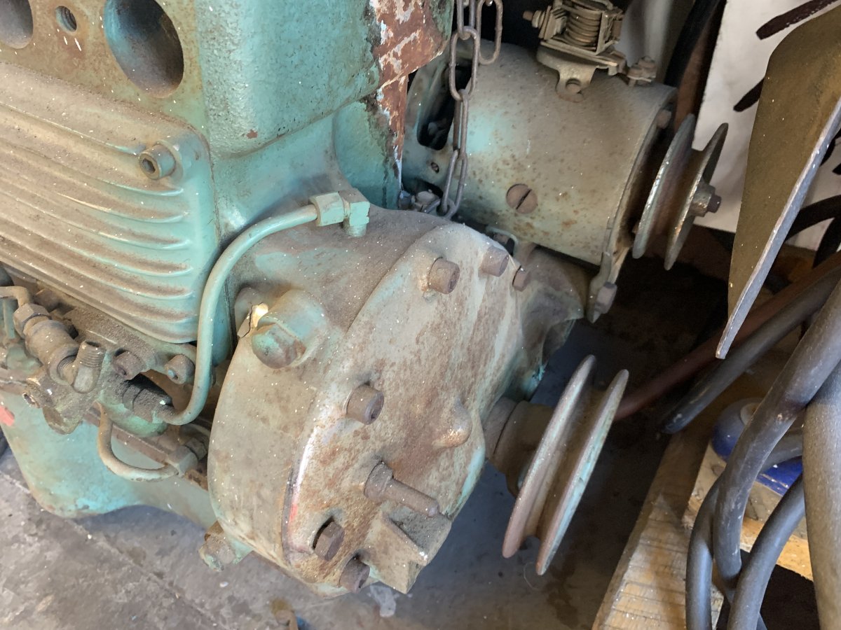

    I just picked up this A engine. i was told it was built in the 40's. I don’t know what’s inside, but it has a lot of coolness on the outside. Full pressure oil lines, chrome cam cover, chrome pulleys and a Cragar valve cover. What do you guys think of the oil lines? AFD63EB2-C1C2-4C0E-97A7-2F478B770840.jpeg 4B984666-CFAA-45EC-B710-02FDC825437B.jpeg

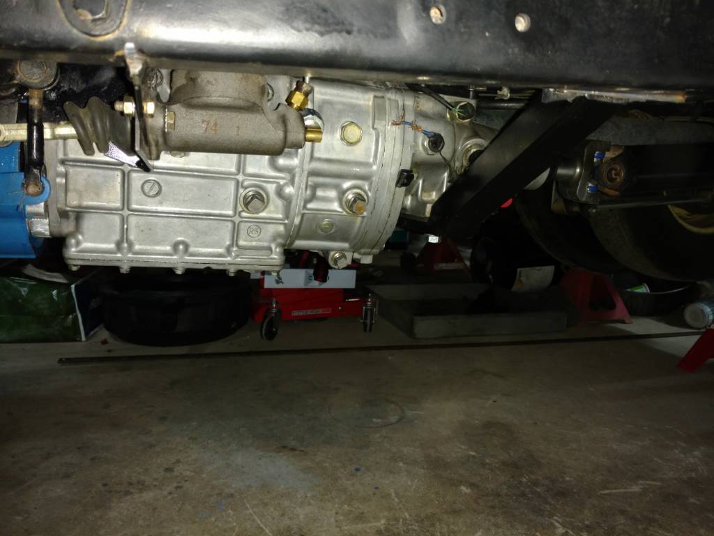

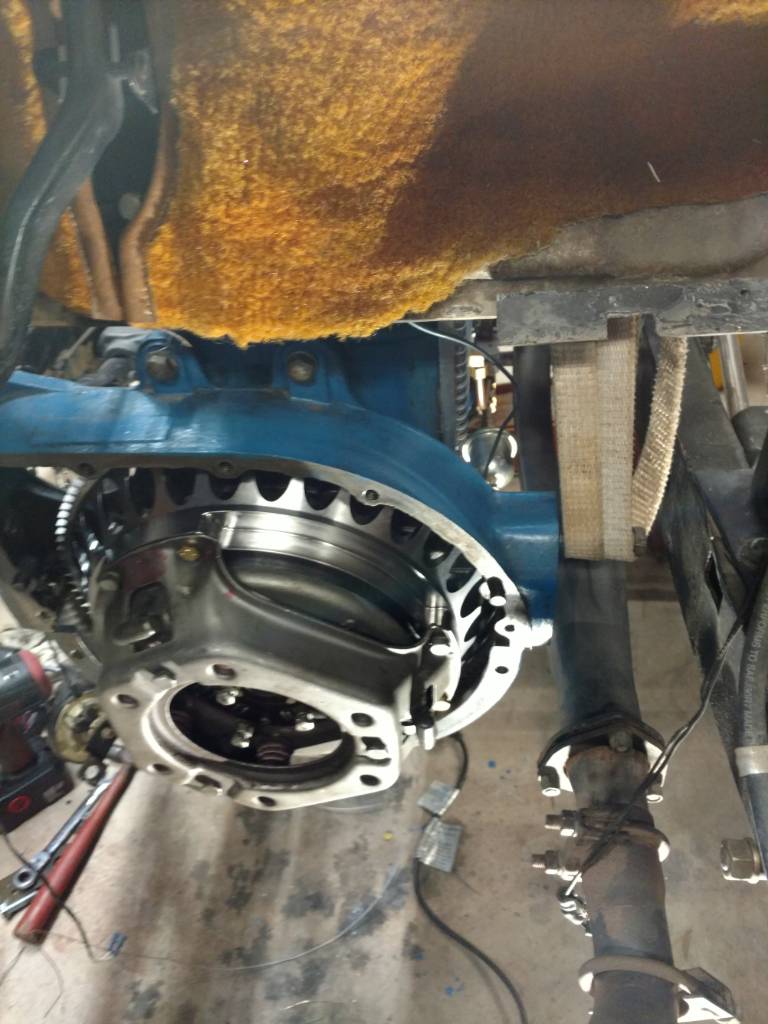

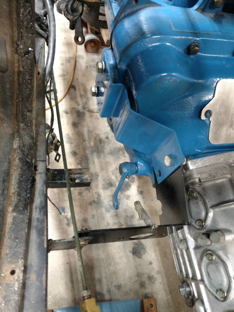

    Got the TK-5 into the '29 Roadster and someone was asking about a more drivable A with B motor and oil pan. It was pointed out that you have to make provisions for brake and clutch peddles. I addressed that and I will share photos of my solution.
    I am seeing how things fit up. The TK-5 is a bit of a red headed step child as near as I can tell there is very little support parts left out there. It came to me on an engine/transmission combo that I got from a fellow HAMB'r that was removed from a '32 Cabriolet. It came with the bellhousing, which is out of cast iron. Don't know much other than it is old school and you need to use the shorter AA throw out bearing with this set up. IMG_20210131_155406688.jpg
    Figured I needed to try out a 22# Sterling, dynamic absorbing, flywheel on it. Yes, it got safety wire and Loc***e on the fasteners. That's like a belt and suspenders....
    I forgot that you have to remove the oil pan to exchange. There is a tab on the left side, lower part of the photo,
    A bracket for the master cylinder attaches here. The piece of tubing in front of it is for the cross shaft for the Model A pedals.
    J.Ukrop, Old Dawg, G Baese and 3 others like this.

    The wind is gusting to 70-80 mph and the internet is freaking out, so I thought I'd post and then carry on before I lost all and had to start over again.
    The pilot on the input shaft is 15mm on the TK-5 and 17mm on a B transmission. A 6203 bearing is 17mm bore, so a 15-17 mm bushing was three count, for less than $6.00 an Amazon, free shipping. Problem solved.

    The flywheel is drilled for a 9" Ford V8 pressure plate. I tried to find a 9" disc that had the 23/24 spline count. No such luck, so I used the Ranger disc which is 8 7/8".
    Install cross shaft and throw out bearing and stab. I had to re-clock the arm for hook up to the clutch linkage as well as shorten it. You can see the first bracket I bent on my big *** vice by heating and bending. It attaches to the motor mount holes on the flywheel housing IMG_20210210_133807576.jpeg IMG_20210211_205013176.jpeg

    The bracket half that bolts between the tab on the frame and the back of the first bracket. The pedal cross shaft is drilled for the fastener on the lower corner of the bracket. I added grease zerks on the pedals. The bracket is hole sawed for the master cylinder. I welded the nuts to it for ease of dis***embly on the side of the road. IMG_20210212_081800658.jpeg IMG_20210212_101700798.jpeg

    Looking at the last photos, I should add that I drilled the brake pedal for a return spring and had to relocate the lever for the brake rod clevis. It is real short but the master cylinder is off of a Ford truck... Fruit jar style, 1" bore and all the ratios worked out well
    The brackets mounted ready for the pedal shaft.
    The pedal shaft and pedals mounted. I used a shaft locking collar to tighten up lateral play. You can see where the lever used to be on the brake pedal ***embly IMG_20210212_100948515.jpeg IMG_20210212_080255686.jpeg

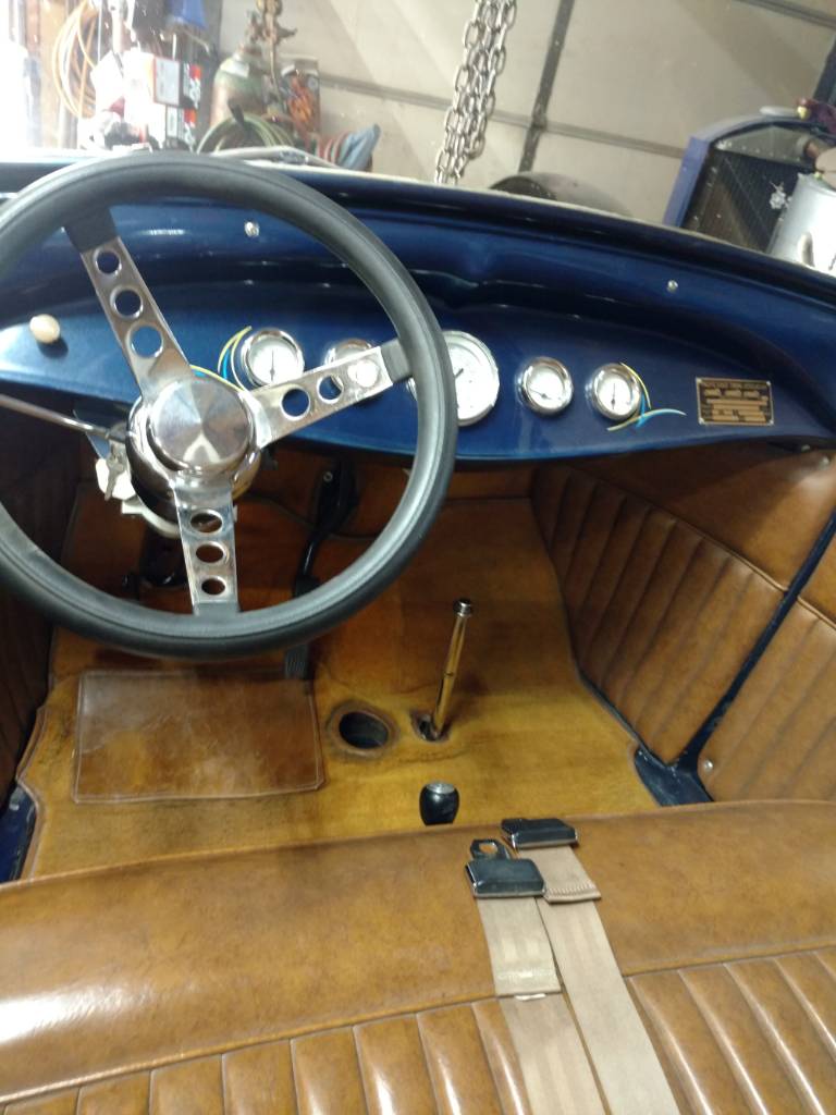

    I don't have a photo of the ebrake bracket, but it was a head scratcher to figure out. There is an interior shot with it back in its original location. Now if I move the shifter hole back.
    The new location is just in front of the seat.
    An under car shot IMG_20210220_140604375.jpeg IMG_20210220_154815802.jpeg IMG_20210221_143418442.jpeg
