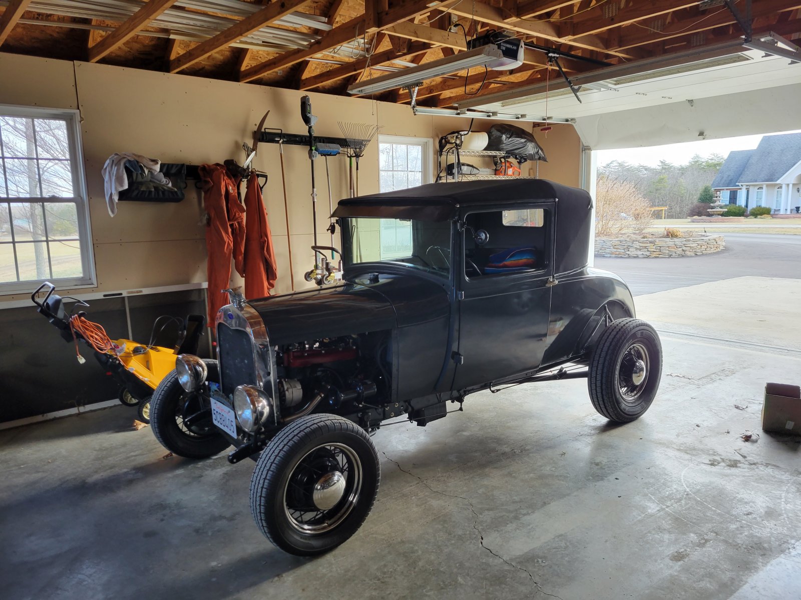

    Made it to WV...3000 miles on a pint of fuel!!.(he had others to drop and reload) Gonna have to get out and drive it some when it warms up..new kid in town,Im pretty sure I have the only banger in Capon Valley,but you never know.146 miles to Hershey,113 to Carlisle..haven't been to the Hershey meet since '75...

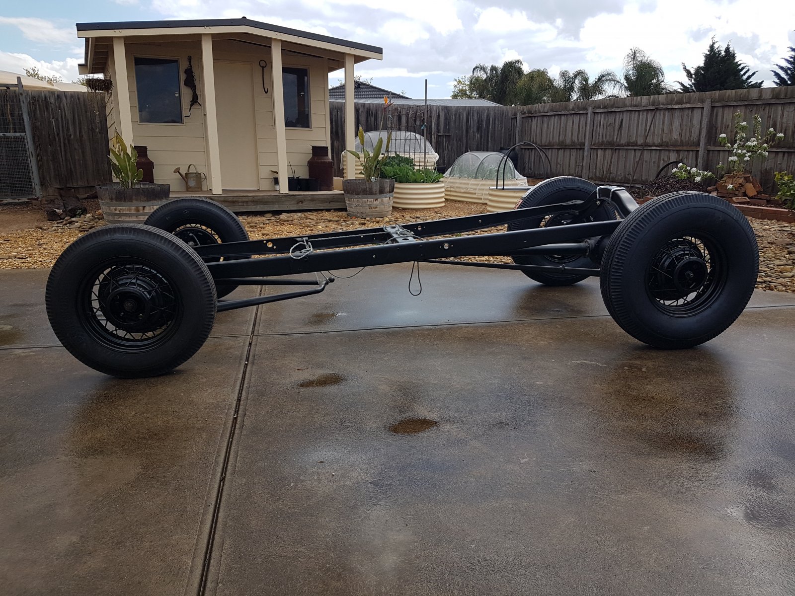

    Ive built a Model A ch***is running a 4" dropped SoCal front axle; rear suspension is a reversed eye main leaf and three other leafs on top and 4 cut short leafs under the main leaf to fill out the pack; juice brakes - not yet plumbed; 35 wires with 750 Firestones on the rear and 600 on the fronts. Im worried I have too much rake and would like to get the rear down more and am thinking about stepping the ch***is using the Tardel method (2 1/2"). Will the rear unsplit radius rods hit the ch***is when it bottoms out if stepped? Hoping someone has stepped there otherwise stock banger set up that can provide advice TIA 20191012_145249.jpg

    good looking job .....

    @Kewl65 have you thought about a T spring?
    My coupe sits approximately 5" lower than stock with no step-up in the frame.
    A friend had the original A spring's eyes reversed and the main leaf shortened and re-set to lower his coupe. but I have not seen that as yet.

    Speedway has a medium arch spring that may do WHAT YOU'RE LOOKING FOR

    TBH I didnt think I would get much more drop out of a T spring than I have out of my reversed Model A eye spring with the leaves rearranged and they are hard to come by in Australia
