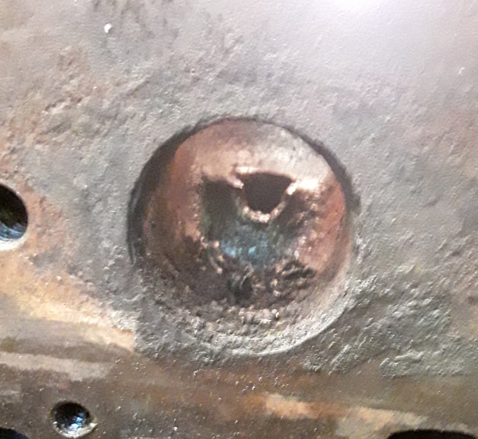

    1930 model a engine I was going to get overhauled - took things apart just to see what I have before bringing it to machinist and found the block casting damaged around all of the exhaust guides this one being the worst - Im sure its been like this for a long time with all the carbon build up it couldnt be seen until the guides were removed
    has anyone ever seen this? should I look for another block?

    If I'm looking at what I think I am seeing...appears to had water setting in/on it.....it may not be fatal
    Wire brush it real good...the whole deck and check for cracks or have your machine shop clean and magniflux as a first step. Wire brushing and putting your eyeball on it first could save the cost of a vat clean and magniflux.

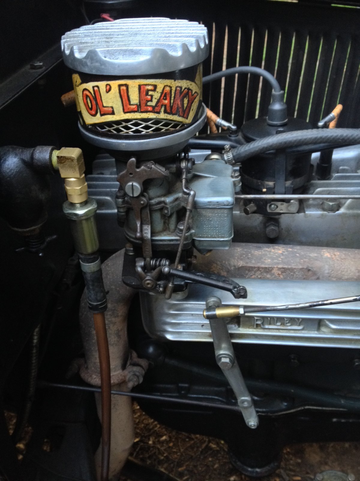

    I am looking at a pile of parts, blocks, misc. and a two port Riley while I am out here this time. I know nothing about Riley's except that some repops were made. I really don't need it but it will be part of the deal. Are these worthwhile and dependable or should I trade it off, any input would be appreciated either on here or send me a PM.
    Thank You
    Steve

    bringing engine to a shop in LasCruces they've done model a engines so he'll give me the "yea or nay" i have a bonded ***le with this serial # so hopfully its all good

    Hard to tell from the pic, but looks like a good candidate for pressing in straight valve guides and grinding out the guide hump...
