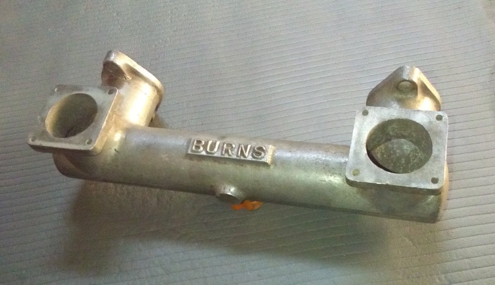

    Does this help?

    I think the Burns one posted by Dan might be about right.

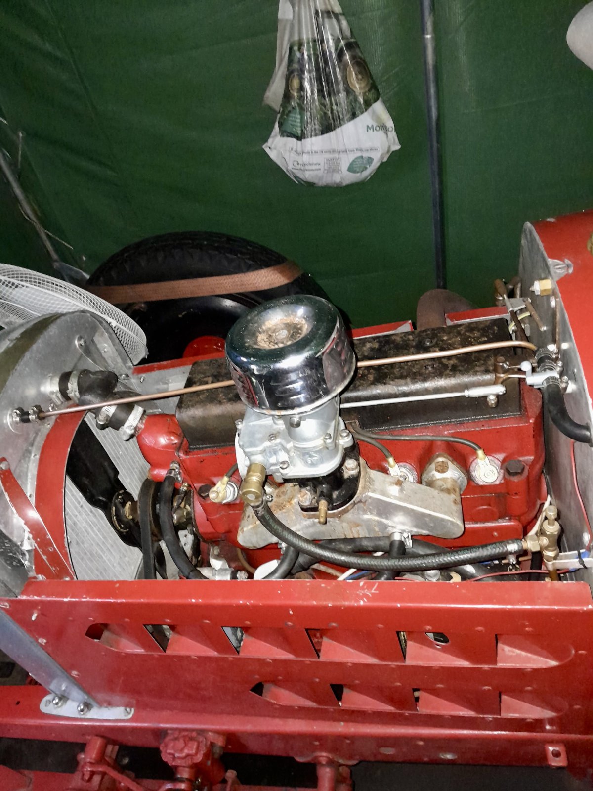

    You don't need much water flow, mine is taken from below the thermostat and has a 3mm restrictor at the start of hose line, and the return line still runs out very hot.
    So for neatness small copper brake line and fittings would probably work, and look better than my rubber hose.

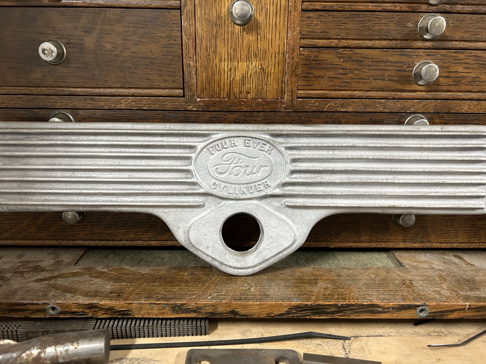

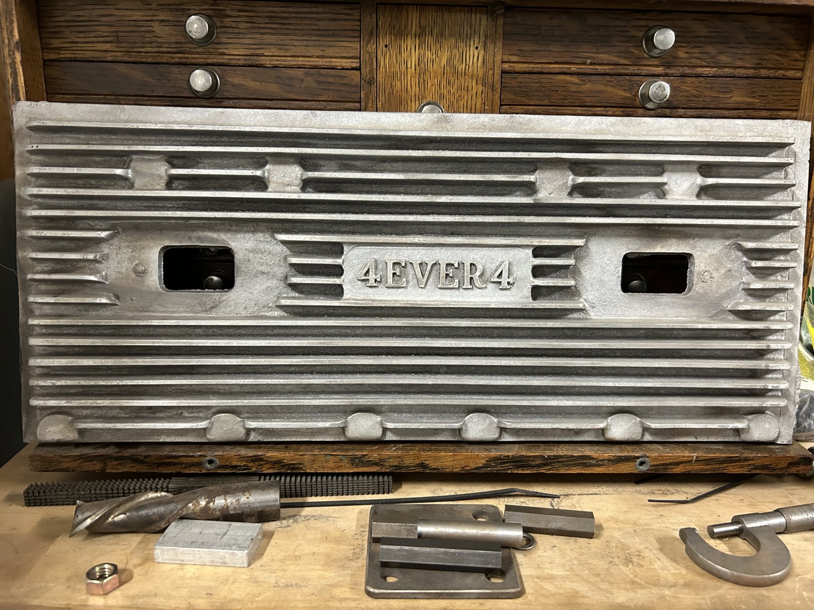

  18. Not sure you see too many of these

    The purpose of the restrictor is that the return hose goes to the bottom rad hose as that's the only way I can see to get a pressure difference to make the flow. Because my cooling is ok at speed but not really adequate when moving slow, I added a small cooler in line to try and stop adding heat to the bottom hose and maybe help the cooling.
    This didn't work, hence the restrictor, still a work in progress.

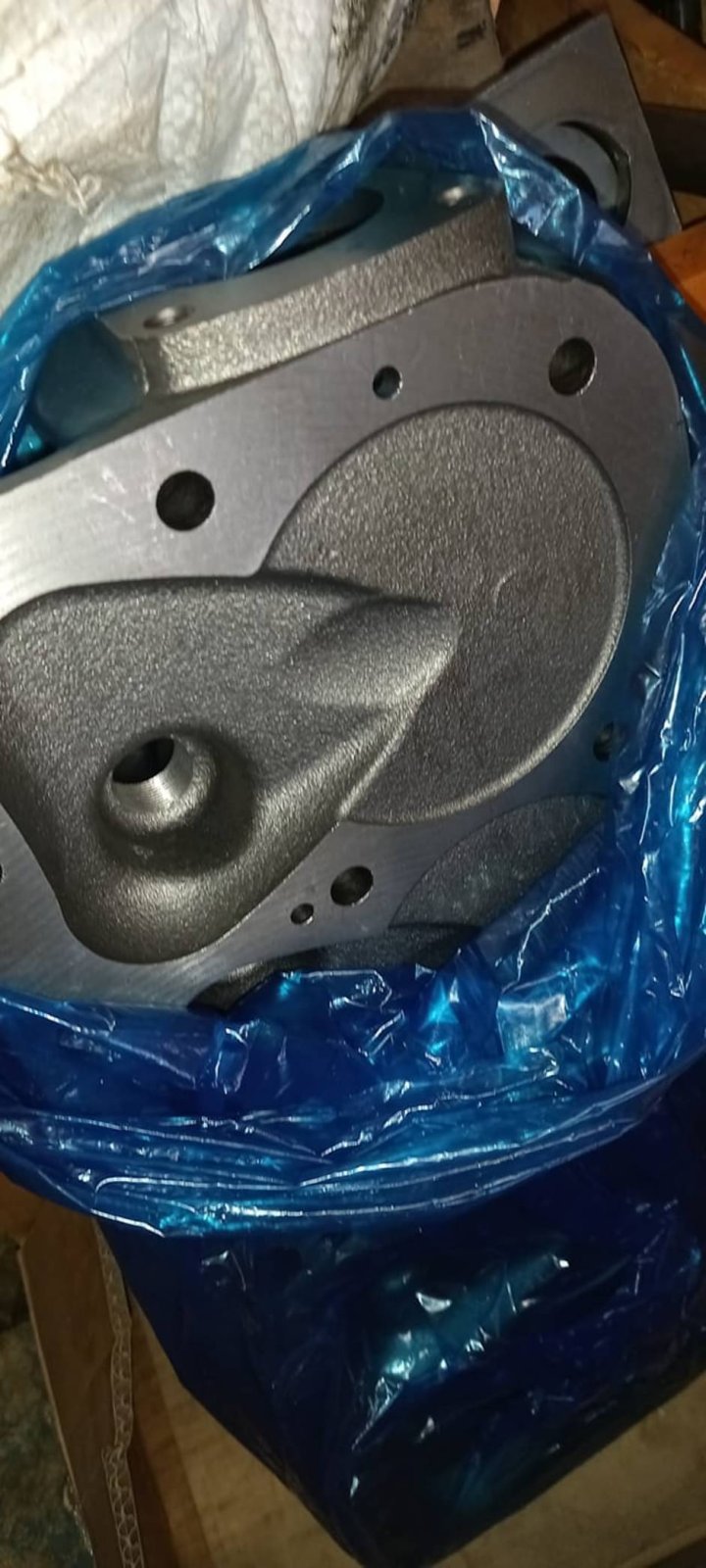

    Just wondering what you guys think about the Burtz combustion shape/design vs other options? img_2_1707644888517.jpg

  25. Nice opportunity to get quench, spark, plug location, over the top of the exhaust valve for maximum concentration of heat for combustion, I'm ***uming that little dimple in the middle of the combustion chamber has something to do with laminar flow. Not crazy about the spark plug pocket. Looks like it needs some polishing.

  26. With the spark plug pocket it's very similar to a 14.9 head. It's not ideal but it's to keep it looking stock on the outside.
    I've been trying one. I used plug adaptors and extended nose 14mm plugs to get the fire down the hole. And y'know what? It's not too bad at all. Feels plenty tourquey...

    That's good feedback, I'll be ch***ing a higher comp head at some point, but not necessarily ch***ing 'stock' looking. Having said that these are available down here.
    Phil, have you done the comp Calculations?
    A friend bought a '6.5:1' stock looking head from a local early Ford parts supplier & when he worked out the numbers it came in at 7.3:1 - not sure on pistons/stroke he has...

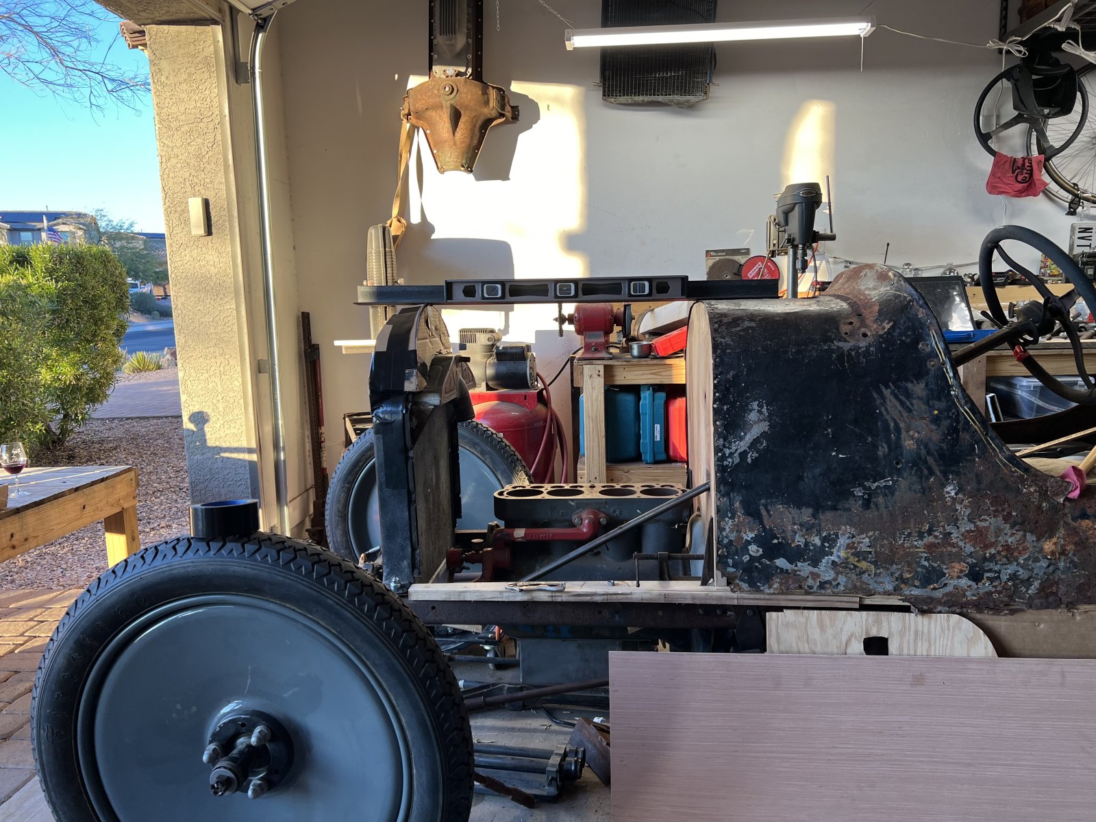

  29. A fellow model T enthusiast came by, got to do some mock up. Also started having an experience with the hammer and dolly. When the body was as bent as a Chicago politician, even a minor bit of learning helps. Thinking 6" in the center to start.

  30. Nope - complete charlatan. Slapped it on just as it came. Wanted to see what the complete Burtz kit runs like. Apart from a bit of porting...
    I used the recommended Egge pistons, so stock bore and stroke.
