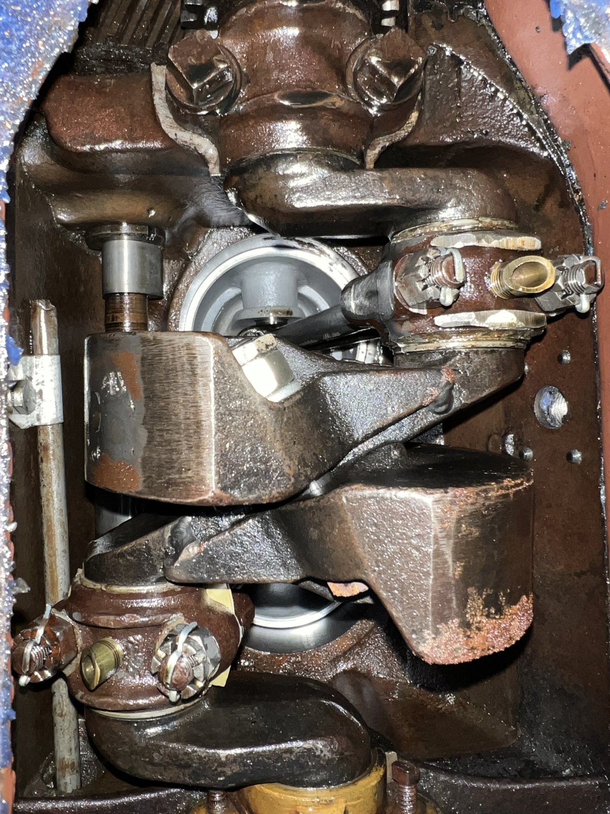

  18. Got an engine stand up and functioning. Mounted the engine and flipped it over. Everything looks very clean. The engine had no compression, wondering if the rings stuck? Any tricks at unsticking rings? IMG_0325.jpeg IMG_0324.jpeg
    Old Dawg, 4BangerDean and winduptoy like this.

    I would question the valves before the rings if it had NO compression. Either way, the head has to come off to do anything useful. Nice collection of pieces though..........
    Old Dawg and fur biscuit like this.

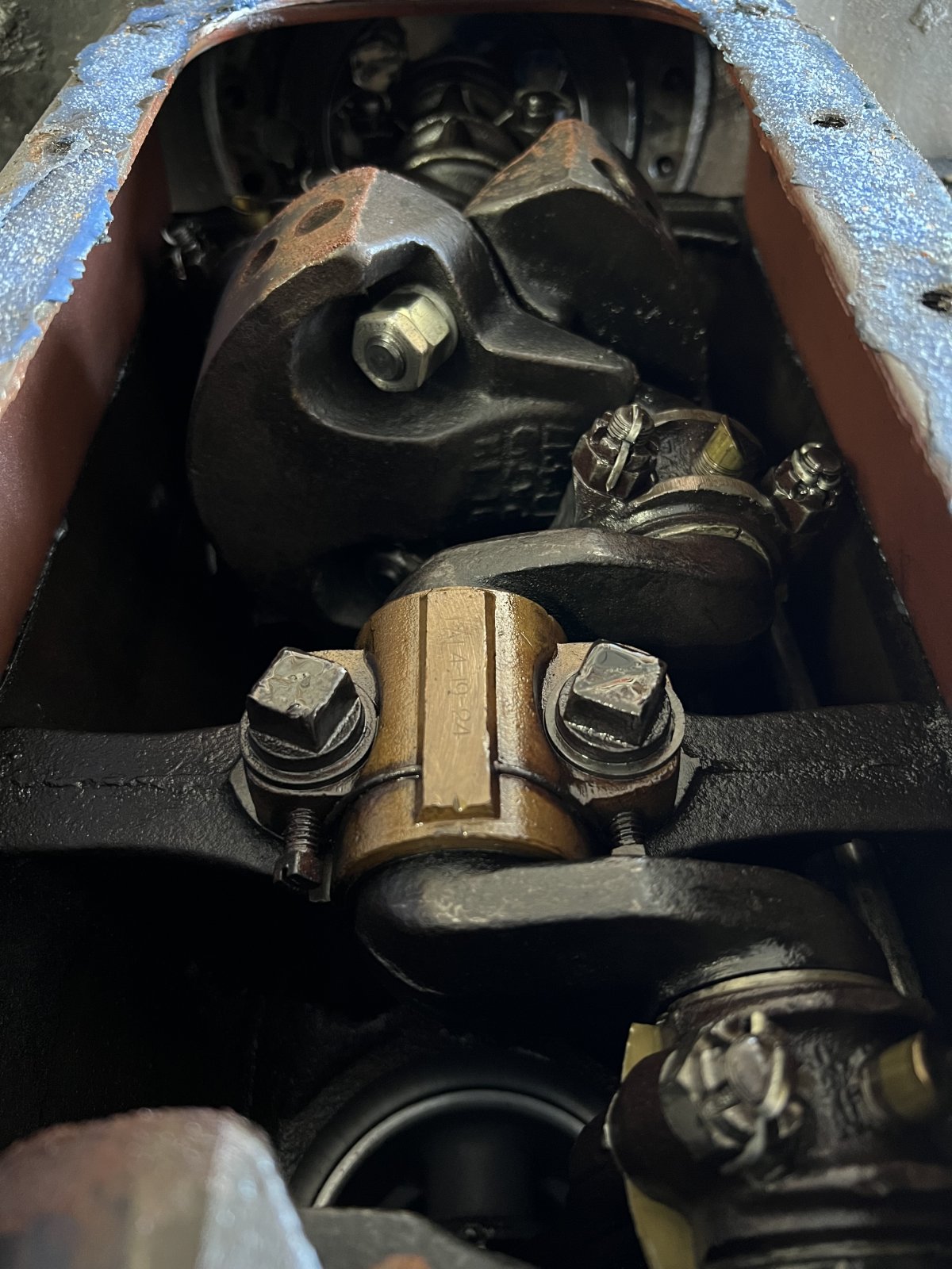

    I've not seen extensions on the oil scoops of the rod caps on the Model B engines i have taken apart. Any explanation for these?
  25. Dips for the rods, instead of the little pressed steel ones, who ever built this engine put a lot of thought into it.
    Old Dawg and winduptoy like this.
