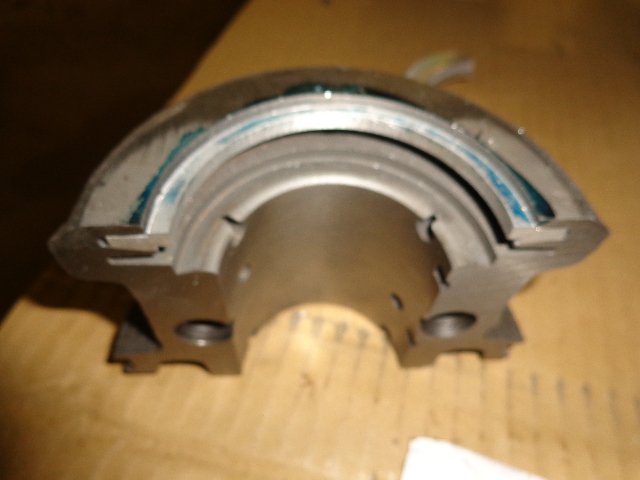

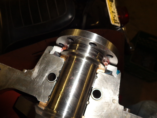

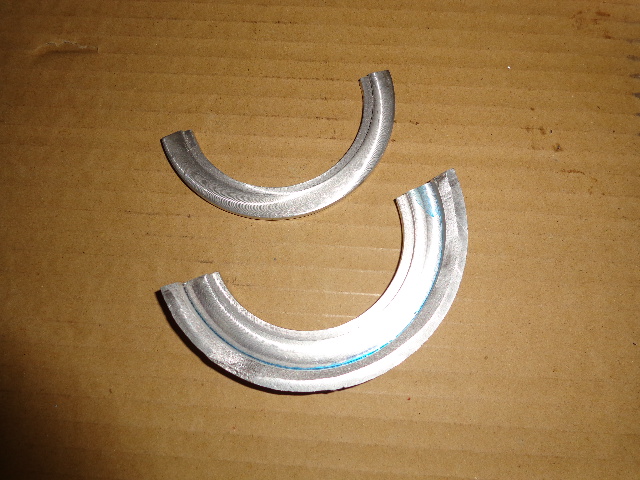

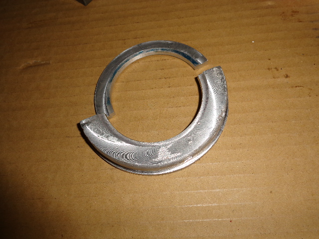

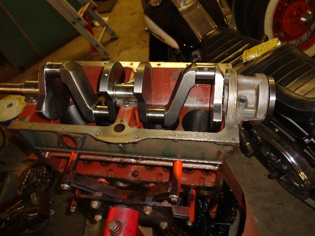

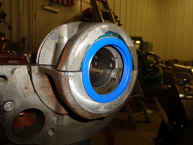

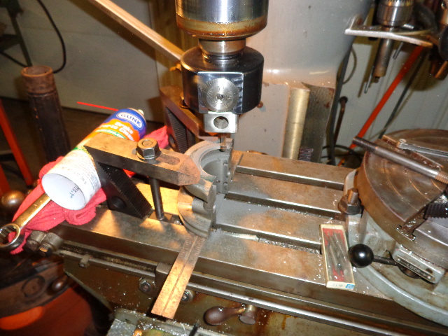

    Well, i finally got back to the rear main seal thing on my B. The second casting worked fine, much better. I ddi get a " beige" seal but it really didn't fit well. I used a chevy 350 main cap for my dimensions, the fine print on the beige one said it was oversized for a 400, no problem the blue one fits perfect.
    I had to cut away the outside of the rear main cap to accomodate the seal, bored it 3.12", the only machining needed to my engine for this. An easy one, non critical.
    I made an insert to hold the seal in the outer groove from 3/8" aluminium plate. Much easier than working with a casting. Still it took me the best part of the day.

  13. Lazlobassett
    Joined: Apr 12, 2010
    Posts: 475
    Lazlobassett
    Here is two more final ones. I forgot to take pix of the upper piece being machined but well...
    I hope to put the motor together tomorrow...
    Cheers!
    Matt

    Looks good Matt,
    How do you like the fit of that crank?
  16. Lazlobassett
    Posts: 475
    Lazlobassett
    I think the Scat crank is about the nicest A/B crank I've seen. I hope to get it bolted in tomorrow and possibly fill all the other holes in that block, then I'll say for sure.
    I did plasti gauge the mains and they are dead on. I am using stock SBC rod bearings for the mains, 2 pair per cap.
    The crank came with a sweet set of H beam rods ( it is drilled for full pressure). I have a set of custom JE pistons full floating wrist pins, high compression ( 8.5-1). They are pop ups so I'll be running the Cragar head. I don't know which intake yet, they seem to be falling out of the sky around the shop these days!
    I am keeping my eyes open for another B motor to bolt the Riley 2 port on.
  17. Lazlo,
    Did you have to align hone the mains in order to use the SBC bearings?
    or have the block decked then align bore the mains?
    It looks like a nice setup, tell us how it runs.

  21. ebtm3
    Joined: May 23, 2007
    Posts: 837
    ebtm3
    Matt--
    Nice job on the seal!
    One suggestion. I don't know how much wear your Bridgeport has, but if it is the least bit tired you are better off working on the canter area of the table. If you trammed the head to the center of the table, then go off to the end and re-check you might find a surprising amount of error--especially with a heavy piece like the rotary table on the other end. Try it and see--a good way of determining amount of wear on table and saddle.
    Herb
