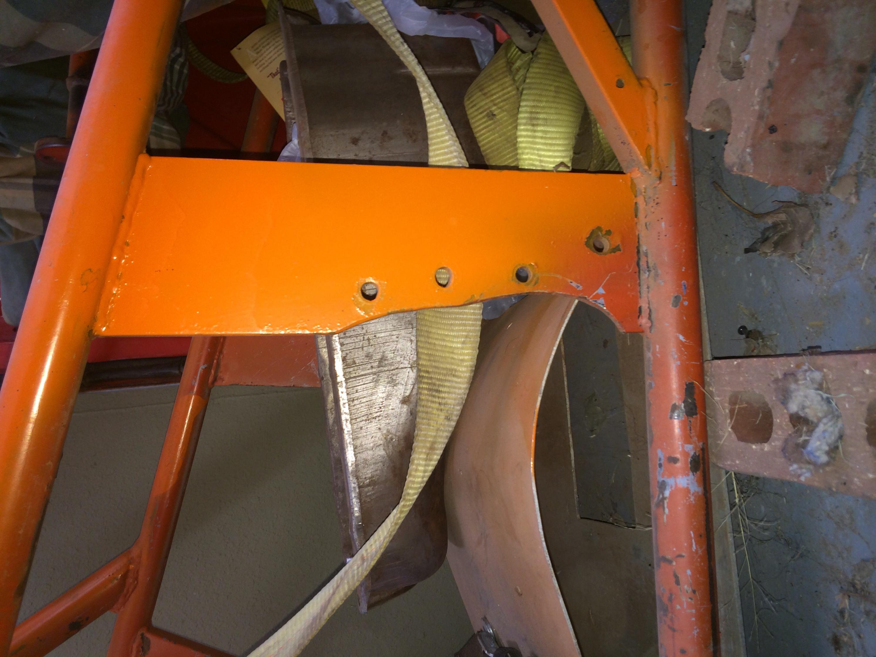

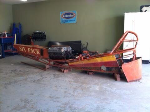

    Ok I'm new to the whole front engine dragster game. I bought this for a couple hundred bucks. Now I may be regretting that. I've been told it's not ever worth building. My question is shouldn't the rails be flat when sitting on the ground?

    post some pics without any body panels laying on it , and yes it looks wrong, shoot some pics of the engine area, Looks tweeked to me, Tim Jones

    Yes they should. Looks like it went nose up and came down hard. Appears to be an older chassis and not worth fixing. The gear box would be worth the $200 if it's undamaged.

    Its been on here and other boards before ----Junk

    The top rail at the front of the engine looks like it's been "cut". It's either a static display car, or wall art at this point in it's life. Butch/56sedandelivery.

    Yes, the bottom rails should be straight, it obviously took a hard hit. It depends on what you are going to do with it. I would not be too quick to scrap it yet. Even if you decide to build a new chassis, what you have will be a good reference. It will need updates if you intend to race it NHRA or with others and may then be too much to fix. If you just want a cool car to take to shows it will be alot less work to just fix what you got. Alot of guys build cars from scratch then call them old, at least you have a car that is obviously real. Be prepared for alot of work either way, if you fix it or start new. My rail is nothing crazy, but its real, we have a lot of fun with it at shows and on the track. People love em' because they bring back memories.

    Didnt take a hard hit to get like that---sombody was building it that way, Notice the openings for the rear end being real low to the bottom rail.

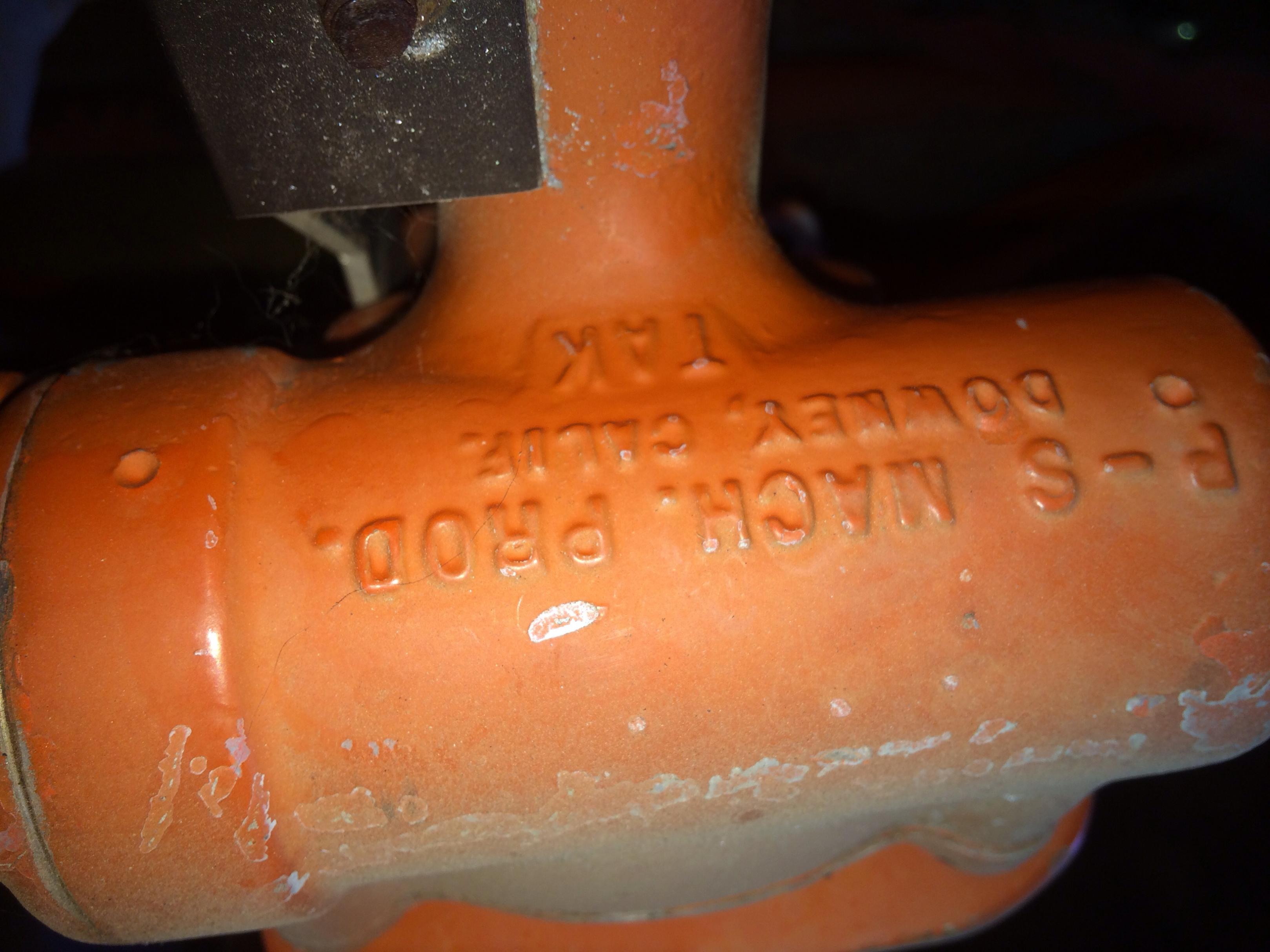

    Probably get most of your money back by selling the steering box if its a P&S

    Kinda hard to tell exactly what's going on from only one picture, sure looks bent. So not a FED, what is it then a sand dragster or something?

    I have seen the other pics from when it was posted last year, and has passed thru many hands at this point

    Couple more pics. Is this steering box worth getting some of my money back? Just curious what other boards did you see it on? Po said he'd had it a long time

    Cleaned up the steering box is worth $150+ if its not worn out
