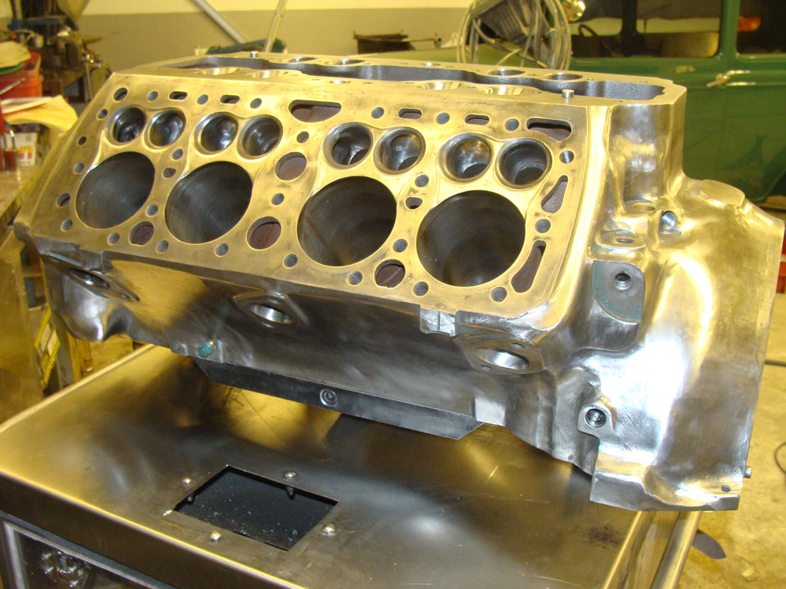

    For now, the Flathead is like this:
    1988 French Flathead
    Ported an reworked aprox like your first in this tread+some of my own ideas.
    New home made HQ. mains with girdle (Baron style)
    Moldex crank, 4 1/8 stroke.
    Crower custom billet rods.
    Kustom Ross pistons, reinforced for more load/pressure. Coated.
    Total Seal gapless rings.
    Manley Hi flow ss. valves. 1.6 inn. 1.56 ex. Will be undercut.
    Isky 185G springs, with ***anium retainers.
    Turned down stock valve guides
    And the Crower roller
    Reworked Offy .400 heads
    Home made blower inntake, from a Offy quad.
    A GMC 4-71 blower, pullys for 7% / 18% / 25% / 38% overdrive
    Hilborn 2 port fuel injection. for Methanol.
    4 th exhaused port out of the inntake.
    Vertex Magneto to fire this thing up:D!?
    Manually shifted C4 with transbrake.
    4.10 rear end ratio.
    Have the Hurst 10" slicks now, but will order a set of M&H 12.00x16",
    for the 11x16 American Mags.

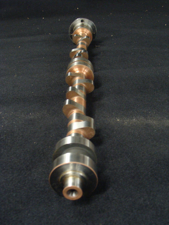

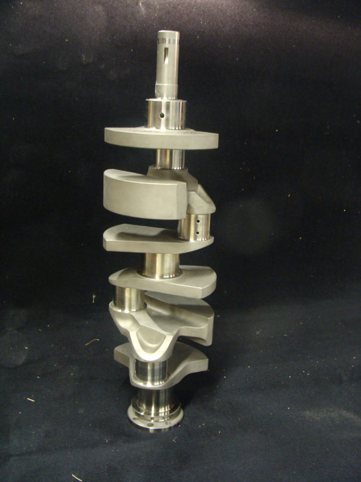

    That sure is a good looking crank, thats one piece on my build that I hope I don't end up regretting since I went with a **** crank, what kind of specs are on the cam? the crower roller I'm using is a .460 lift with a 280 duration and 110 lobe seperation, I'm wondering what your lobe seperation is and was it ground for the blower in mind? Good luck with it sounds like it should be a screamer.

    Sixcarb.
    Here are some specs. on the cam.
    0.458 lift, 273 degree duration, 112 degree lope sep.
    If you can, send me your tag, and i can send mine:)!

  5. Looking fantastic! I'm going to pop for a Moldex crank for one of my 'special' projects - looks like a nice piece. Given all the work and $$$ that go into these things, it is nice to have as strong of a lower end as possible.

  6. Lookin nasty - damn that roller has some serious lookin lobes. Then again, you HAVE been talkin to Dale -that kinda explains that !!
    More progress pix...pls !!
    I was wondering what kinda coin are we lookin at for a custom Moldex crank and what options can they come with?
    Rat

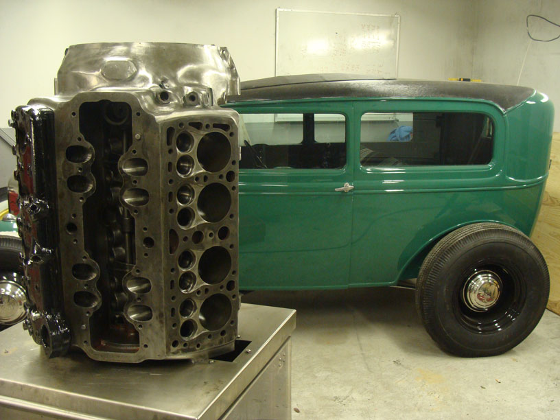

    Cool project Fenderless. Here is some inspiration for you. I snapped a couple of pics of this FED running at Brainerd this summer. He was running consistent 7's. The motor is setup for both nitro and methanol.
    He was running an original block filled with aluminum, and then the 4th exhaust pipe was cut out of the top. The owner claimed the top side exhaust pipe was good for a couple of tenths as it allowed for much better flow, but required a very custom intake.
    Good Luck and keep up the good work.

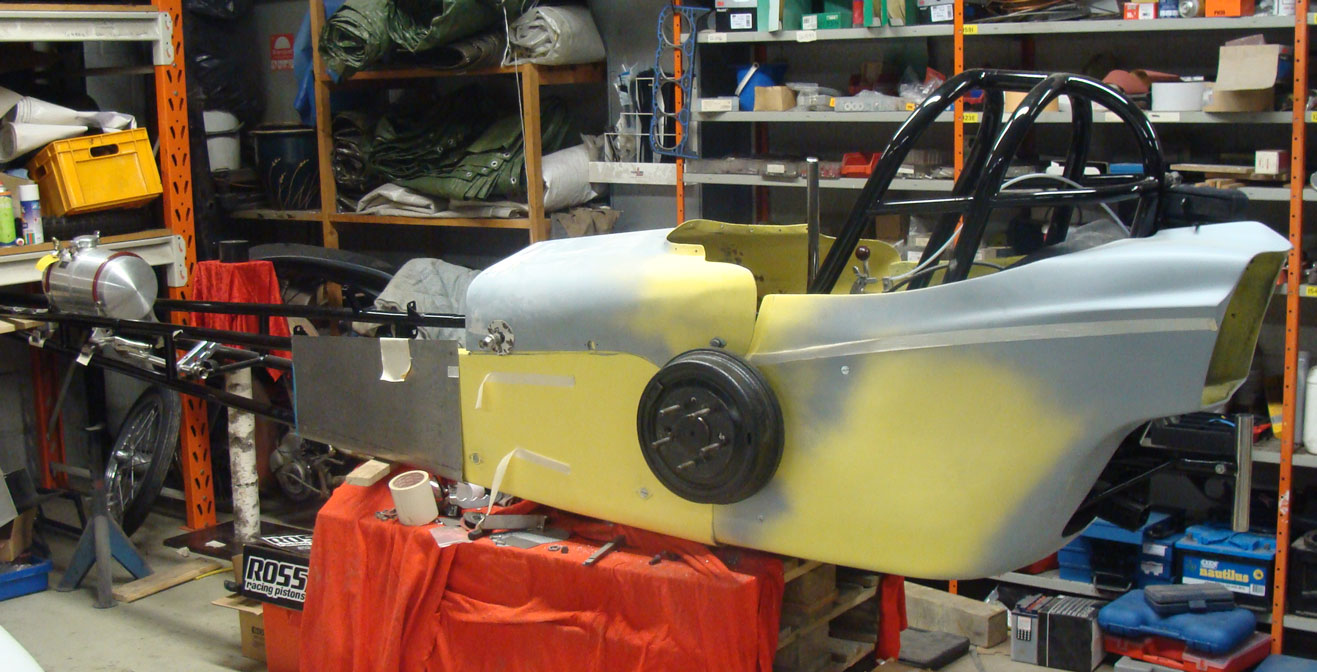

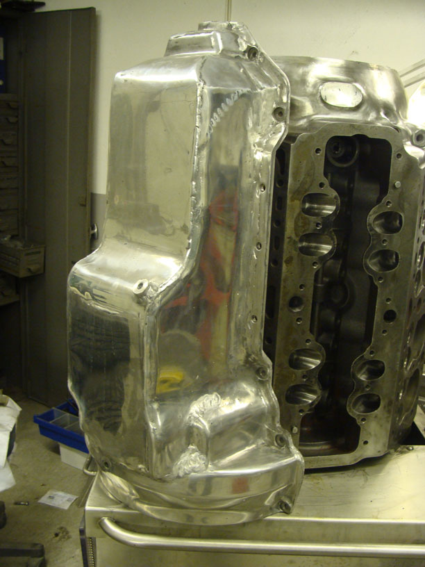

    Here are the last picture of the frame.
    Painted the frame black, then to find out that i needed a new bigger tank.
    Also need to make a new oil catchtank.
    The body is almost ready to be painted:)

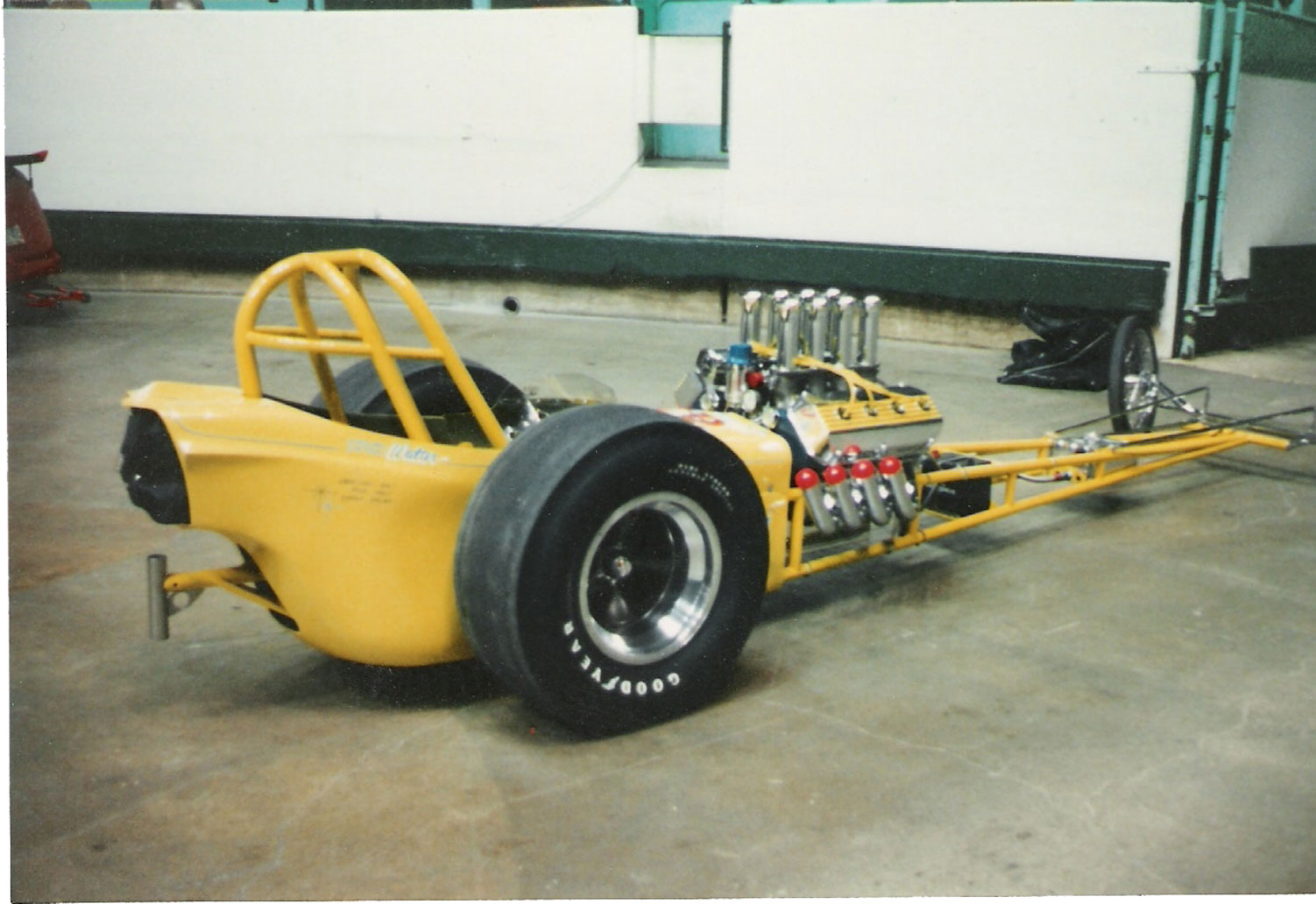

    More pics.
    When Don had it, NICE:)
    It was called "Mittys past gas"
    When i got it, new name, "Roadkill Express"

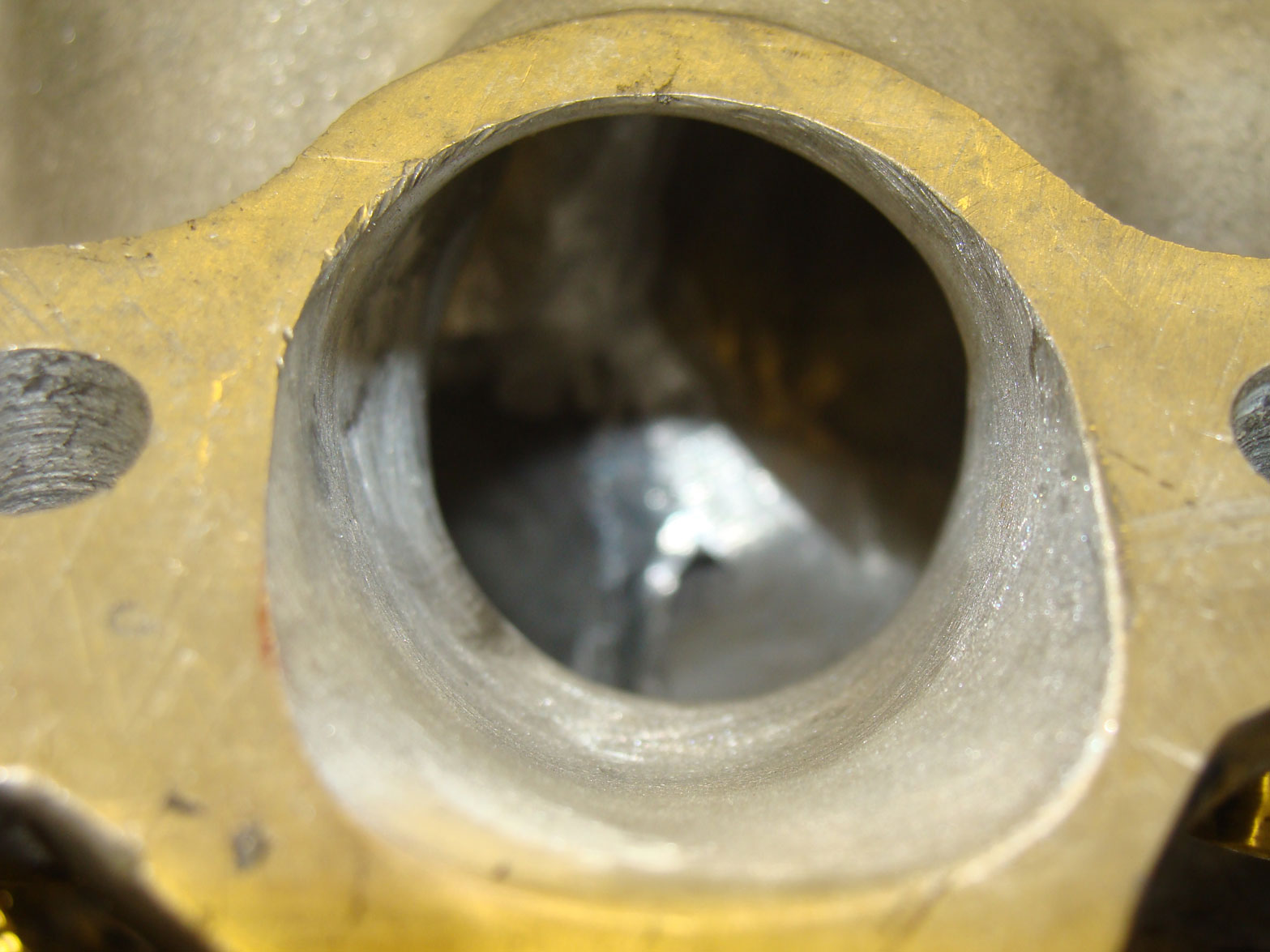

    A question, has anybody used locking nuts on the adjusting bolts on the roller lifters? Found out that my set of French hollow lifters had bolts that fitted the
    new Crower lifters, so thhis might be sorted out!!??.
    Also if anybody has used copper as intake gasket?
    All replacement intake gaskets are to small, as i have made the ports bigger.

    Copper works really well. Most drag cars ran it back in the day. Rick Schnell runs copper on the Slider (and can still push it out the sides).
    Keep up the good work.

    I will then go for copper.

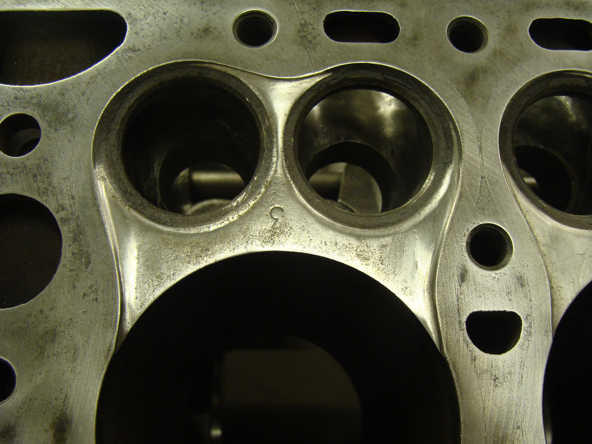

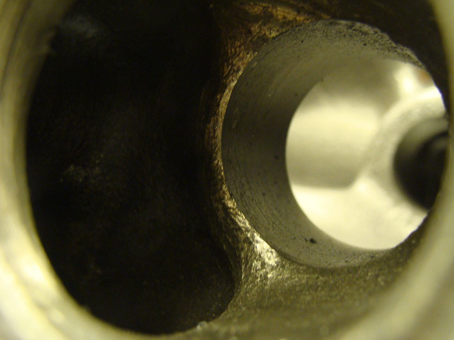

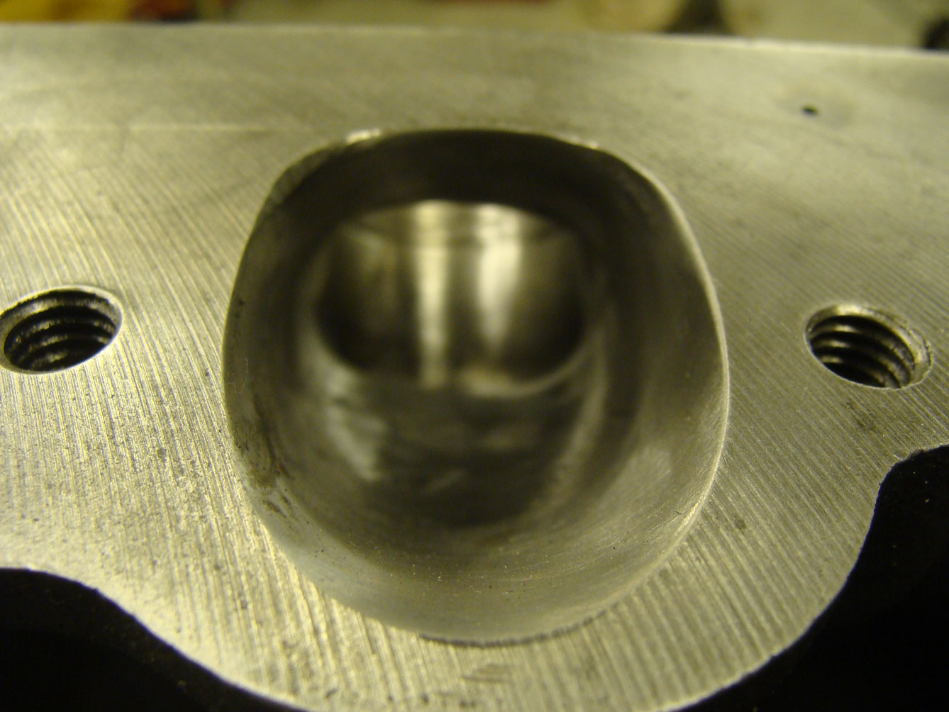

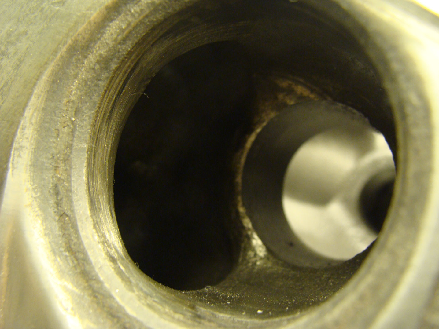

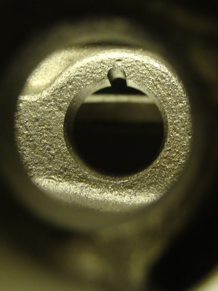

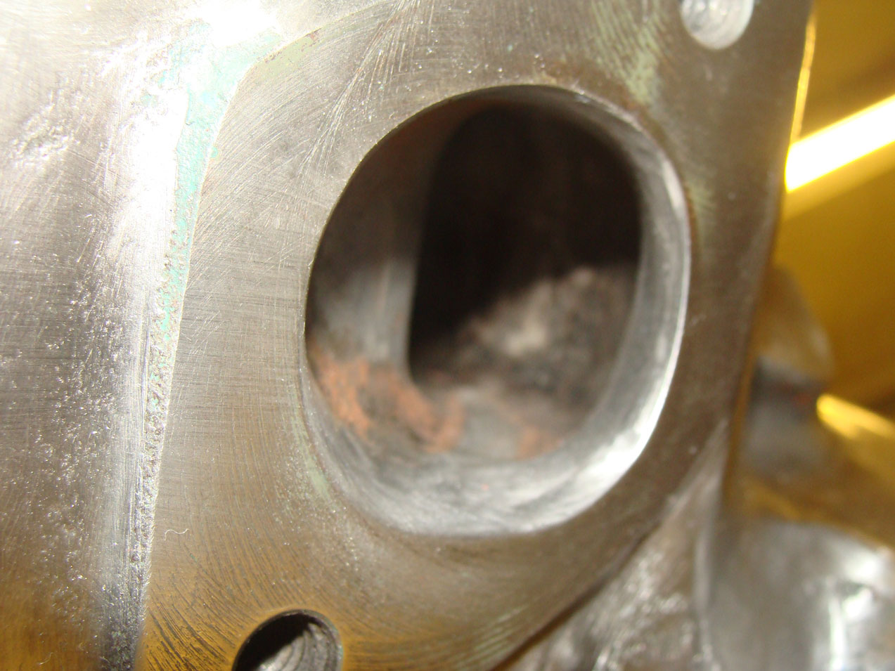

    Last evening i got some good working hours, did final match-porting and drilled the slots for the rollerlifters. Also found out that i had the adjustingbolts for the rollerlifters, (Crower don`t supply them when ordering a set). So now it`s just to pack it together, and send it to the
    machine-shop:)
    Her are some pictures of it, nothing new, just had to try to copy what everybody has done before me. I have just added some small stuff of my own, kept a litle more materiell here and there, just to be safe, as we are going for alot of pressure:).
    Carl, look under the valvecovers....:D

    good looking job Fenderless, looks like you spent a lot of time on the block.......

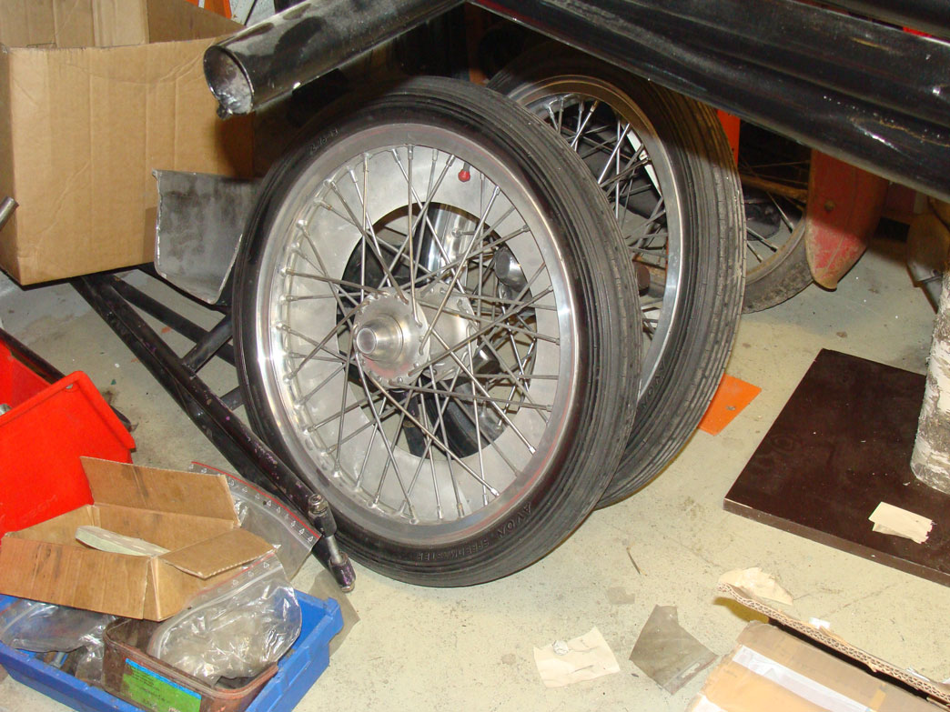

  29. This is likely a noob question but...
    Why is it that on a lot of FED's does the front right wheel have a fairing (or disk...whatever you call it)? Is this for some aerodynamic advantage?
  30. fenderless
    Joined: Mar 31, 2006
    Posts: 1,286
    fenderless
    from Norway

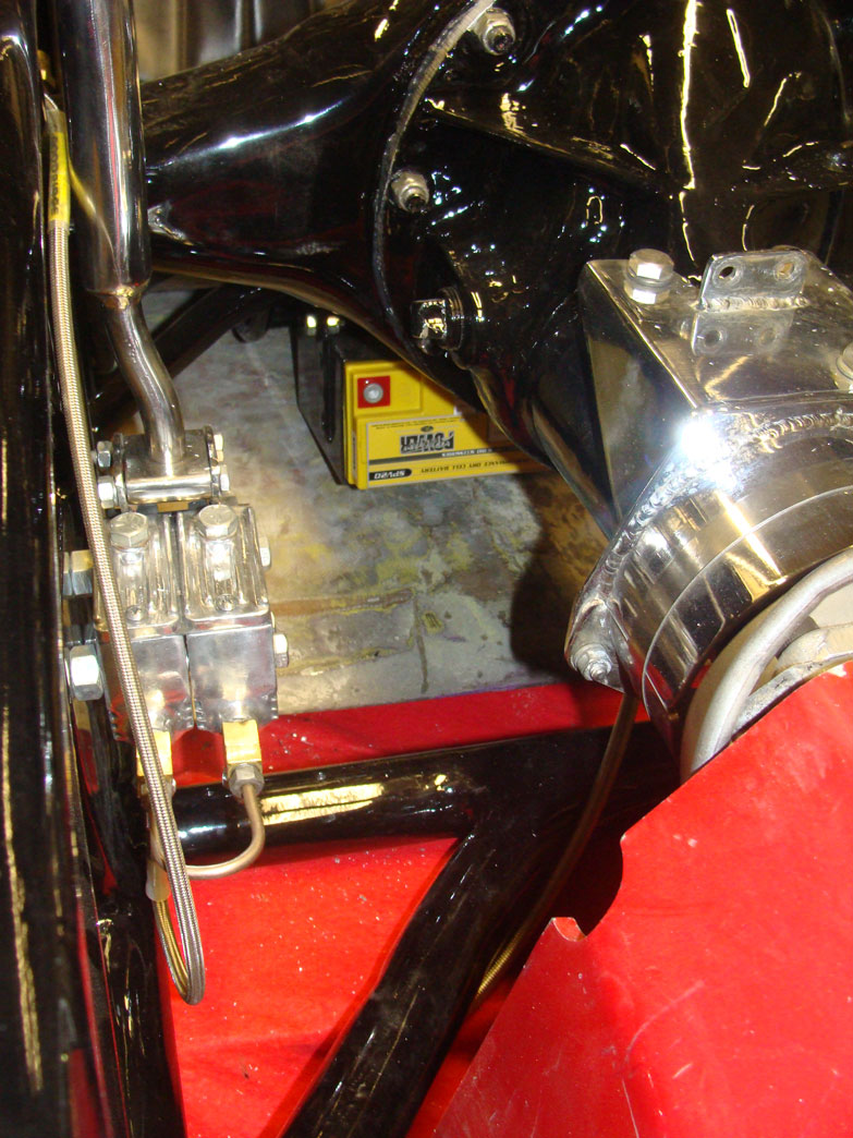

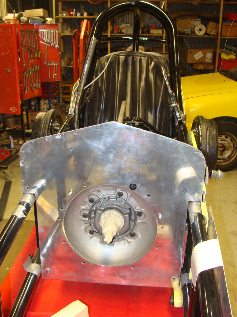

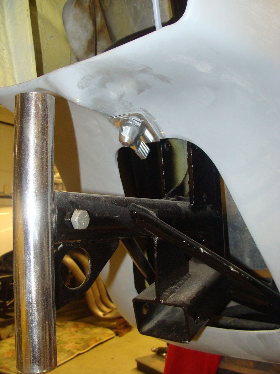

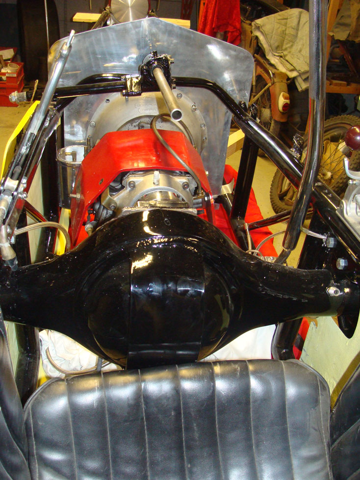

    Got some things solved & done on the ch***is today. Also found some parts that whent missing in the shop:):)!
    The disk is for breaking the stage light right on the xmas tree, oh dis i say xmas?:D
    More pictures here, since i have a small battery under the seat, i had to mount a killswitch, look ok as long as i hide it a litle.
    Last picture is of a really good helper when it comes to drilling & grinding, old Wynn`s cutting oil;)
