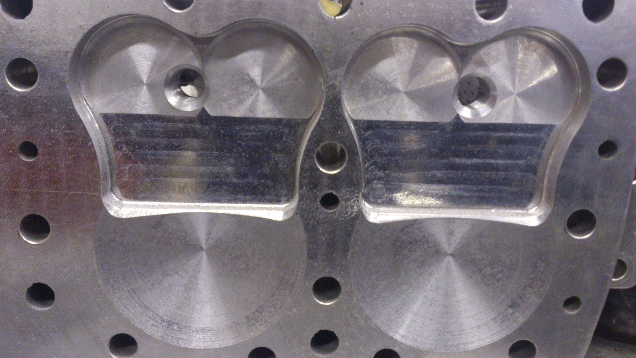

    Already some progress:)! Talked to Don at Hilborn, and they are on the case:)! I left an empty block and blower mounting-plate at Rogers shop.
    Picked up the new heads today, and they really are some nice pices:D!?

    Damn Kjell those heads look awsoooome............

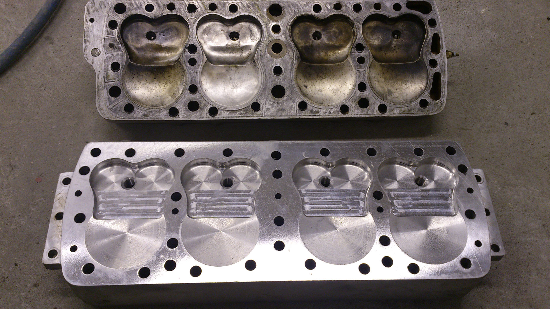

    Carl, those heads really look cool:D! Can't wait to mock them up:D!

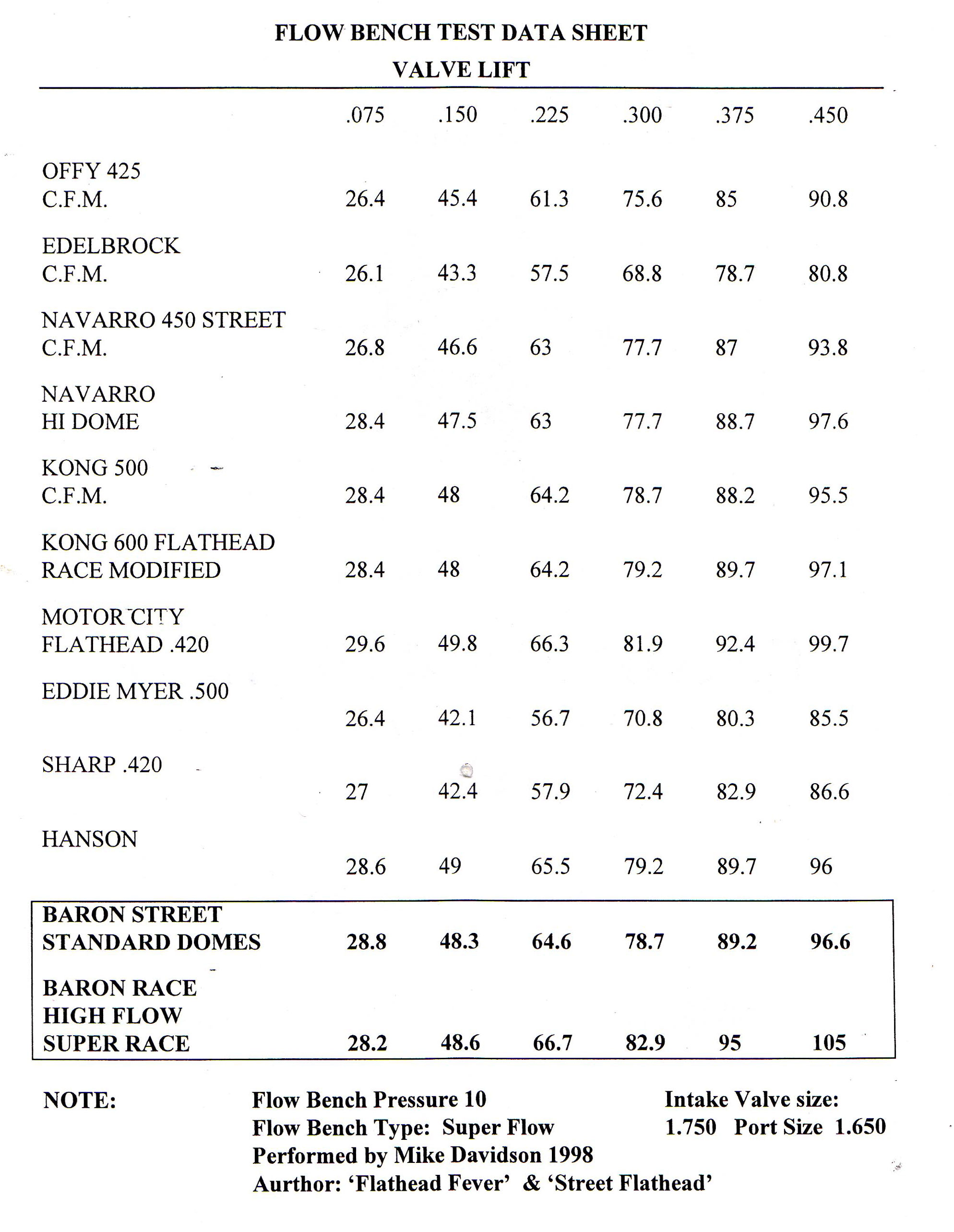

    Dale, If my memory serves me right, this Baron heads are one of the best flowing heads out of the box!? But the CR are lowered somewhat, could
    it be an idea to weld some material, and make them flow more like the Baron Racig heads? Or leave them as they are?

    Kjell, do you have accress to a flow bench? You could always add material like clay, until you achieve the results you want.
    Then, you could add material and trim it to what worked on the flow bench.
    I'll have the FlatCad and heads on the flow bench the 24th of this month. I'll post up how we do it, and the changes we make, if any, that gain us flow.

  17. Hey Kjell: What you should do first is put a head on your block (with a gasket) and tighten it down a bit and CC the chamber and relief area -- so you have an idea as to where your compression is at the moment. You don't need a whole heck of a lot of compression given that you're going to run some pretty heavy boost. You're better off with flow, than you are with more compression on a blown motor - as it will "stuff" the intake charge into the chamber.
    This style of Baron head is not his pop-up high-flow version - which uses a huge transfer area and a big pop-up piston (more along the line of some of our thoughts with the FlatCad). I've never had the opportunity to run both sets of heads - as you'd have to make custom pistons for the pop-up version, so you can't just swap the heads and dyno them side-by-side. Would be fun to do though . . . if I only had a dyno! :rolleyes:
    Try to get your piston to head clearances to about .040 or so - make sure you clay the top, bottom, right and left sides of the piston . . . so you can check it every place.
    Once you know you have your compression where you want it, then I'd polish the chambers.

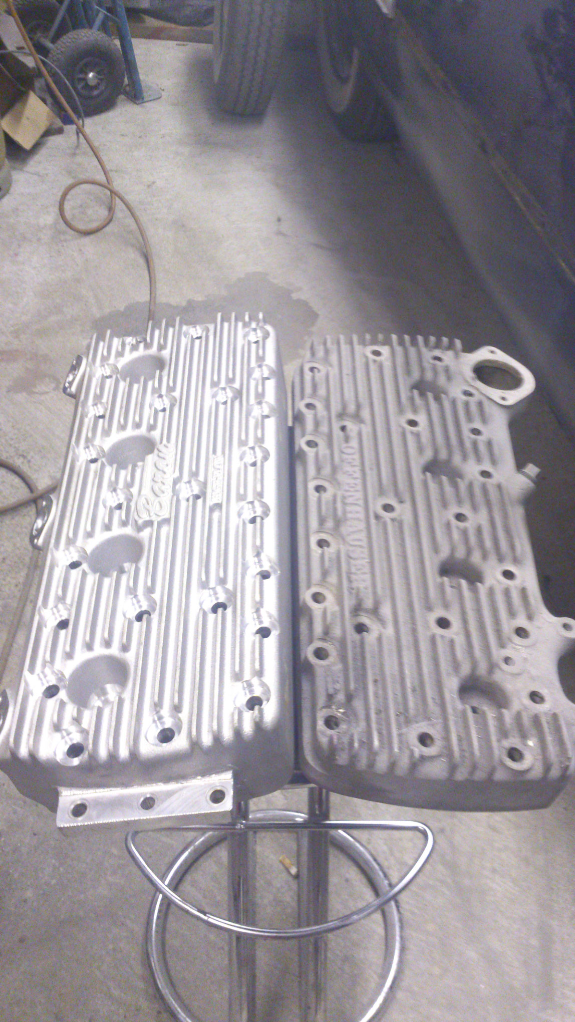

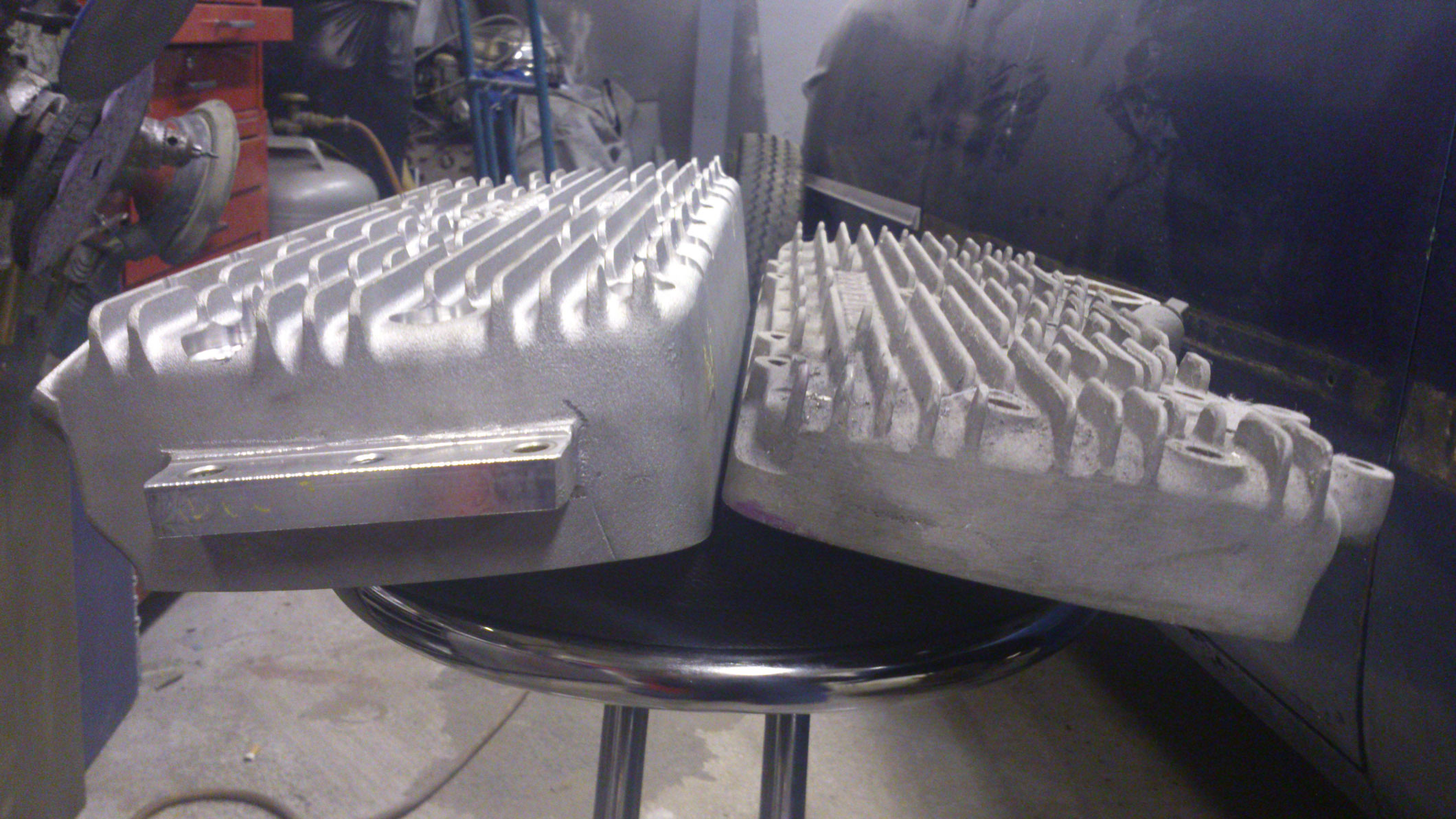

    Look at the old and new head. not too much diffrence!? :)
    Kjell
    Taildragger&fenderless

    Heads look cool!

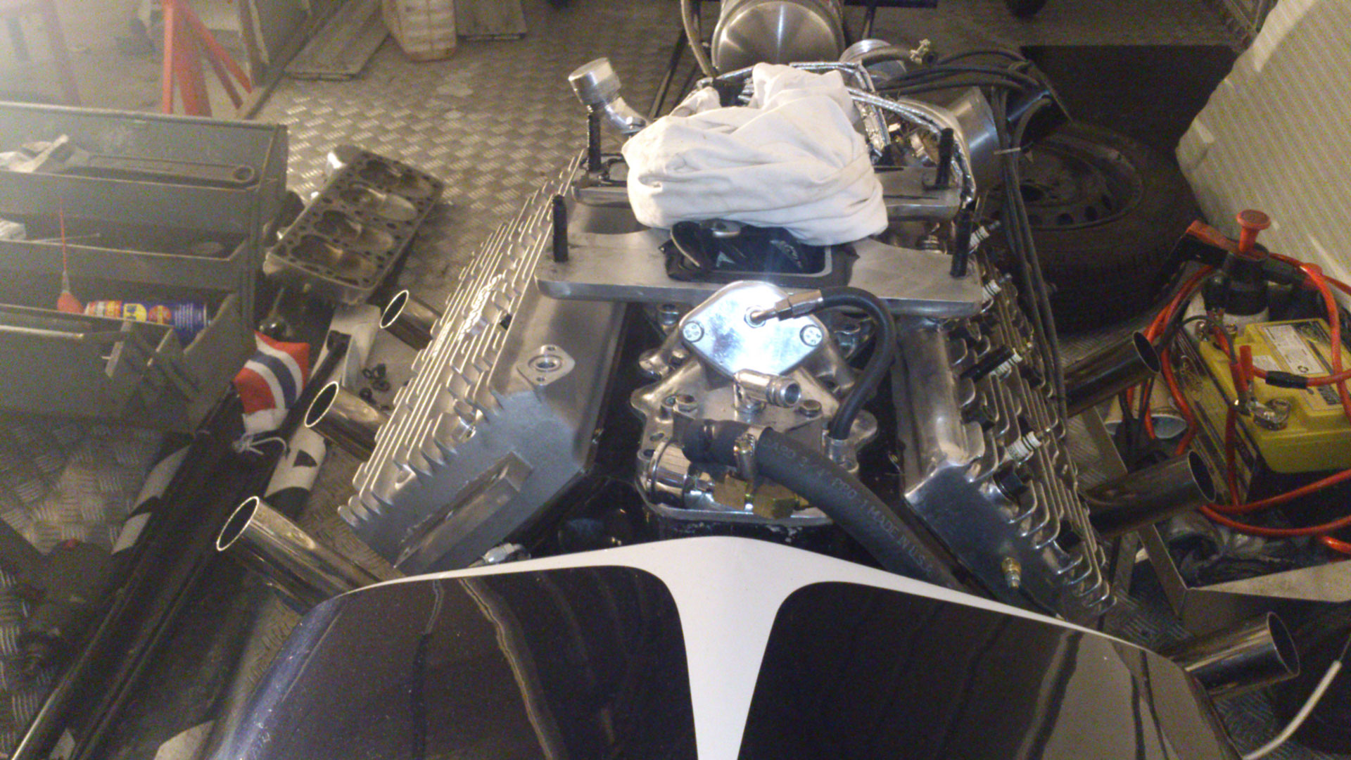

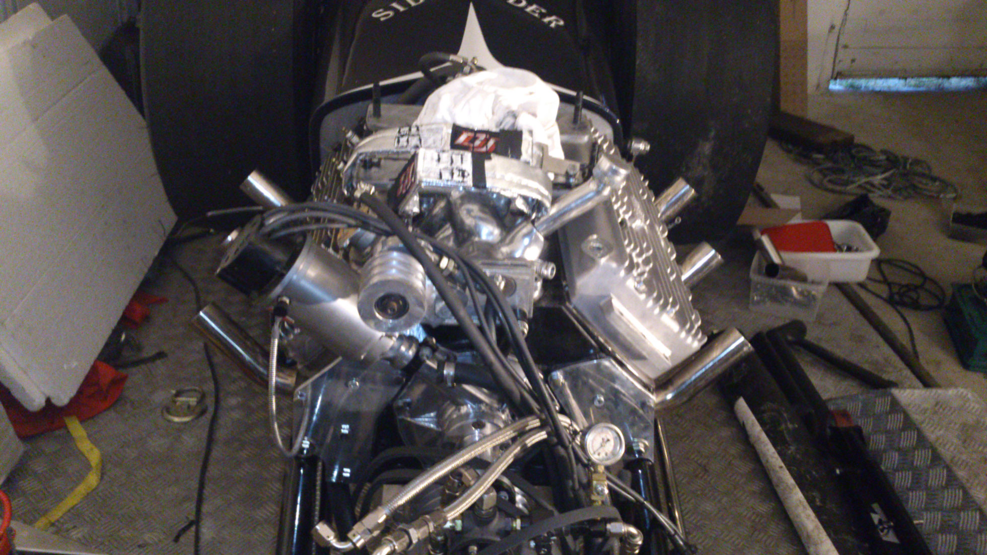

    A new intake is the solution, the idea is to make eight equal length runners i a small plenum, hopefully approx as lage area as the blower adapter plate.
    Hope this makes any sense:)!?
    The current head/intake/4th exhaust pipe, is not service friendly.
    With the Baron heads, we need to raise the blower, then make a new 4th ex. pipe at more angle uppwards. This will make it easy to service:)!?

    Thanks for the input Buddy:) New intake, but i might wait with the port nozzles!? Lets see what Hilborn comes up with:)?
    We'll make the new intake with tabs for the nozzles, so it would be easy to do if this becomes the solution.

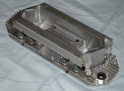

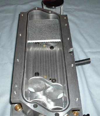

    Concerning injecting above and below the blower and the shape of the manifold.ffice:eek:ffice" /><O:p></O:p>
    The manifold I made for the Flat Cad has a flat surface onto which the blower dumps its air and fuel mixture. I had debated giving the bottom a pointed shape to channel the flow to the side but was concerned about puddling. And went with the flat bottom hoping that turbulence would keep the fuel suspended. Apparently that worked out OK for you Buddy.<O:p></O:p>
    In looking at Kjell's manifold I note that the fuel flow (which is not always the same as air flow) may have a tendency to byp*** some ports in favor of others thus causing a run lean in some cylinders and rich in others. <O:p></O:p>
    The manifold I made for my blown Ford flatty also has a flat bottom. ffice:smarttags" /><?xml:namespace prefix = st1 ns = "urn:schemas-microsoft-com[​IMG]Al</st1:personName>though it was originally designed to run dry; I found, to my suprise, that it gave excellent performance, all around, on the street.<O:p></O:p>
    In researching, Barney Navarro actually installed windows in an intake manifold of a supercharged flatty and found fuel running down the side of the manifold, which indicates that it would be very important to try in every way possible to avoid puddling in the manifold and even out distribution. A manifold similar to mine, with a common chamber at each end for the four intakes at each end that fuel could be directly injected into may solve the fuel distribution problem; or perhaps just blowing down on the flat floor would cause enough turbulence to keep fuel in suspension. I'm sure Hilborn will have some thing interesting to say on the matter. Here are some pic's of my manifold to more easily visualize. In my particular application I'm running carbureted and because the blower is not centrally located and was blowing down into the front four intakes I devised a baffle to divert and even out the flow. These are just my own observations (my own 2 cents worth). Perhaps it will be of some use to you, Kjell.<O:p></O:p>

    That is one beautiful manifold there Roy!

    I understand that your intake design works alot better, as it's completly open. My idea is in a way the same, but the opening on the 4-71 is smaller, not extending all the way out to the ports.
    That's why I wan't to make the runners go in a slight angle toward a plenum. This will also raise the blower abit, making room for the 4th exhaust pipe to clear the new Baron heads.
