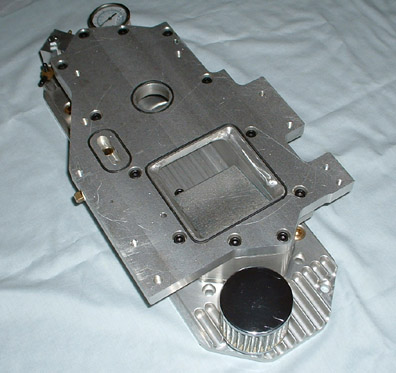

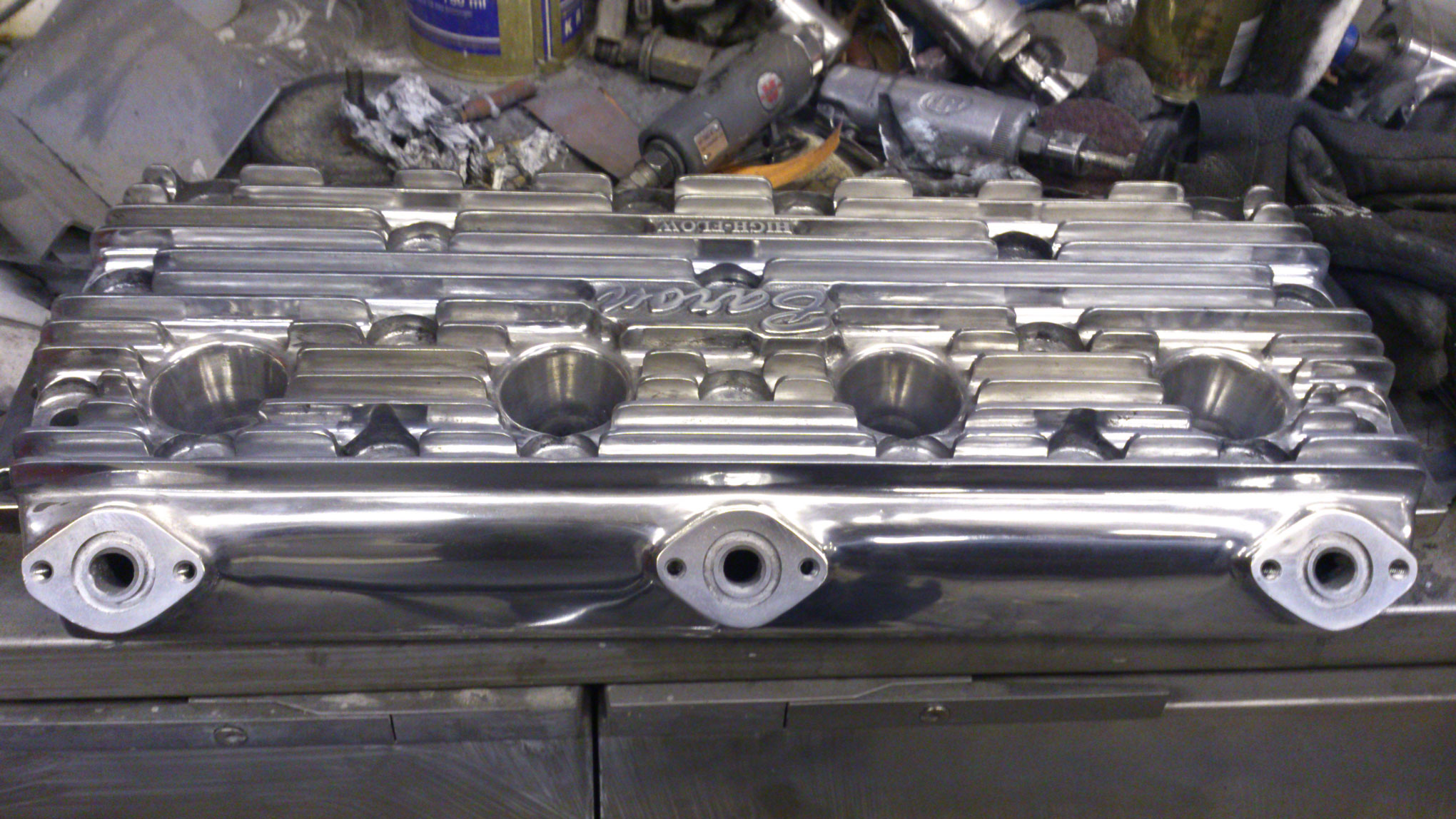

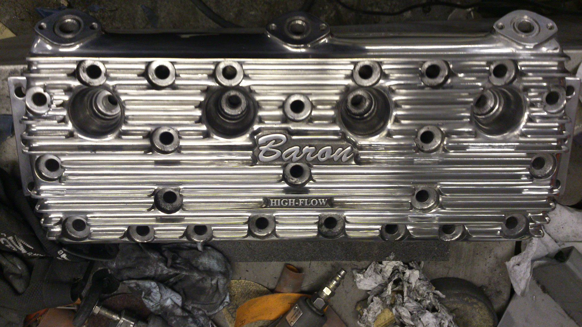

    The manifold I made is a rather elaborate CNC milled part. I'm sure from seeing what you've done so far that you could fabricate a welded manifold that would work just as well. The blower I'm using is not any bigger than yours, if as big. Here's a picture of the adaptor plate showing the opening.
  2. fenderless
    Joined: Mar 31, 2006
    Posts: 1,286
    fenderless
    from Norway
    Very nice Roy:) And yes we'r gonna weld one up;) Just hope this will work better, hopfully as good as yours!:)

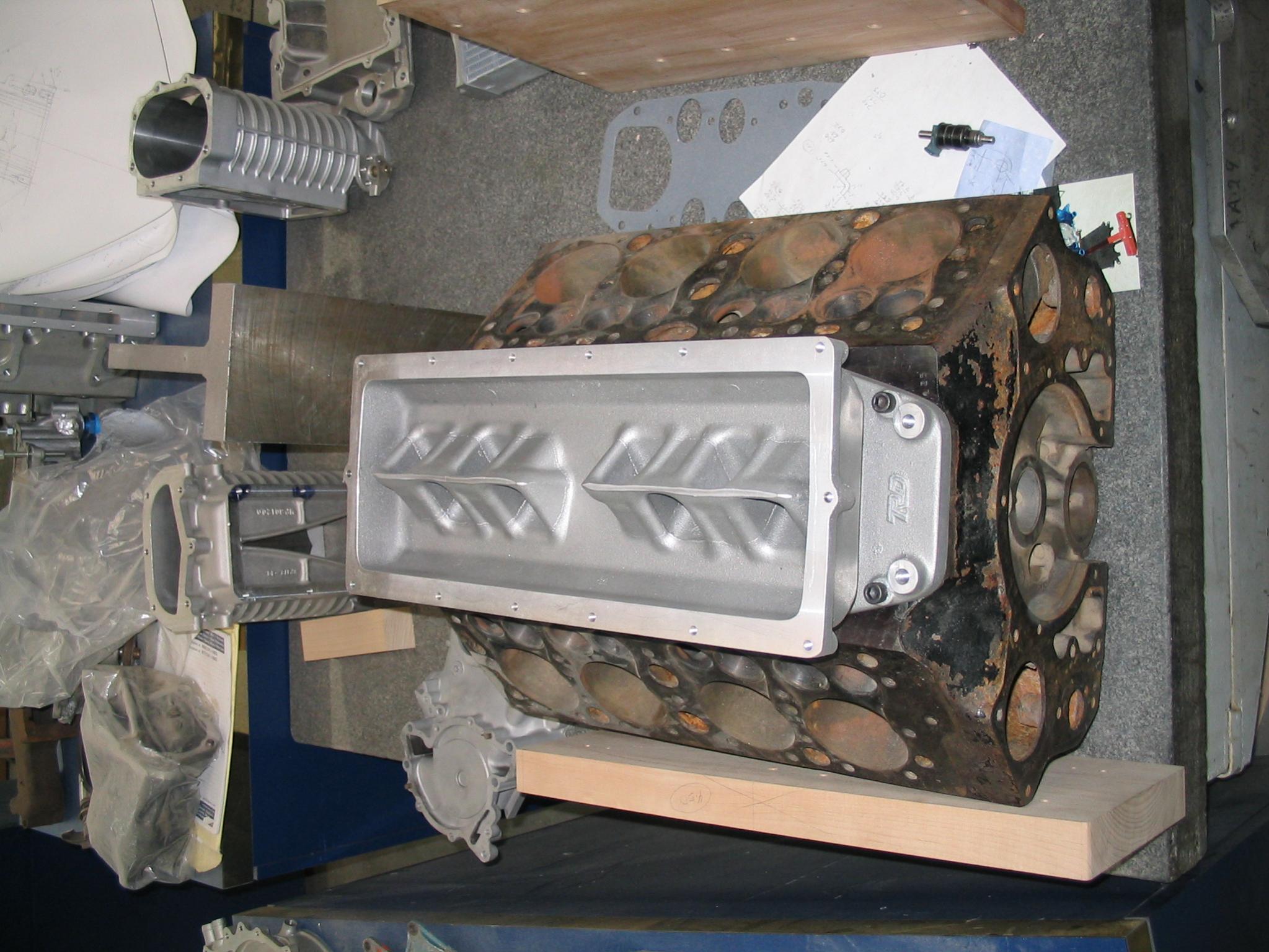

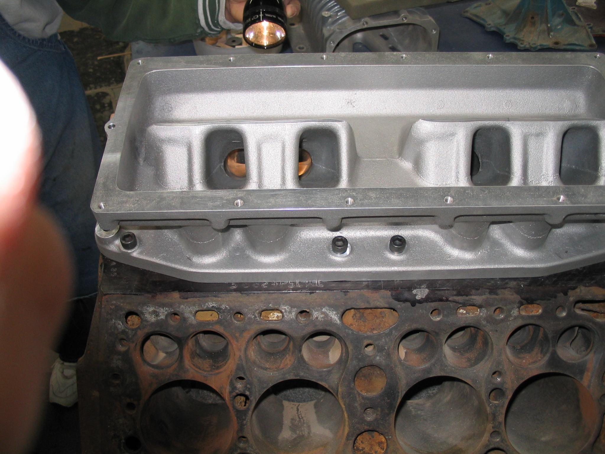

  7. If you're pondering a new manifold, you might want to get in touch with Tom Roberts. He's the guy that has done a lot of the patterns for Tony Baron and he has a really interesting manifold that I'd checkout if I was you. I happen to have one (I invested in the original run he did quite a few years ago). He also makes a lot of patterns for Magnuson - which is why you'll see his supercharger kit being offered by Magnuson and visa-versa.
    I like the concept of a cross-ram plenum . . . though I've never ran mine to know if it is any better than more traditional 'box plenums'. Does it work in the 1/4 mile - or maybe Bonneville . . . or maybe both . . . who knows.
    Anyway, see the attached PDF do***ent - with a couple original shots when he was designing it. You should give Tom a call for pricing. I you want some detailed pictures or dimensions from my actual manifold, let me know - can take them.
    Best of luck!
    View attachment TRD_Catalog-08.pdf

    Thanks Dale:) This was really interesting. At the moment my pockets are emty, so not much funds to buy alot. But I will contact Tom and hear what he has to say:) At the moment we are looking to make one.

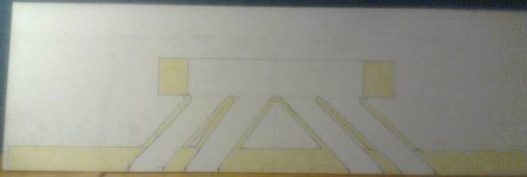

    Just an idea, make a similar style, but angle the ports toward the center, making the plenum smaller and fit the areal size of the output of the blower (4.71)!?
    The crossram plenum is probably better for the flow and matches the flow of the blower!?
    Thanks again Dale:)

    We have now desided to try making a new intake with 8 equal length runners into to a plenum, not that large. The crossflow runner idea is really interesting, thanks for the tip Dale:) We will consider slanting the runners to make the crossflow, but we will see if we kave enough space. We'r gona make a new mounting ange for the fourth exhaust pipe, making abit easier to take off the big Baron heads.

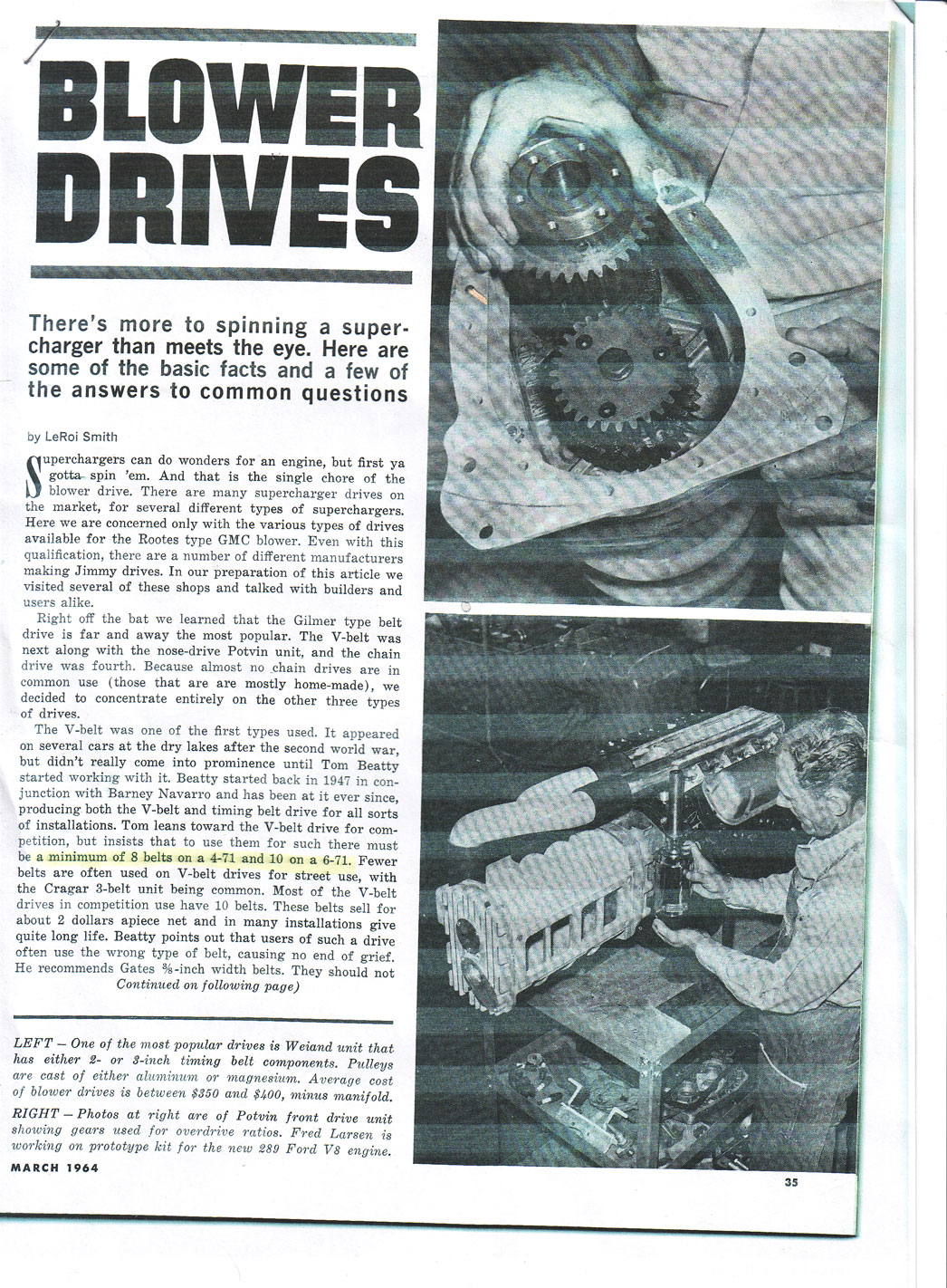

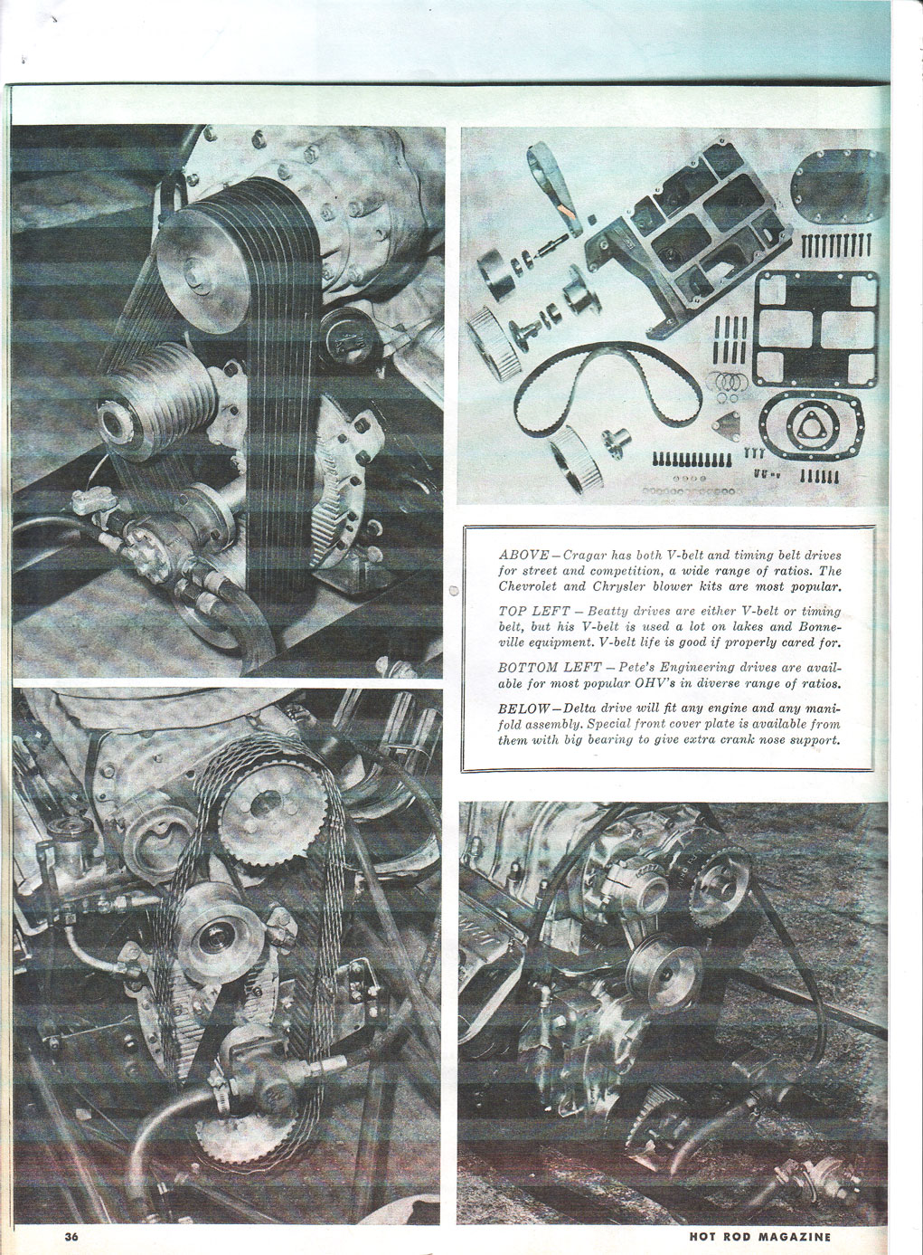

    While waiting for Grinder1 to have some spare time, I know I have to wait in line;), I have pondered about the blower drive system.
    Do we change to serpentine, or stay with 3xV-belts?
    Have gotten a 57 thooth magnesium lower pully and some other stuff from a Hemi. Just have to find an upper pully.
    I think we also need to make a crank support.
    Got this article from a friend in Sweden:)
    Taildragger&fenderless
  24. Happy Birthday Kjell - wish I was over there to toast you with a few pints! Do you think you'll make it to Bonneville this August?
  25. Personally, on a flathead like yours - I'd run a 2" cog belt and 1/2" pitch pulleys. You'll not need to worry about belt slippage. One thing to note, is that if you go this route - make sure you have a burst panel system in your manifold (can't remember of you do) - as the belt won't slip on a backfire.
    Should be a pretty easy thing to setup - if you want me to measure my crank hub, no problem.
    Dale

    The pully I have is with 4.5mm. I really don't want to have too much tention on the crank, so we just need to make some spacers to get it as close as possible to the engine. I was also thinking of making a lip, similar as on the Weiand vintage pullys. All this came to my head, as the new intake manifold will be abit taller than the old one.
    And YES Dale, I'm in the works trying to plan the trip to Bonneville and meet you for a cold one:D! Roger need to check with colleagues as school start around the same time. I also need to check out the work part. But we really hope to get this sorted out:)! Buddy has a room too:):)!
