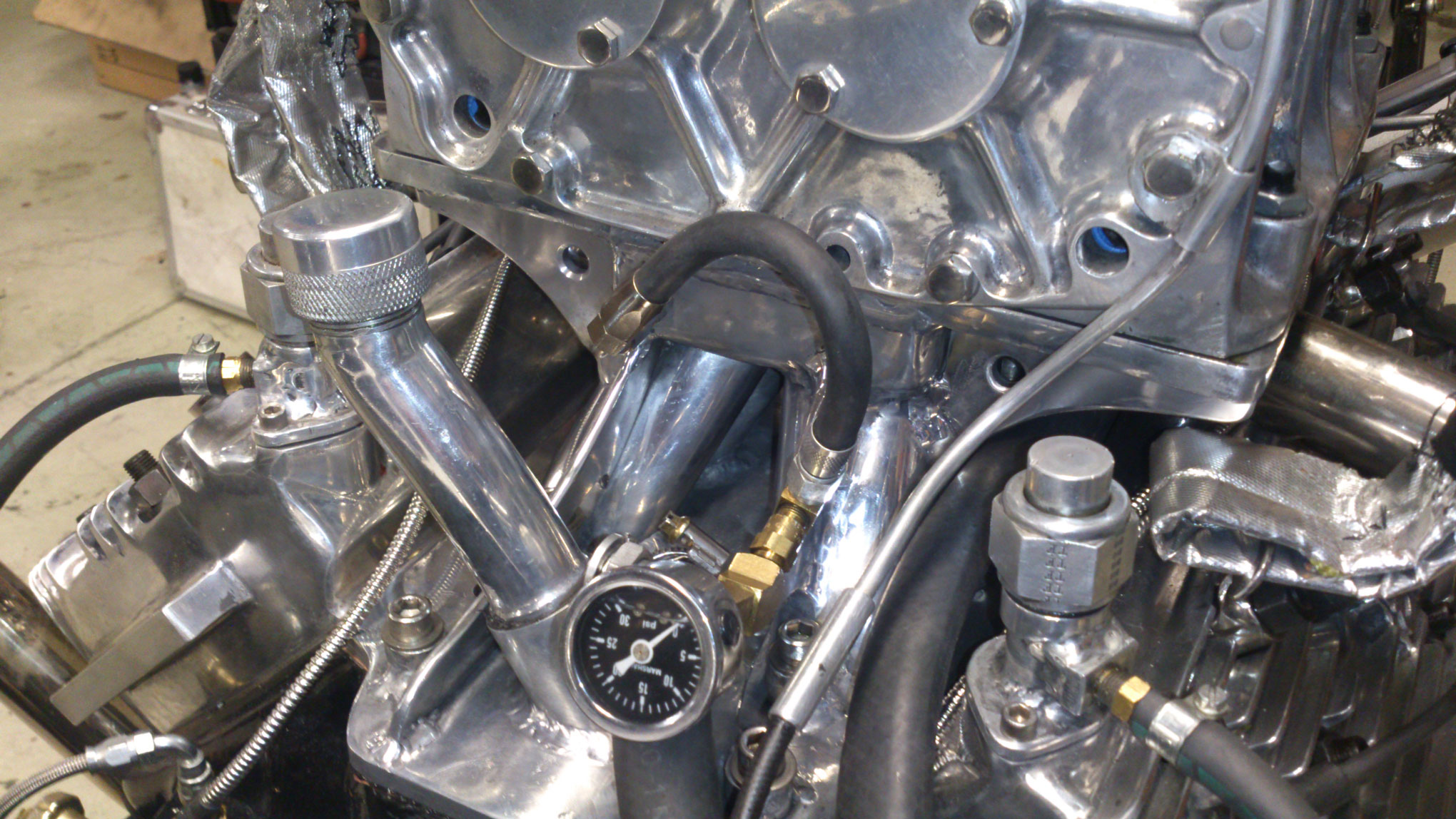

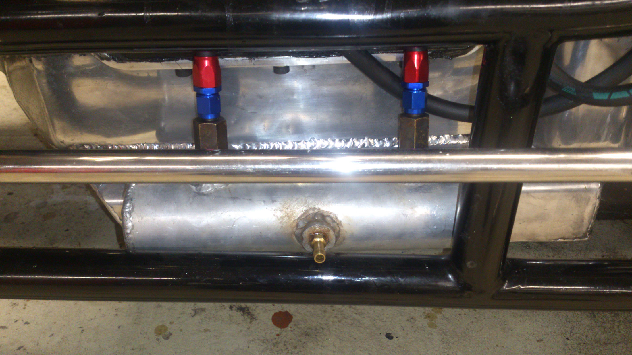

    Thought I share the solution to the water pressure valves (overflow).
    As we had some leftovers from the "Harvester", I thought it would be a good idea to use two byp*** valves to control water overflow.
    Look better than two large radiator caps on top!?
    We route a hose from the small tank to an canister behind my back, don't wanna spill water in front of the rear tires;).

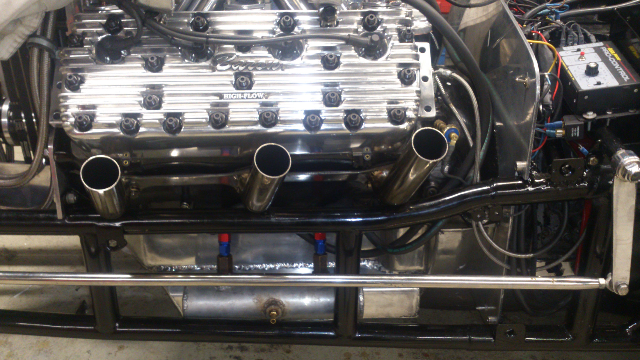

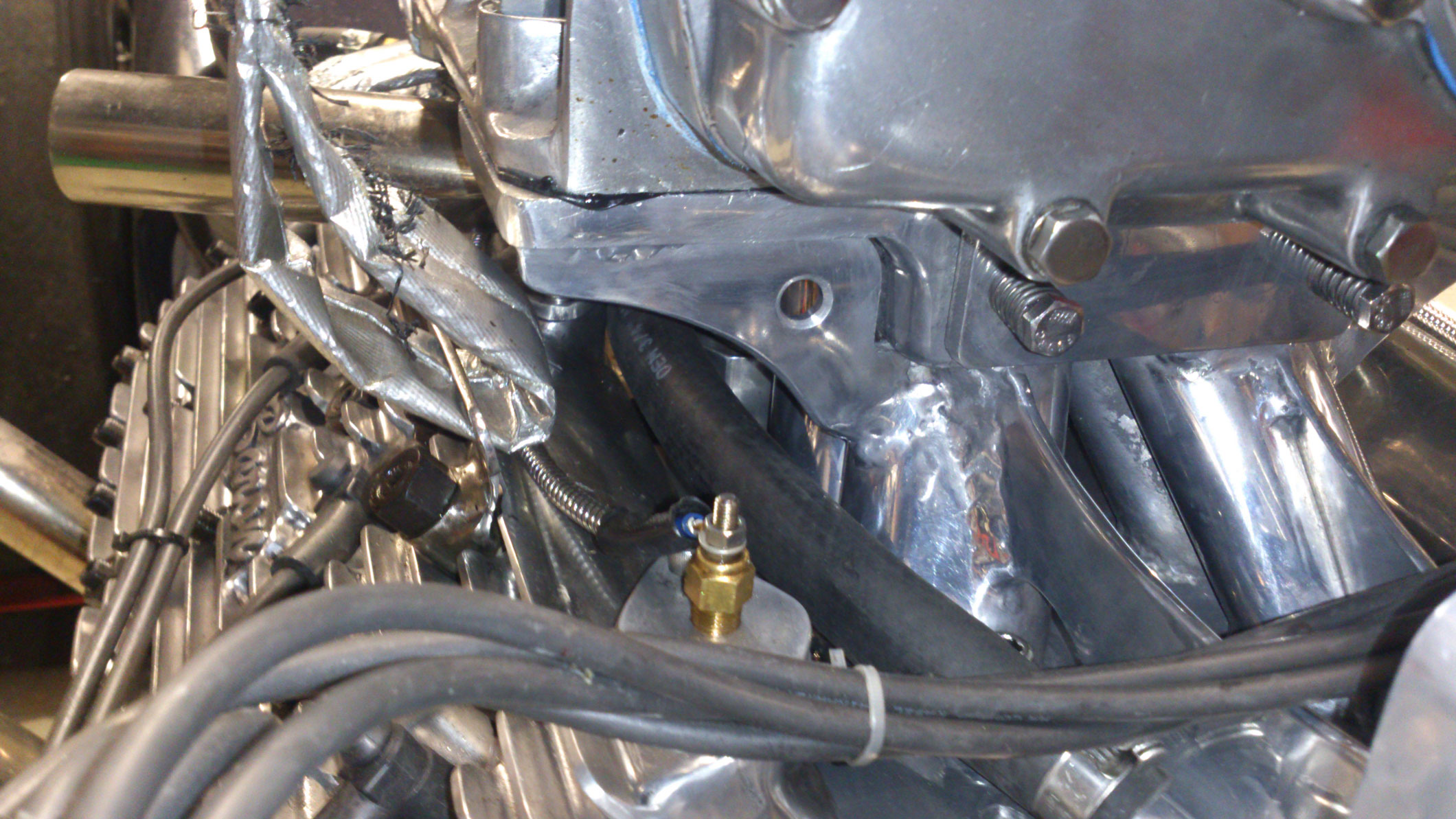

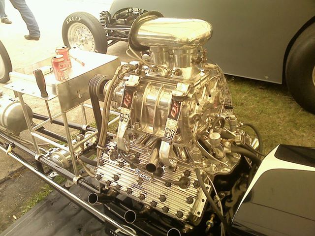

    We have now started to do some more modifications for the next race.
    Intake needs to come off, and we're gone make some braces for the "ears"
    as they bent upwards when we tightened the blower.

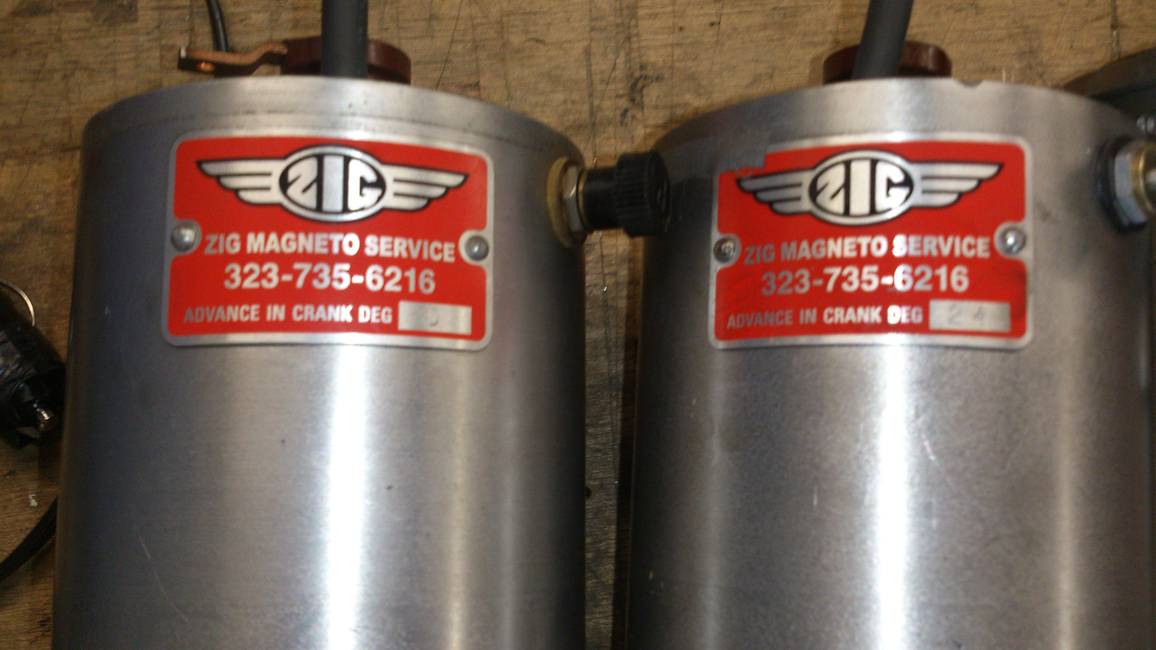

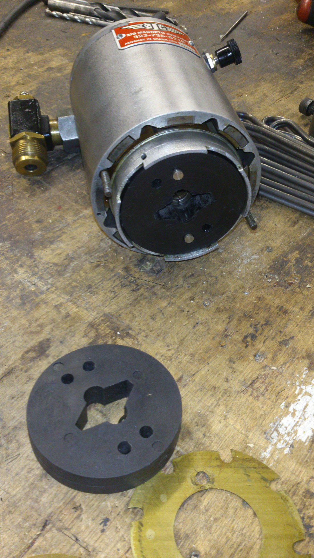

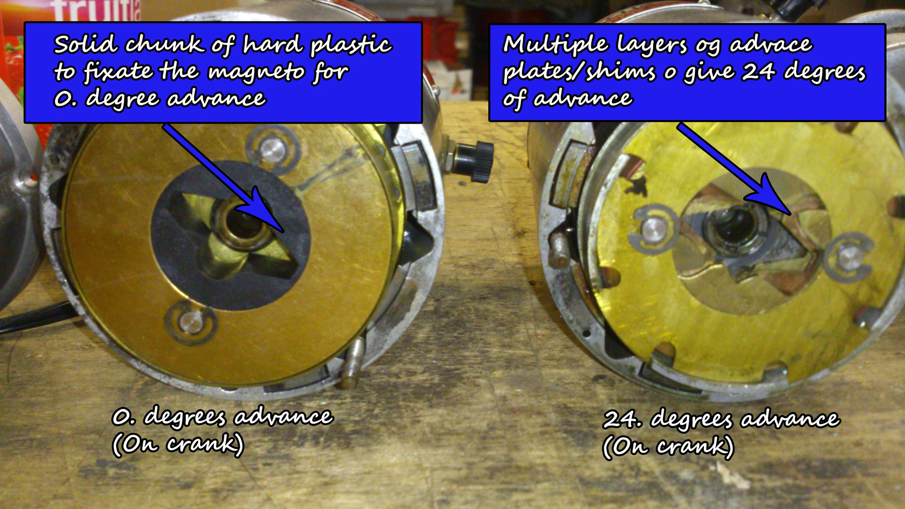

    Next is to modify the magneto for 0. degrees of advance. Got to borrow a magneto, so I have already changed the neck to fit it.

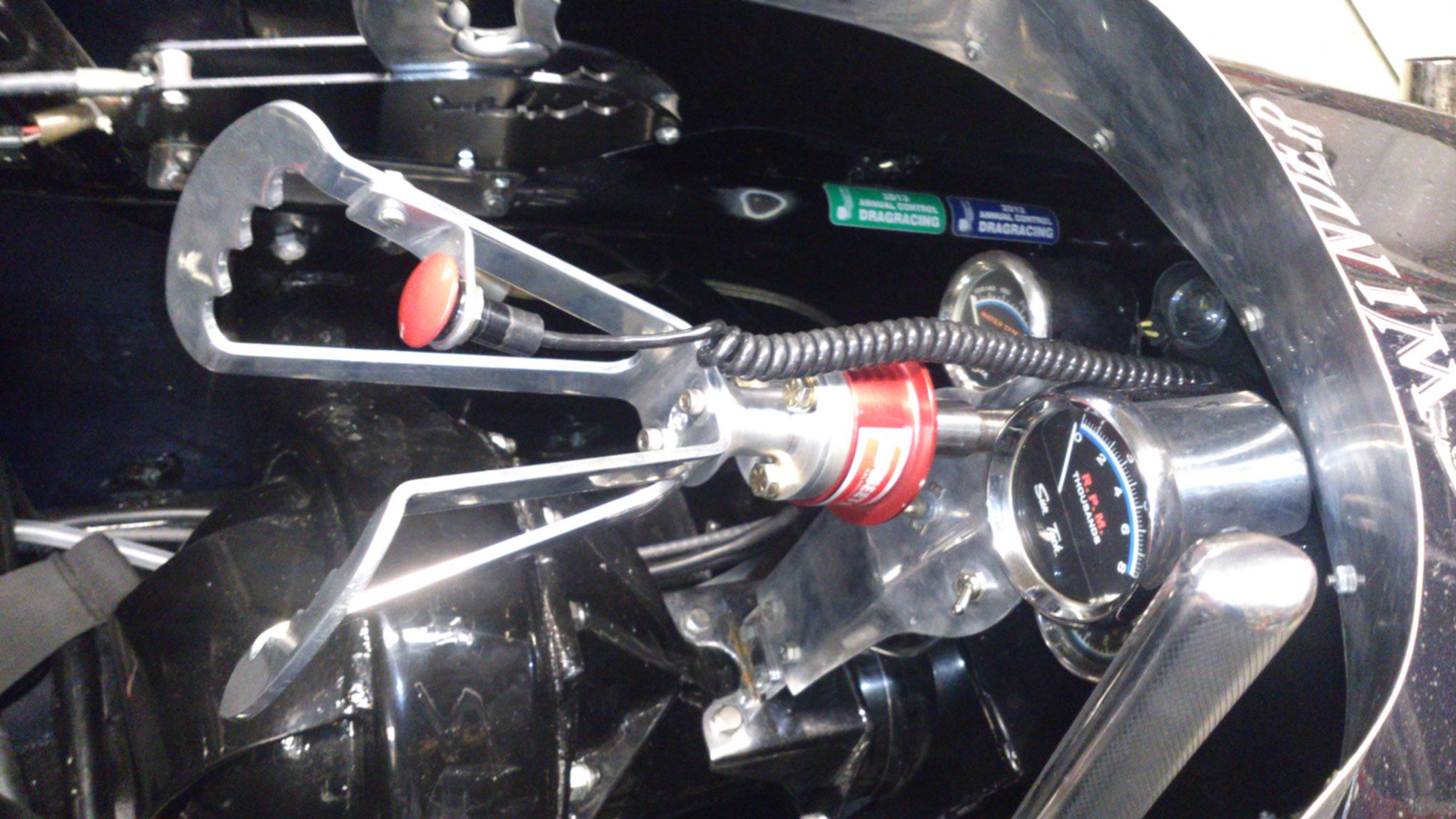

    Gone mount a quick release on the steering so I will be getting in and out easier:)

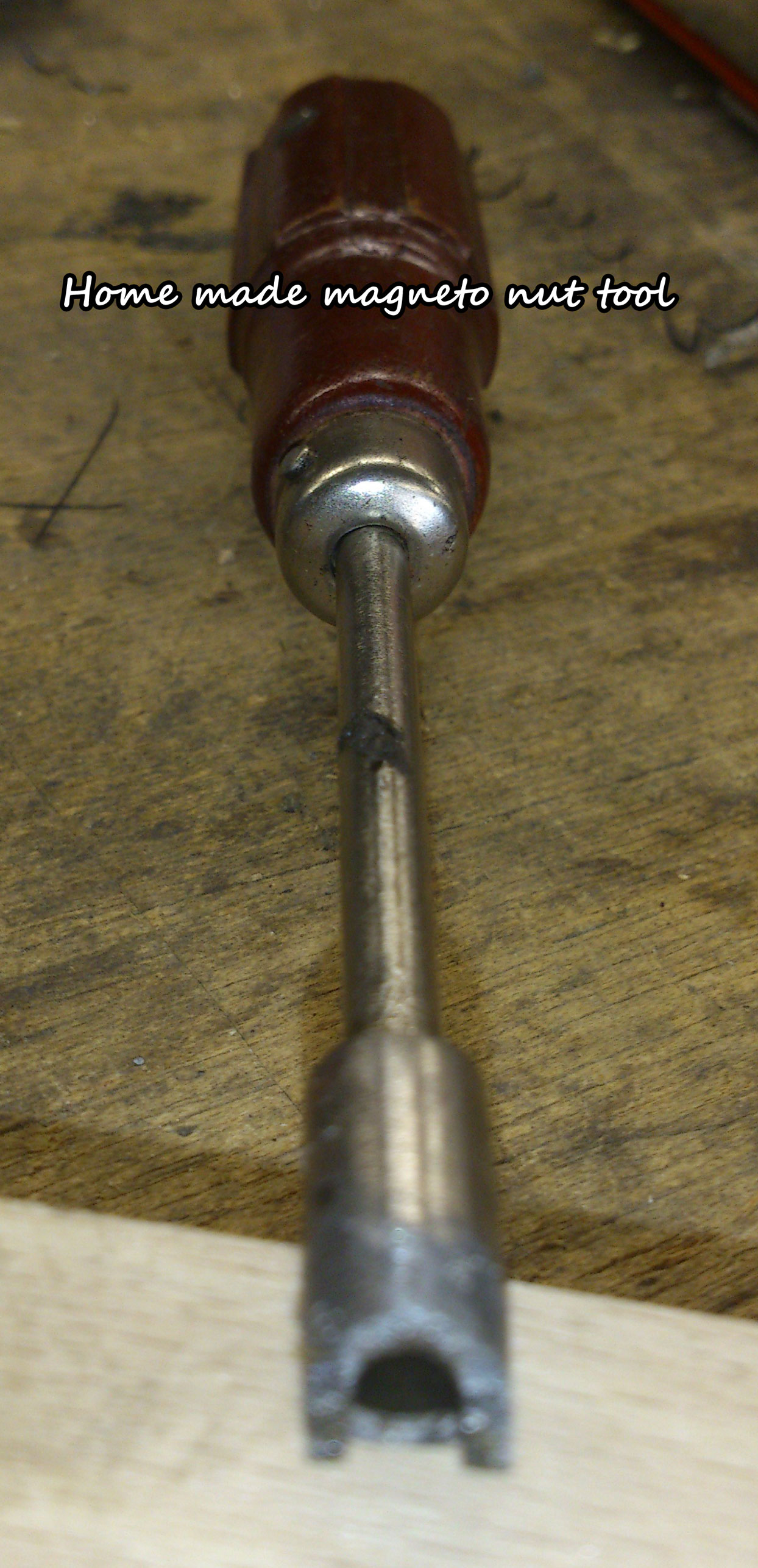

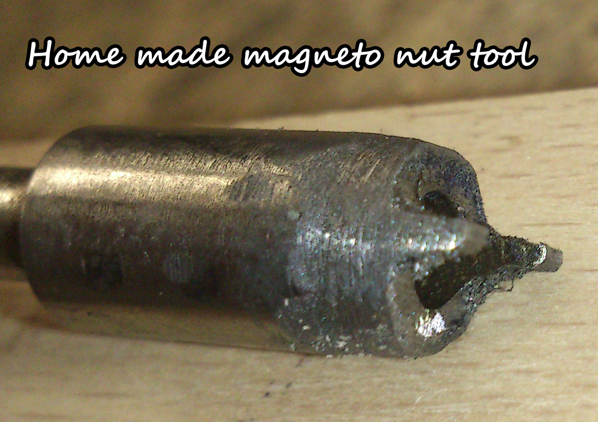

    EaringSo now we will Make the lockout plate for the magneto;)
    Roger is soon ready with the intake. Quick realease stearing is also ready for innstall:) so hopefully we will be able to some testing soooon:)

    Finally, Doc Eriksen has OK'd The Sidewinder, but we need to do a test Thursday:) Got it together this evening, and filled it up with Alky, then fired right up.....:)
    Here are some pictures of the last modifications. Made a zero advance locking plate for the magneto, new clamp, braced the intake and mounted quick release steering for easy entry/exit:)

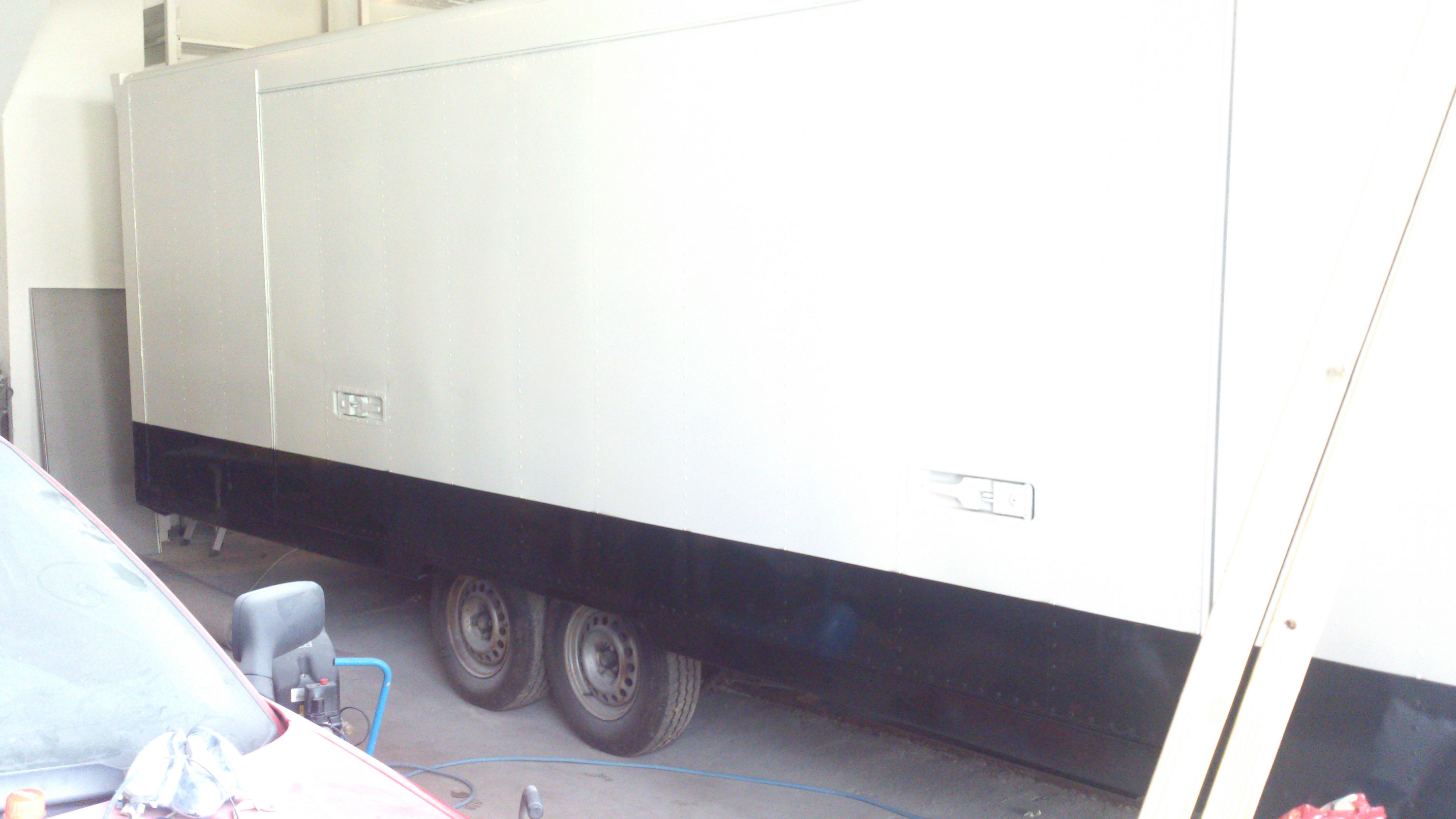

    While waiting for the next race, I decided to use one of my summer holiday weeks and do some useful stuff...:) Enclosed trailer need some new paint badly. So this how it turned out:) And Buddy, I was not mocking you:) I really understand that you need one. It's so much easier packing and finding stuff at the track. Plus it's also comfortable:) Now we have beds and running water too, luxury:D!

    Thanks for the kind word Buddy:) The Flatcad crew in a major inspiration:)! We put on a checker-flag tape between the black and white. looks better now:) I'm currently working on different options. We hope to land some sponsors that will have their logo on the trailer. I'm in the talks with a very known compressor/air-tool company/dealer:)......

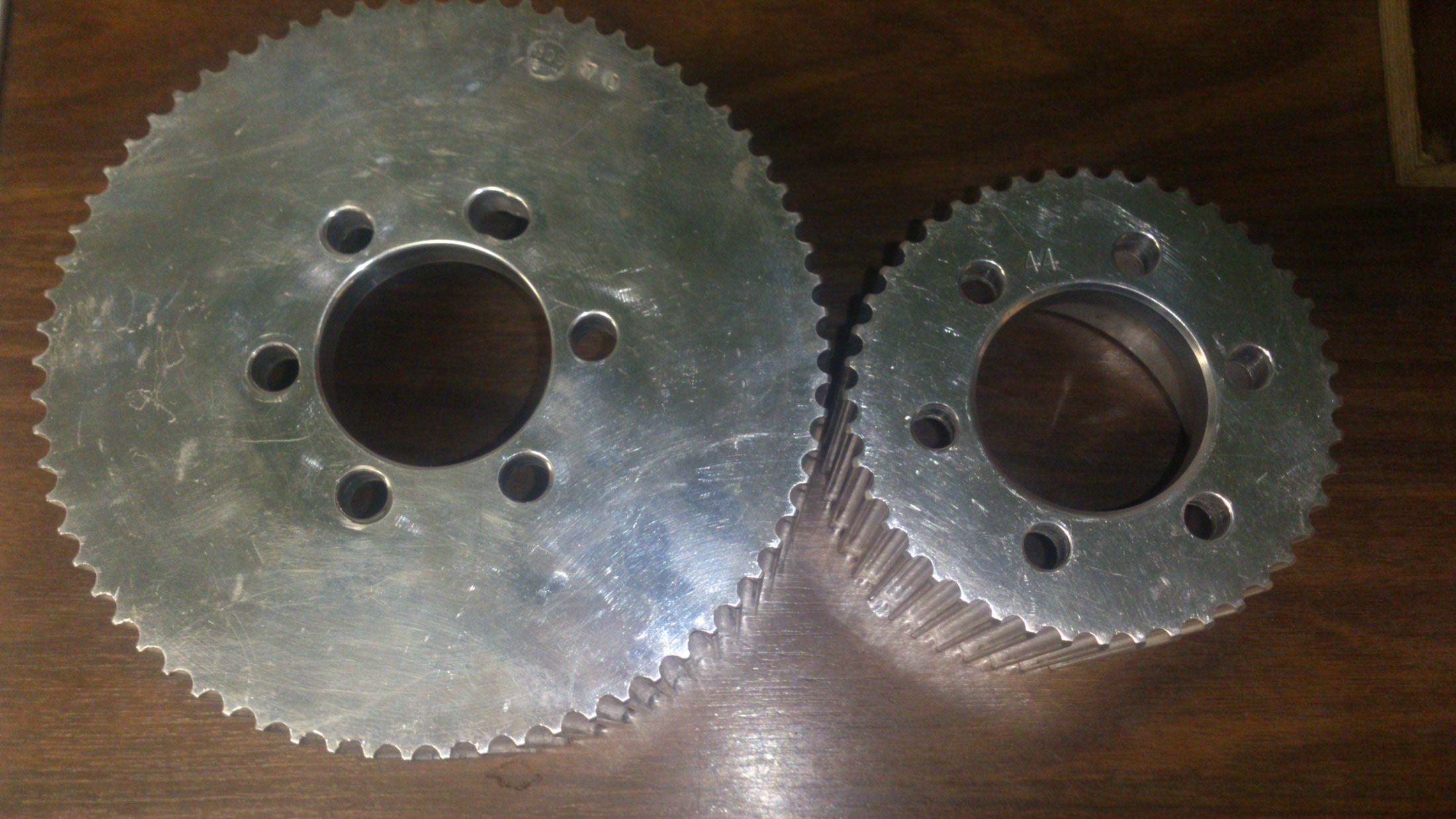

    After the last weekend, I'm looking for a pulley set, 43 & 65 tooth 8mm pitch.
    Here is why..........>
    K

    Yes computers are a great invention;) But todays case, where I put an add out wanted to buy blower pulleys, I didn't have to. My good friend had them on the shelf:D.
    So now is the question, would I try to use them;)?
    They look like the "Sidewinder" would start to "wind":D?
    Or should I stay with the V-belts?
