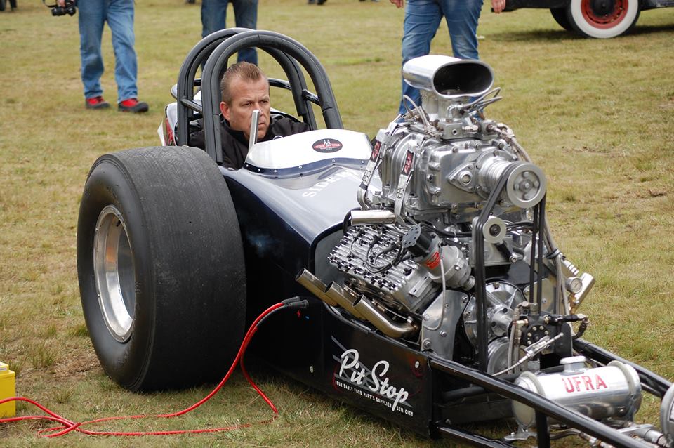

    Just found a #67 magnesium pulley in a box:)! I think we're gone start with that one.
    Hauled the dragster to the last Kala race for this year, last weekend.
    Lots of nice people to talk to:)

    No racing this time Buddy;) Just took the "winder" down there to show-off:) My only sponsor was there, so we could support:) The race is a cool dirt-track race. Used to bring my Modell A, maybe next time:)

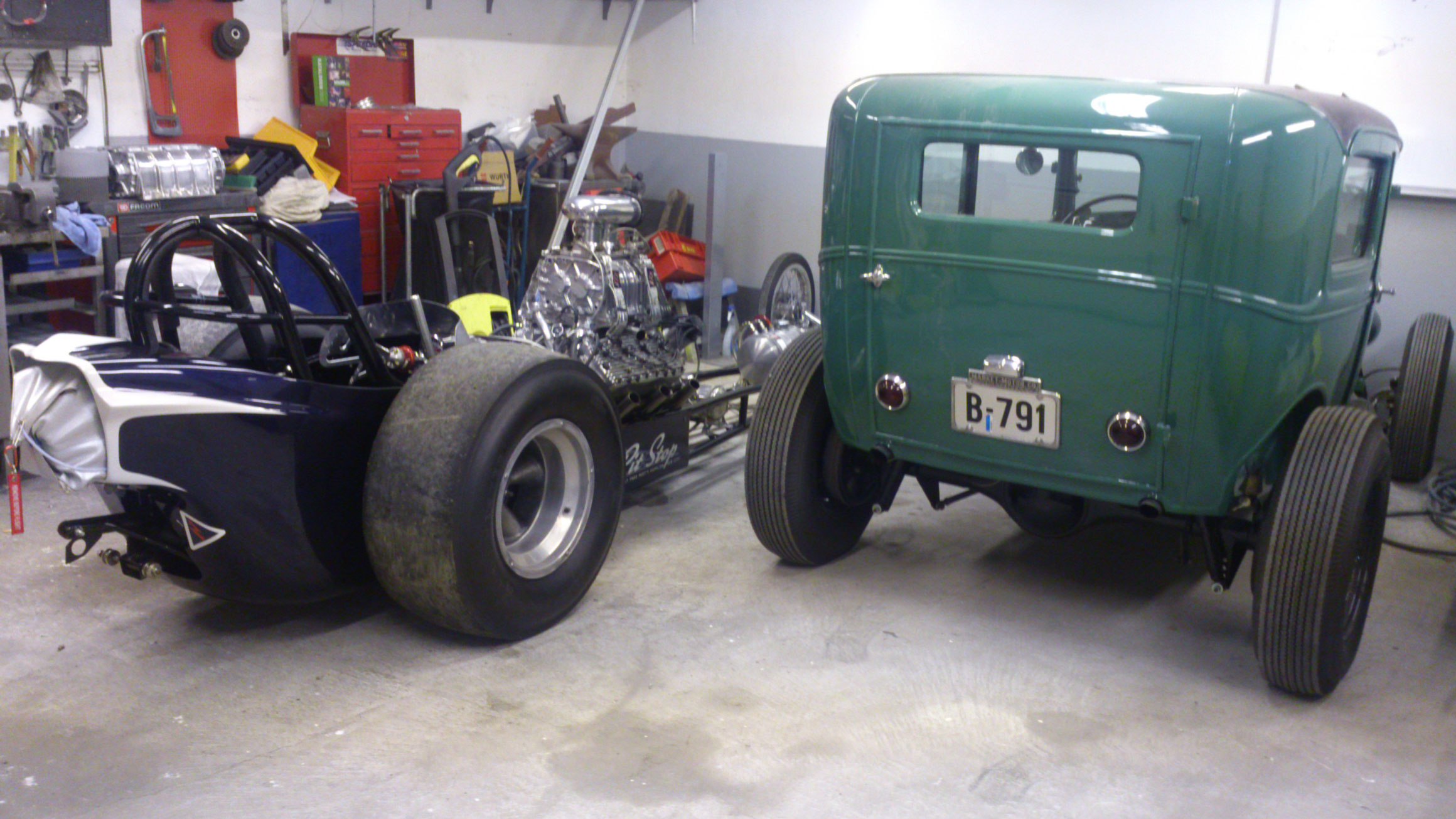

    Finally got the dragster back home in my garage, inn fact it's the first time I will have it at home all winter:). I also think the Modell A will like having a friend:).
    Next up is to take the pan down for some inspection.....

    I'll see if I got some older pictures of the "A", and might post a new thread:). But for now I have tore down the pan, and took down the center main cap and one rod cap to see if there have been any damage. But noo everything looks very good:) Have been a bit concerned because there are some "grey" stuff I the pan after draining it:confused:, but not eny larger particles. I thought this was something we would see just the first season.

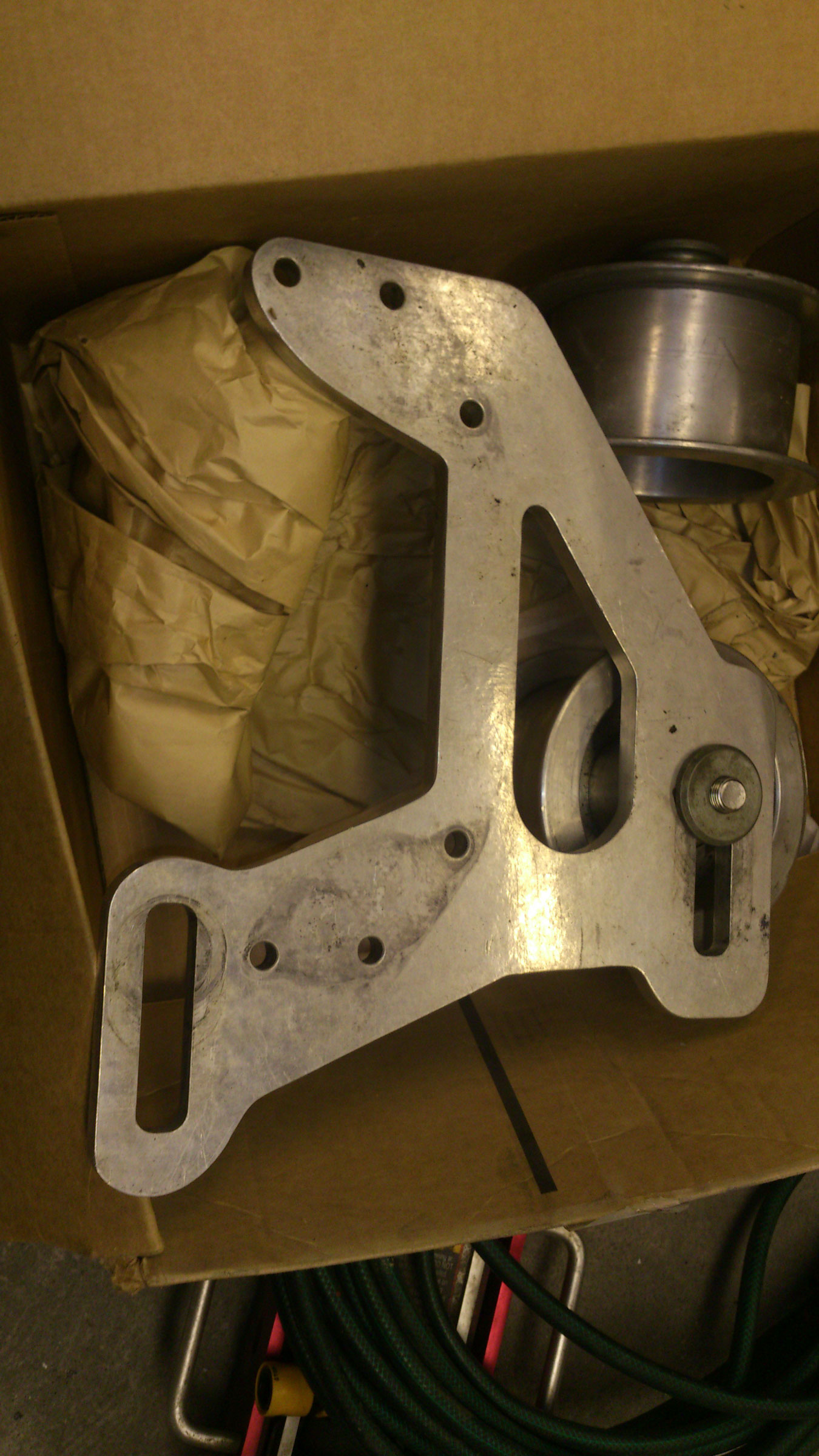

    So far so good:) Roger has gotten a big box with "to do stuff":)
    He's going to make new hubs and mod. the pulleys. We are also planning to make a crank-support. Bought a box with some blower parts.
    one magnesium pulley and two idler pulleys one one on a bracket.
    the idler pulleys are marked with a number, 5001. Does anybody know the brand and what the bracket fits?

    Hi Kjell The bracket looks like it fit a 426 hemi or a KB , Tim Jones

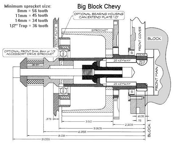

  16. Hey Kjiel: If you need any design help with the crank support, no problem. The thing you'll need to do is make a steel crank hub (like an RCD) - that has a nice bearing surface on the front to index the roller bearing support on. If you want me to take some pictures of what I'm talking about - no problem. We took a BBC setup and adapted it to our FlatCad - which is why I had a BBC snout designed into the crankshaft.
    I'm willing to design one in CAD - with the provision to take the RCD style timing plate. This would be a cool setup - the blower pulley would bolt right onto the crank hub, and the snout/crank support would slip over the end. Hell - now that I'm talking about it - I need one myself . . . ****!
    B&S

    Thanks a lot D.:) I had a look on the RCD drawing that you attached, and if I remember from Roger's drawing, I think we are doing something similar:)
    I will try to scan Roger's drawing and post it so you could see it:)
    We have the original flathead dimensions on the crank, so nothing could be bought:(! But it would be nice to make it:) A 3D could really help, and would be more accurate to get everything lined up. Our pulleys will be inside out as we like to minimize the crank load.

  18. Hey Kjell: I also have a flathead crank hub that I believe came from H&H. Tell you what, I'll take a look at it - and make a 3D CAD model of it. Then I'll throw together a 3D prototype for what I believe you'll need for a system that includes a snout support (it will be close, but not perfect). Are you running 2" or 3" belts?
    You can then take a look at it and we can tweak the dimensions any way that works. I'll also design it so we can use the RCD degree wheel (which would be good - pain to make). That way we can swap degree wheels if for some reason we want to run a crank trigger some day. Let me know if that works for you.

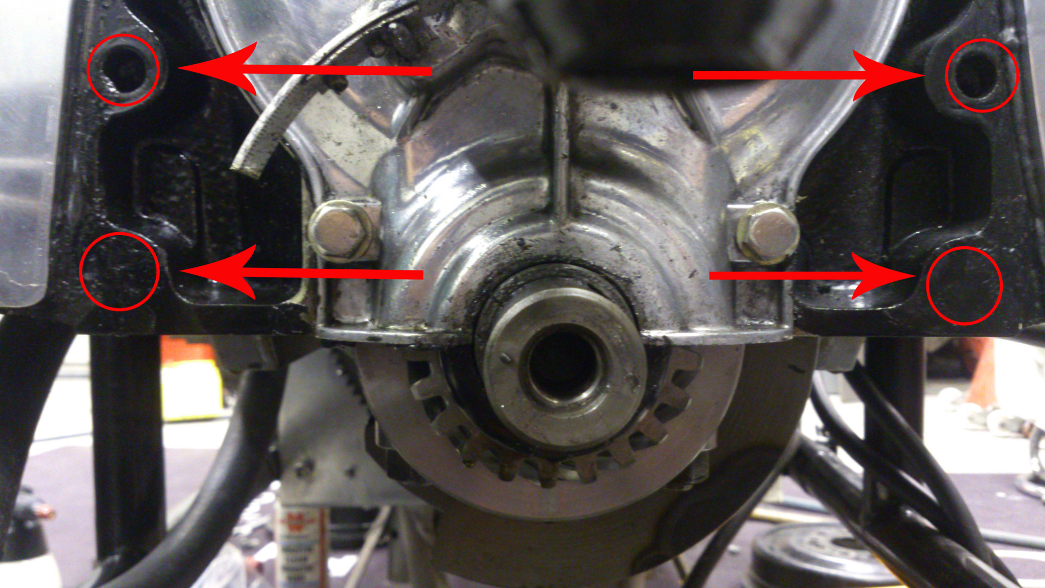

    I think we will go for a 3" belt.
    What location on the Bolts/studs will you recommend? There is two 1/2" holes between the water pump's and timing cover, and provisions for two on the "lip" down towards the oil pan.
    Oh, no hurry D. We have all the winter:D!
