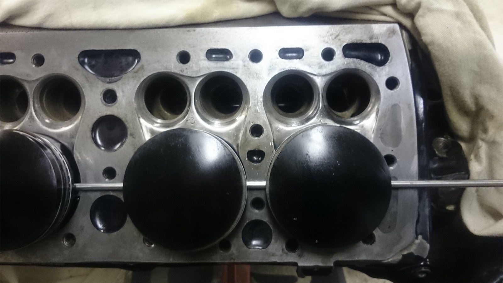

    Another evening in the garage;) Dagfinn and I put the pistons/rods in and gott all torqued down.
    Valvejob is a little time consuming, 15 of the 16 whent inn;/ The last one is a puzzle;)
    How many of you has managed to bend a valve in a Flathead???;)
    Dagfinn to the rescue, found a valve in his garage, so just need to grind it abit;)

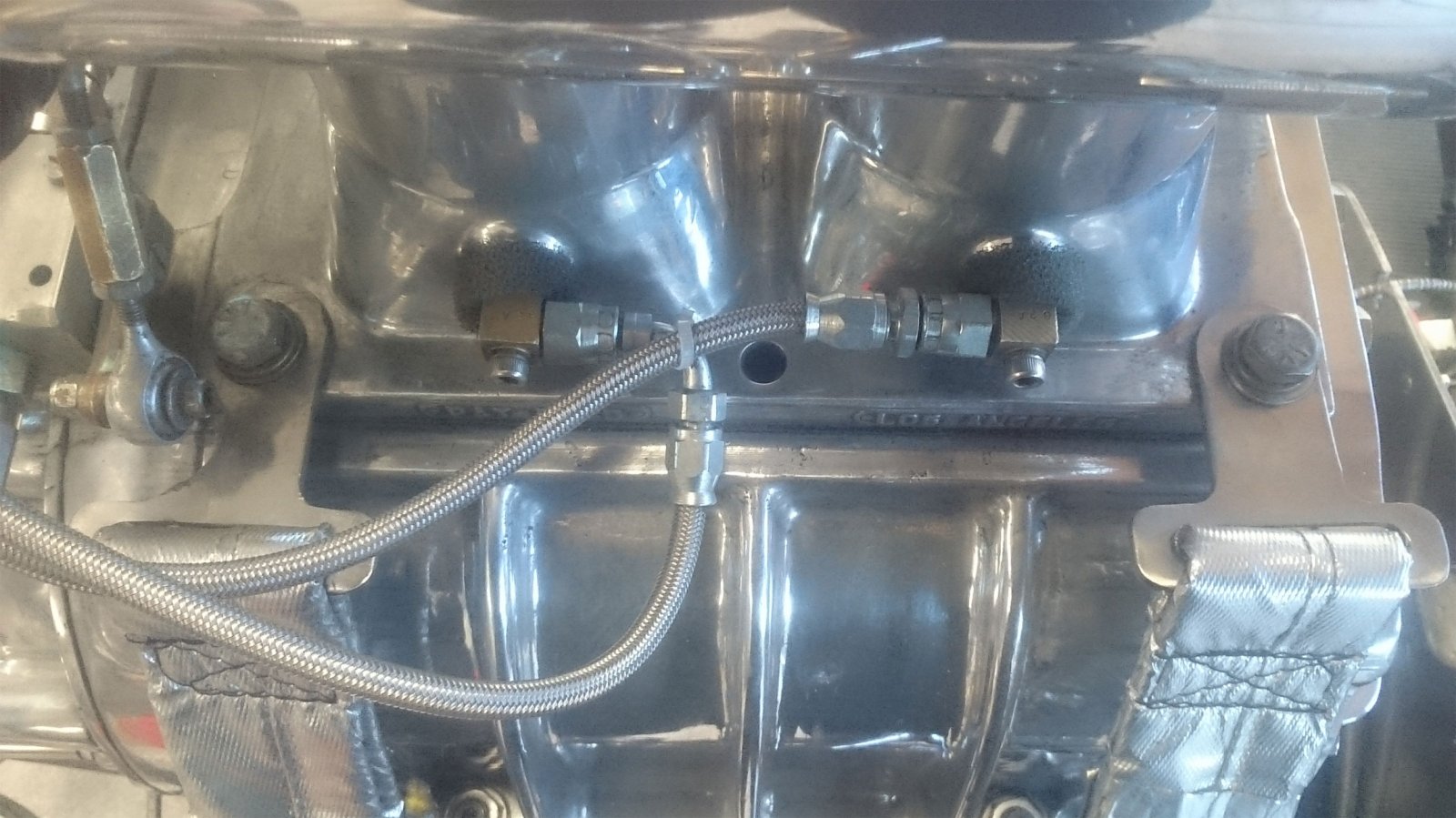

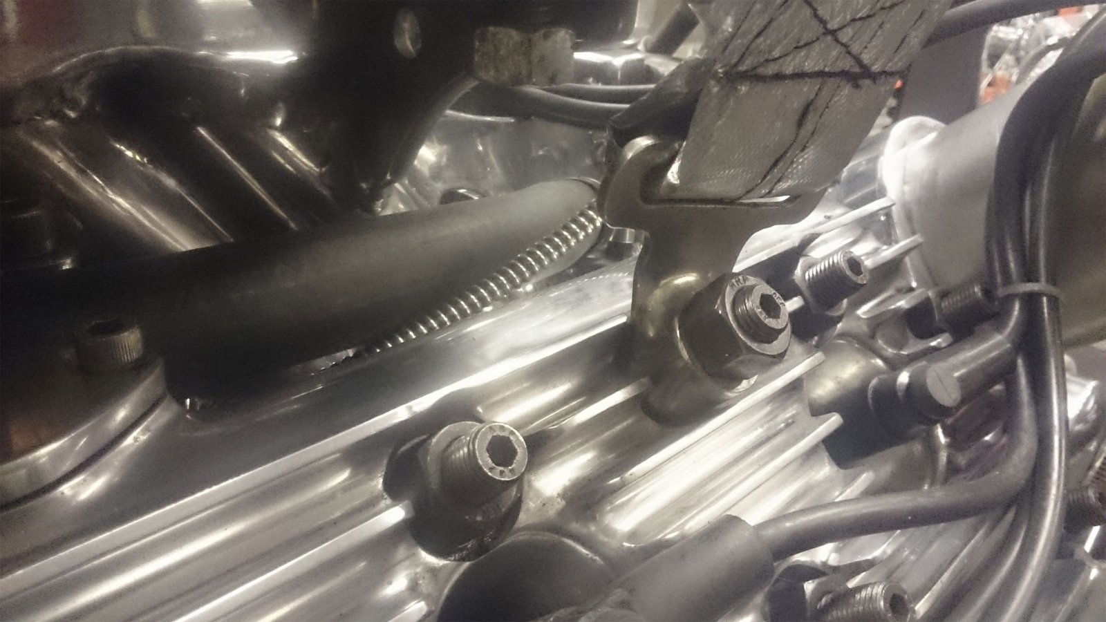

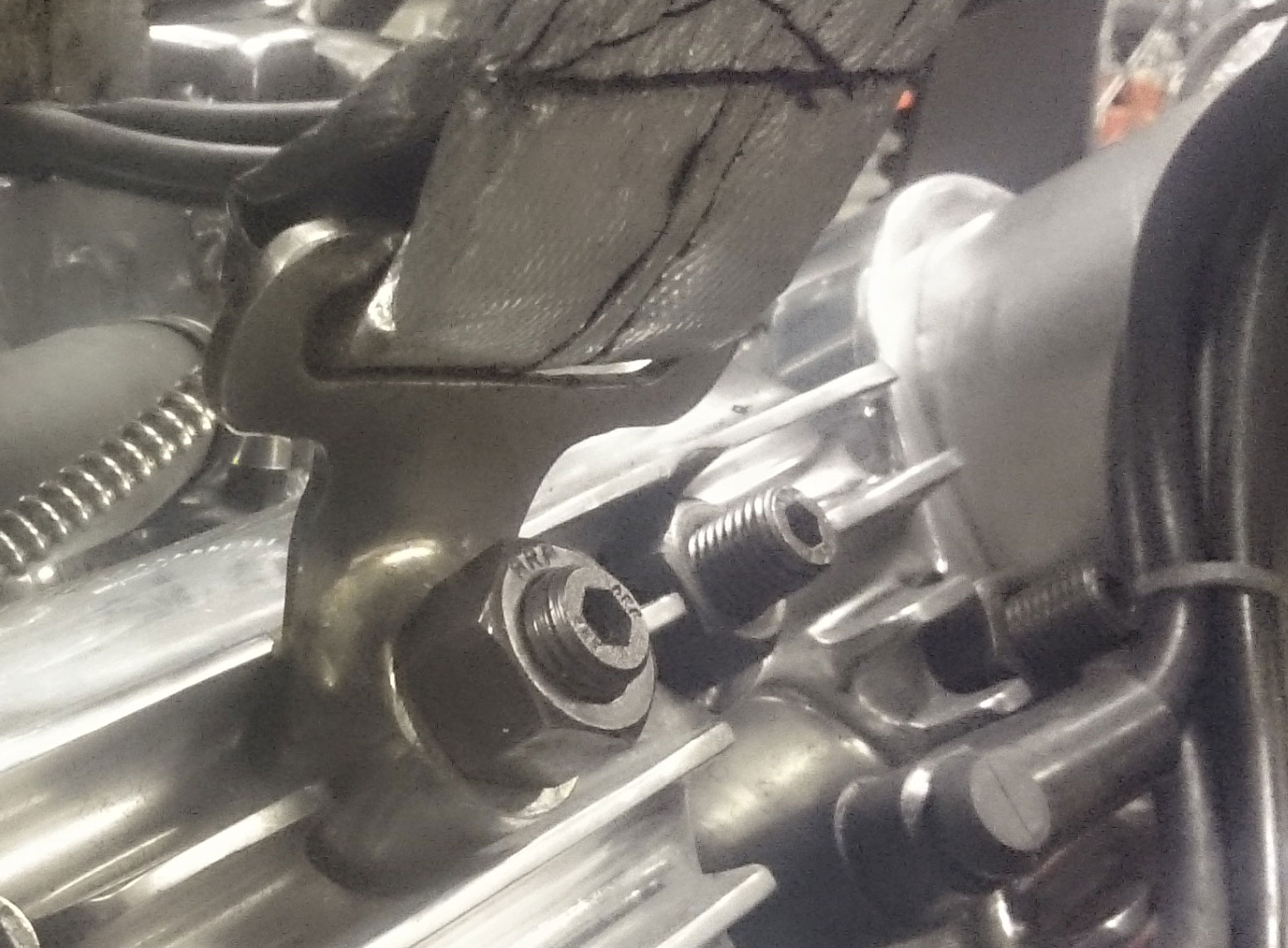

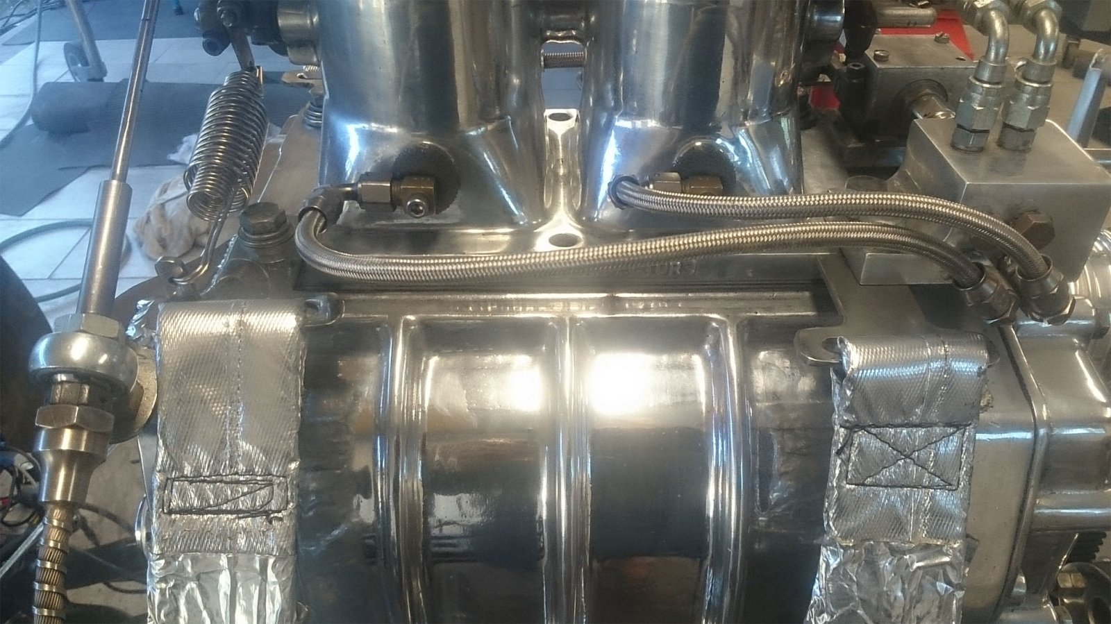

    Thanks guys:) The blower restraines are from DJ safety, DJ-141002. All the braktes are made by my very good friend and crewchef Roger J. :) Ok I had some of the ideas too;)
    Here are some Pictures. I hope they are understandable:
    Lower Brackets are same for all four
    Upper Left side
    Upper Right side
    I had to restich the restraines, as I did not want to have the DJ logo showing;) finished off With some 3M alu.tape.

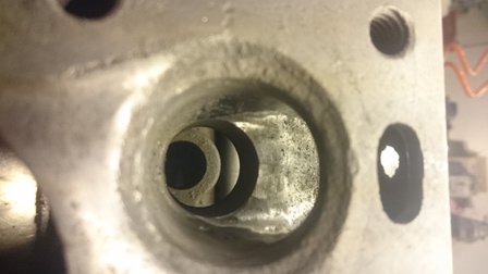

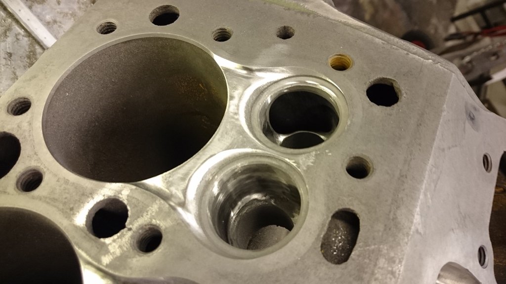

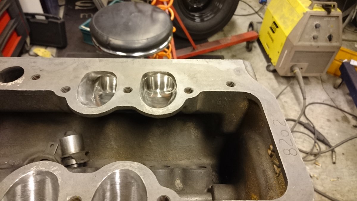

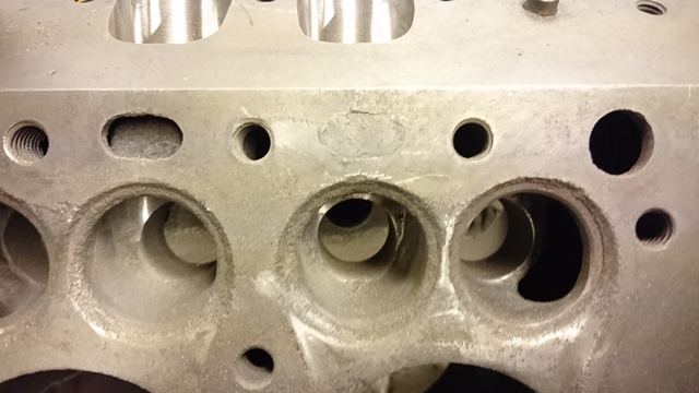

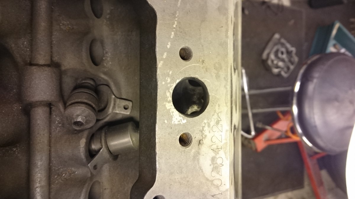

    Max porting......! Hmm I really did messure.. ;/
  25. Model A Mark
    Joined: Apr 30, 2008
    Posts: 1,360
    Model A Mark
    from dallas
    ouch..
    how you gonna fix that ?
  26. 97
    Joined: May 18, 2005
    Posts: 1,983
    97
    just fill the block

    Well, got some done today :) Fixed the hole in the runner, and finished one side, just some small ajustments left.
    Marry Xmas and a Happy New Year to all :)
    /K
  30. Model A Mark
    Posts: 1,360
    Model A Mark
    from dallas
    nice work, so how did you fix the hole ?
    you dont run water ?
