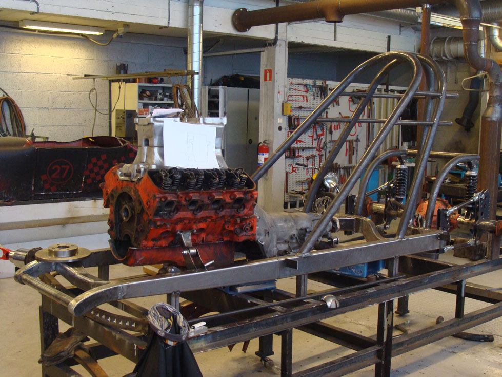

    Here are a picture of my good good friend next to me in the garage.
    The Big Barndoor looks scary:D

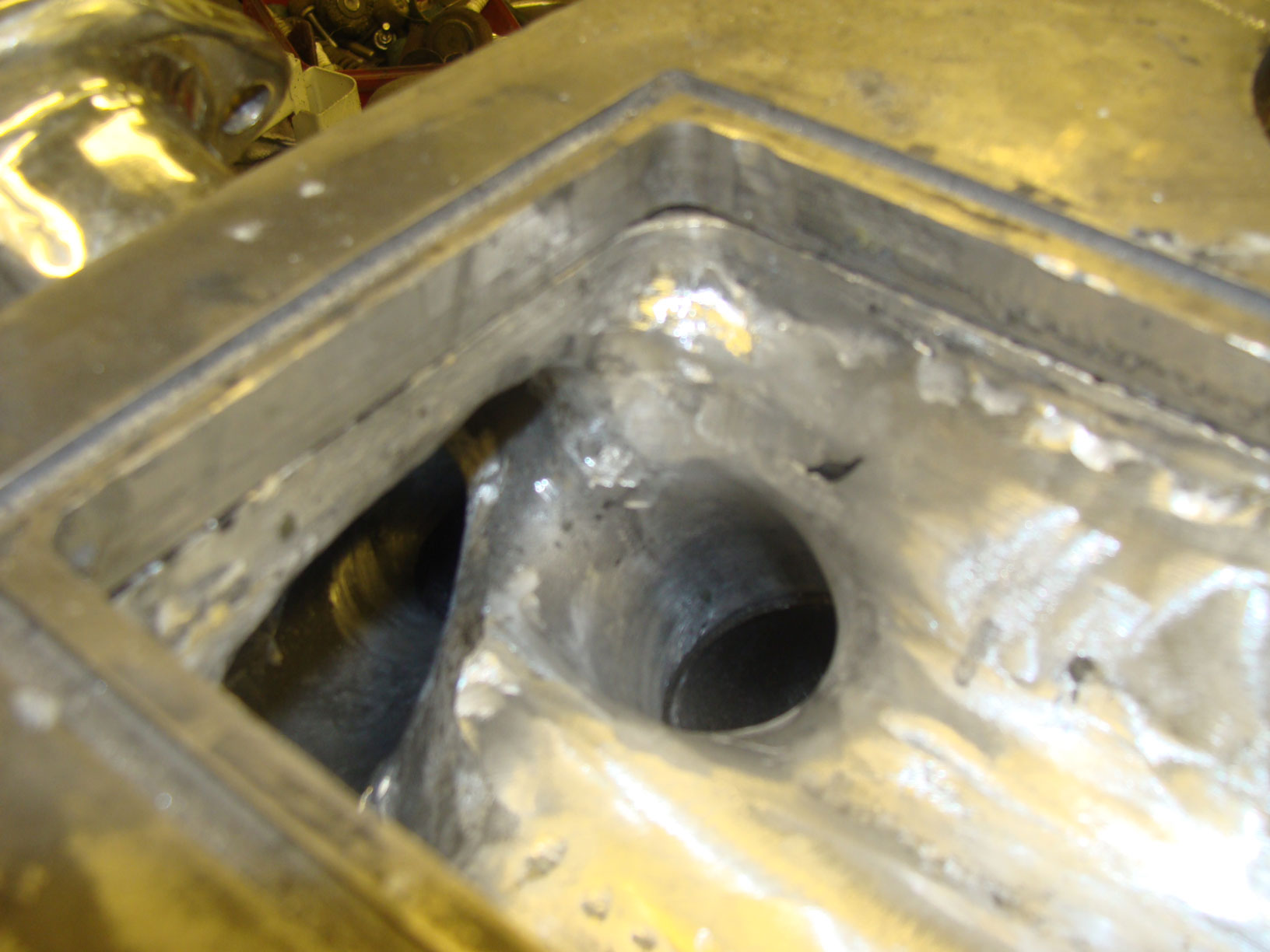

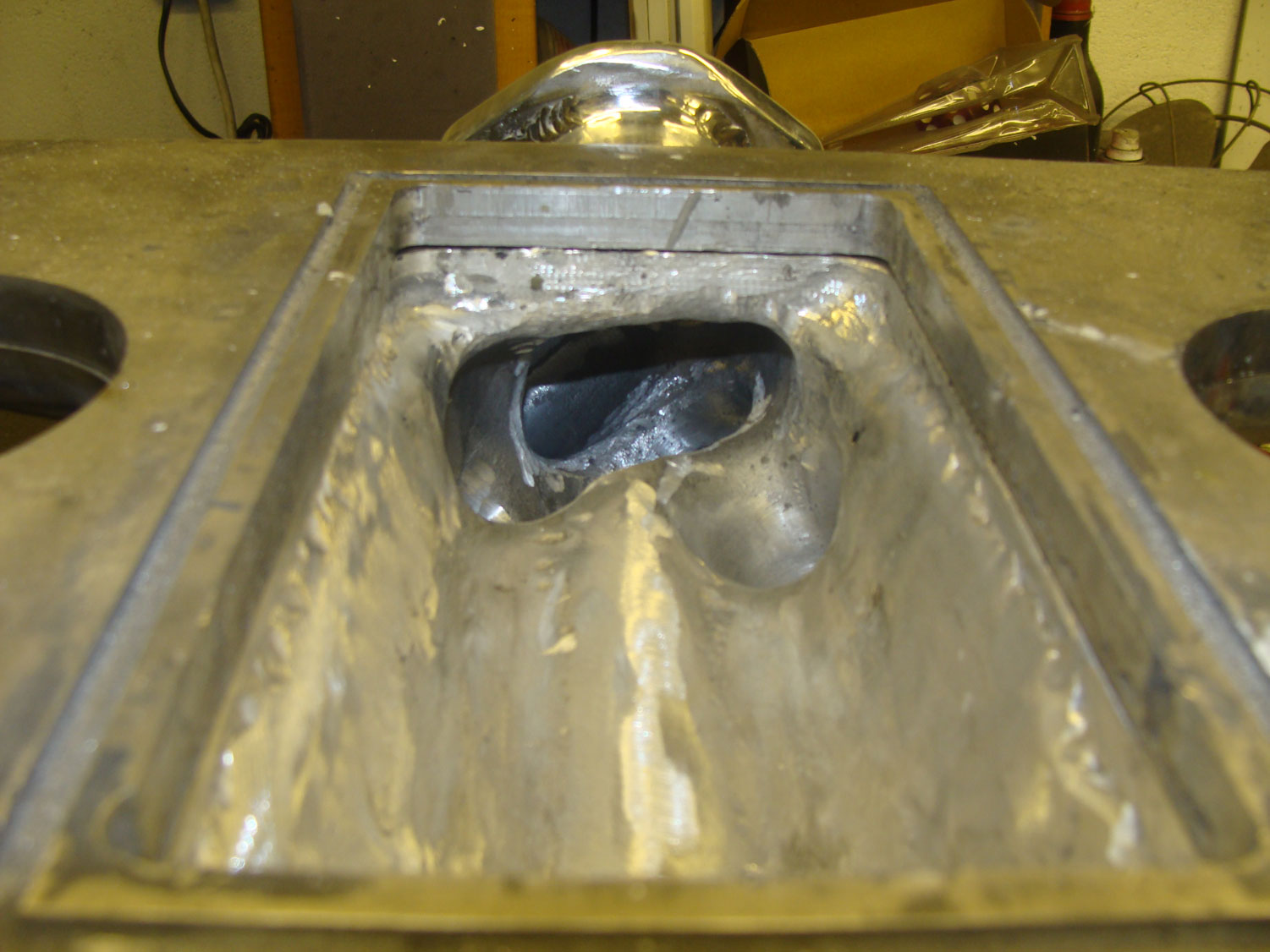

    Have had some time to fix other stuff, intake final porting innside...

    Have done som stuff today also, polishing the timingcover, and som minor finishing on the inntake. Took out 16 adjusting bolts from the french lifters, so that is checked out too:D!

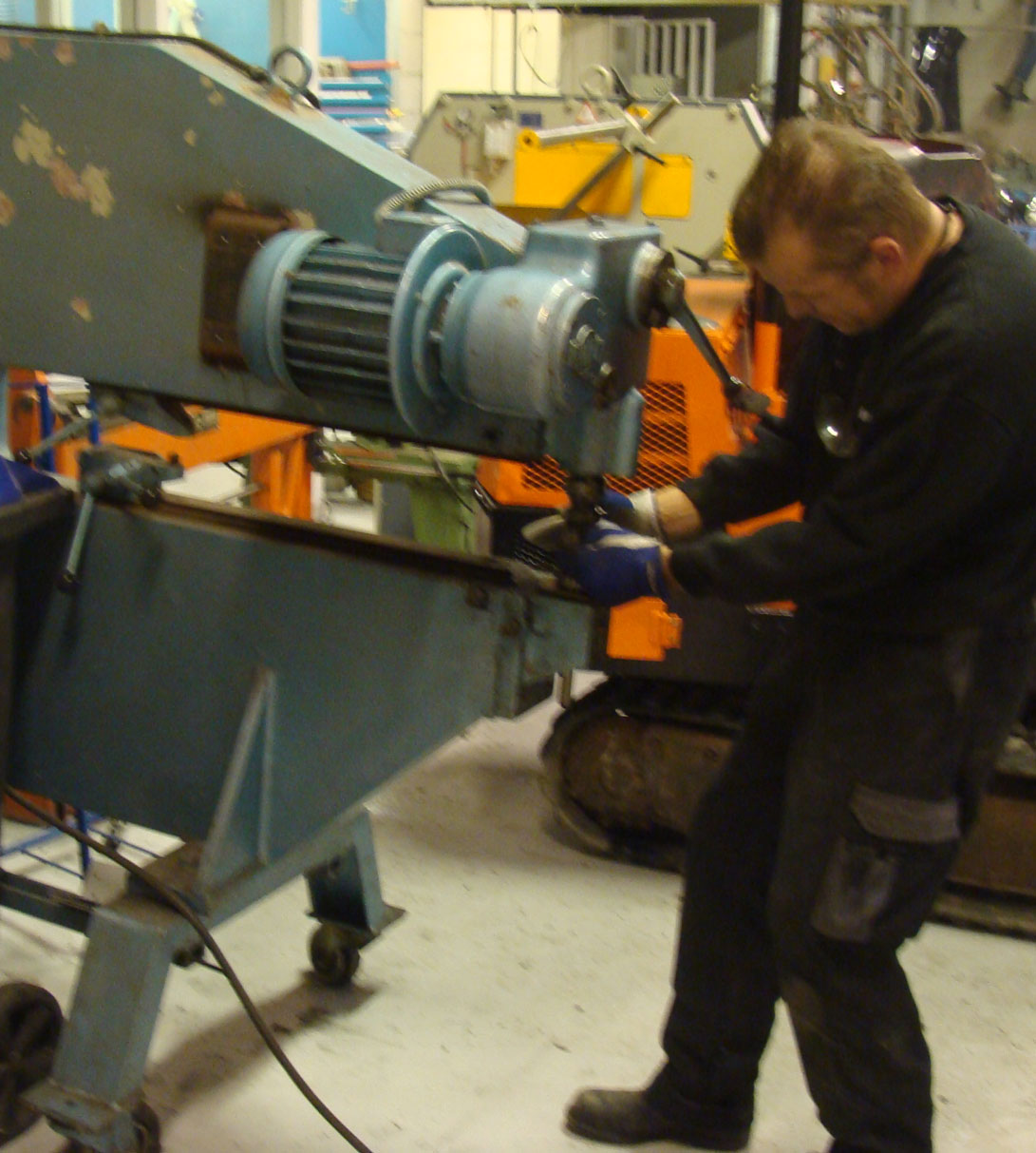

    Alot of progress yesterday, we worked from early in the morning to late evening. Roger welded up alot of aluminium brackets, soldered the torsion springs and some minor weldup(final) on the intake.

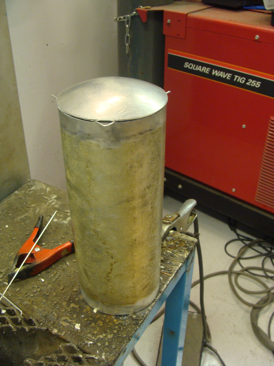

    We made a new catchtank aprox 1. gallon, the old one was to small.
    It was a great experince to make curved end plates for the tank on the pullmax, very nice tool:D!

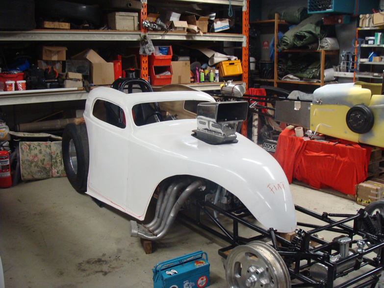

    A picture of The school project, T-27 G***er.
    Enough boring for now.

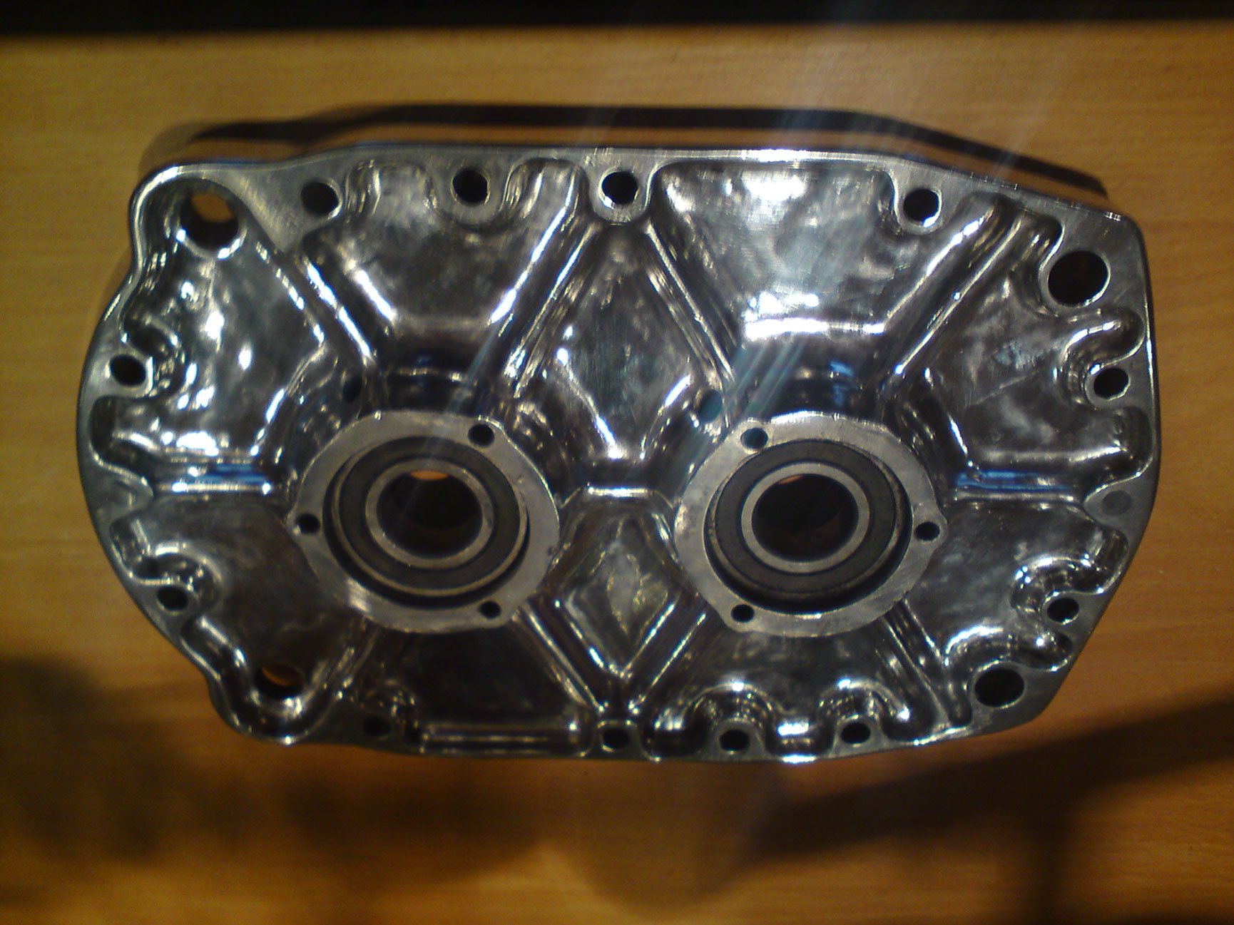

    Block is now done, just await's new crank bearings, gotten wrong type twice:eek:! Ch***is is ready to be painted again, also found the right colour for the body and sceme for scallops.

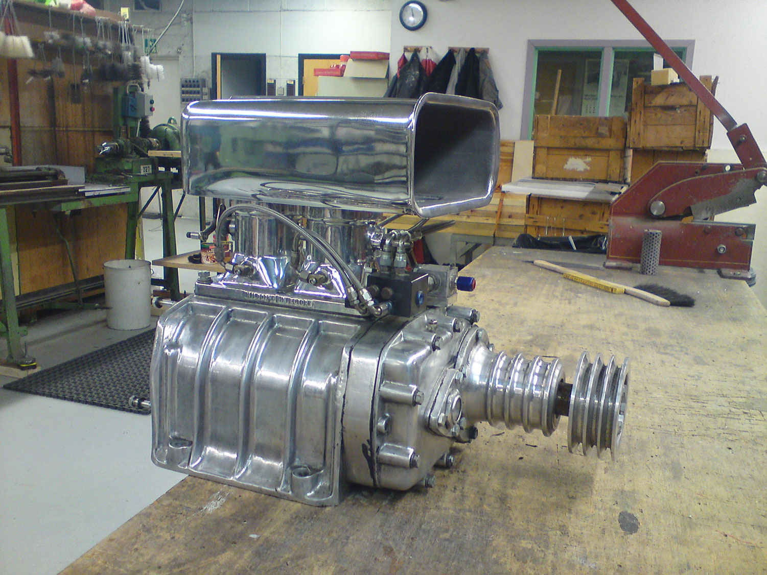

    Used the afternoon polishing the milled down end bearing plate on the blower:)!
    Got hold of a scoop e couple of weeks ago, but have not desided to use it? We will do some more details next weekend.
    If abybody has an idea on a name for it.........:)?
