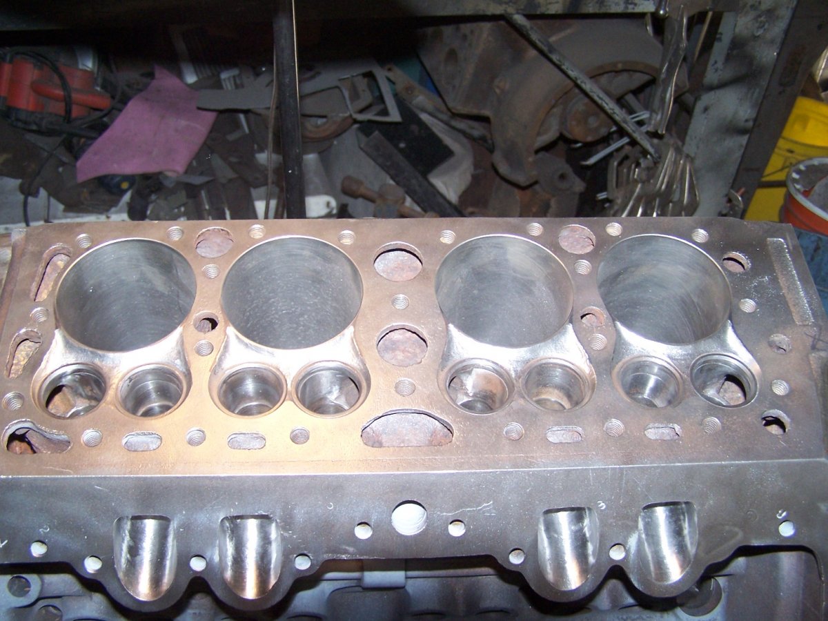

    As a part of the updates on this engine, I desided to change the timing gears to early style for thrusting towards the block. As Bored&stroked adviced, I bored å small Hole up in the Main oil feed to improve lubrication betveen the cam and block face.

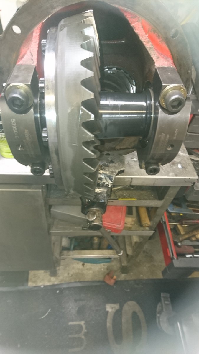

    On the last race I managed to break one of the Main caps in the rear end, the Chrysler 8 3/4" could not handle the power from the mighty Flathead ;-) With two New MW mains it should hold, I Hope :-D
