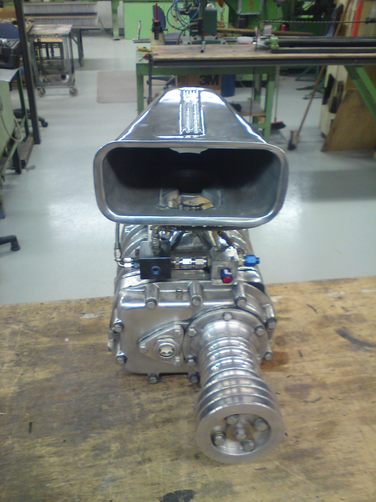

    Small stuff was done today also.

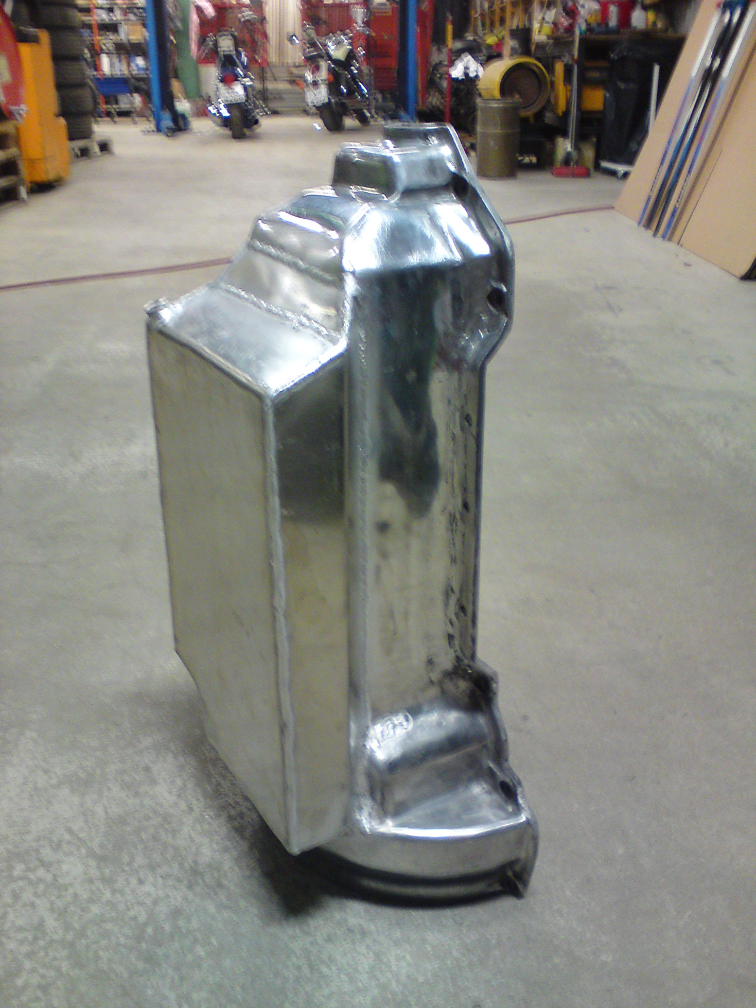

    The injector is a Hilborn 2-port, that i bought from a guy in Australia, came from one of "terrible" Ted Gotelli's g***ers, it has number 131 stamped inn it. I have not messured it, but vill as soon as i go back to the garage.
    The scoop came on a deal that a good friend did a couple of weeks ago.
    He bought a Hilborn 4-port with both the original scoop, and this one.
    It has a modified base, to fit the 4 port, but he thought it was to short for it, so i ended up buying it:).
    I think it's a Enderle? Any other suggestions?

  2. I don't think anything looks better on an 2 or 4 port Hilborn injector than a Hilborn scoop. I believe that Hilborn still makes this 2-port 4-71 injector -- you should be able to buy a new scoop from them. I bought a new one for my 4-71 two port and a new 6-71 four port about 2 years ago . . . seems they were around $200 each.

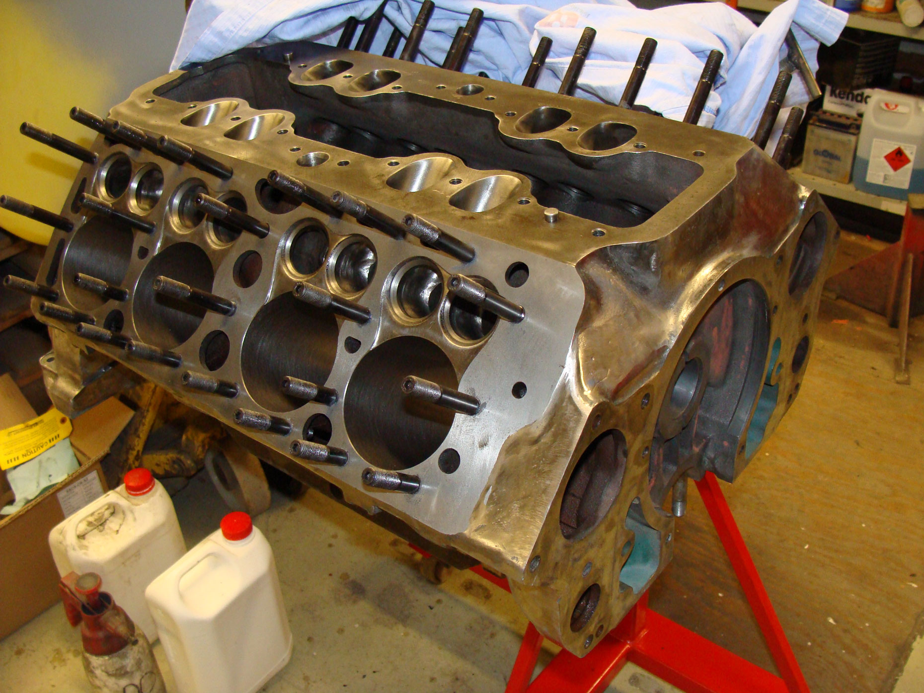

    A litte uppdate!
    Engine block is now finished.!?
    But as allways, there are some issues. One big for the moment is the crank, but my very good friend here, B&S has come to rescue me:)
    Hope to have this sorted out soon, but the result will take some time.
    Anyways, i just have to make the best of it, so i will continue working on other details:) The cocpit erea is staring to look desent, made a new dash with stearing support and guage placement.

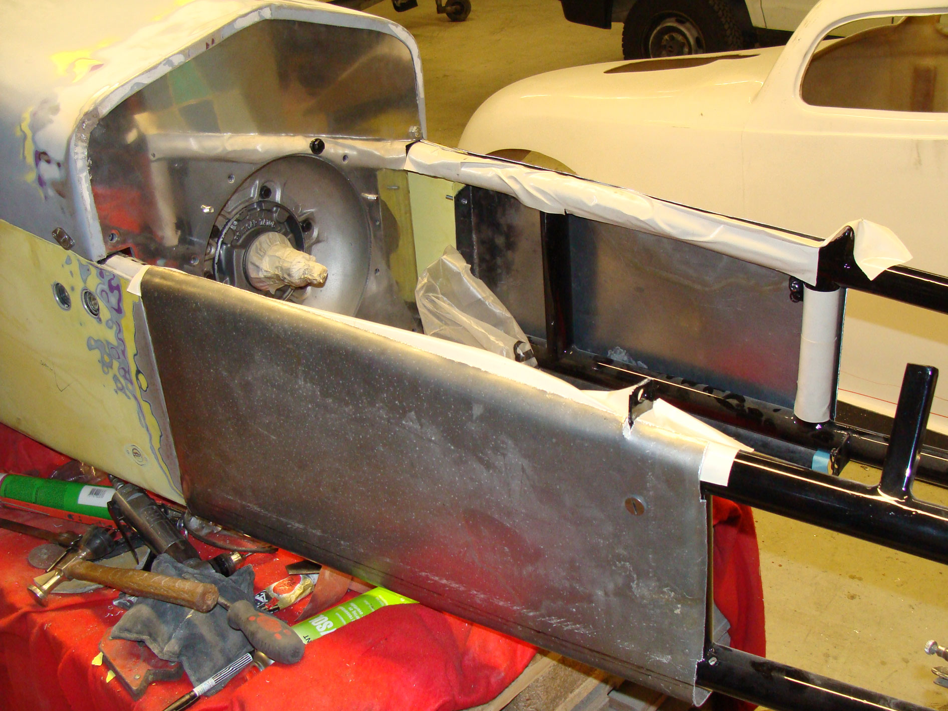

    Also almost ready to paint body, as i did some grinding and hammering yesterday!

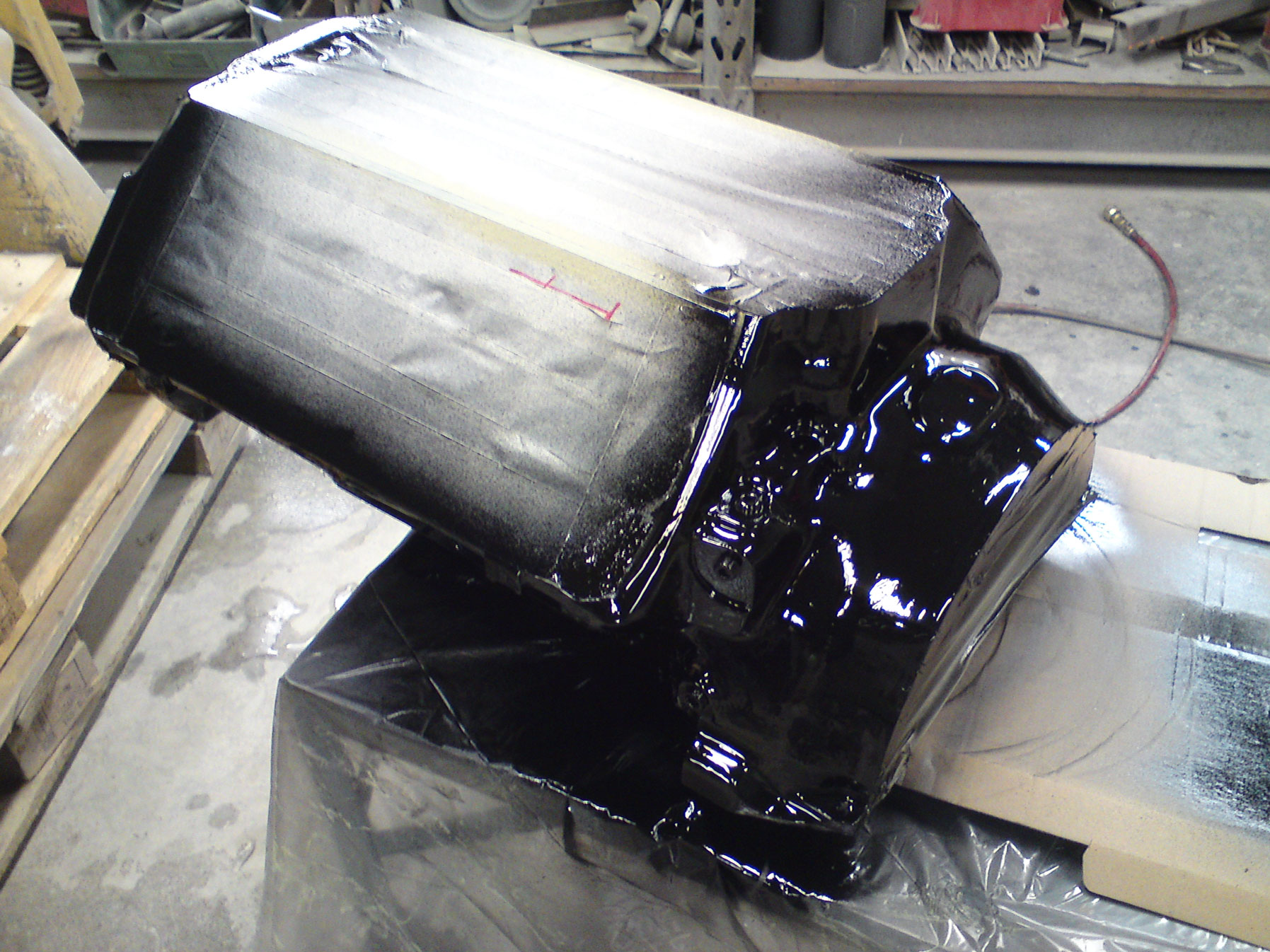

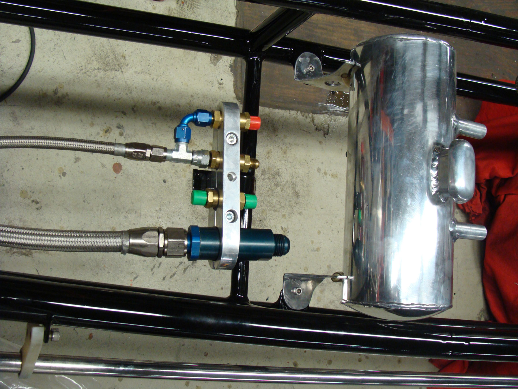

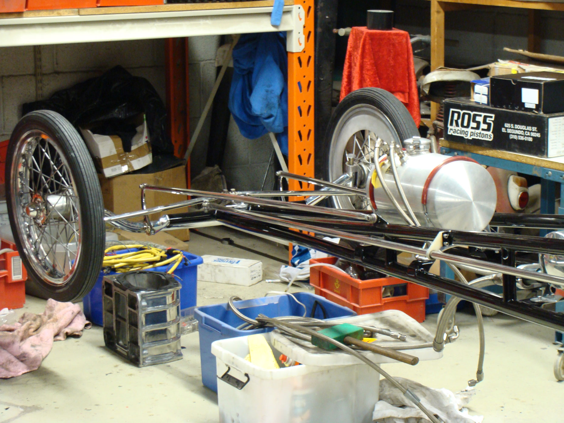

    Grinder1 redid the pan, making it alot bigger, will now hold about 2 gallons.
    I got to shoot som colour on the back-side of the bodypanels and block this evening.
    Also got the inner/floor panel from the powdercoater ..
    Hope to get the frame ready tomorrow, so somebody else can shoot it:D!
    Taildragger&fenderless

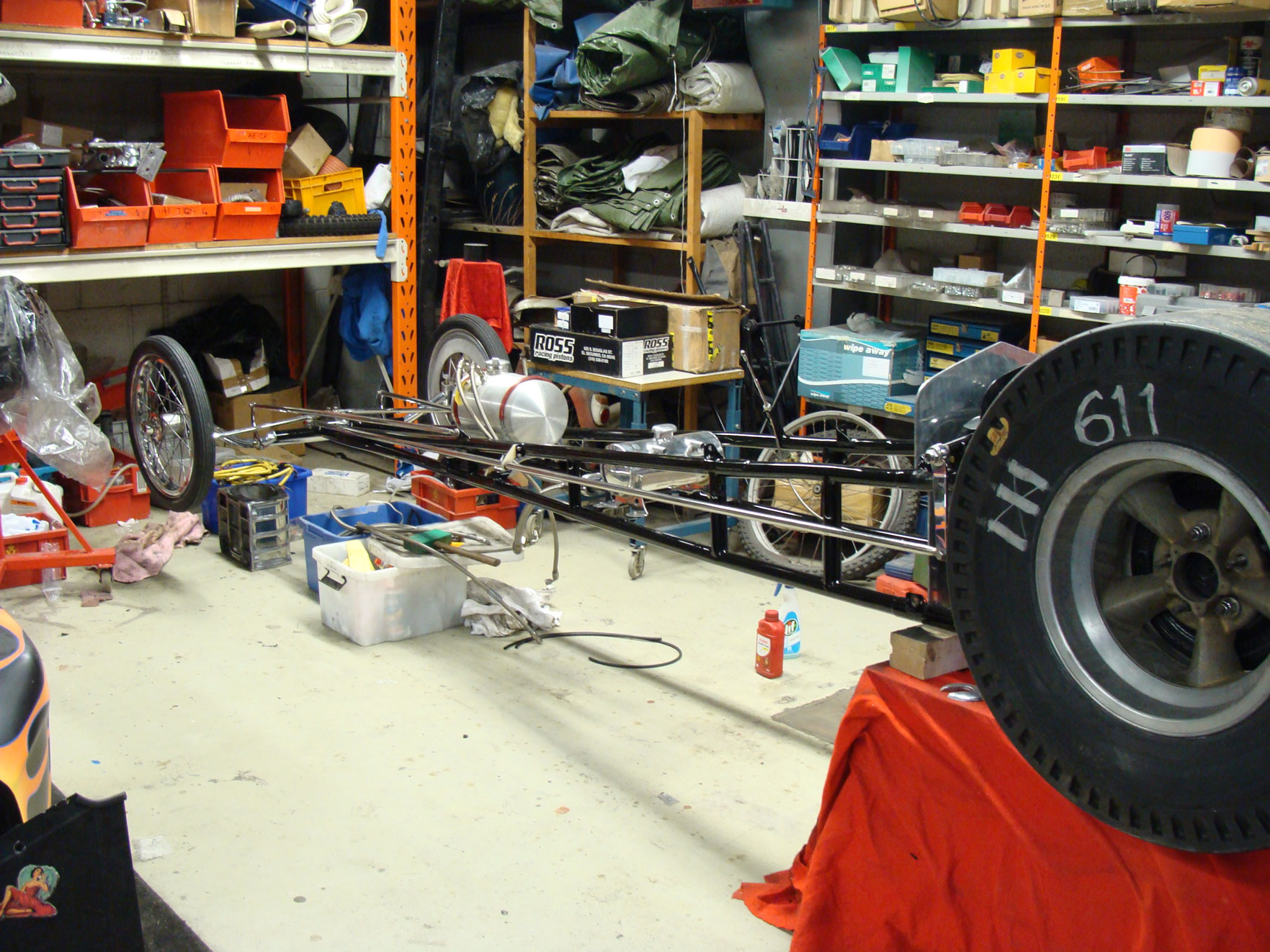

    Finished the frame today, just final prep before shooting-time:)

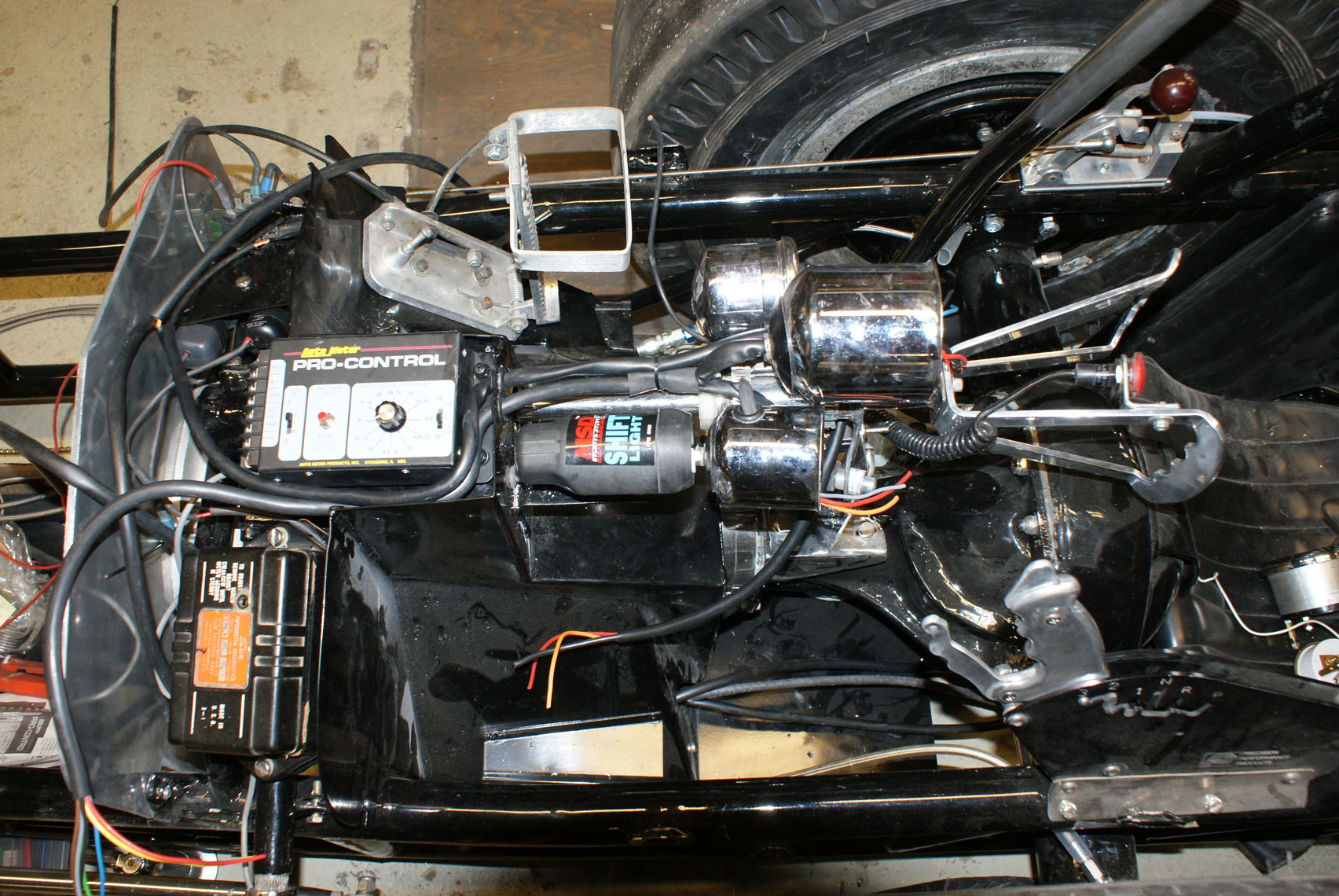

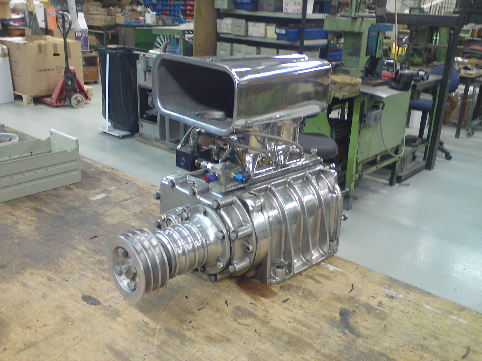

    Took apart the blower yesterday, need to plug the two holes leading to the main housing. Had an small oil lead that i could not understand, but found out that the gasket compund did not like the alcohol.
    Did some testing on the Sun blue-line water temp. guage today at work.
    Have read some threads on the issue with sender.
    The senders that i have (2Kohms cold state), don't match-up with the blue-line, as many have stated before.
    Found out that i needed about ekstra 5K ohm's to get the guage to read room temp(low/0)
    But when water temperature reaches about 200F, then it will read very low temp.
    Instead of tracking down a sender, i tryed something diffrent.
    I took a 12V to 6V converter (Sony car power for Handycam), and hooket it up with the sender that i have.
    Almost Bingo:)!? Could live with the readings, but have to map it excactly so i don't melt down the Flathead:D!?

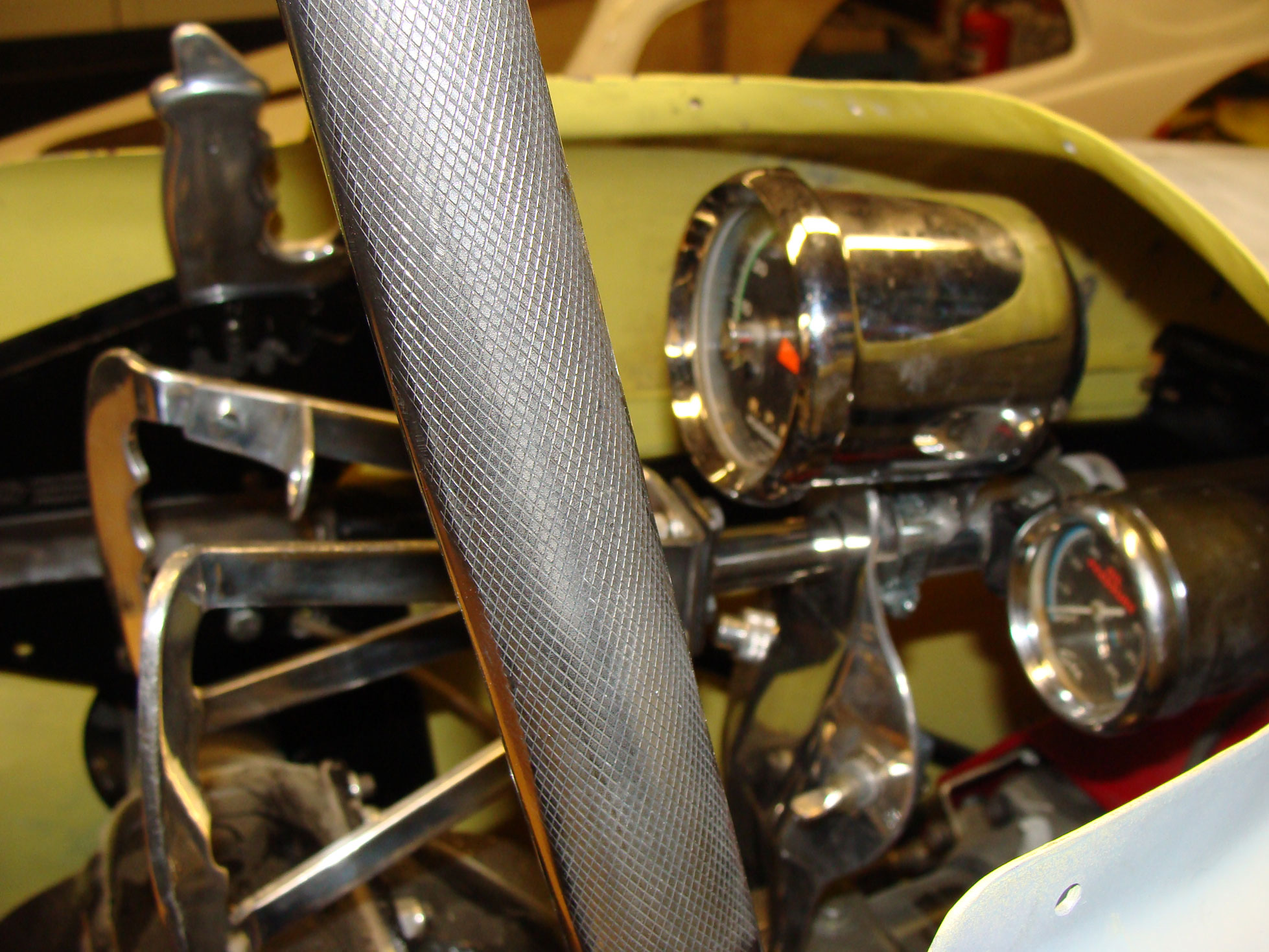

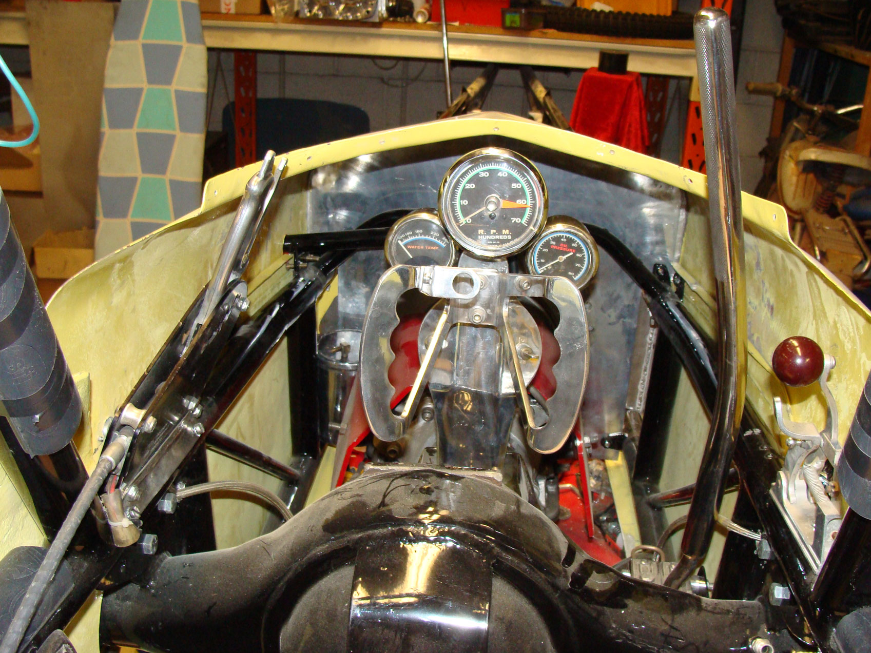

    Here is what i had in mind, the temp guage are just for monitoring right and left hand side of the engine by flick of a switch, the right temp will be monitored by my crewshief (Grinder1).
    Oil pressure is a mechanical Sun Blue-line too, so thats abit more critical to follow up. I might even put a pressure switch on it with a bulb, just to be on the safe side. Dout that in see much at the top of the track.
    (It's somewhat crouded inside the ****pit):D!?
    I have also a challenge with the tach with the Sun tach-box. The batteries innside it are dead, but i think i can make a external power-supply for the 2.7V needed.
    Same as the oil pressure, i double-up with a shift-light:)!
    What do ya think? Is it safe now:)?
    Br
    Kjell

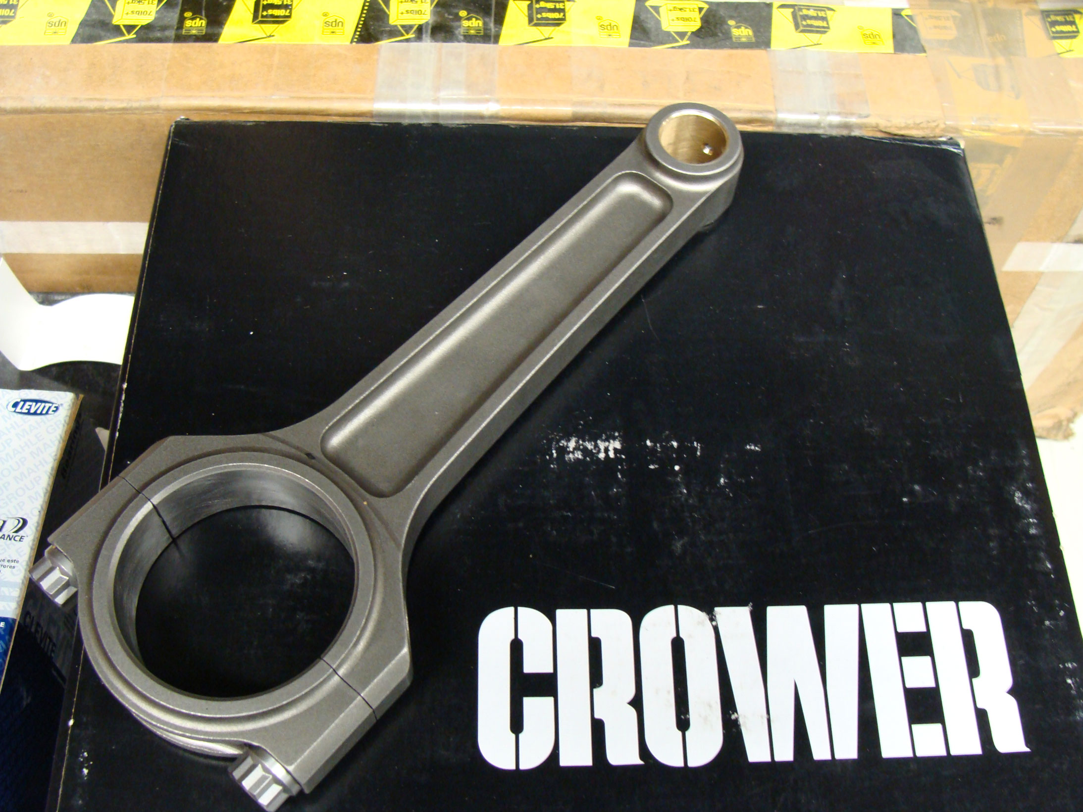

    So it's with mixed feelings that i say that i was a little glad when i finally got my Crower rods today!
    Next up is sending bottom end for rebalancing!!

    Yes, thanks to your recommendations Dale, i now seem to have solved the issue with the crank:). They really look great, and strong too.
    They are a litle bit heavier than the ****'s, 718grams.
    can't seem to find te papers on the **** rods, anyone have the weight on them?

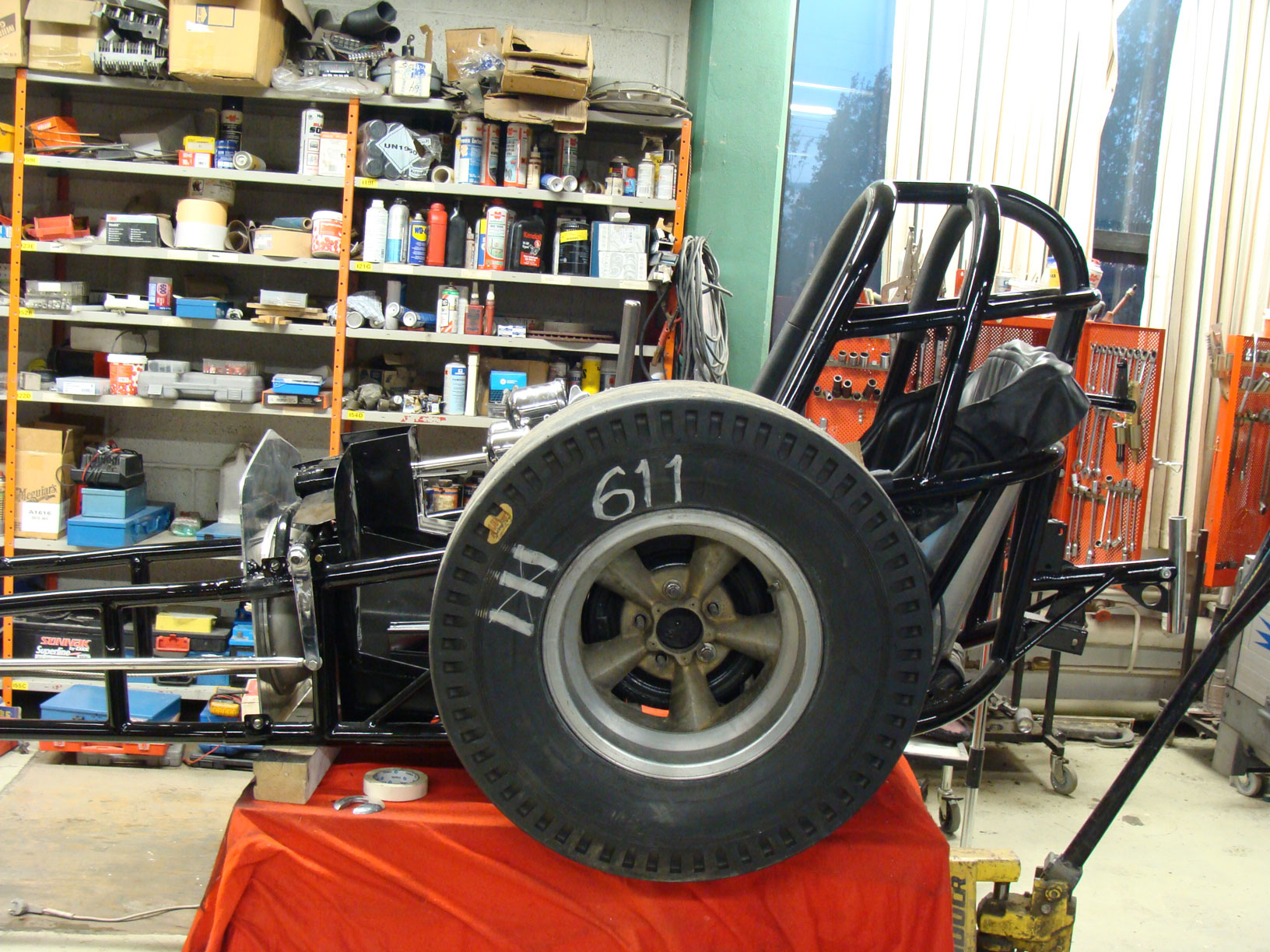

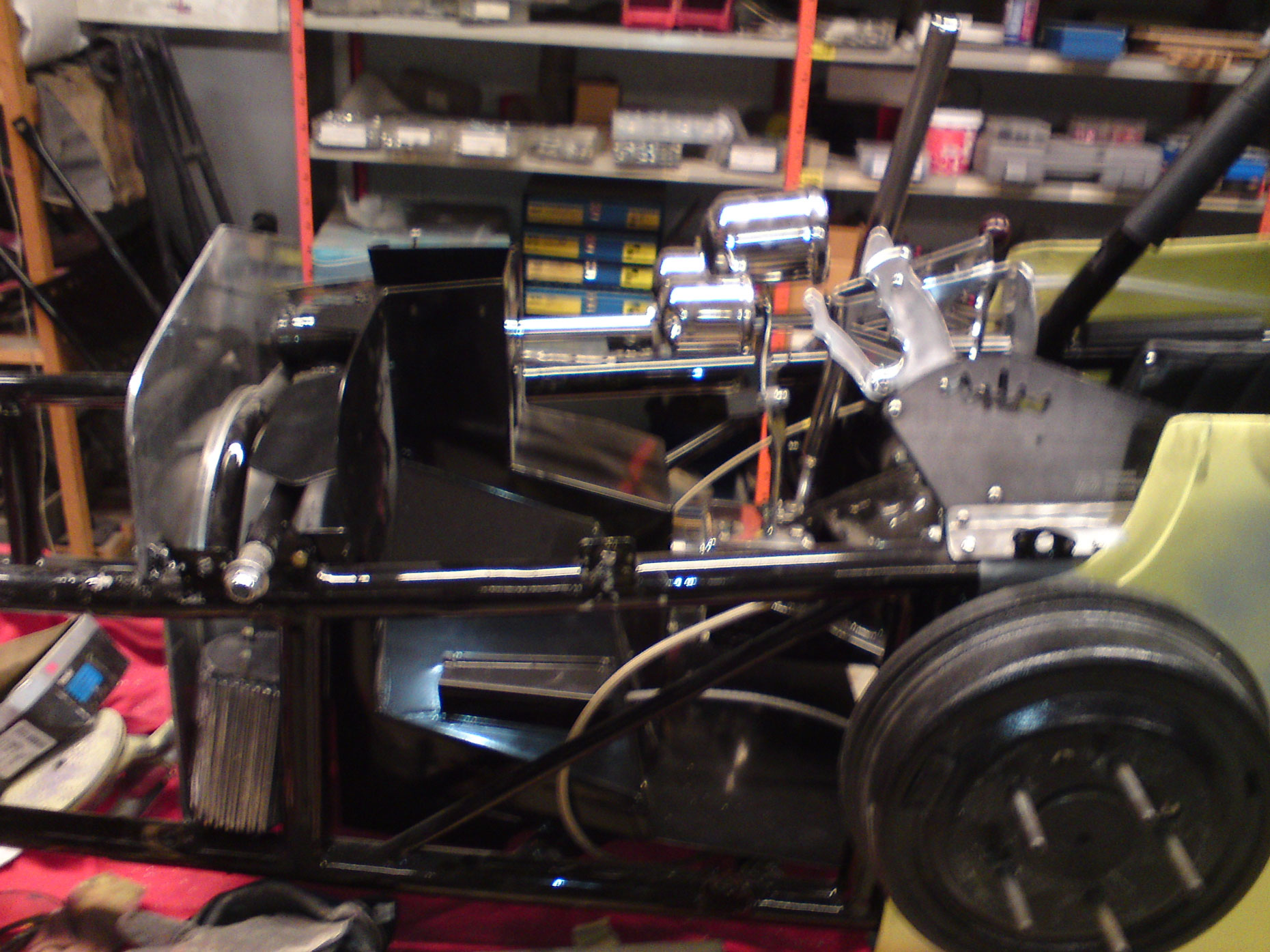

    After a small breake, we are now back on track:)
    We started to mockup the valvetrain, and found out that we are gona need some serious shims to get to our innstall hight on the springs.
    If my measurements are correct, we need a 0.255" shim, so we desided to make one solid intead of stacking.
    Second challange is to get the adjusting bolts in the roller lifters all the way down!!? I don't want to do this when they are in the block, just final adjusting down there:) I think we will rethread the bots allmoust to the head, leave some of the old threads enought to lock them??
    I have also started to wire it, some boxes are needed, sorry:)
    Also want's lights in the Blue-line's:)
