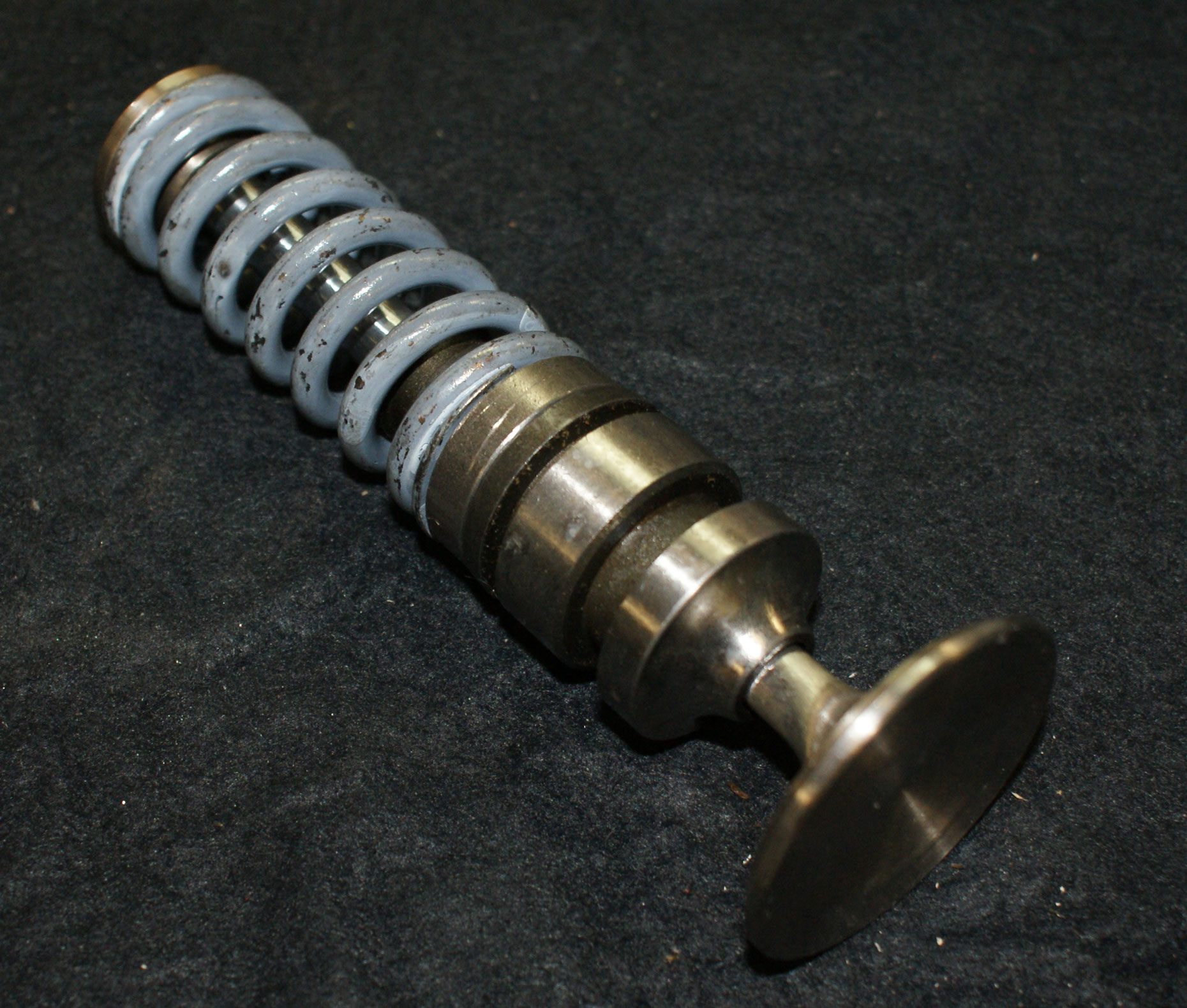

  6. Hey Kjell - look up my flathead porting article, I show how to use an off-t******lf spring retainer as an alternate method of reducing spring height (just turn the OD down on the lathe). I'm with you, if you just try to use .060 shims, you stack up a bunch at the top. Taking up some height via machining an aftermarket retainer works good.
    Roller Lifters: Are you using Johnson adjusters on the Crower bottoms? Keep in mind that I believe there is a bit of a deliberate 'cross-thread' that keeps the adjuster tight. If you re-thread them, you may need to add a thin 'jamb nut' (like you see of rocker arm adjusters) to ensure they lock down. If they are not nice and tight, then the adjustment will change on you - usually getting looser as you go. Given the pain in the rear of adjusting these dang things - you'll not want them loose!

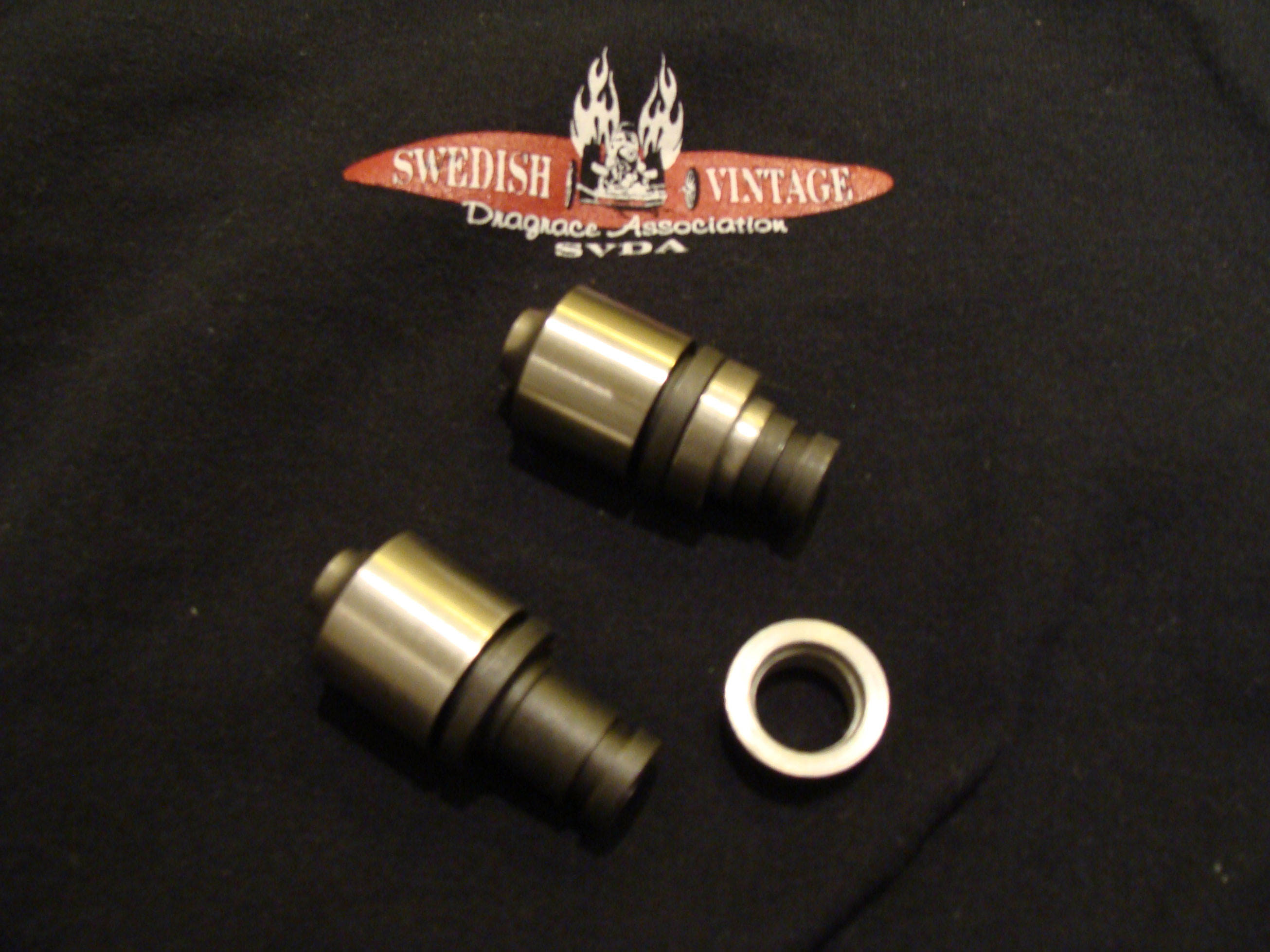

    I did look at your great flathead porting article, but as i have bought a set of ***anium retainers, we could not get the added hight/thickness. So we have to shim one way or the other. Thats way we came on the idea to make a solid shim!?
    As you say, the Johnson adjusters have a bit of a deliberate 'cross-thread'.
    And they are way to hard to get all the way down.
    I have about 0.125" clearence between lifter top to underside of bolt head.
    I did get a set og thin jam nuts, but nut that thin:eek:!
    So that's way i think my last option is to rethread the bolts, but not all the way to the head, so they could jam. Maybe i could use some lock-***e aswell!?
    I could understand that jaming them good and tight are wery important on an convential cam and liftters, as the lifters rotate.
    But on my Roller cam, the lifters are fixed so maybe not that critical?

    If the Johnson tops are way too tight to thread down all the way, you might be able to re-thread them, grind the tops a bit or potentially shorten them in length. I don't have a set of Crower lifters (though I will soon :rolleyes:), so don't know exactly what is best.
    If I remember correctly, the "cross thread locking" may be caused by the two threaded portions being offset a bit -- instead of the actual threads being off (let us know!). If this is the case, then threading the top up higher may not cause any drama.
    On the big shim, if you can, try to make sure that the spring has something to center on and doesn't move side-to-side at the top. I've seen cases where a bunch of regular shims are used and the spring has a lot of play in it as some guides start to narrow a bit when you get down past the top. Check your guides and see if the spring stays centered (hopefully it does). If not you may be able to make the shim to cause it to center/locate better.
    How much spring pressure are you looking to have when closed?
    Dale

    You are spot on Dale:)
    Looks like the threads are 'off set'. But I wil check once more, as one halfe of the lower section, broke when i took them of the French lifters.
    I will cut the lower part off completly and check if it is tight too.
    Regarding the shim, your idea is really good:):)
    If i understad you correct, i make the shim similar to the retainer, but thicker, with a spring guide inside the spring. Preventing it traveling!?
    I followed your recommendations, making spring pressure 100 pound on the seat.

    - First to check the adjustment bolts. Took the one bolt that the lower part had broken off, cut the lower part completly off. Tried to skrew it down in the lifter, but same problem, too tight. Desided to rethread it, did not break any of the current threads, just whent down much easyer in the lifter. Did not rethread all the way up, left about 1/8" to the underside of the head.
    It locked really good, with the correct valve lash.

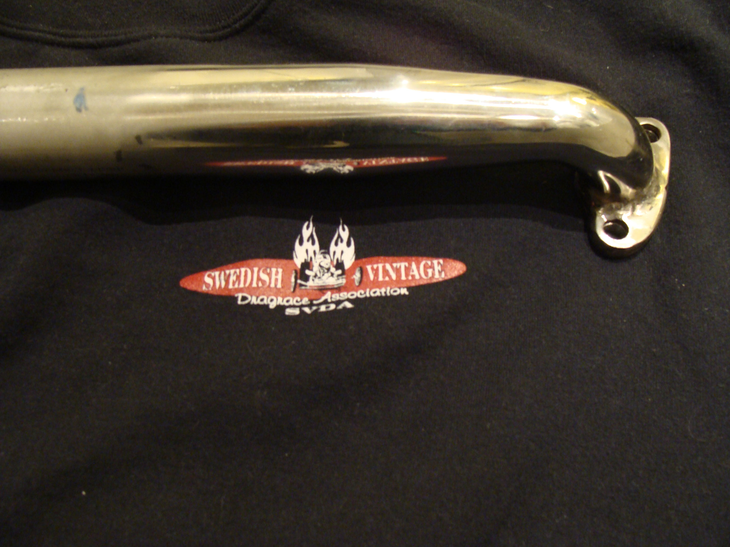

    But have manage to finish all the bodyworks, and actually p***ed,
    the shooter aproved my work, so he will do the paint within a couple of weeks:)
    Roger (Grinder1) has done more suppurb work on several details,
    made a new pully on the blower setup, finished the fourth ex.pipes,
    (me next, cutting and polishing).

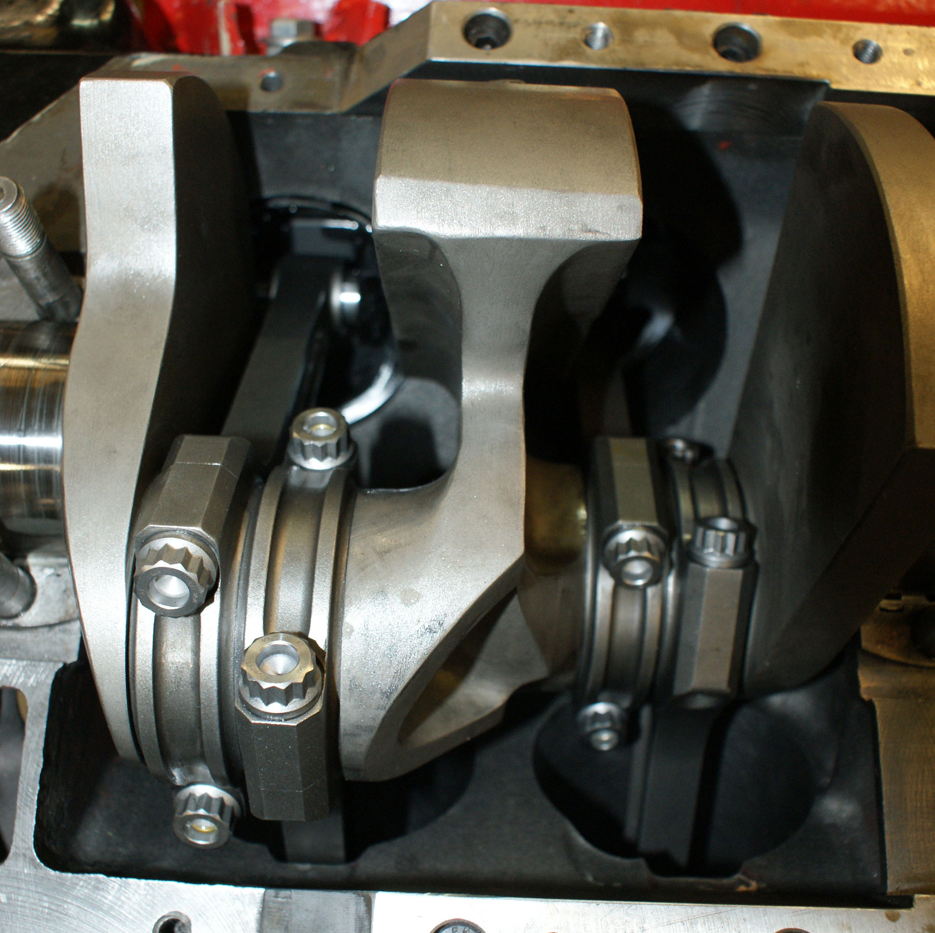

    Anybody know how much clearance i need between camlobe and crank counterweight?
    Br

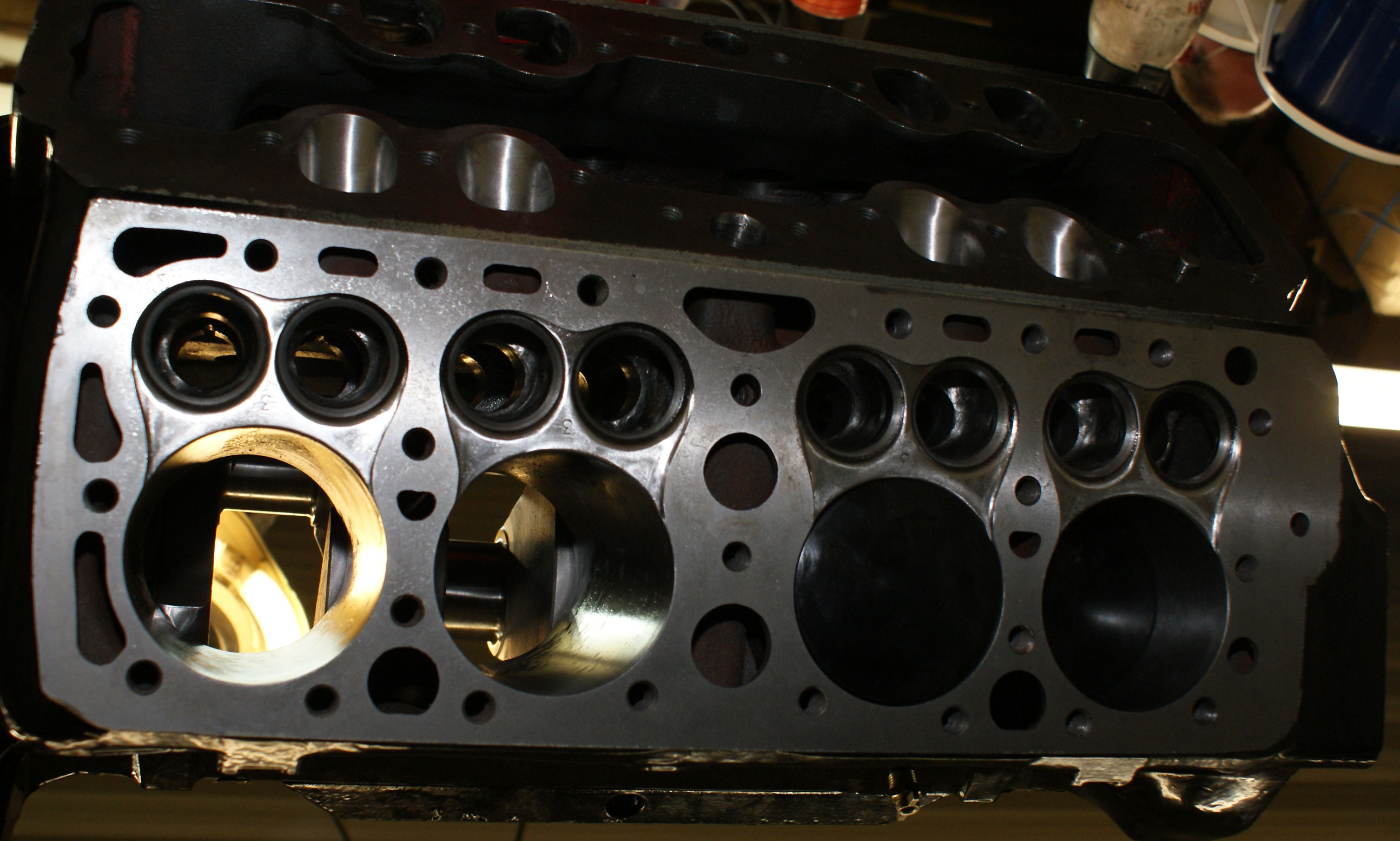

    from Norway
    Home after a long day in the garage:)!
    Finally had the chance to try the crank, but had some clearence issues, so
    after some grinding, it heads back to the machineshop.
    Allthough we had to do this, i still feel that we got alot done today.

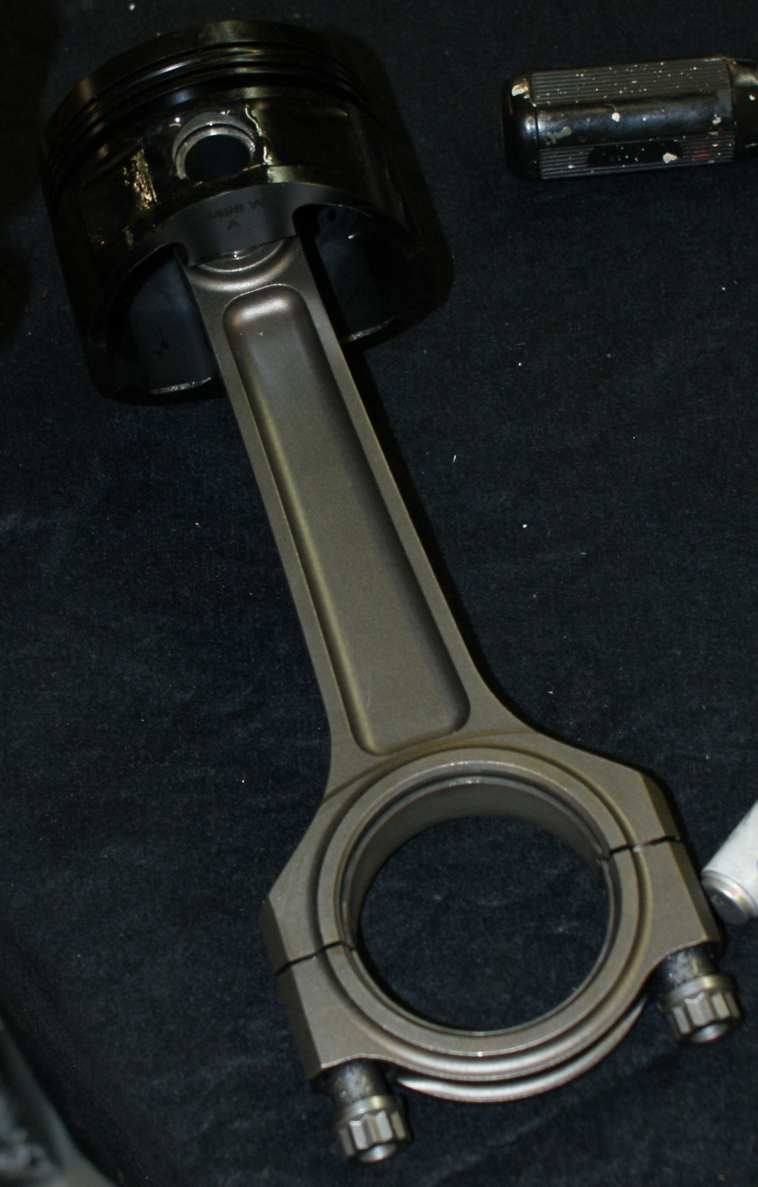

    All pistons are mounted on the rods.
    As the rods are way wider than stock, we have to mount them from the innside:eek:!

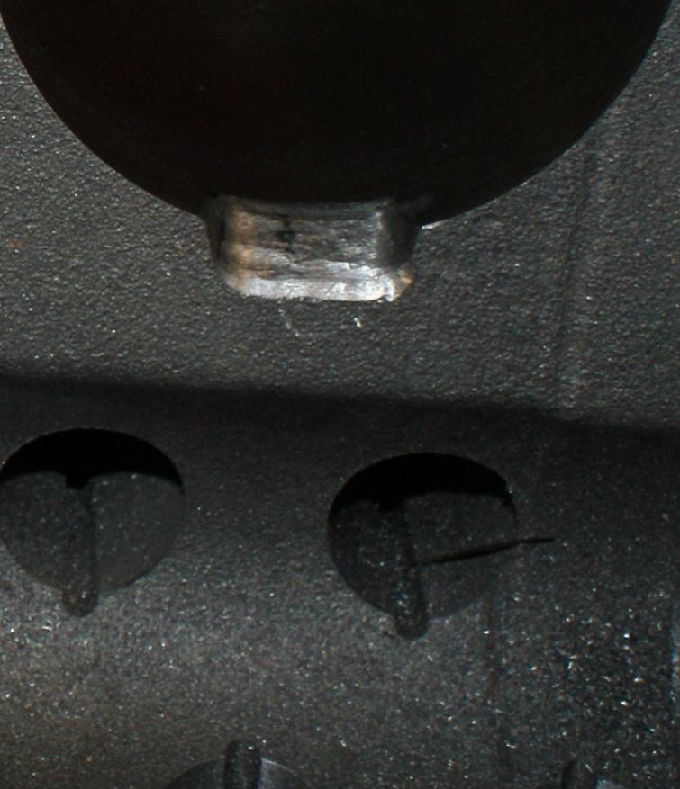

    We also have to grind a notch in the bottom of eatch cylinder to clear the rods. I knew about this so no drama:D!
    Hope to get some more done tomorrow:)!

    First of all, i wanted atleast 0.080" clerance on all moving parts.
    But the crankshaft clearence i asked for, well abit wrong thinking:D!
    I just turned the crank and cam seperatly, then they hit eatchother,
    me panicing abit:D! But when timed up, no problem:)!
    But desides to grind some anyway, just to be om the safe side:)!?
    Those crower rods are really big, a litle glad i didn't go for aluminium ones!?

    Have spent some time on the roller lifters. I think they are gona be hard to adjust!? I don't think the two balls on the side is gona hold when adjusting.
    Either way, i will need to grind down the lifter bosses about 3/16" so i can reach the adjusters.
    One other solution, is abot the same as useing johnson lifters, drilling a hole in both the lifterboss and lifter itself. 1/8" drillbit, about 1/8" from the top of te the boss?
