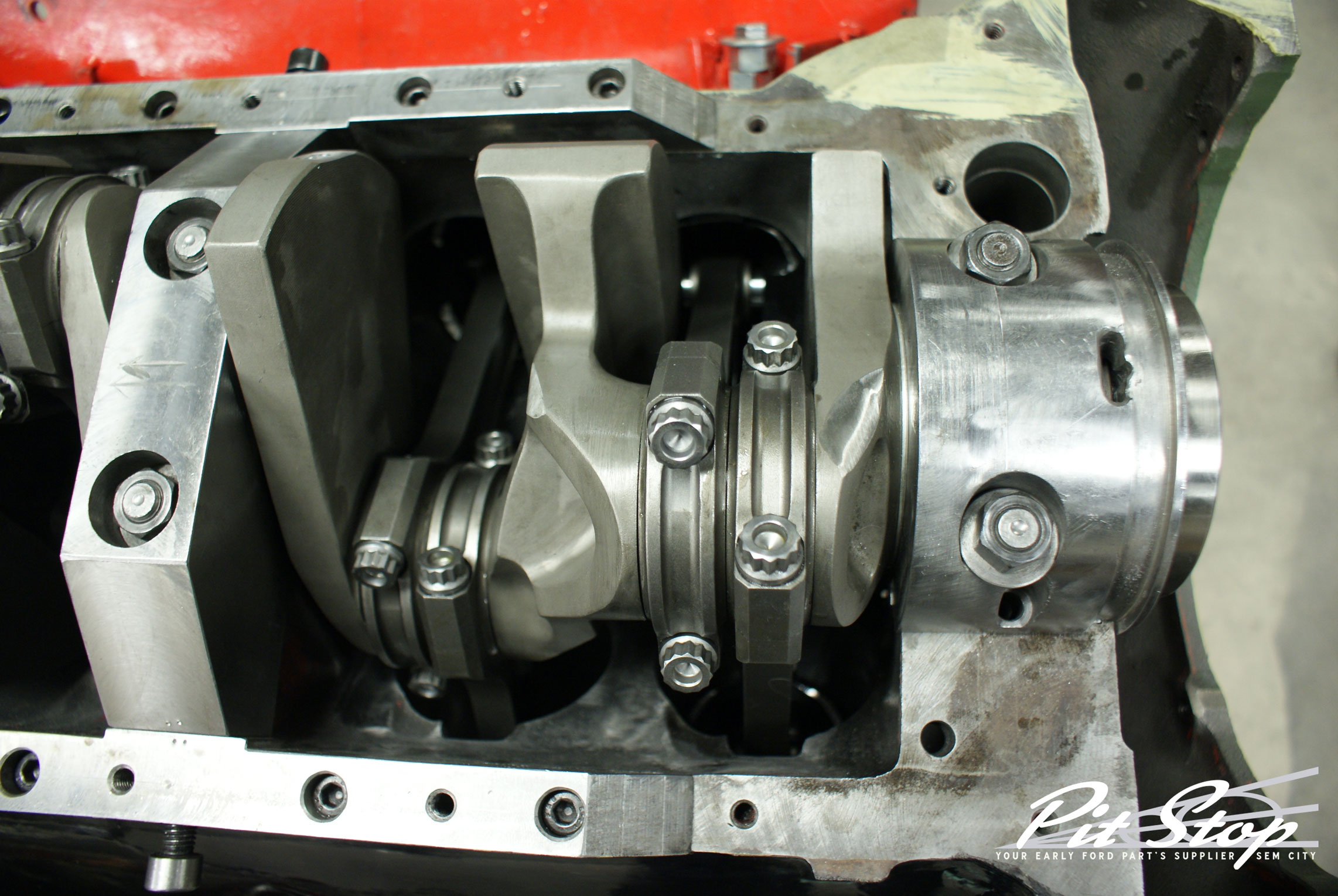

    YES! Crank finally back:)

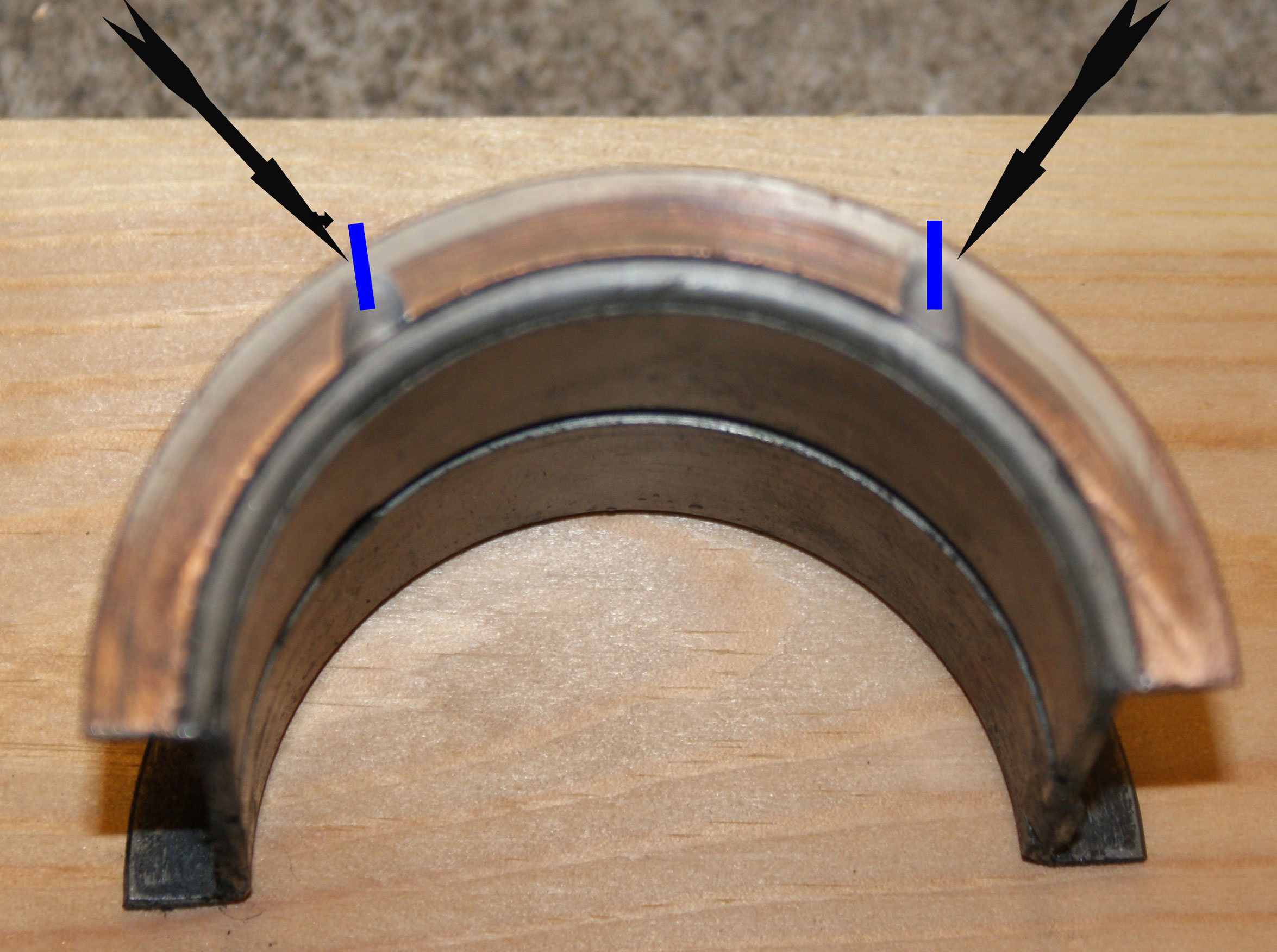

    But as you all know, allways some challenges on custom engines this old!<O:p</O:p
    As all main caps are fabricated new ones, rear main didn't fit right when innstalled with new bearing.So Grinder1 had to take it for a minor adjustment on the mill. Hope it will fit better when we try it out this week!? A litle conserned about oil not escaping from the rear main!?<O:p</O:p
    Here is one idea;
    Grind/file a small track extending the two existing notches in the bearing?<O:p</O:p
    Have anybody done this before?
    <O:p</O:p
    I have to gind some more on the block, small adjustments, so all rods will clear, 0.080".

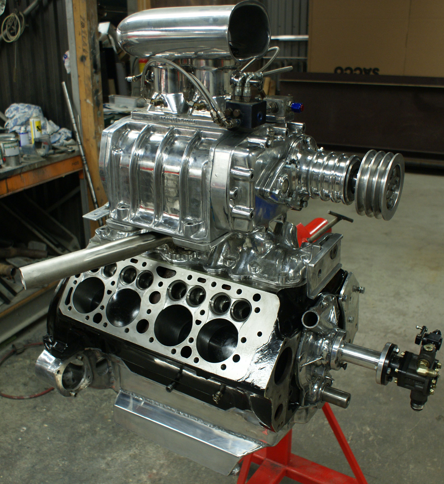

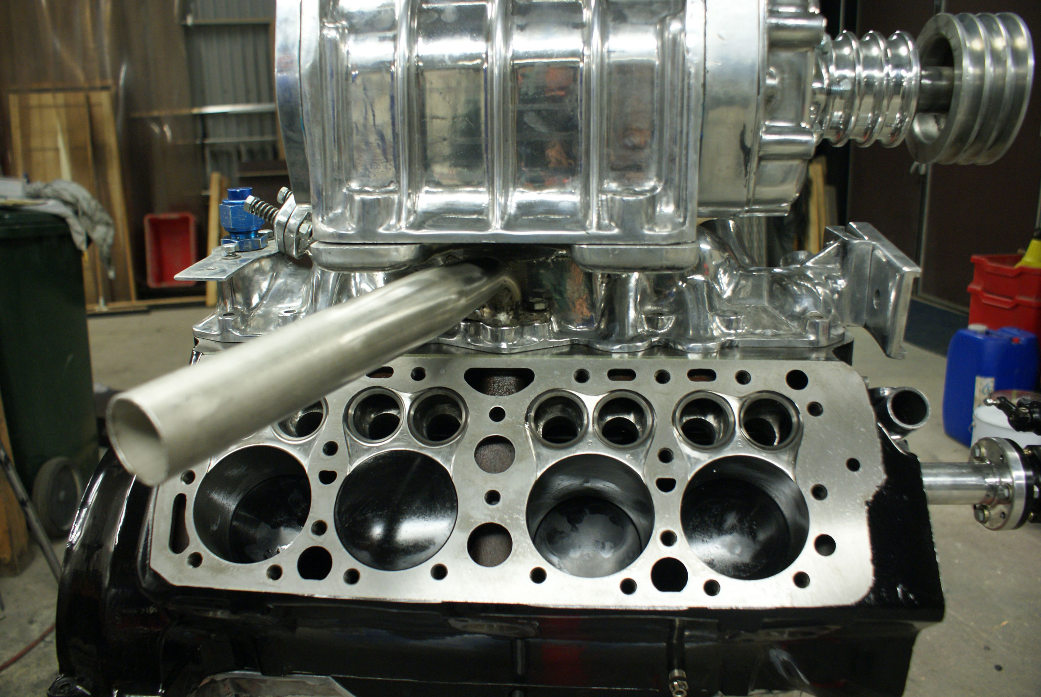

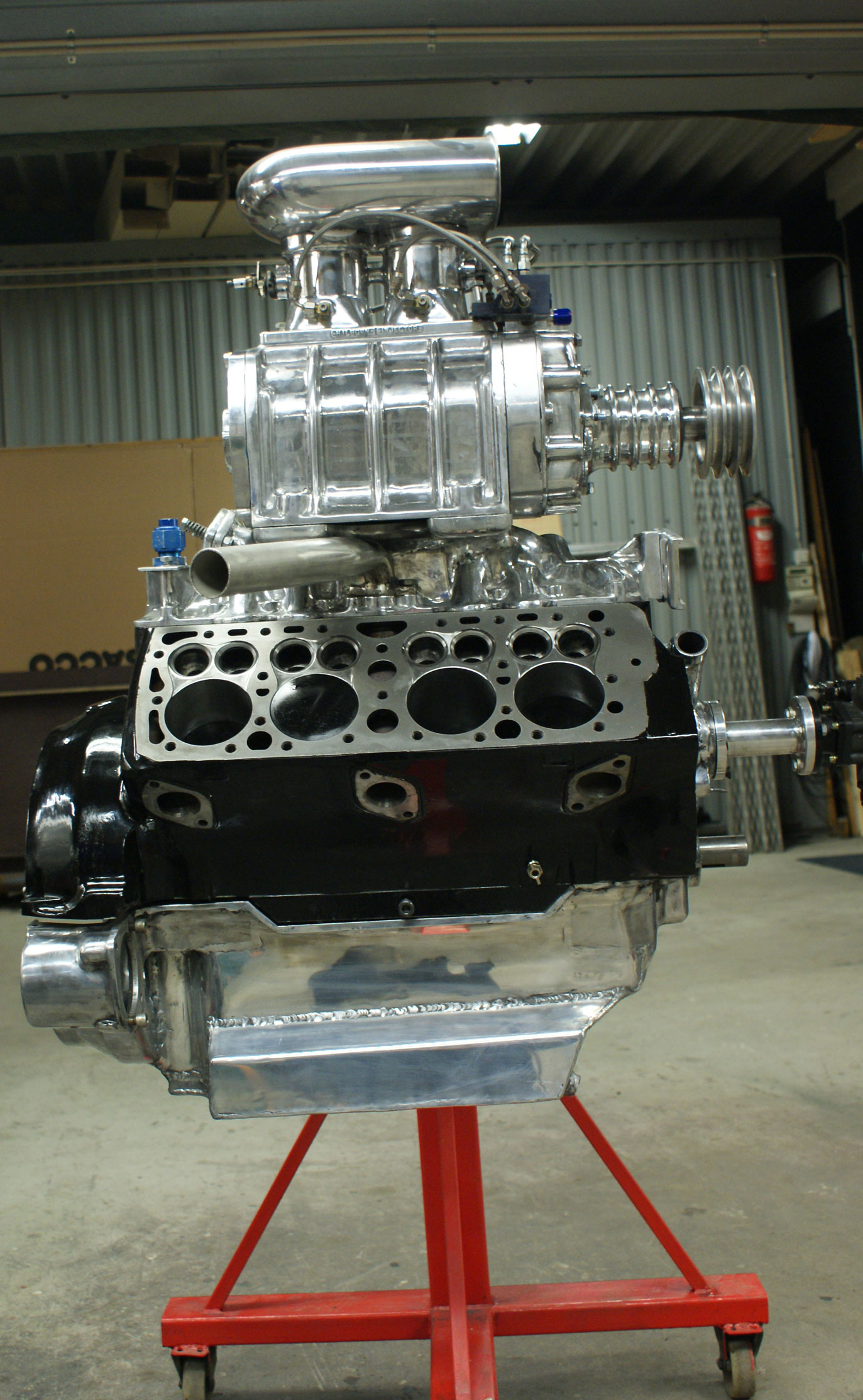

    Well, big improvment this evening:D!

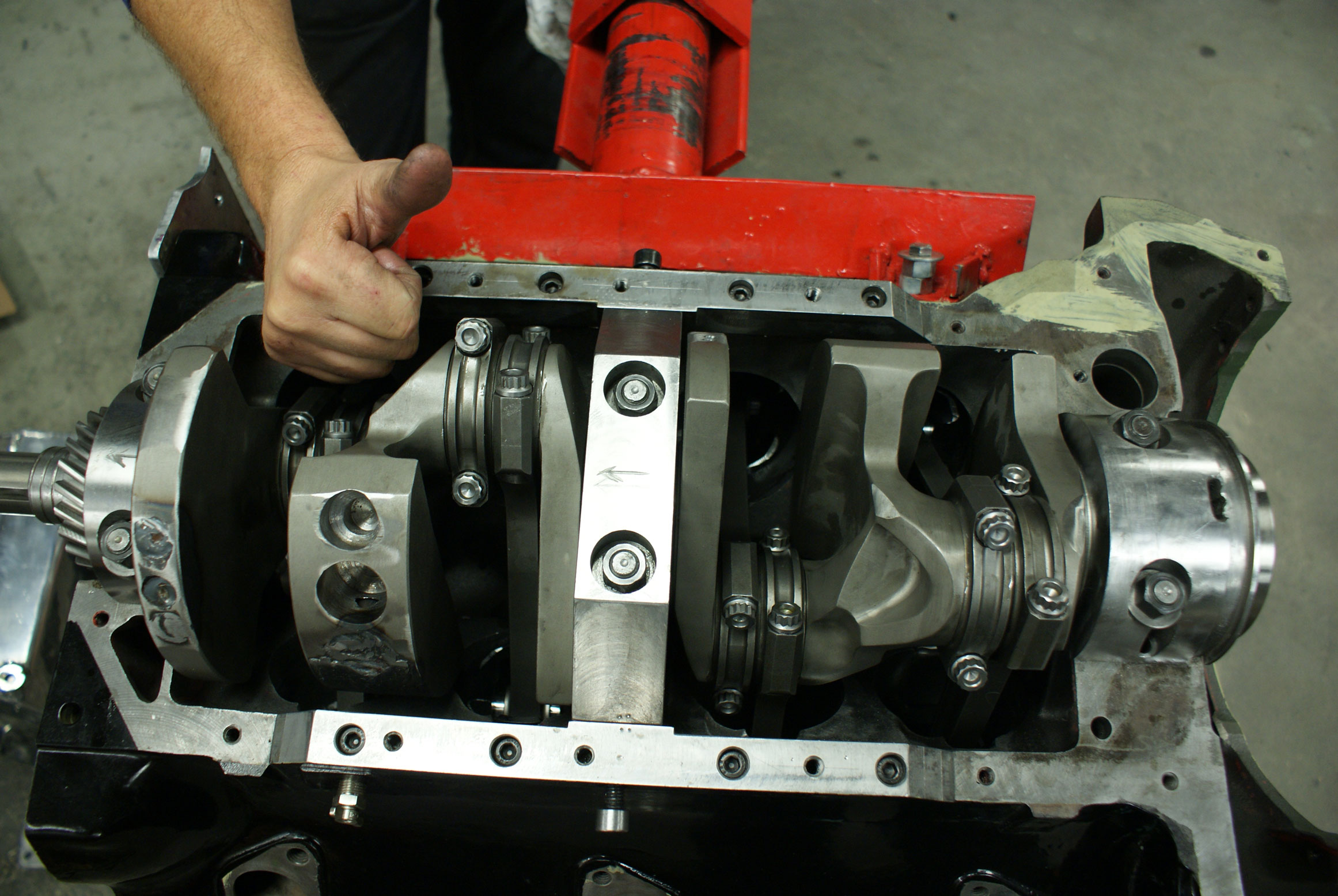

    After scraching our heads, read frustreated, we finally found out why the crank locked up when trying to fit the rear main. We had grind down the face toward the crank a bit, small cuts. We checked and re checked the thrust end clearence, was within Dale's recomandations.
    We finally found out that we had taken a to shallow cut to clear rear thrust/oil-slinger ring. A 15 min. job, then everything fitted like a glow:D!
    Crank spunn really easy:)!
    Mounted the rods to check final block clearence, OK:)!
    Big smiles and thubs up:D!
    Then had to mock the engine up, just to get an idea how it looks!?:D!
    You be the judge?
    Dale! Files will be sent to me next week, the guy needed to make some ajustments, before final files.
    Br
    Kjell

    Here is a closeup of the bottom end, rods finally clear the block:)!

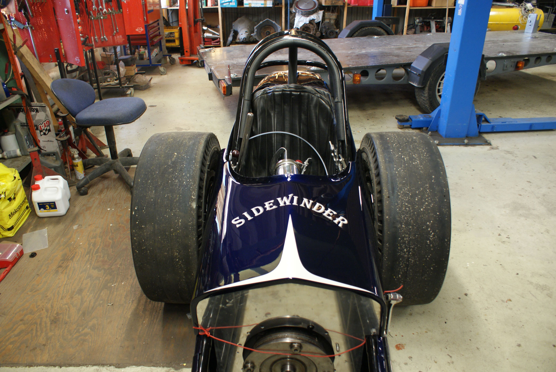

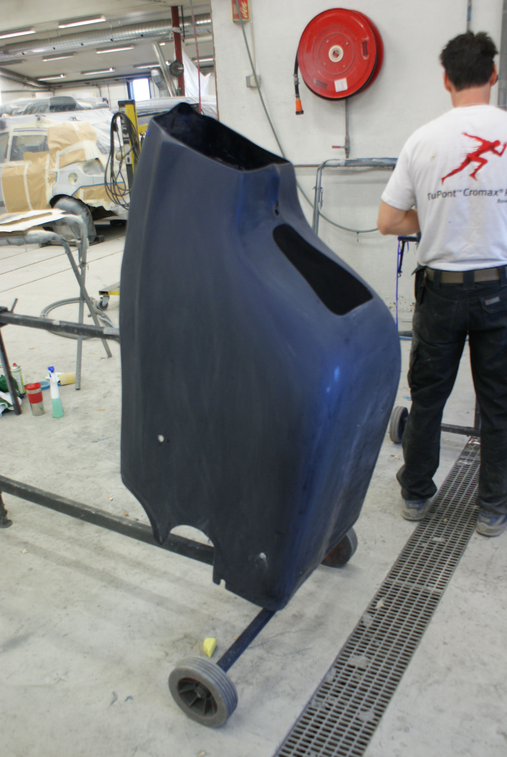

    ALOT done this weekend:D!
    Master painter did his job with flying colours!
    Here are some pictures after prep, basecote, clear, sanded....
    and really cool part, masking for the details:)!
    Taildragger&fenderless

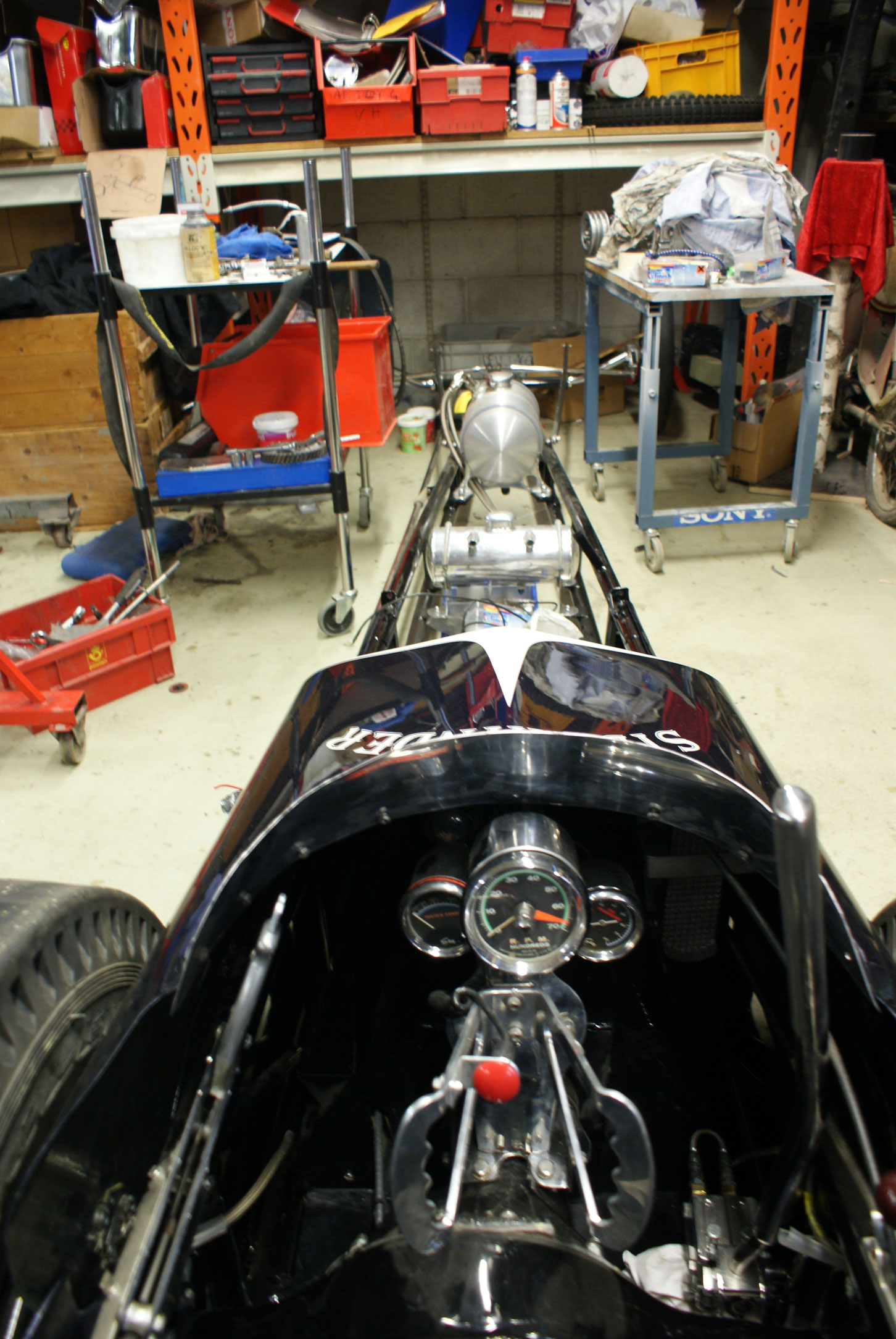

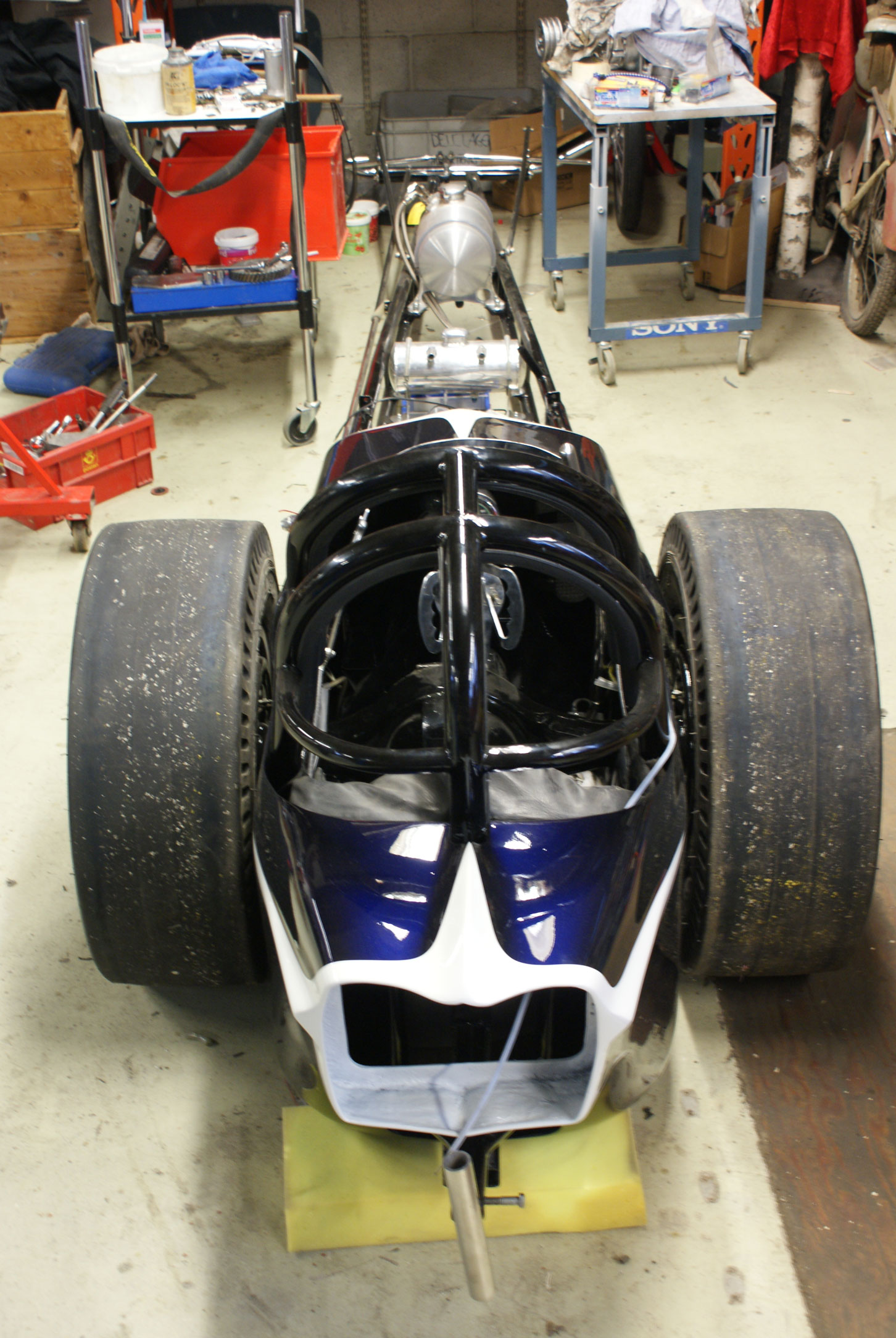

    We plan to install the piston-rings inn wednesday, also get the cam and lifters inn. I we do this, and get my hands on the DXF files.
    And no other hurdels on the way, we plan to get it ready by end of the month:eek:!????

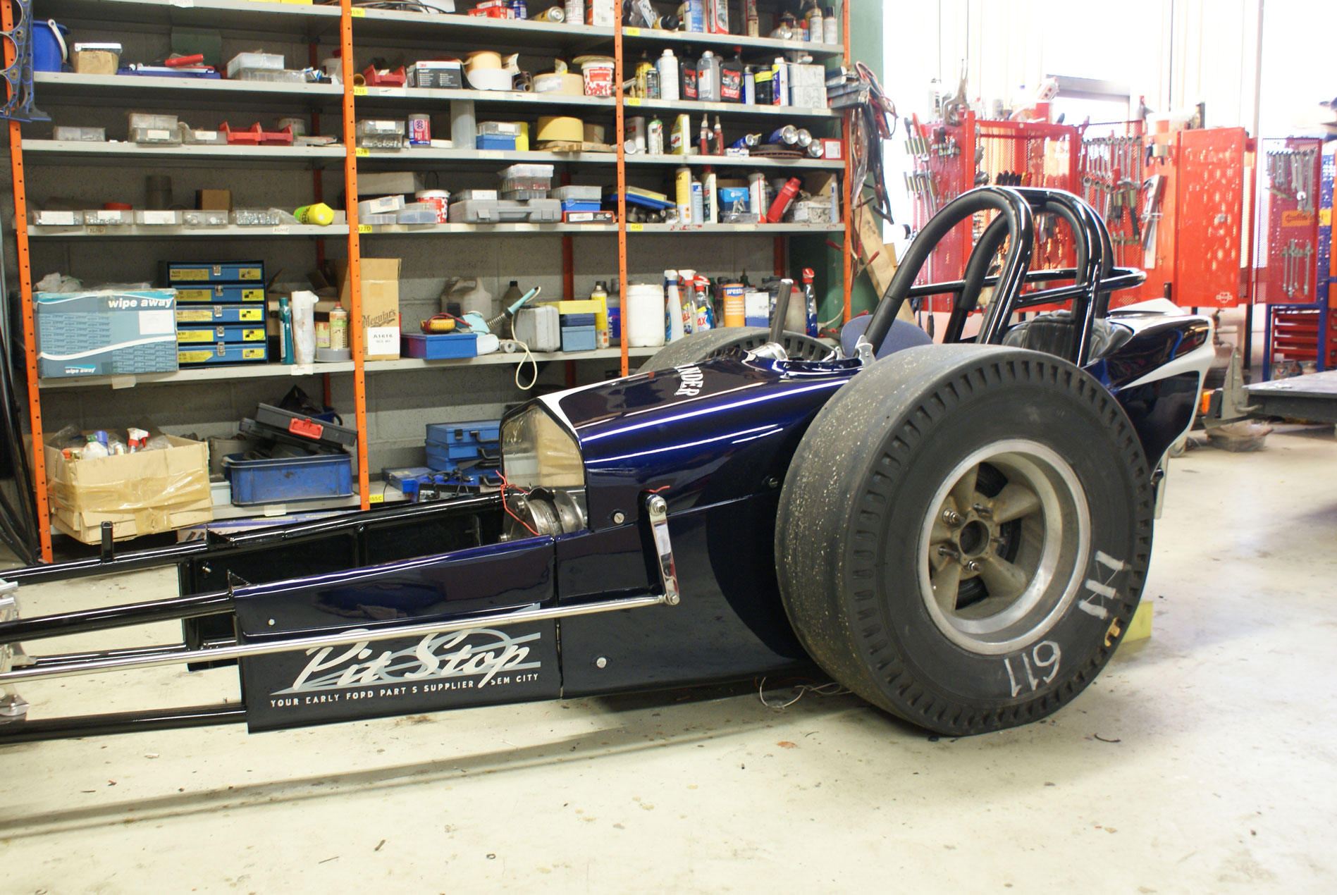

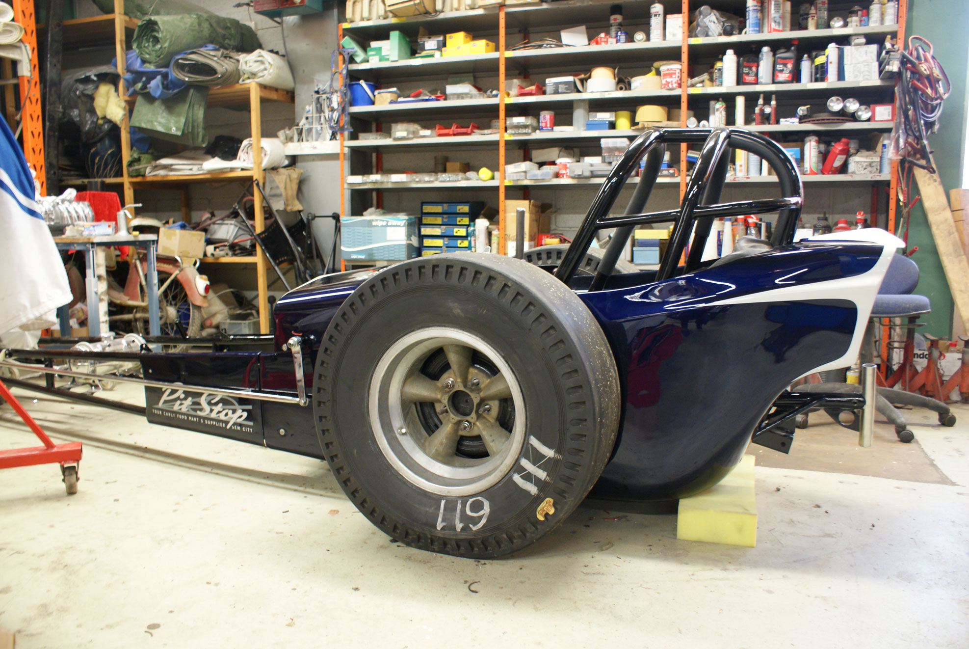

    Oh, here are some more pictures of the paintjob:D:D:D!
    Br
    Kjell

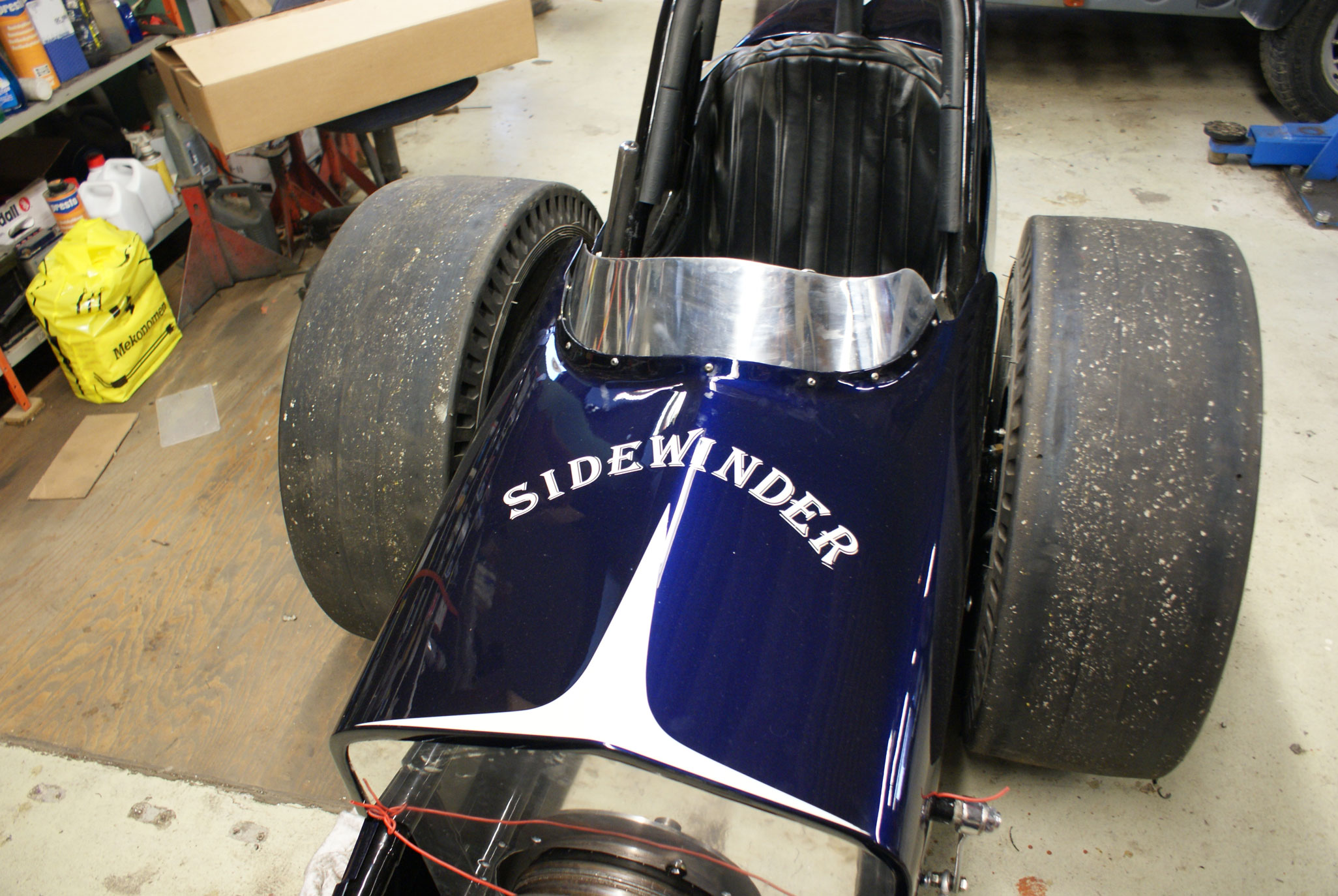

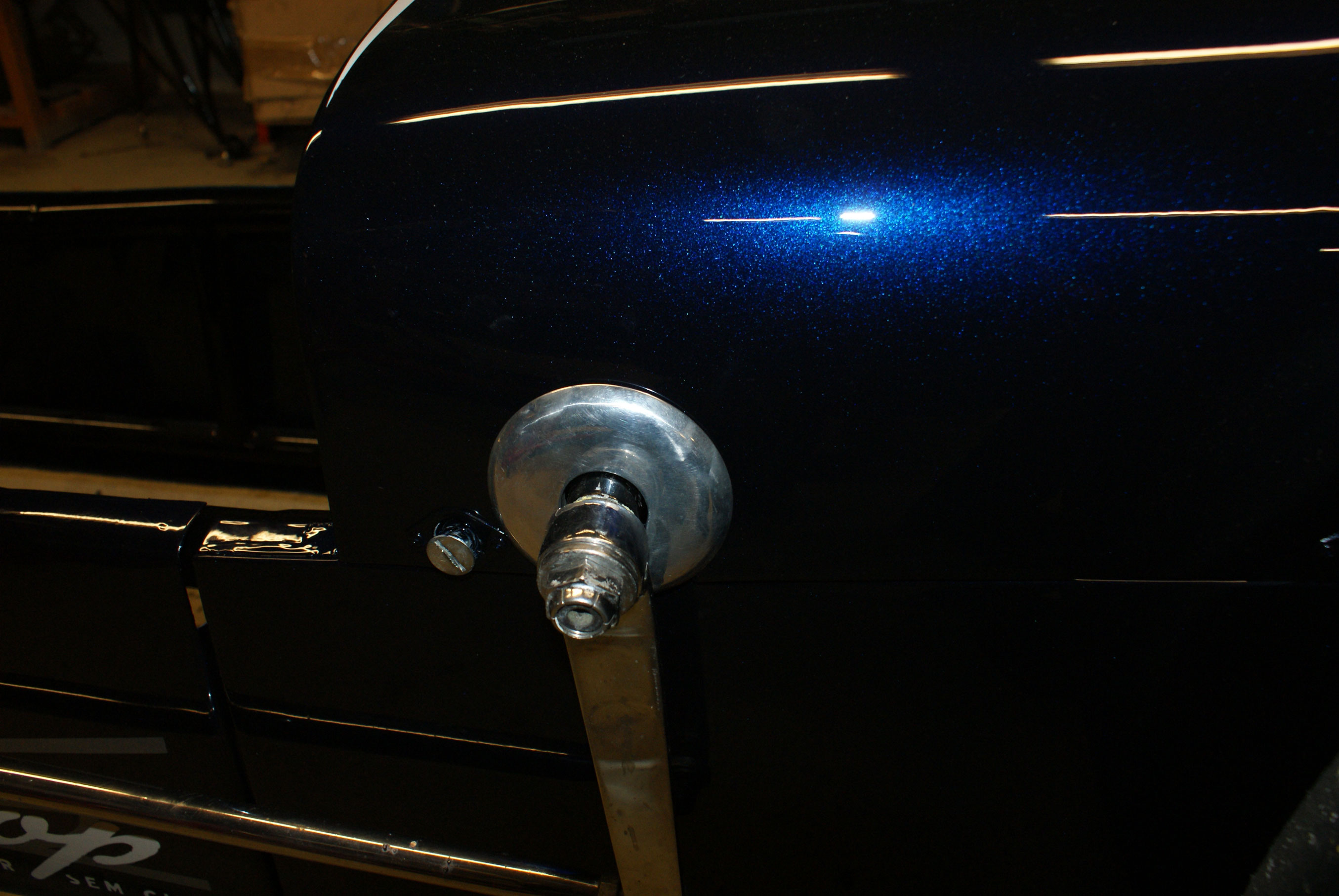

    Mounted the new windshield, and the painter came up with a very good idea for a small cool detail:D! You'll see later on!
    Also tried out Roger's steering axl-cover.
    More work to be done this week, so we can let "the killer" down in the ch***is!
