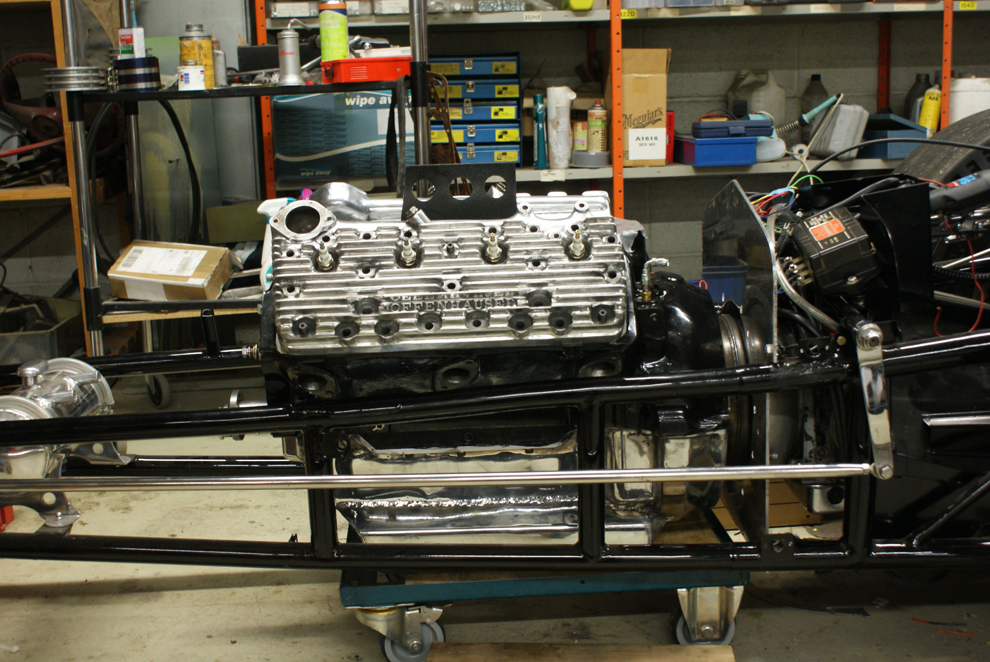

    Have innstalled 8 out of 16 valves. We ended up with
    0,013" and 0,015" cold.
    Talked to the guy who helps us with the gaskets, and he's doing stuff today:)
    We need to recheck the valves to head clearence, before making final cut. So if no more trouble comes along, we should be able to let her down in the ch***is in a couple of weeks:)

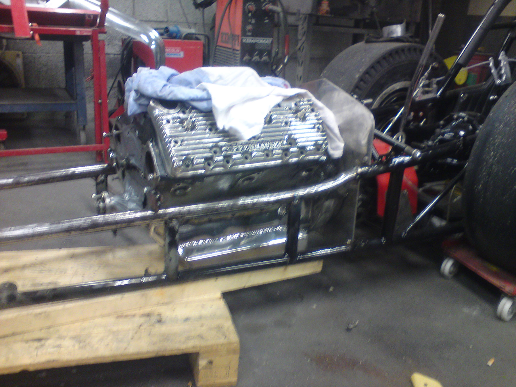

  11. fenderless
    Joined: Mar 31, 2006
    Posts: 1,286
    fenderless
    from Norway
    Buddy, i'm shure gona post a video when we fire this thing up:D!
    As a Sony dealer, i will probaly get decent camera, with a correct microphone to get the sound right:)!
    But first i will have to get her down in the ch***is, made an engine lift plate today, so we are soon getting there.
    Betveen Xmas-tables and other xmas preperations, i will try to let her down, so we can do the final fabrications.
    PS. This picture was taken with my phone, sorry out of focus!
    Br
    Kjell
    Taildragger&fenderless
  12. fenderless
    Posts: 1,286
    fenderless
    from Norway

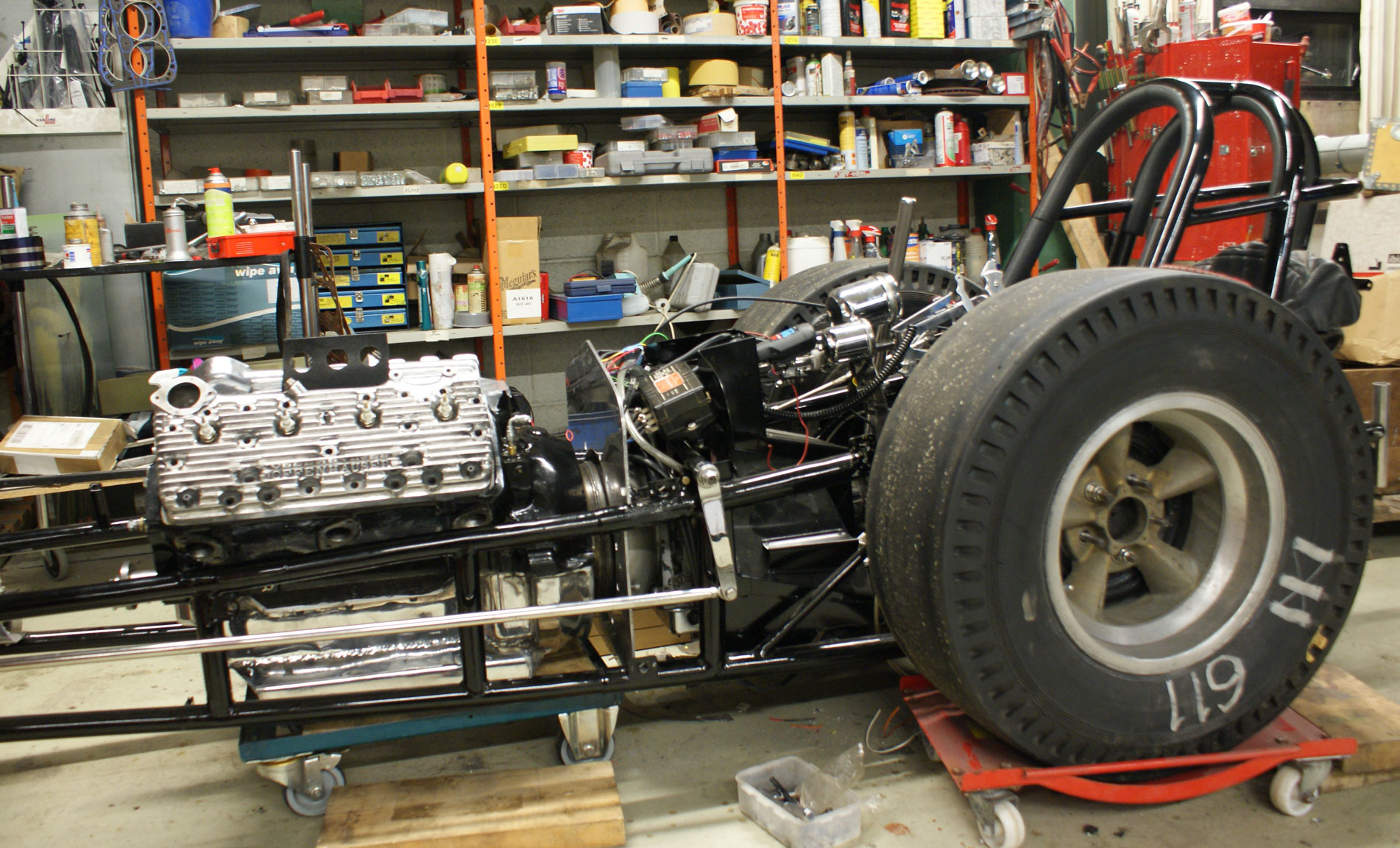

    Finally got the back-breaker into it's final space. hopfully:)
    Some small mods, and it will slide right inn!?
    Grinder1 and I has allready started to plan a new inntake manifold,
    but we will settle with the one we have for now.

  15. fenderless
    Posts: 1,286
    fenderless
    from Norway
    Hello guys:)
    Happy new year:)!
    Seems like i have done a big mistake!?
    As i have run with the flathead before, i didn't bader to messure or
    mockup the new engine inn, major mistake!
    Now, with the new(Old) engine inn, i discovered that the angle of the engine/trans. was wrong, it have been tilted uppward atleast 2" in the front of the engine. This was don probably to clear the exhaust pipes from ch***is. As you can see, all the ports now point directly towards the upper ch***is tube with the "package" in the right position:eek:!
    So a litle setback, but should be ok to fix, just some cutting and welding and we will be back on track:)!

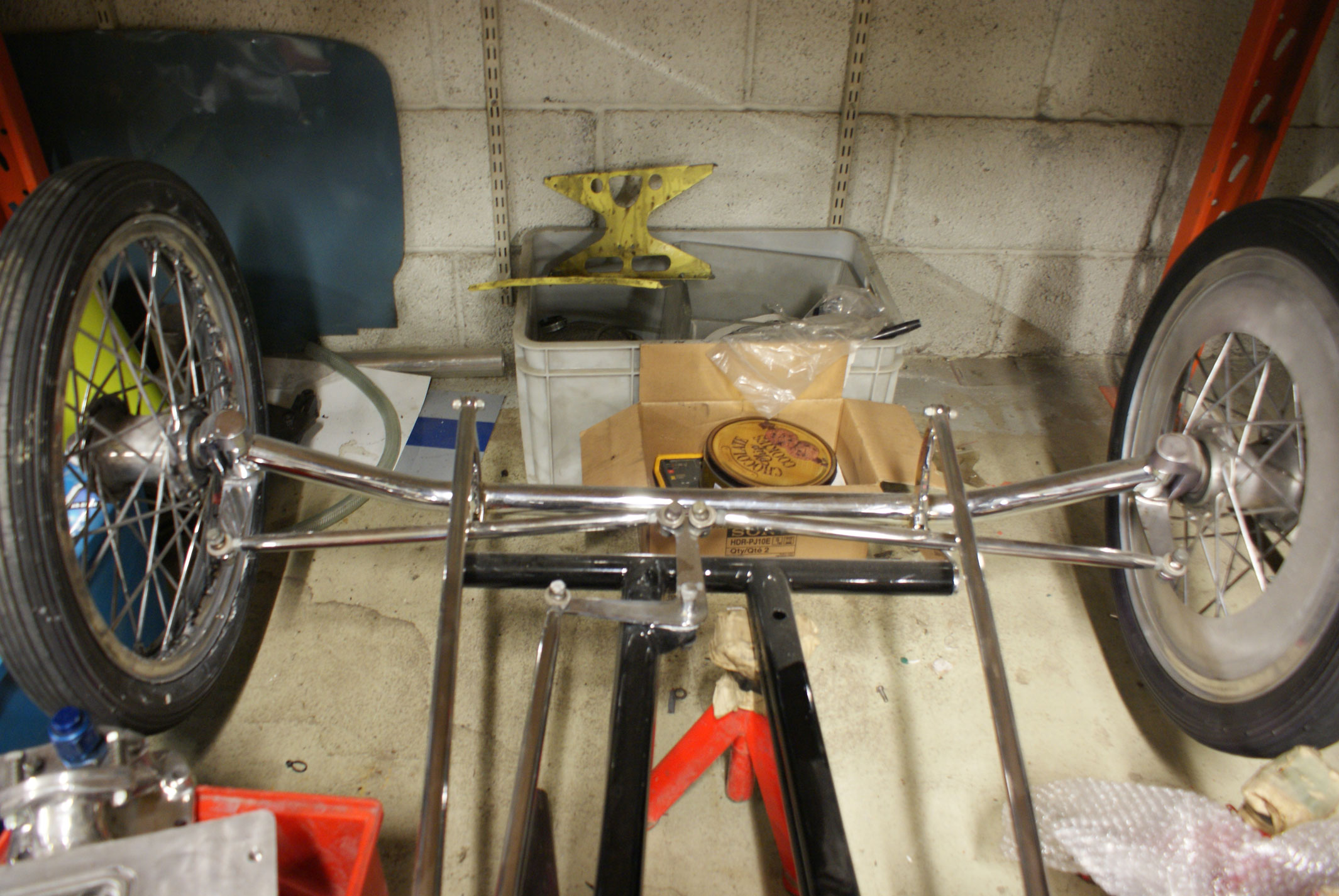

    Some other pictures of the frame, inncase someone could recognize the ch***is?

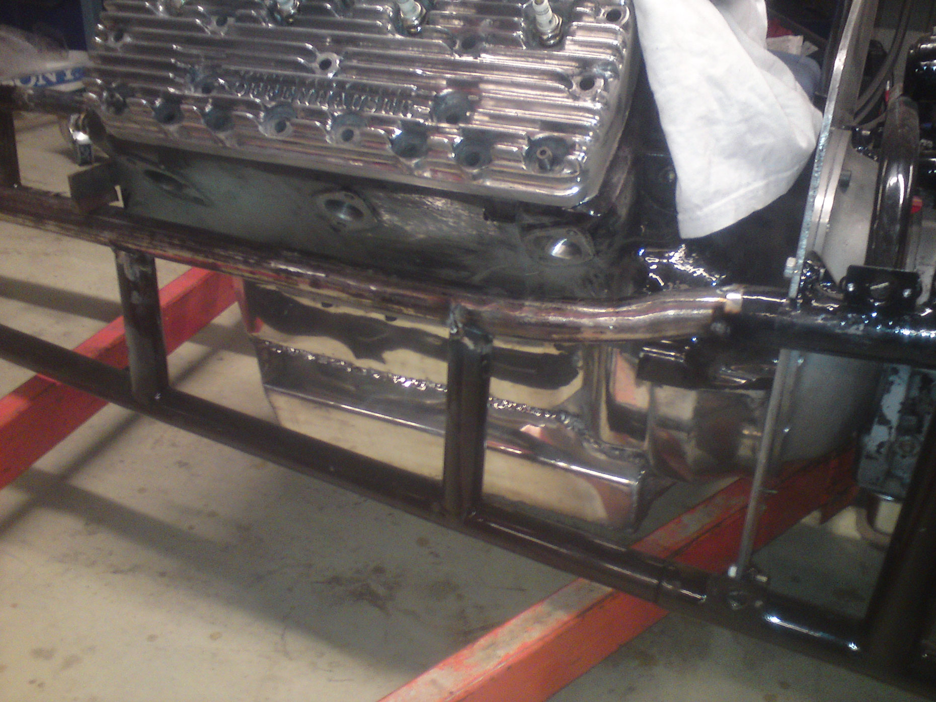

  19. fenderless
    Posts: 1,286
    fenderless
    from Norway
    Thanks Carl:)

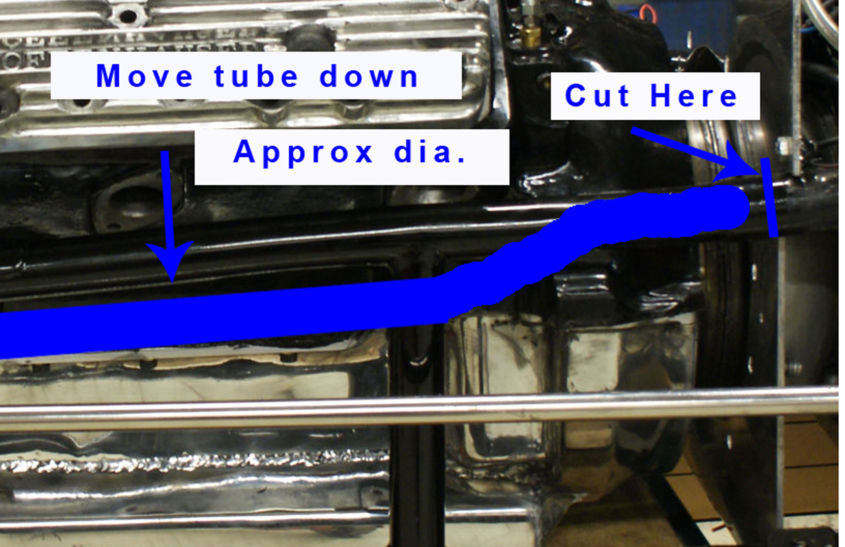

    The ports point more or less staight toward the upper frame tube.
    So no other option than cut&weld:eek:!
    A fast illustration on how i think we will do it:)!
    Br
    Kjell

  21. Hey Kjell - Happy New Year to Yah!
    Whups - looks like it is time to cut and splice. :rolleyes: Is this a mild steel or a chrome moly frame? If it is CM, make sure whomever welds it is an accomplished TIG welder and understands how to do the job.
    I'm probably telling you things you already know, but if it is CM tubing, here is a cool little link:
    http://www.weldingtipsandtricks.com/welding-4130.html
    I don't think it will be a big deal to "fix it" - just some tubing bend work and some good welding techniques . . . nothing you guys haven't probably tackled before.
    I'm looking forward to seeing this thing fire!
  22. roseville carl
    Joined: Dec 29, 2008
    Posts: 5,218
    roseville carl
    Don't forget to sleeve your splices
  23. Good point - you can't just **** weld them! Having some rosette welds past the joint would make sense to me - do you do this as well?

  25. fenderless
    Posts: 1,286
    fenderless
    from Norway

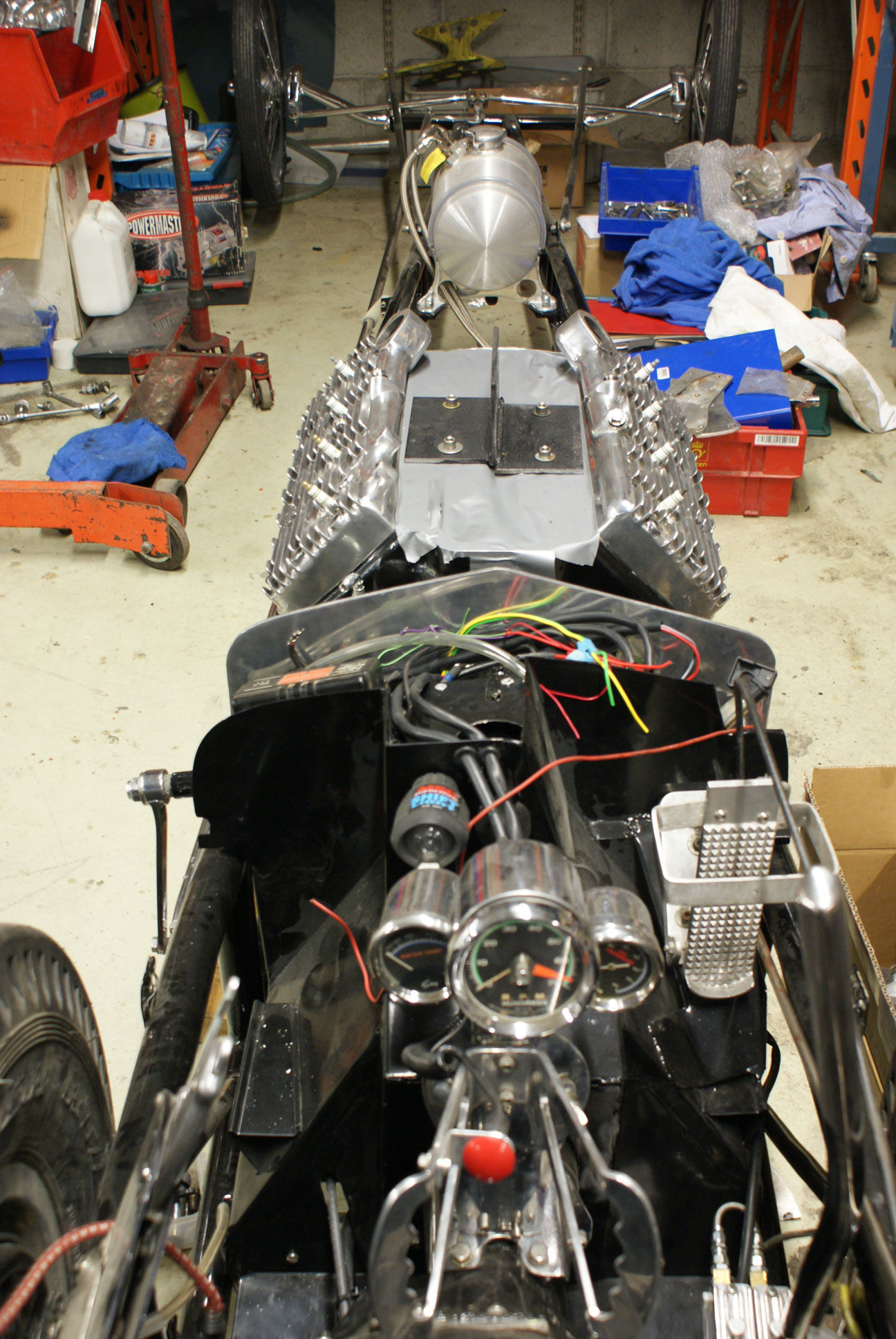

    A really good day, lots of thrashin:)
    Me and Grinder1 managed to fit and change the new tubes:)
    Just some minor adjustment, then TIG finish.
    Also have to take it one more round in the welding both, so we can tack the exhaust tubes on the new flange.
    Br
    Kjell
