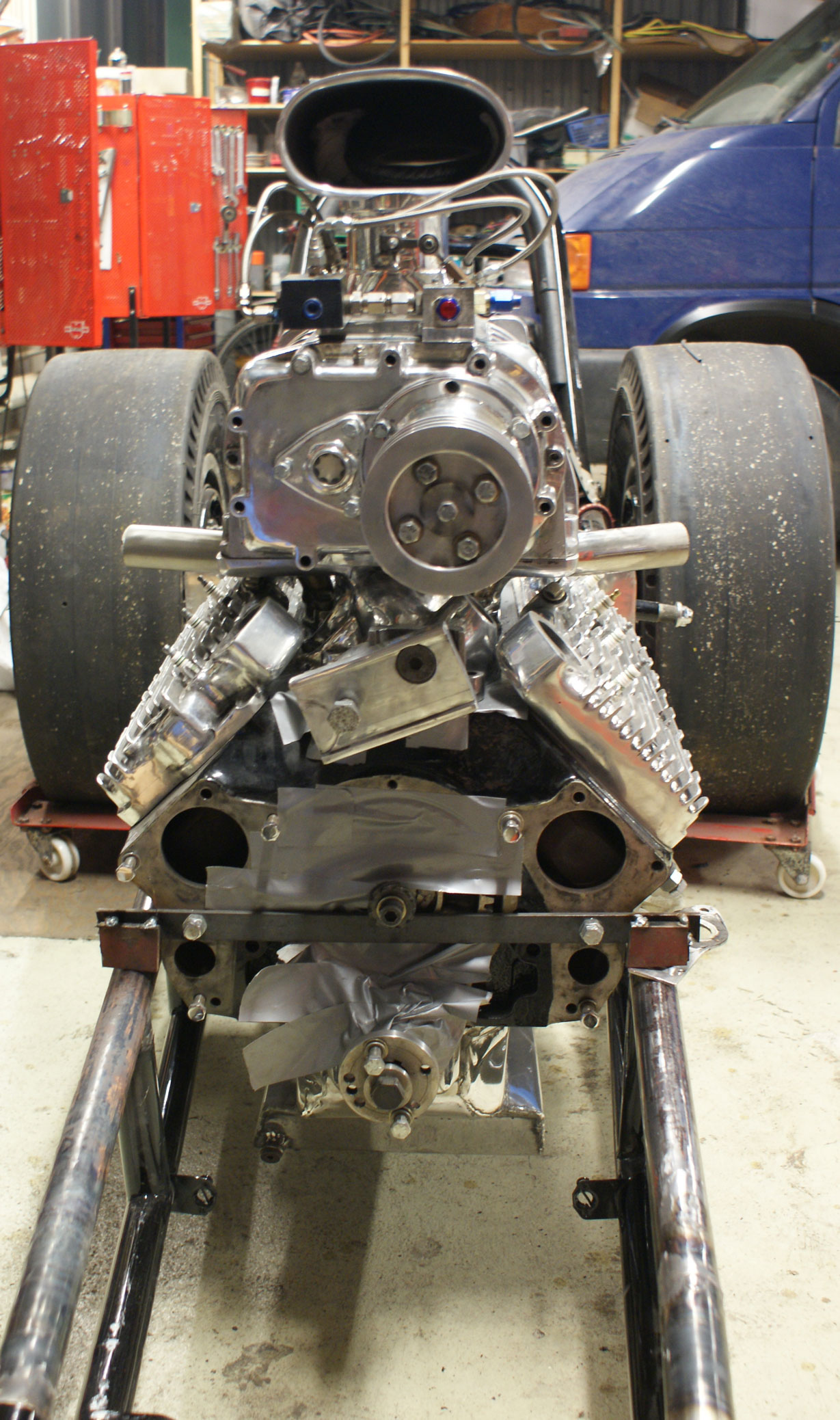

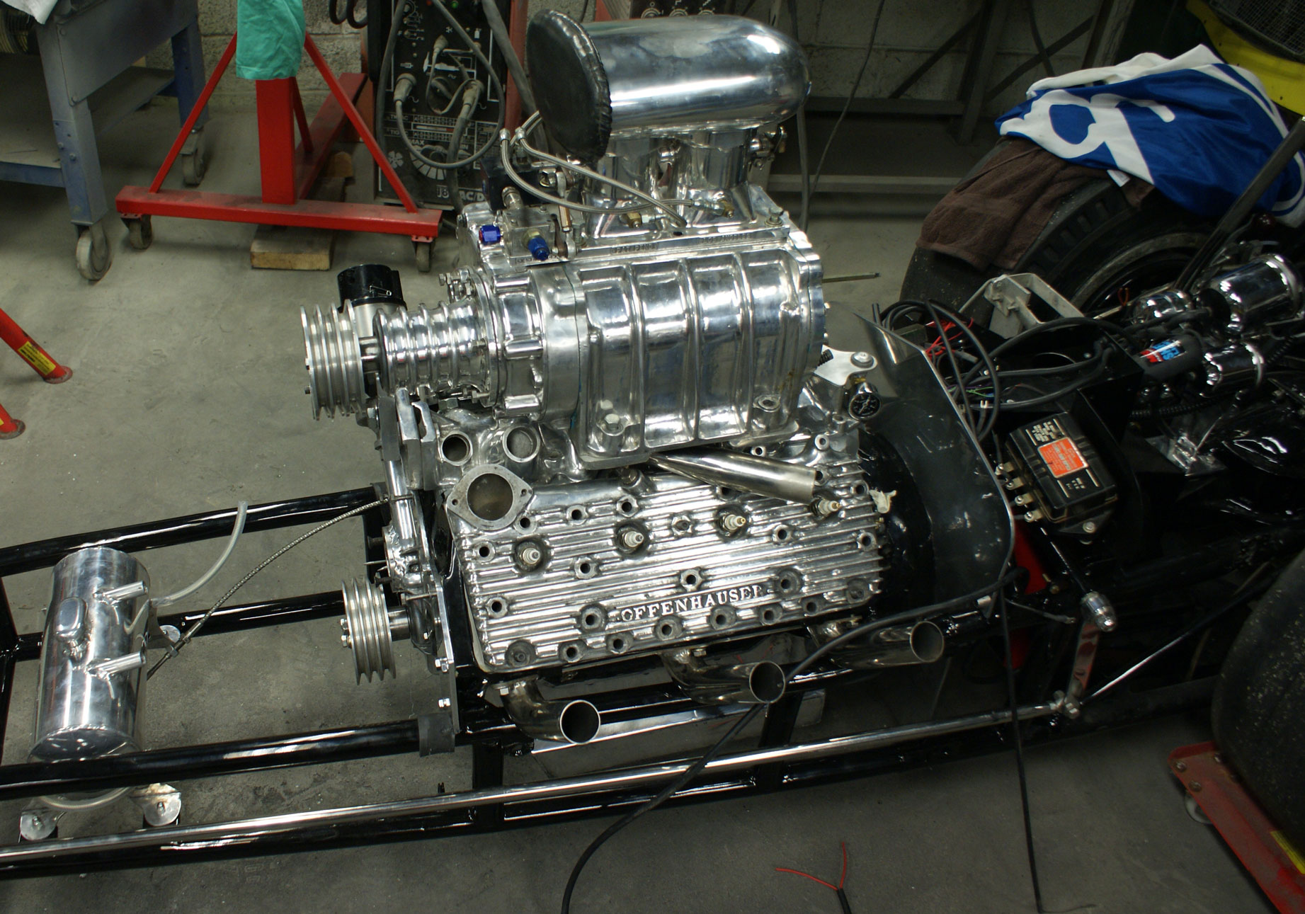

    Here are some pictures taken yesterday.
    Br
    Kjell
    Taildragger&fenderless
  2. 38FLATTIE
    Joined: Oct 26, 2008
    Posts: 4,349
    38FLATTIE
    from Colorado
    Damn that's pretty!
      27.4 KB
      130
  3. dragsled
    Joined: May 12, 2011
    Posts: 1,975
    dragsled
    from Panama IA
    Car is looking Great Kjell , Can't wait to hear it run also Tim Jones

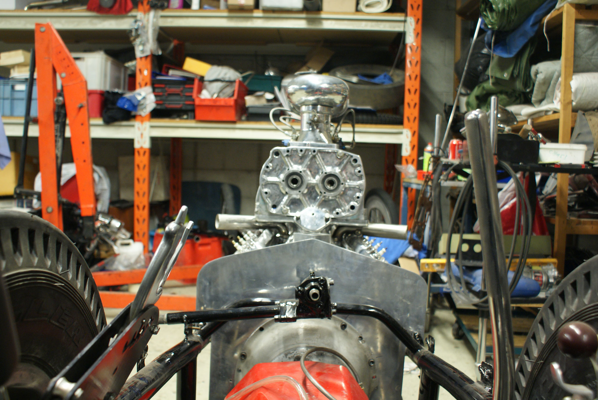

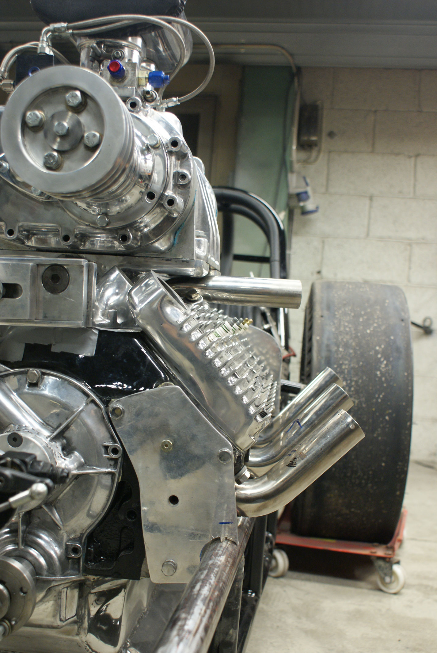

    Allthough things are slow, i have managed to get some done in a couple of days:) Have finally tacked the exhaust pipes in place, i hope. Was timeconsuming as he..ll, i have just two hands:eek::D!
    Also made a new fuel shut-off bracket, thinks it looks better than the old one in the ch***is.

  7. fenderless

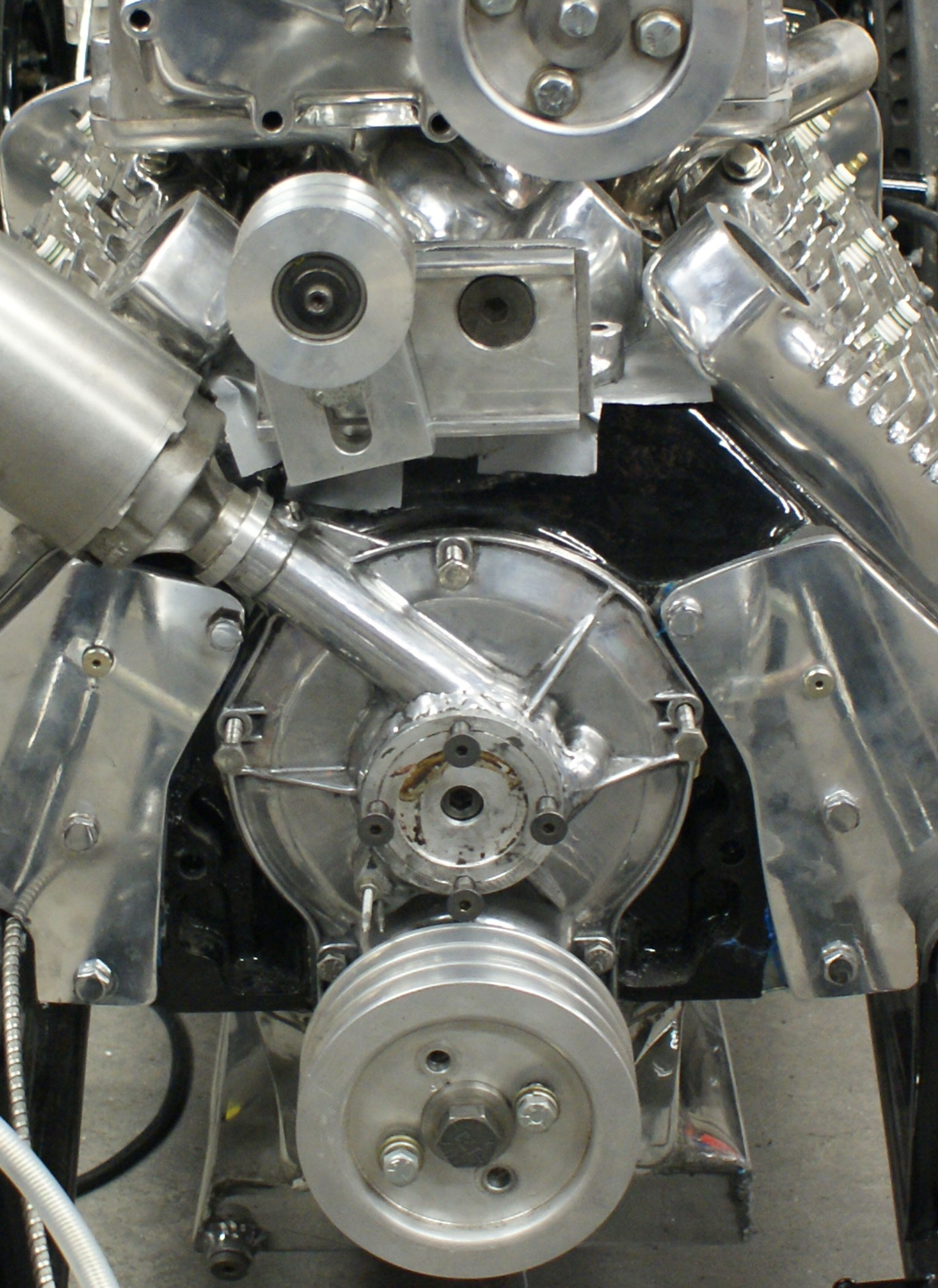

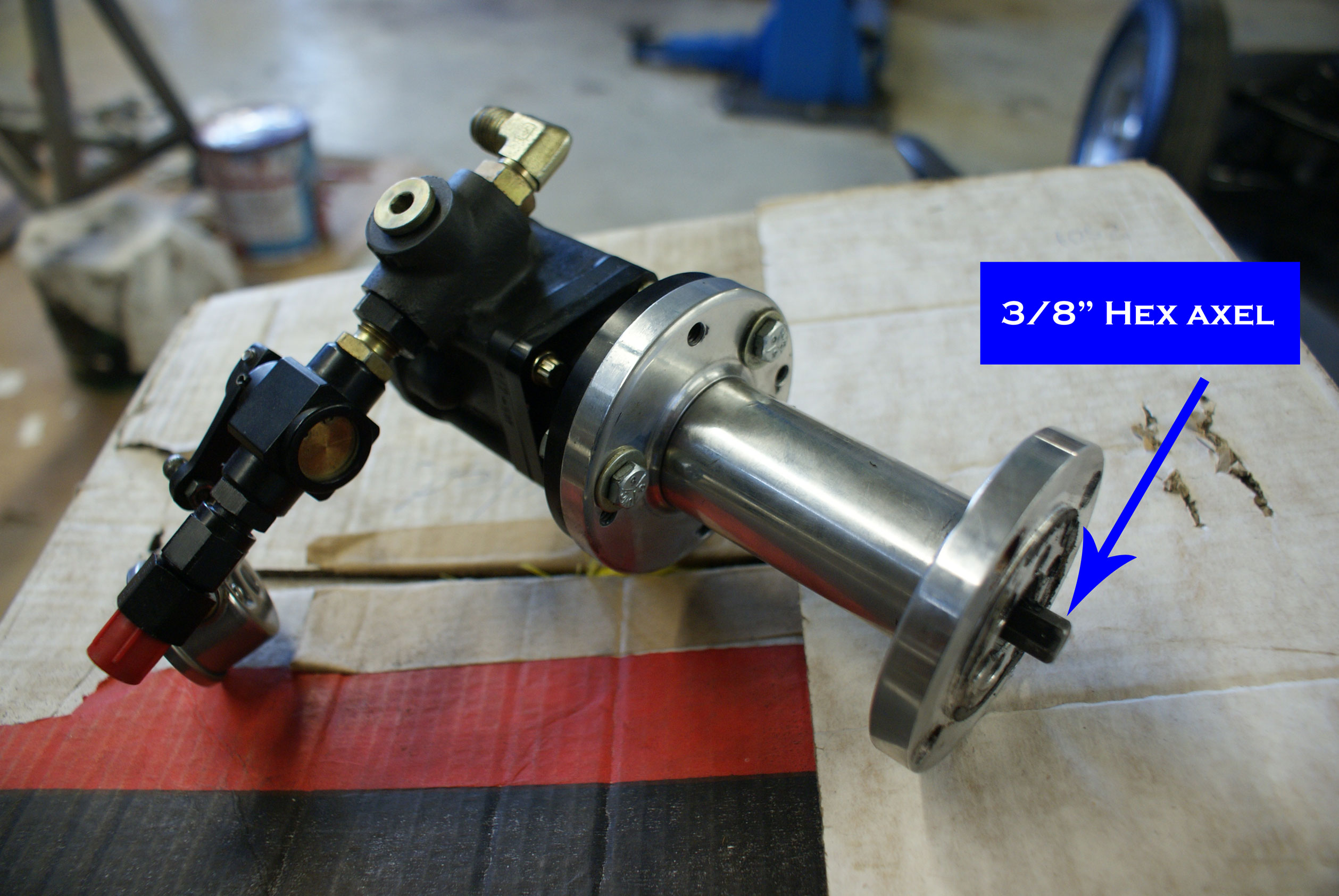

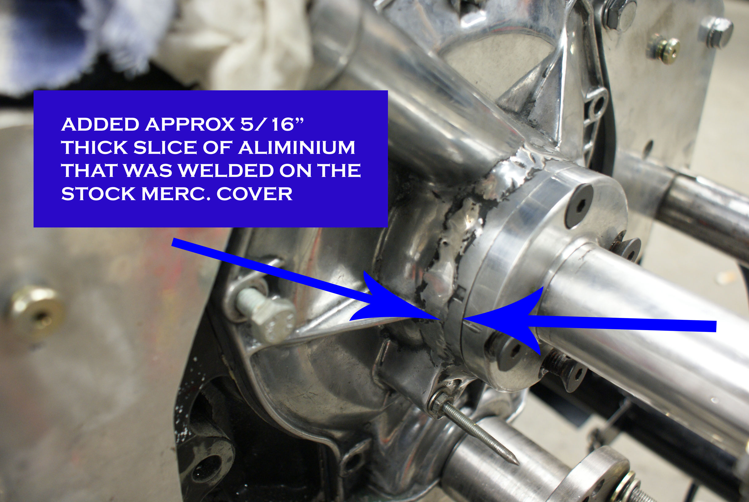

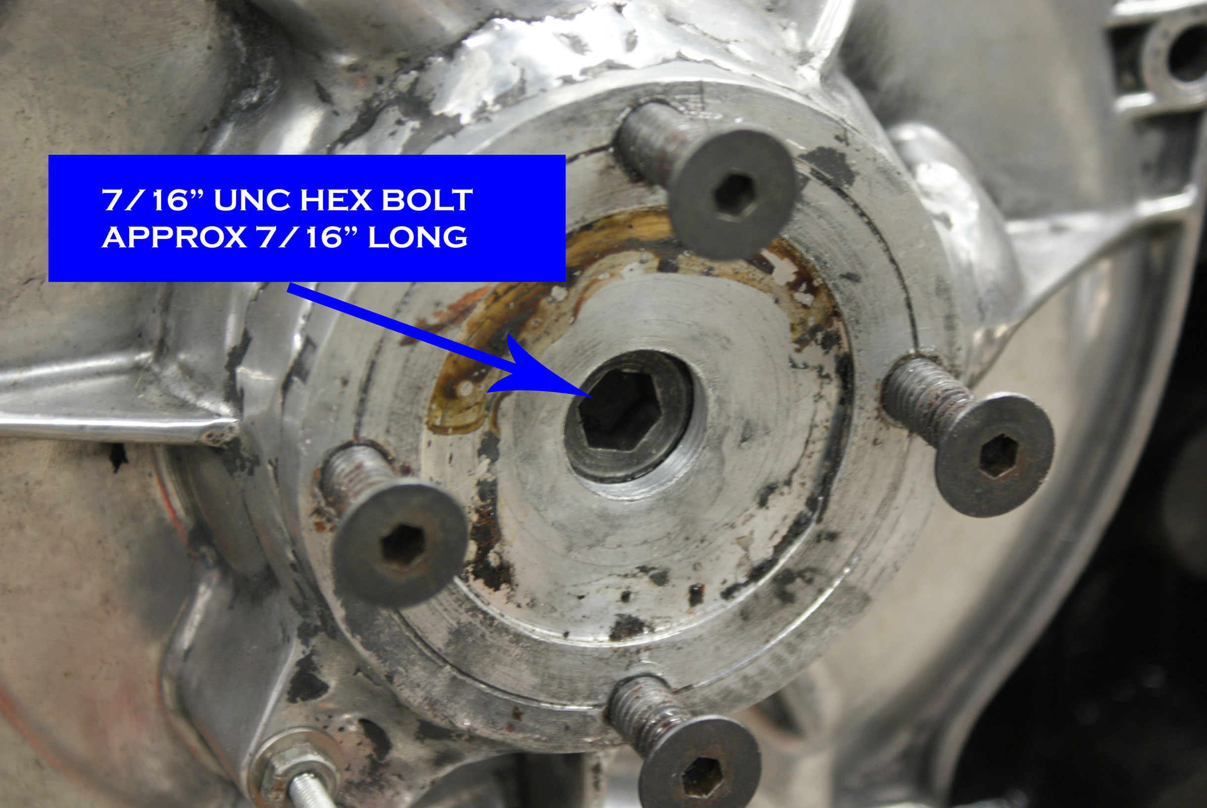

    Nice Work Kejll , did you do the front timimg cover work to adapt the fuel pump? if so do you have details on doing it Thanks Tim Jones Cool video
  9. fenderless
    Joined: Mar 31, 2006
    Posts: 1,286
    fenderless
    from Norway
    Thanks Tim:)

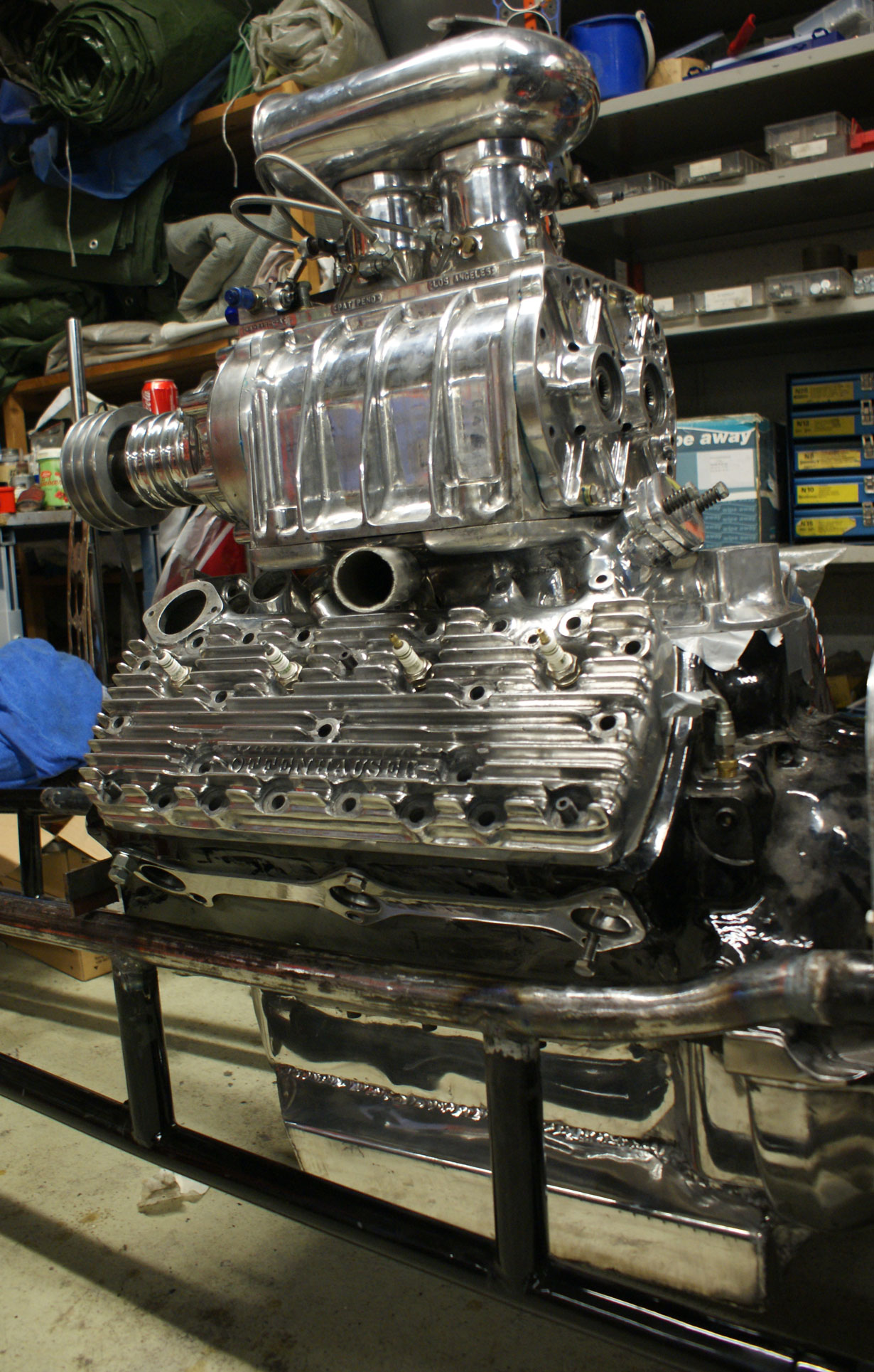

    Here are some illustrations, if they make any sense.
    I would have used the French timing cover, as they have a more even
    front face, where you need to add some material.
    I threaded the short 7/16" Hex bolt on the nose of the 8BA style cam.
    If you have a 59A style cam, you can order a new nose with a 3/8" hex end to match the fuel pump axel. I think Tony Baron and Flathead Jack has it.

  10. 38FLATTIE
    Posts: 4,349
    38FLATTIE
    from Colorado
    Makes perfect sense, and looks great!

    Great Pics Kjell makes sense to me also Thanks for the info ,Tell Grinder1 Thanks also Tim Jones

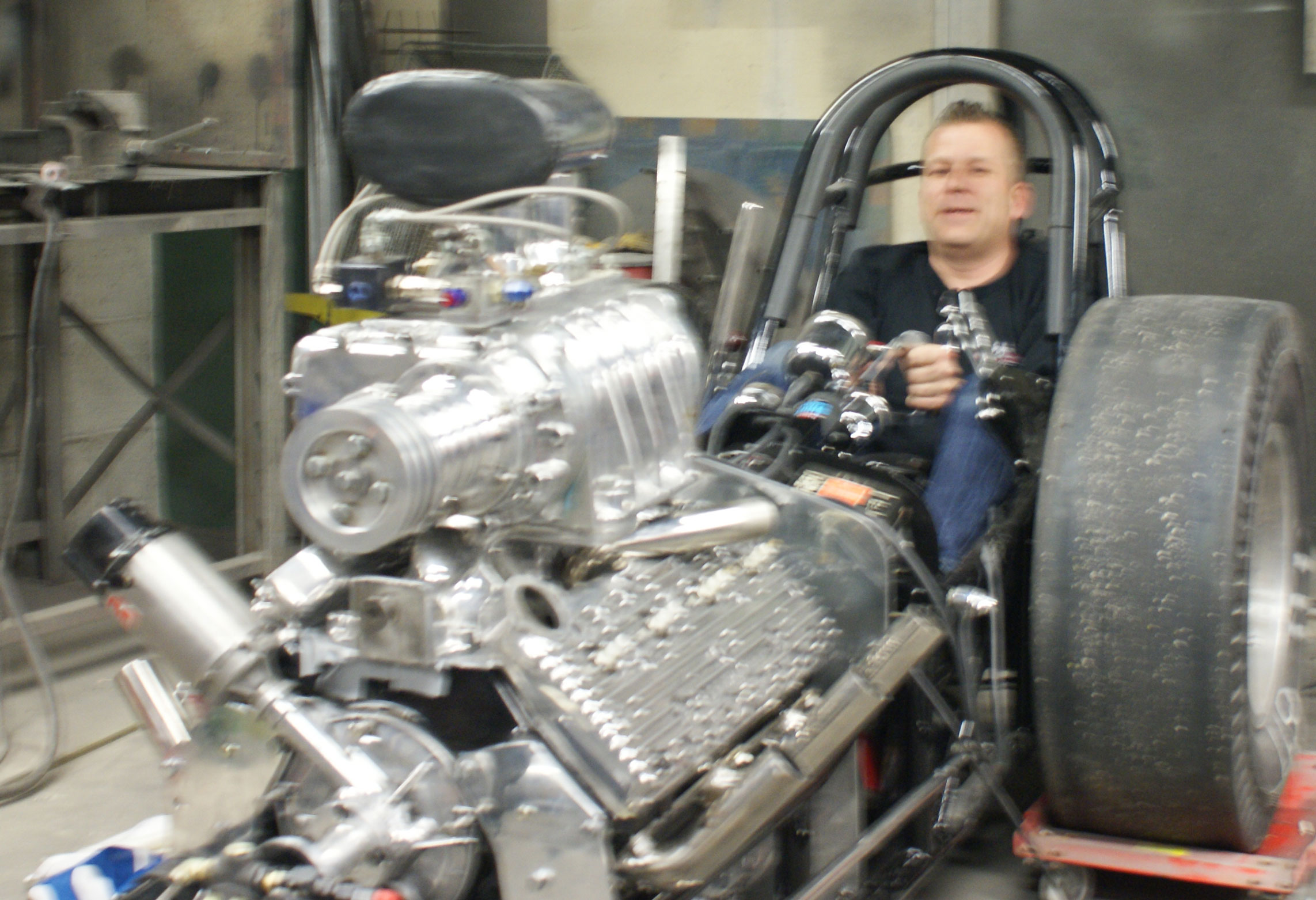

    afaulk
    So Dude, who is the guy with the top knot and the cheesy grin, sitting in your car LOL. Ya got it looking good!

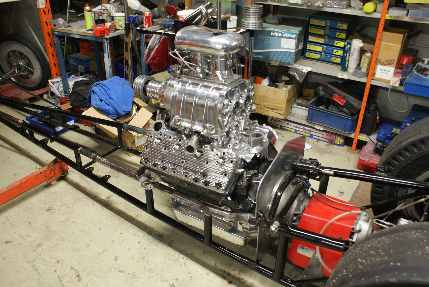

    Back from yet another evening in the garage.
    As I'm going to deliver the intake to Grinder1 tomorrow for the final

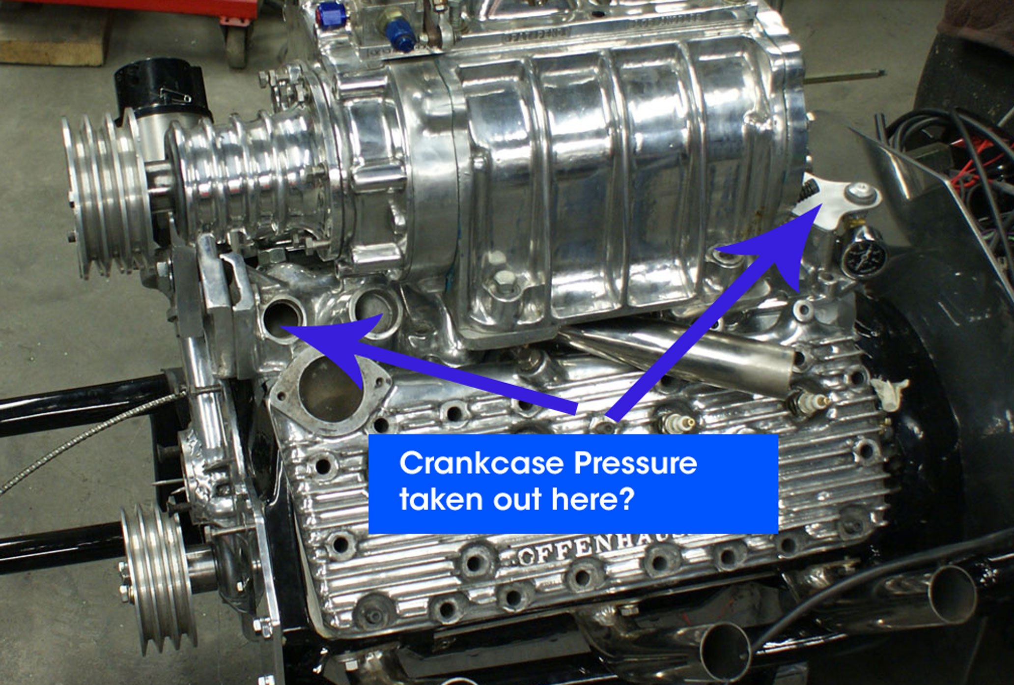

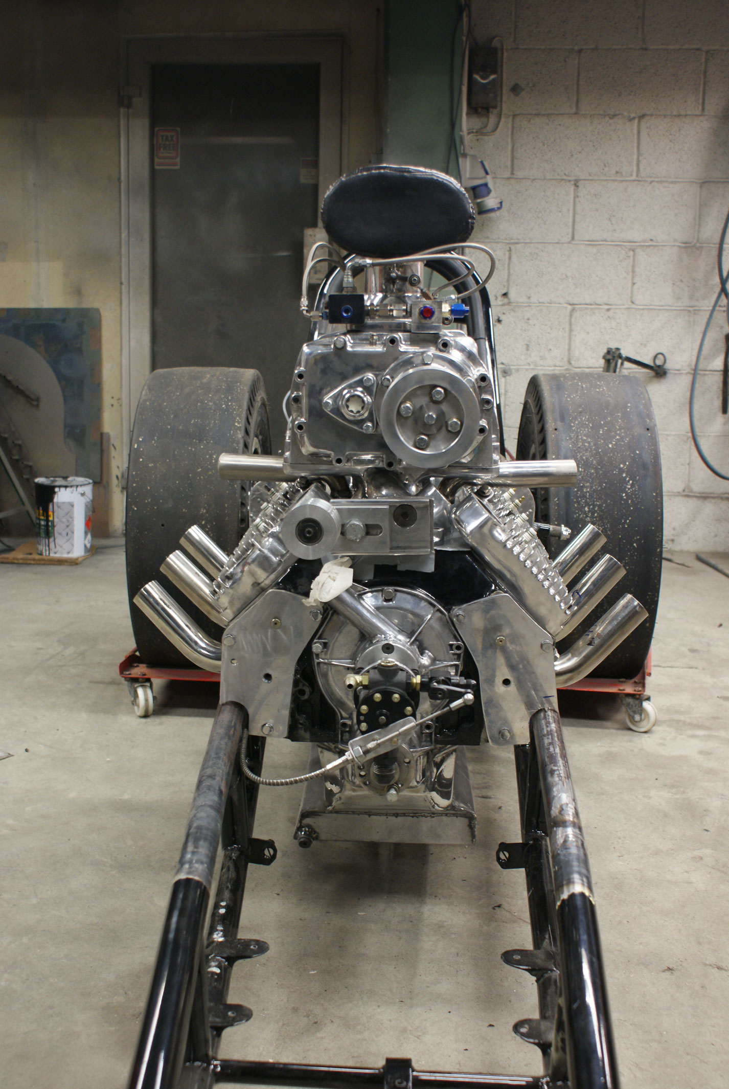

    fittings, I have a question for you guys;
    Do you think I will let enough crank case pressure relived by taken it out both in the front and back of the intake?
    Br
    Kjell
  24. roseville carl
    Joined: Dec 29, 2008
    Posts: 5,218
    roseville carl
    If thats an 8BA block Kjell use the front if you have the tube that connects to the manifold that way you will be taking the negative pressure from the crankcase and not the valley that will put a negative pressure on the lower side of the rings............
    ps.........looks *****in!!!!!!!!!!!!!
    psps....did you guys make the front snout for the blower....... looks great
  25. fenderless
    Posts: 1,286
    fenderless
    from Norway
    Carl, the French block does not have the tube up front, actually it's a tube from the fuelpump/oilfiller in the back of the intake.
    I think I can fit a tube up front, and that might be enough for wenting the fumes and pressure. We wil also consider a wentilation fitting on the crankcase, just to be shure.
    The blower are all homemade, Grinder1 style:)! I'm don't like the CNC moder style that much, and Roger came up with this:)!

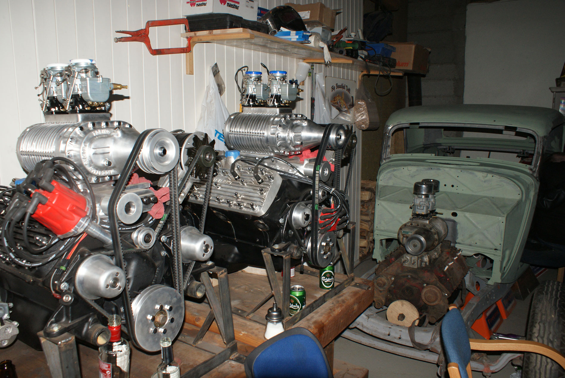

    I met up with Roger at Throwhill Easter party last nigt, to deliver the intake and blower.
    My jaws dropped to my knees, and i started drooling when i saw this....:eek:!
  26. Those look like H&H SCoT blower setups - am I correct?
  27. fenderless
    Posts: 1,286
    fenderless
    from Norway
    Spot on Dale:) The garage owner has the 59-style in the middle for the 34 Ford in the background. His friend has the one on the left for a Modell A cupe. They looks good:)!
    Br
    Kjell
