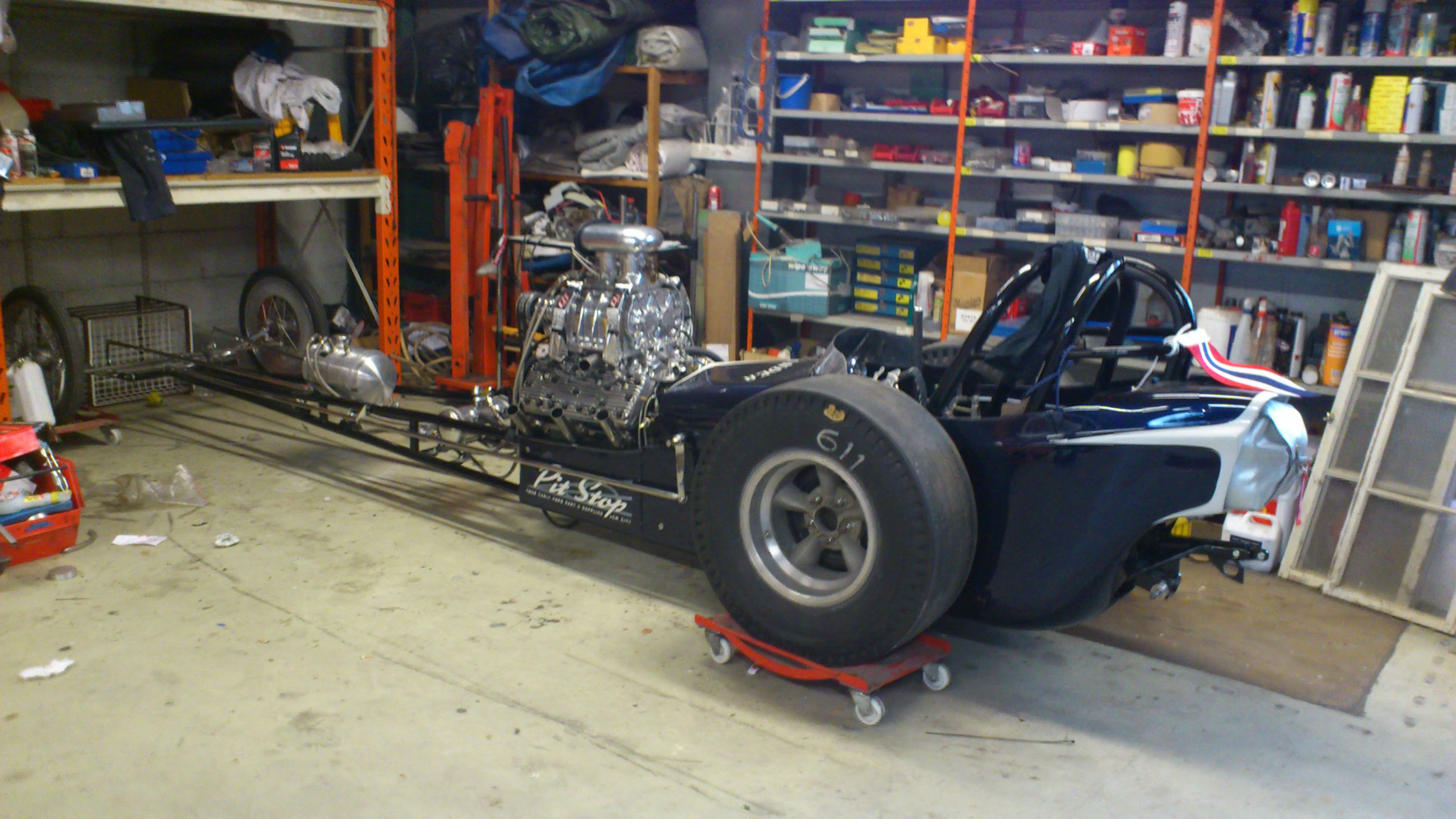

    Dale, I was lucky to get the blue band from a store yesterday, it's actually a cargo strap:) Finnish guys are crazy:D! allways doing extreme things!

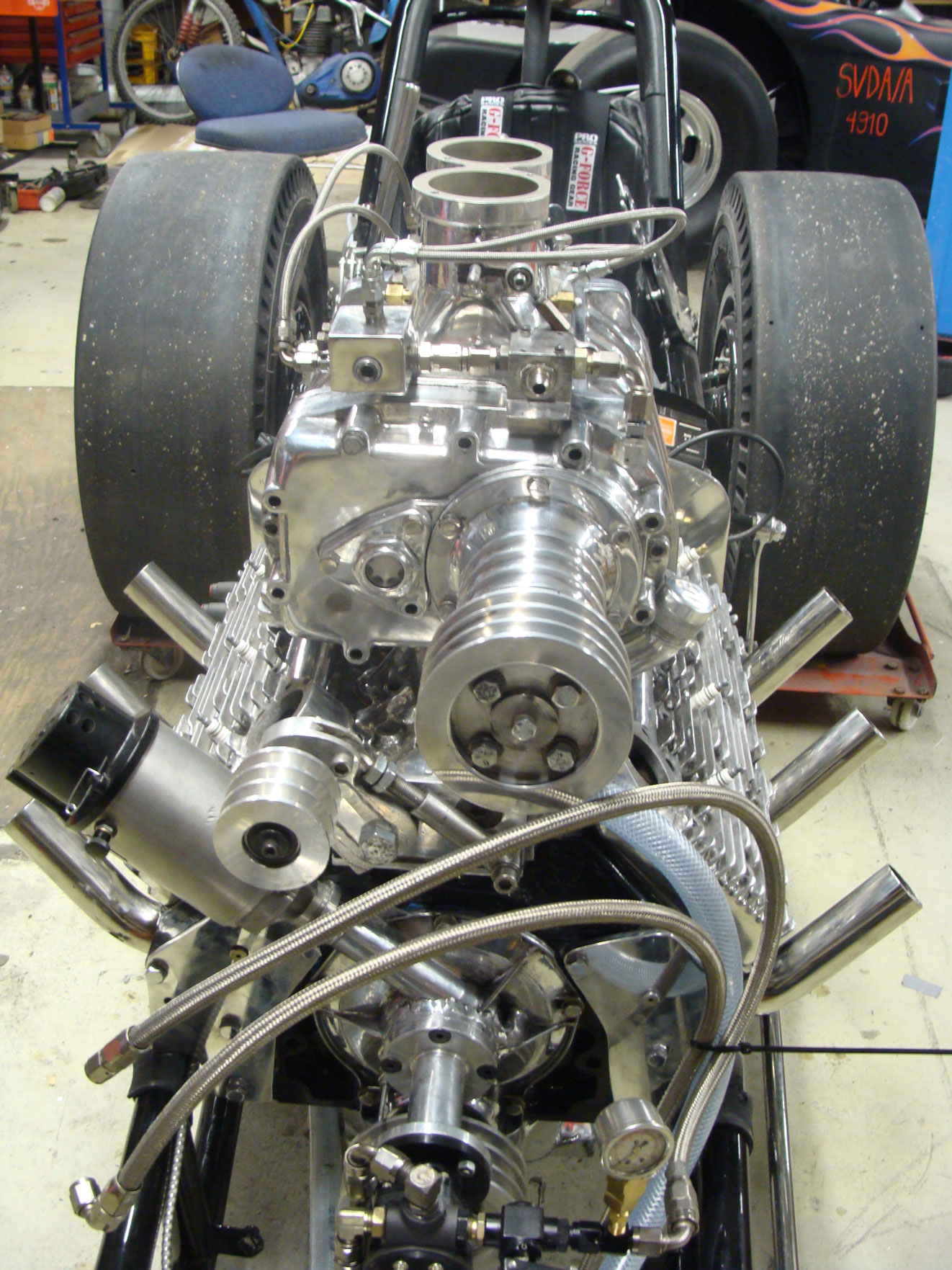

    We are close and closer to the fire-upper:D!

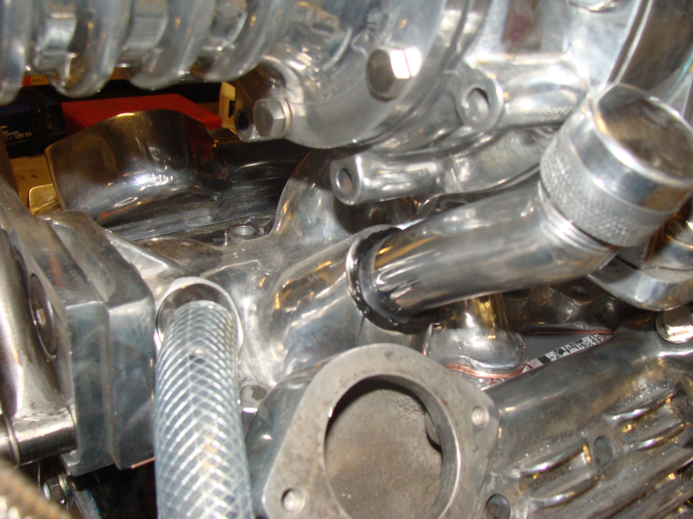

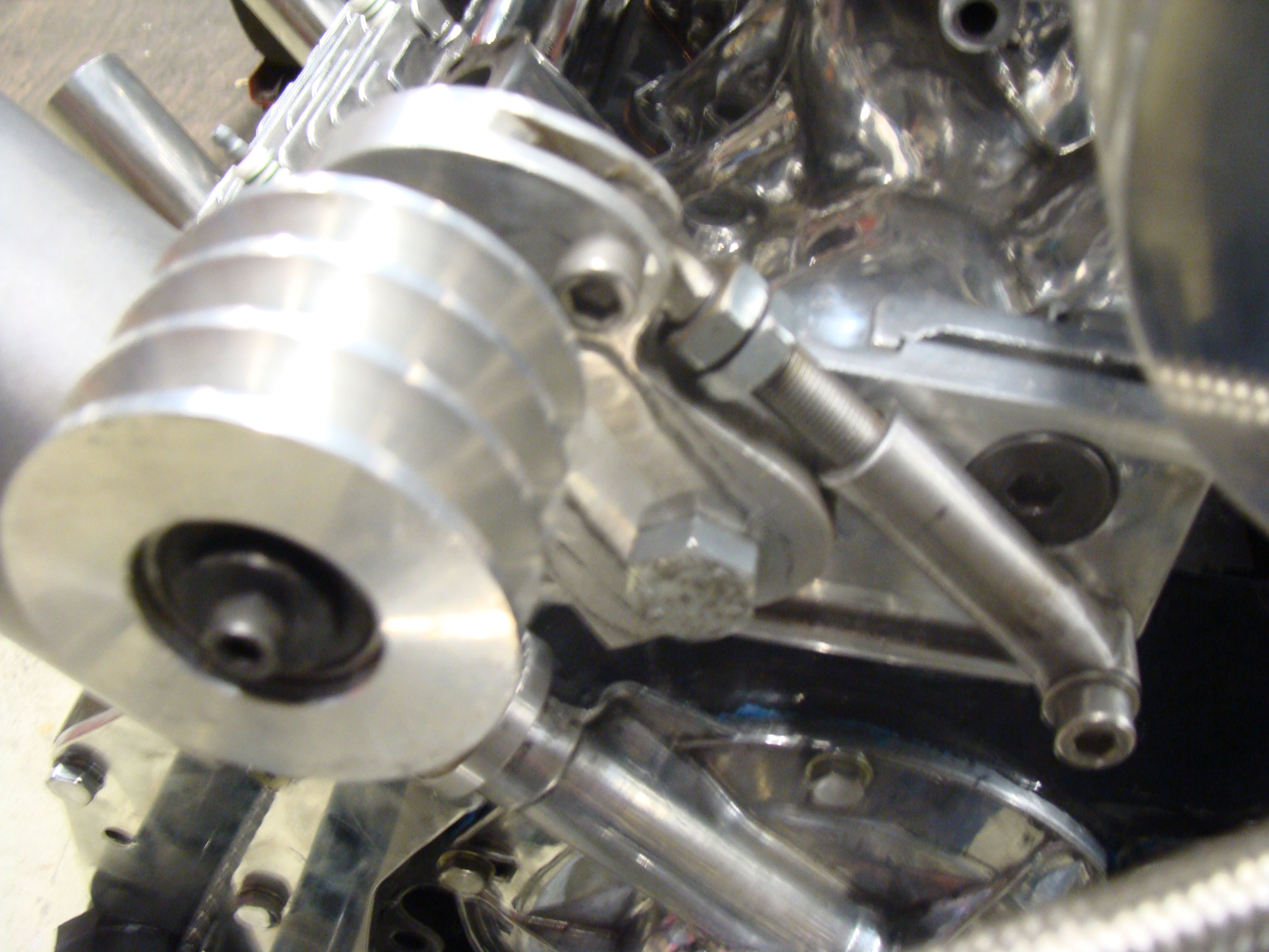

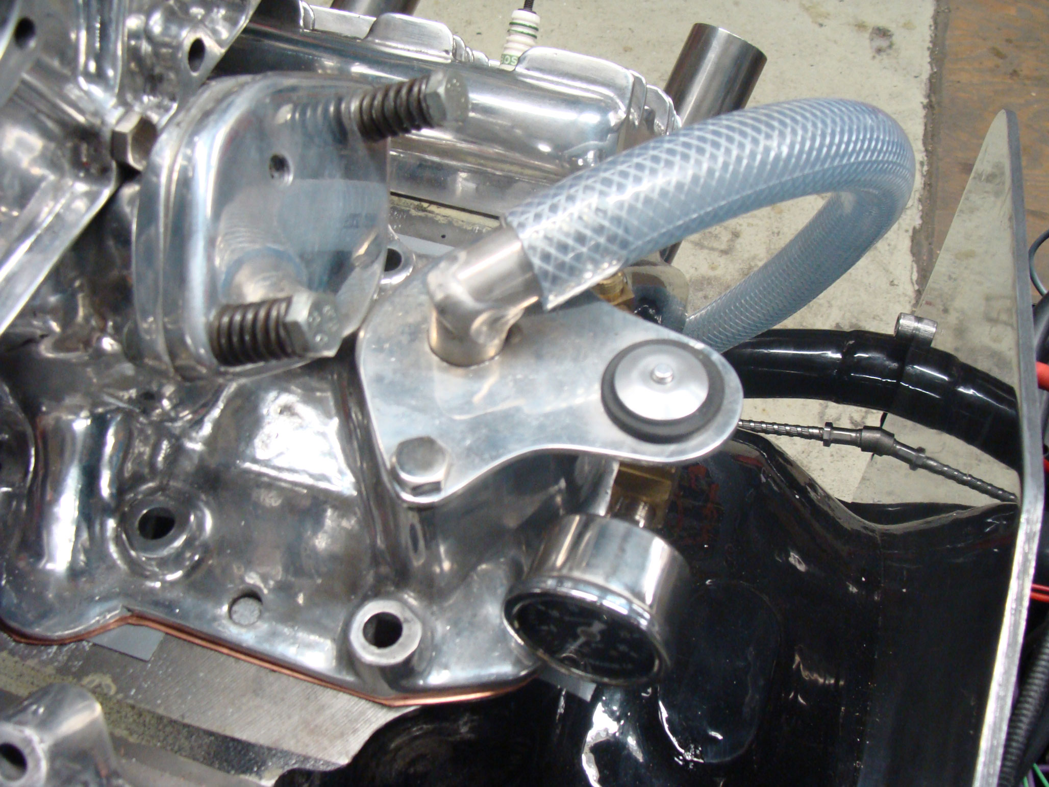

    The last small stuff really takes alot of time, and we seem to find new stuff that needs to be changed all the time. Today we found out that the Big pully hit the fuelpump-extention, so we need to fix it before final mounting.
    Roger has really done alot of work, making a new oil filler-tube, oil breather adaptors, front and rear. And a new tentioner, all very slik:)
    Me! more finish work on details, plubing, electric wires.....

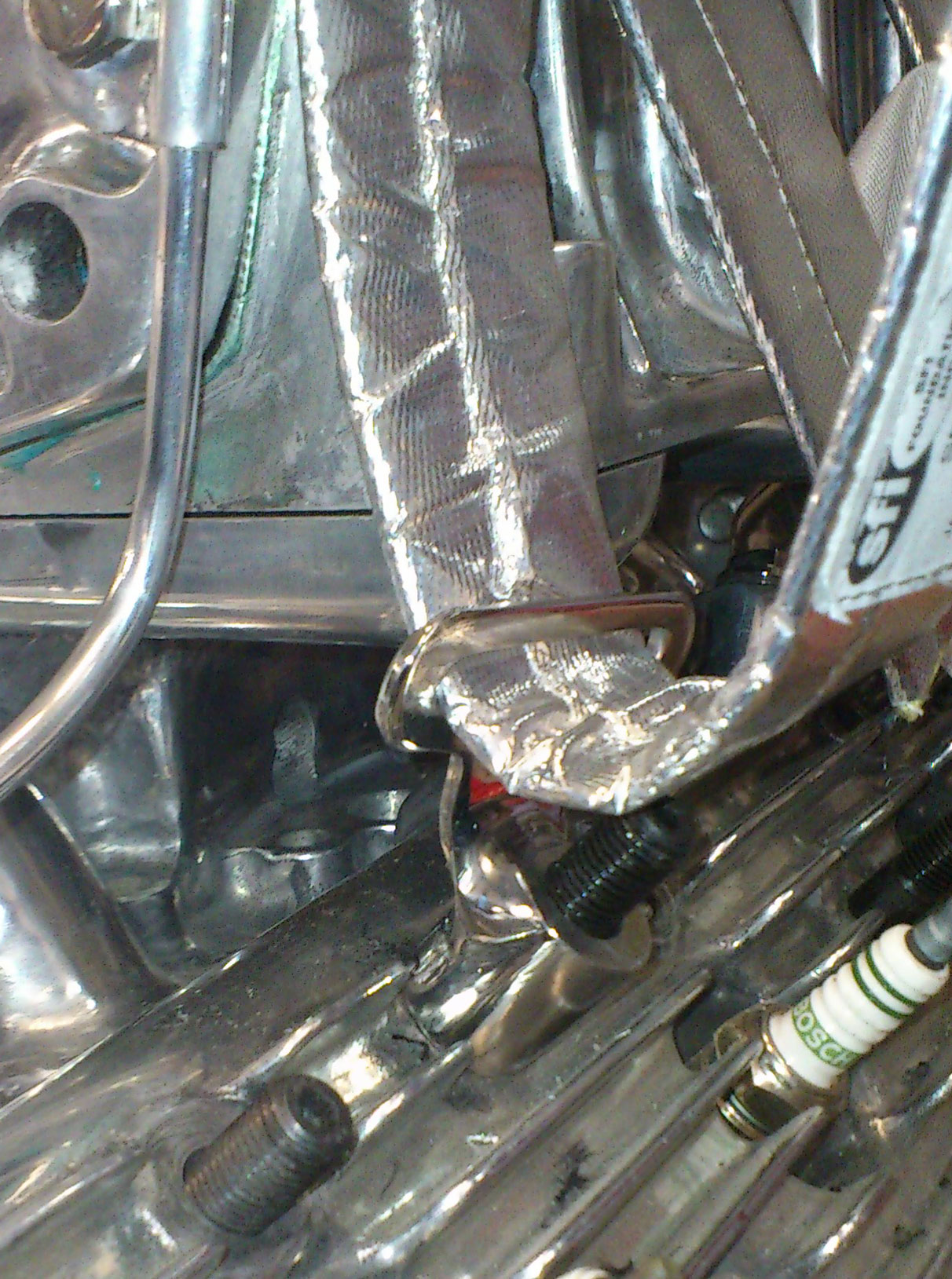

    And the big news, is that we got the rail approved to go some serious racing:D! We just need to make the new blower restrains mounted and a shield over the blower-belts. Roger is on the case:D!

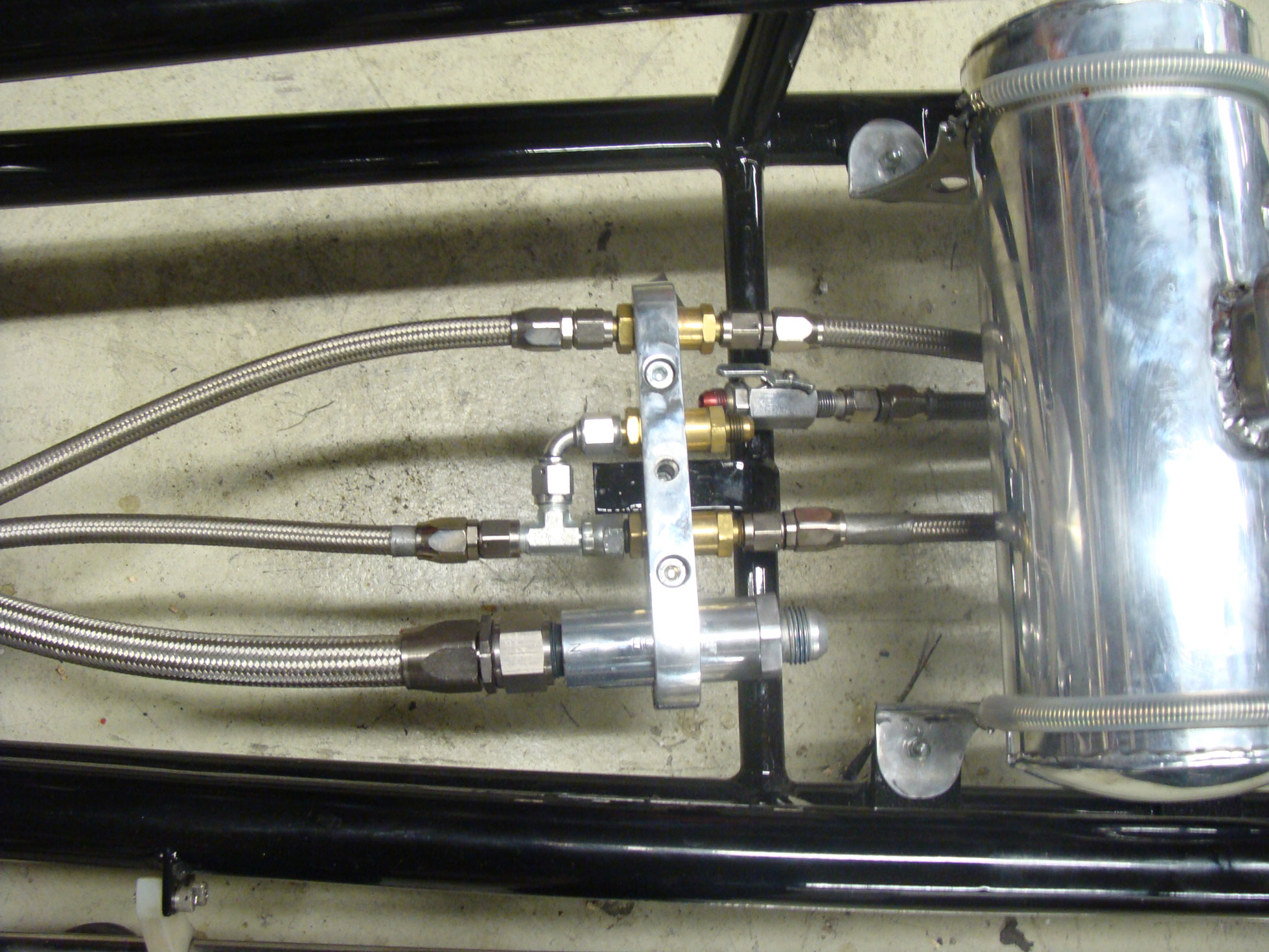

    Now both electricals and plumbing is done!

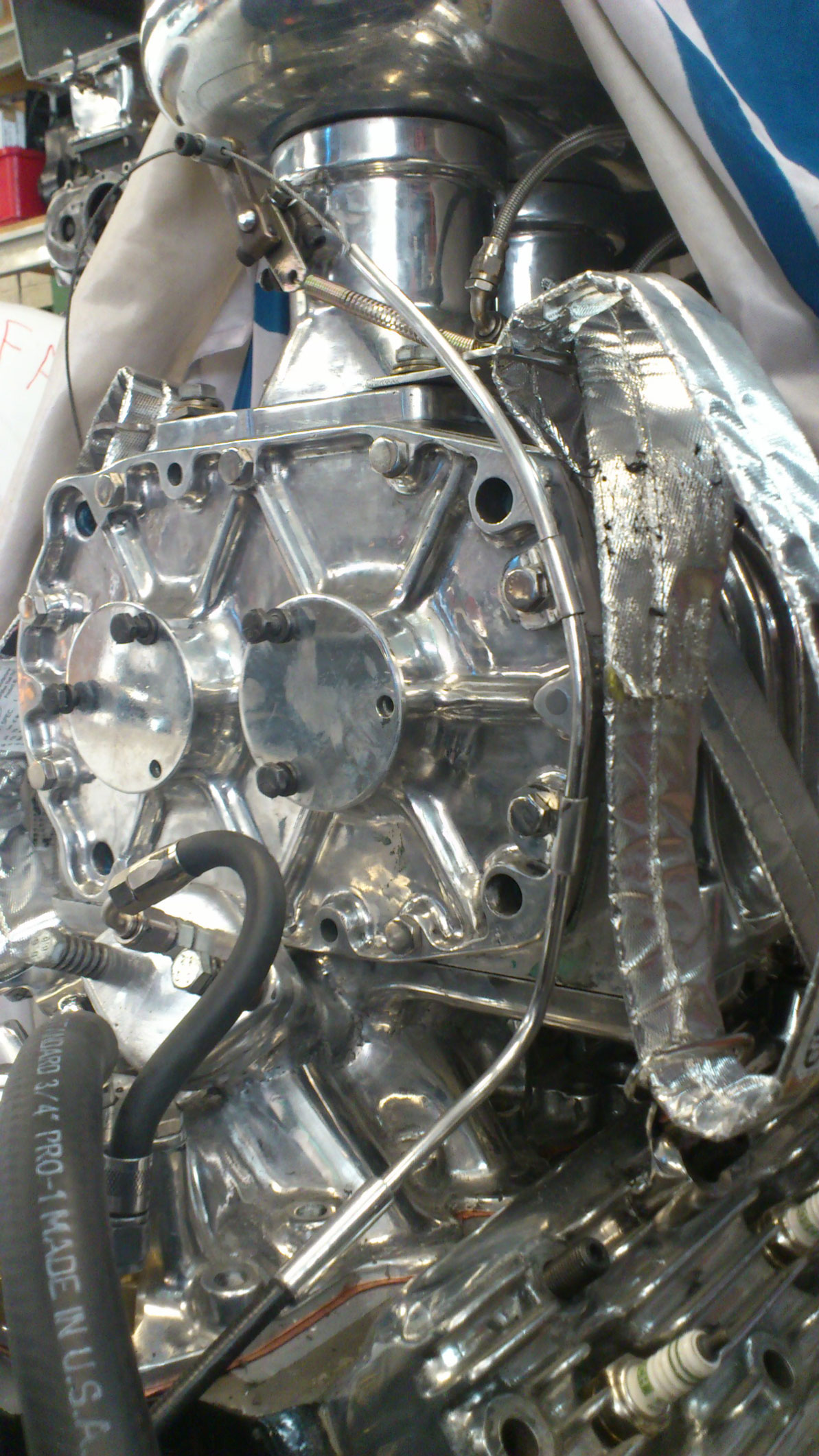

    Roger made some nice blower restrain brackets. We just need to stich the restrains back.
    Also came up with an idea to solve the gaspedal linkage/wire!?
    I think it looks ok, better than plain black wire all the way, i think!?

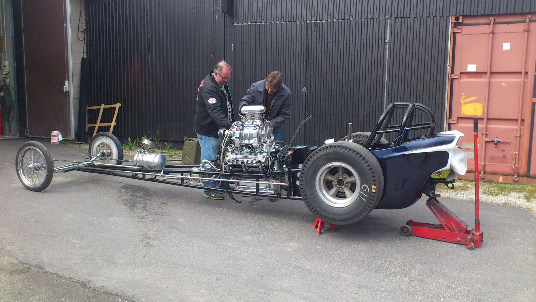

    Finally:):):)
    We fired up the killer today:) two years of waiting really paid off after sorting some issues out.
    Sorry noe video guys:( Put a brand new videocamera on charging yesterday, but when i woke up to go to the garage, some had pulled the plug. Ater some detective work, we have come to the conclution that the big Cat had messed with the cables!:confused:.
    But I will post some videos from the track next weekend:D!
    We had some issues with the set-up, as the engine ran too fat.
    We leanded it out, and Roger made some andjustments, and THEN
    IT CAME TO LIFE:D:D! Really soundes wicked, never heard a Flathead sound like this:eek:!
    I'll keep you posted on the progress:)!

    Last minute fix was a leak from the blower, we had to take appart completely:eek:! Now it seems OK.
