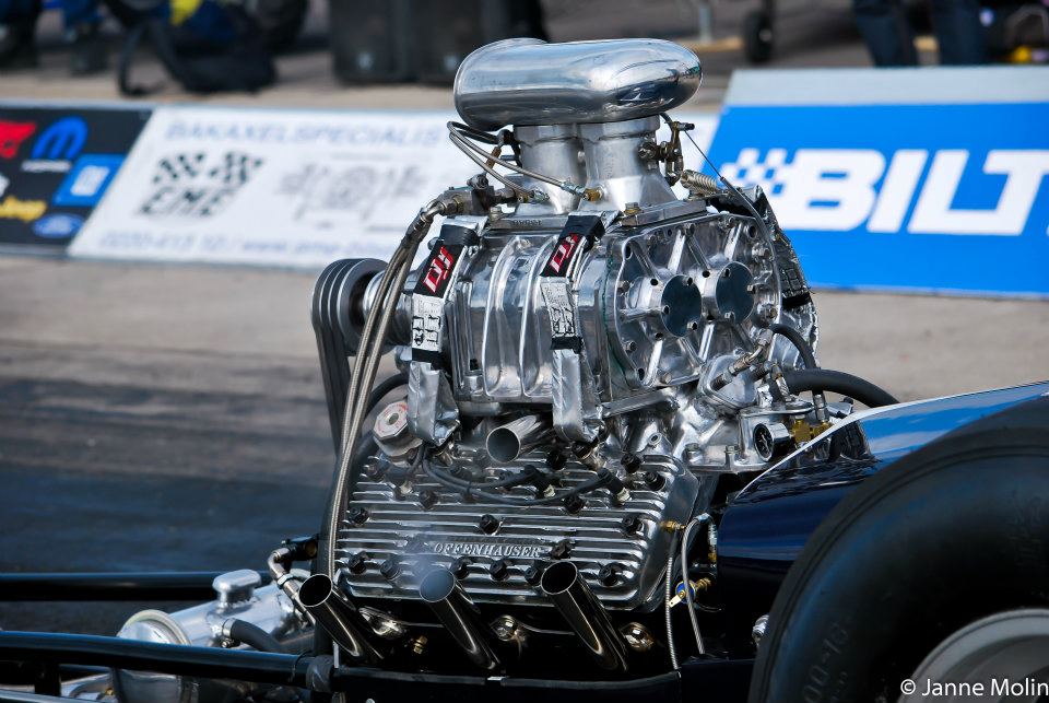

    Talked to Roger today, and we desided to make a new spool for the barrel valve. Hope this will do the trick:)!?
    Next is to book Dyno/roller to try to tune it for max HP.
    The last thing we did was to give the killer some more air, we put on the BIG wheel on the crank:D!
    Br
    Kjell
    Sidewinder...........

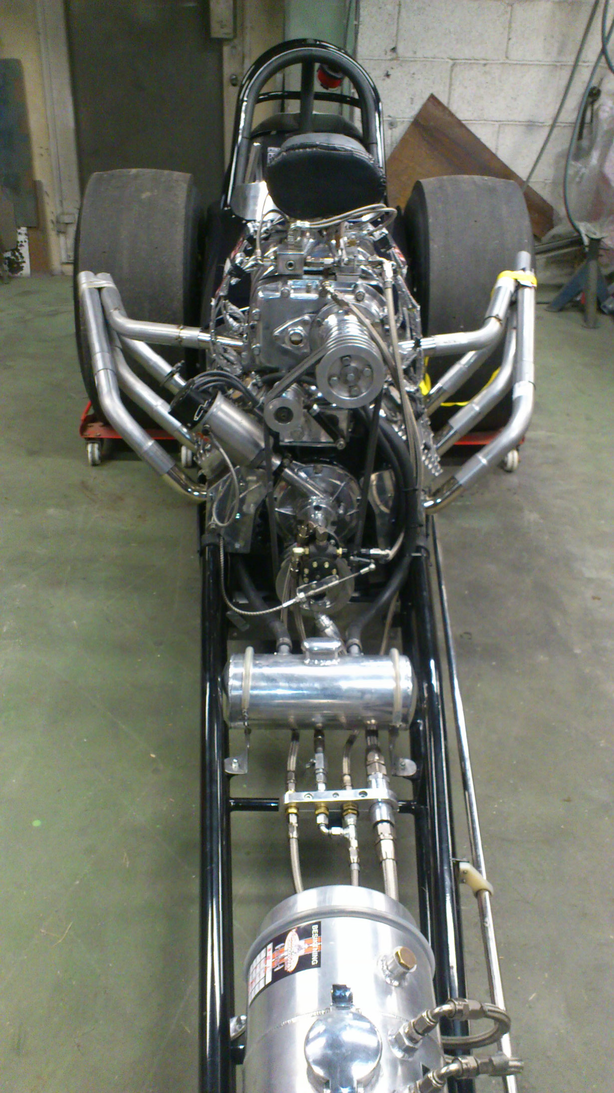

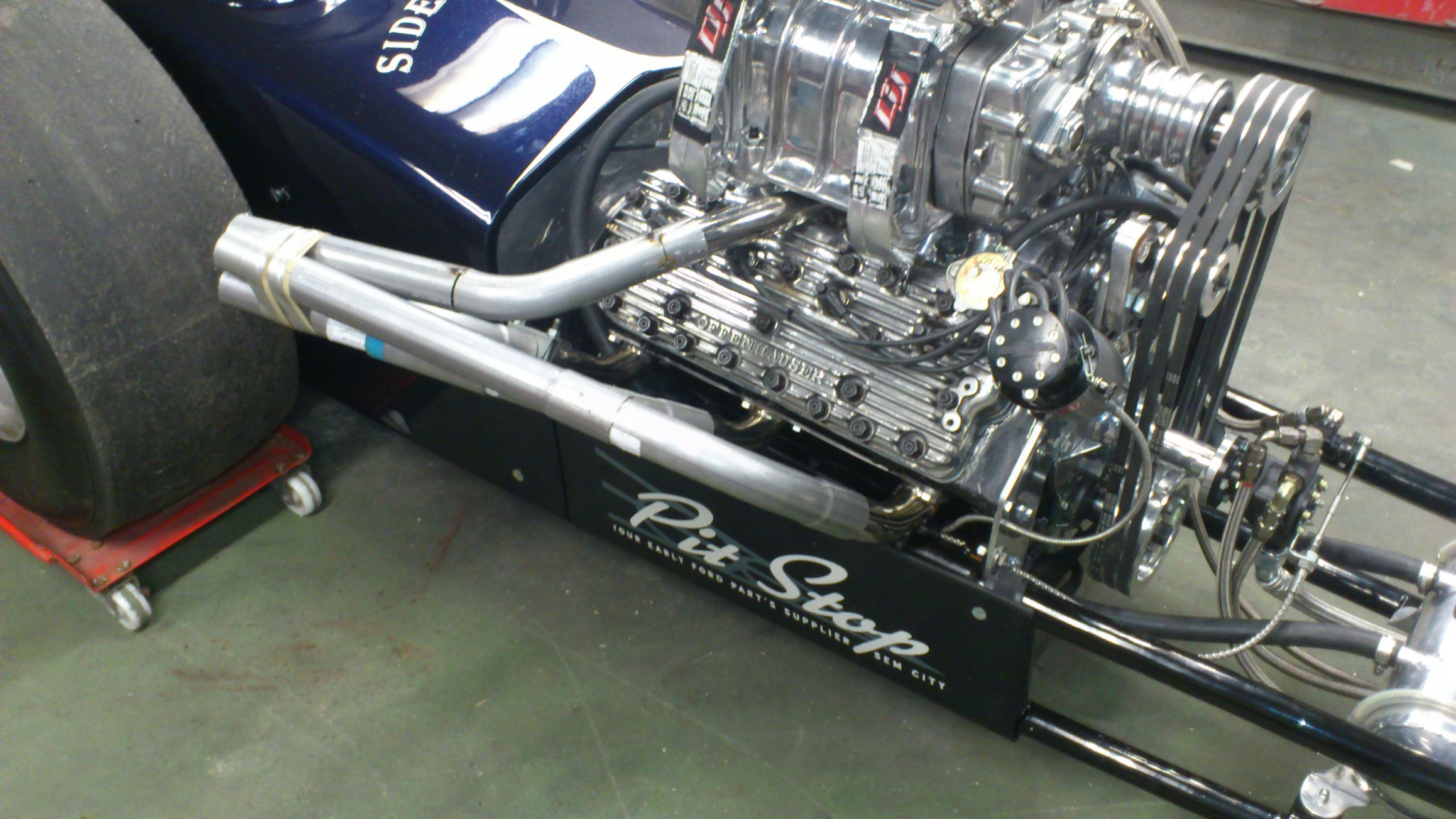

    Finally got everything back together, we had the engine out to fix the flexplate.
    We changed the bolts with new that does not have threads all the way up, and more lock***e. hope it will not come loose again:eek:!
    As we had the engine out, we checked the bearings, and everything looked OK:)! Now it's just to load her up and try out our luck next race:)
