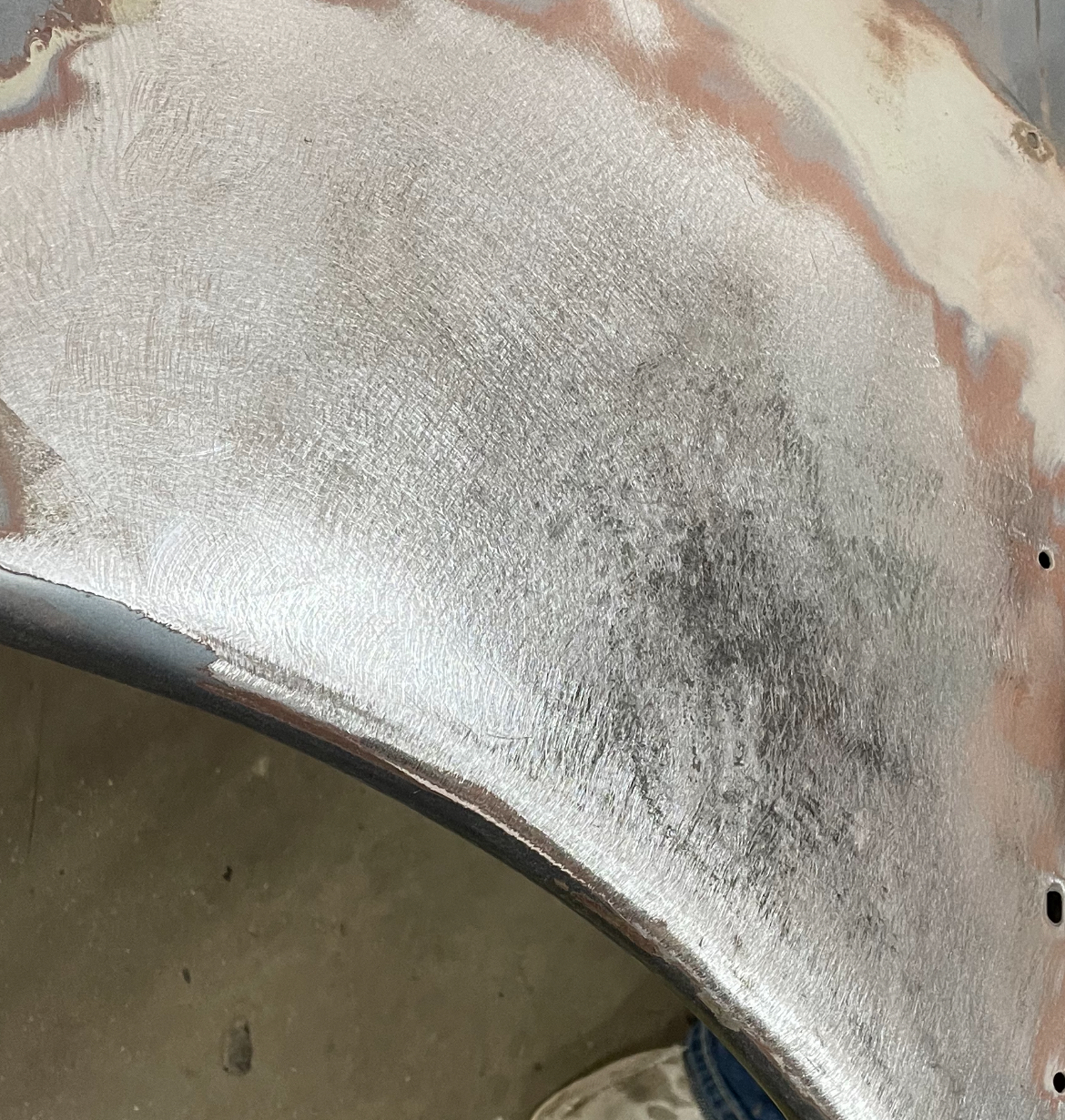

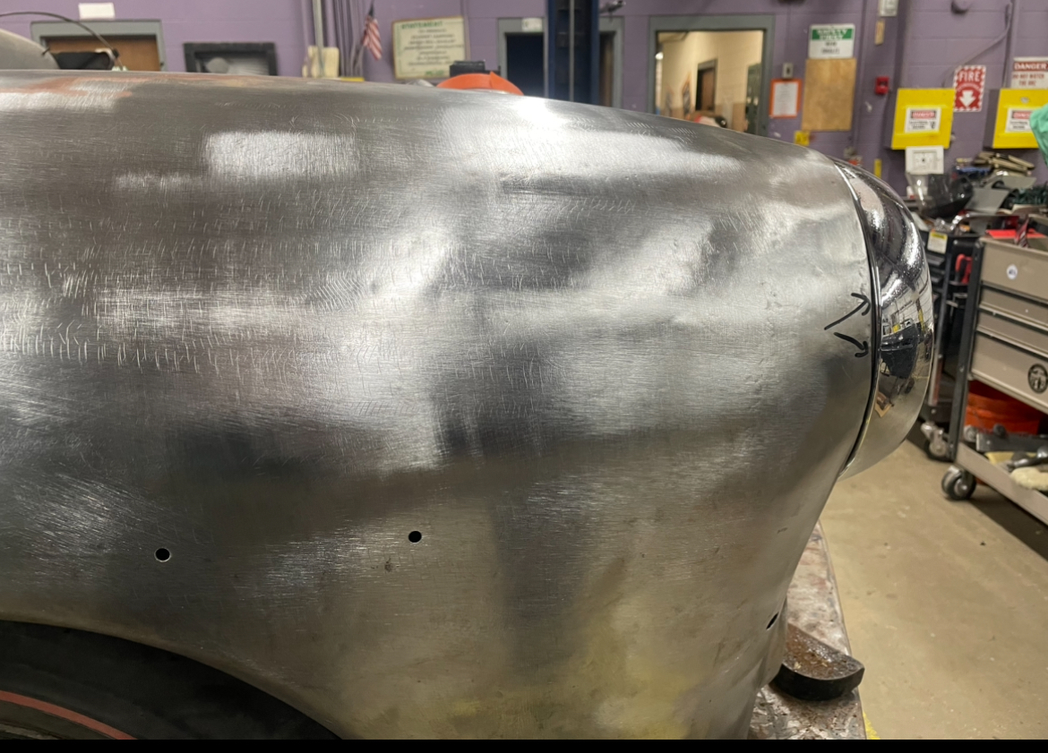

  22. It does shrink the highs. It also creates a great visual for working up lows
    roughed out dent from a previous repair that just filled it up with filler. IMG_9499.jpeg a couple p***es with the disc. Shiny areas are low. Bump those up. Then more disc
    Clean up with a DA
    the heavy grinding marks was from the previous repair

    I think you mean DARK areas (not hit with disc) are low.
  24. The heat from the friction changes color on the high spots. They get darker
    RodStRace and down-the-road like this.
