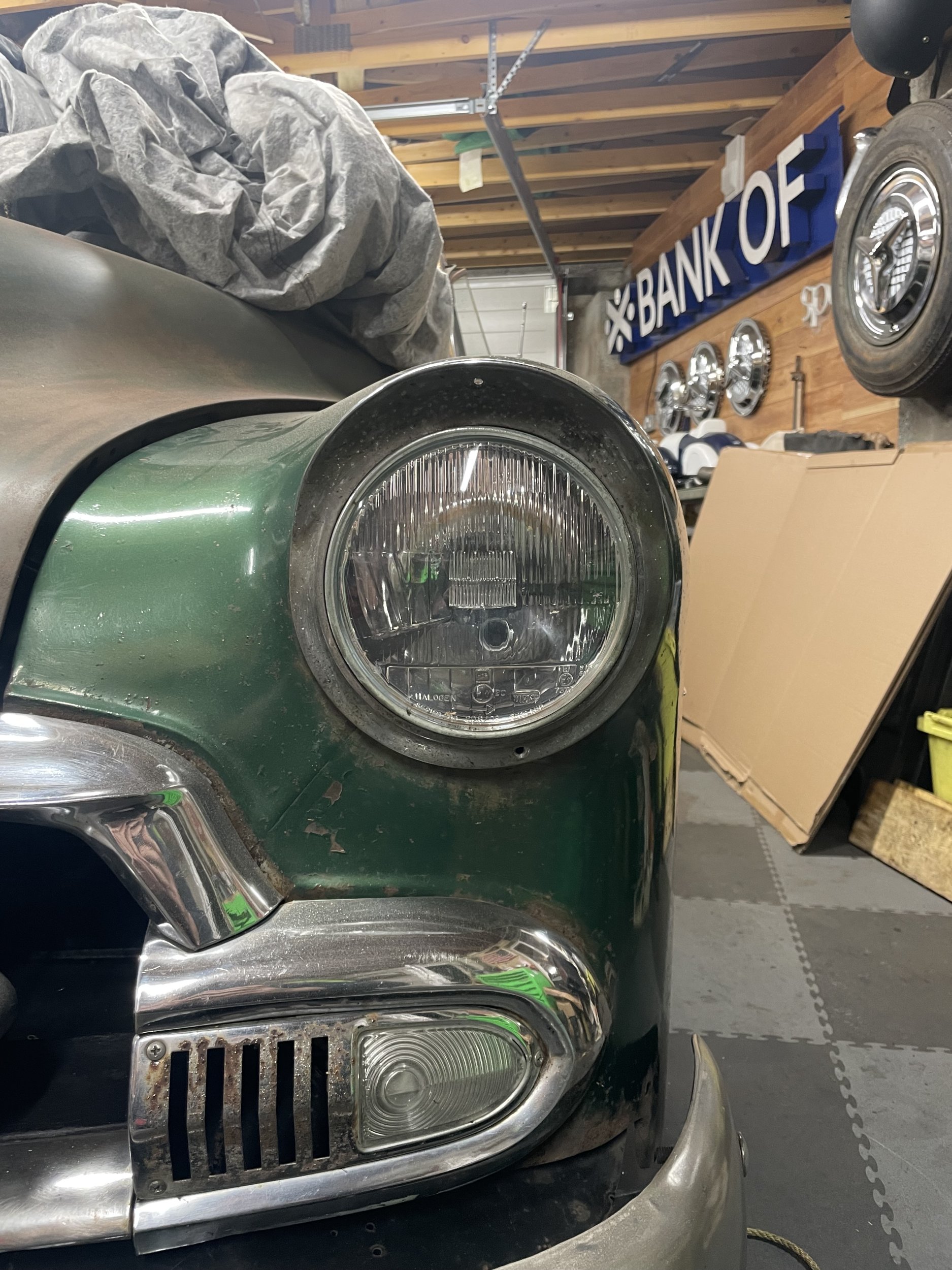

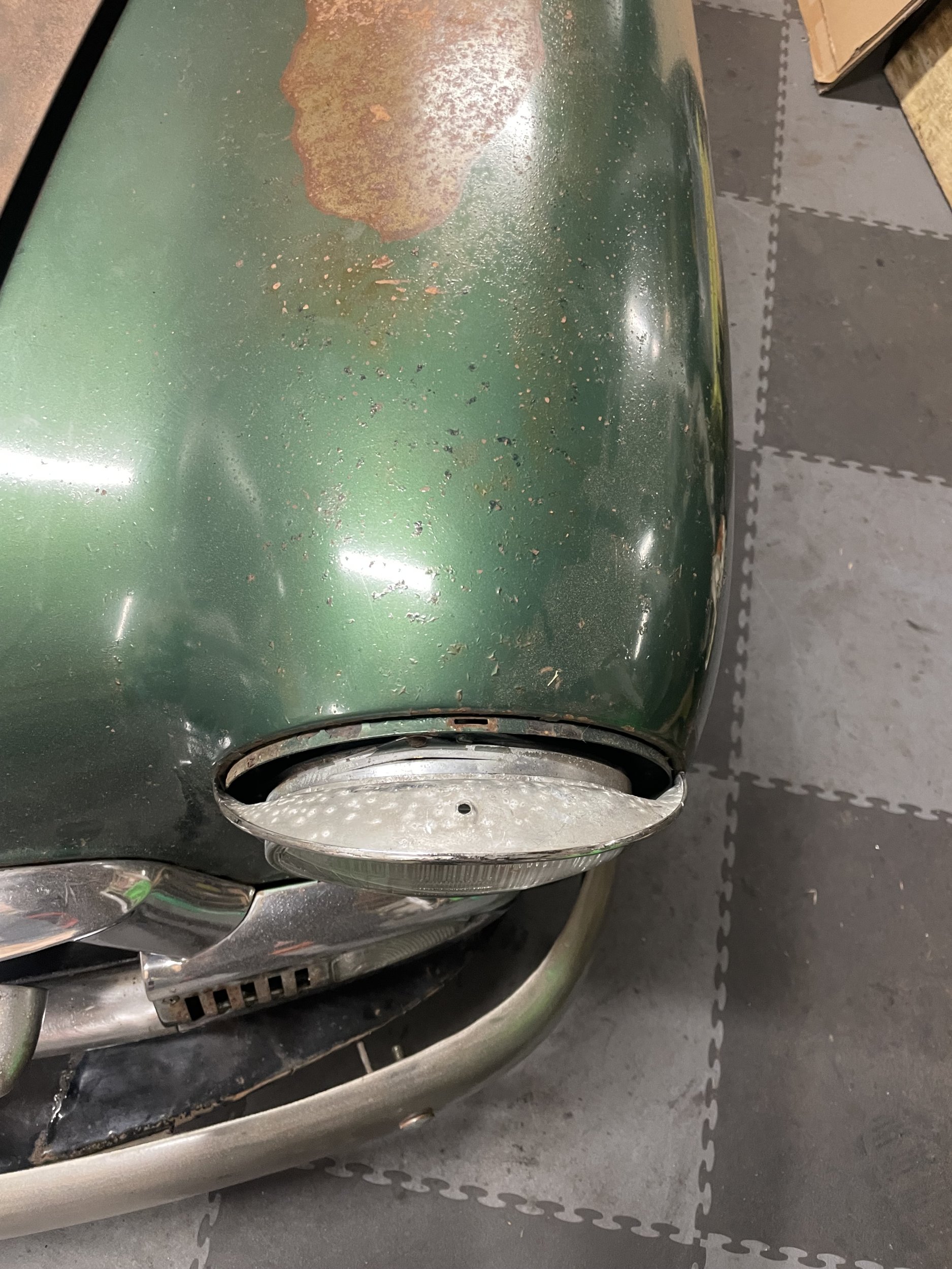

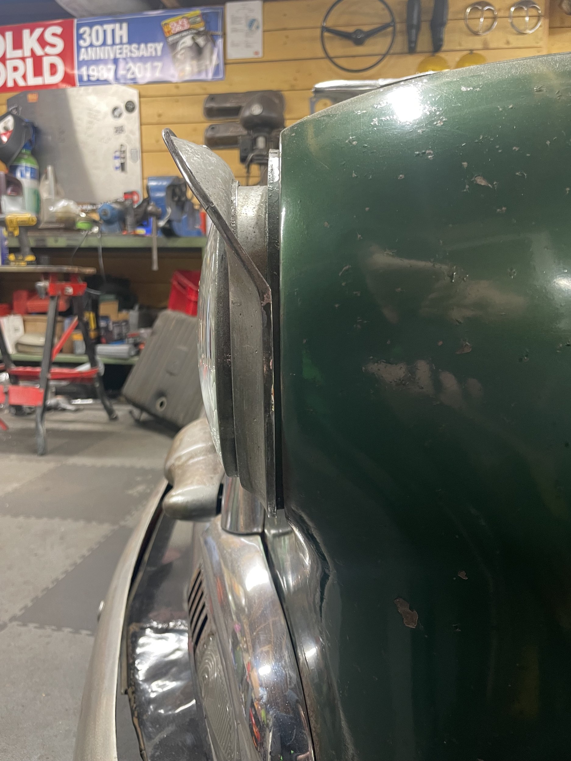

    so I have acquired some neat looking headlamp surrounds/trims that I’m keen to use on my Chevy.
    they are from something British (possibly Cresta)
    as you can see by the pics they are close but will need the top of the fender extended to meet the ‘peak’
    I think I can relocate the bowls to the backside of the fender to get the lower part of the trim flush, but wanted some advice on how to tackle the peak extension.
    thanks in advance!!

    Use heavy paper and tape to mock it up. Keep trying til you find the shape that pleases your eye

    I’ve seen guys bend a 1/8” or 3/16” rod for the new front edge of the fender, fitting tight to the bezel’s backside. Weld the ends of it in place so it fits perfectly to the bezel. Then cut a curved slice of 20 gauge to create the new top of the fender and bend to shape. Tack and weld carefully.

    This sounds like a good plan, the round rod would give a nice finished edge

    Why don't you search for a tri-five headlight brow patch panel. It might not be a direct fit, but it will get you pretty close and save a lot of time fabricating. Or if you could find a tri-five that has been parted out and salvage the front fender tops you would have the same thing.

    I'm thinking it is going to take more than a brow to make that work. Look at the over head shot.
    All side of the fender are in an inward sweep. From the top, you are going to have to do some more work to make it look correct as part of the fender
    Looks like some pie cuts on the sides might work

    now that I am really looking, it might be easier to sink it into fender. Cutting away some bottom and sides.....pushed into the fender making the brow out of the fender.

    I'd bent up some steel rod as stated above to follow the brow. Small tack weld in place and then cover with some 3" tape.
    Once taped up you can get a good idea of what the sheet metal will look like. Also with tape you can easily change angles and work out the sheet metal angles and of you become happy with that then you now have tape patterns to transfer to the sheet metal.....
    lothiandon1940 likes this.

    In this picture you can see that the top of the headlight trim is actually taller than the end of the fender and goes lower than the original lip for the headlight trim ring. To do this correctly you should start as mentioned before and get the top of the fender line with rod, I suspect the rod will go 12 to 18” back on the fender or further. I would recommend making cuts in the sides of fender on both sides of the head lamp so you can raise it to meet the rod then fill in the wedges with new steel. Or you could remove the12 to 18” of sheet metal and build the tops of the fender’s as needed. It just depends on good your fabrication skills are. To make the flange that goes behind your headlight bezel you will need a shrinker.
